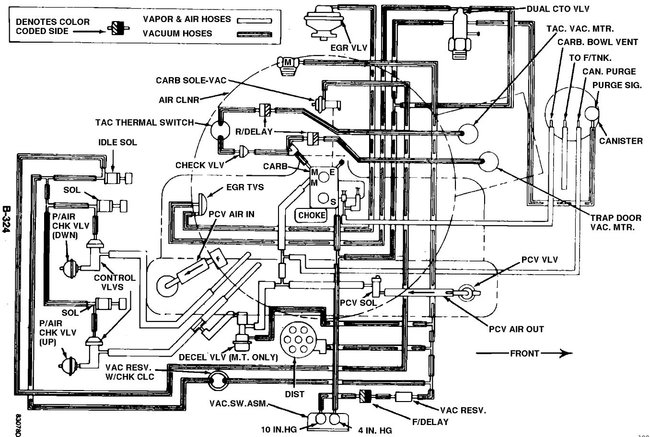

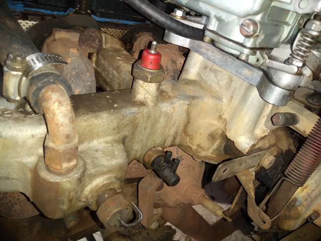

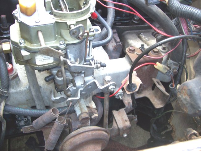

Can anyone tell me, definitively, what these electrical and vacuum sensors and plug we're for before retirement. Top of manifold, with red plastic. Vacuum fitting at center of picture. Electric connector with wires sticking out, about 7:00 o'clock.
Mostly curious as they are not connected in any way at least on the outside. Thanks in advance.

Red one looks like a coolant temperature sensor, the vacuum connections would be controlled by temperature as well. That one looks like the EGR thermal control. It prevents EGR operation unless the engine is up to temperature.

Okay. Thanks Steve. That will give me a starting point to dig a little deeper.

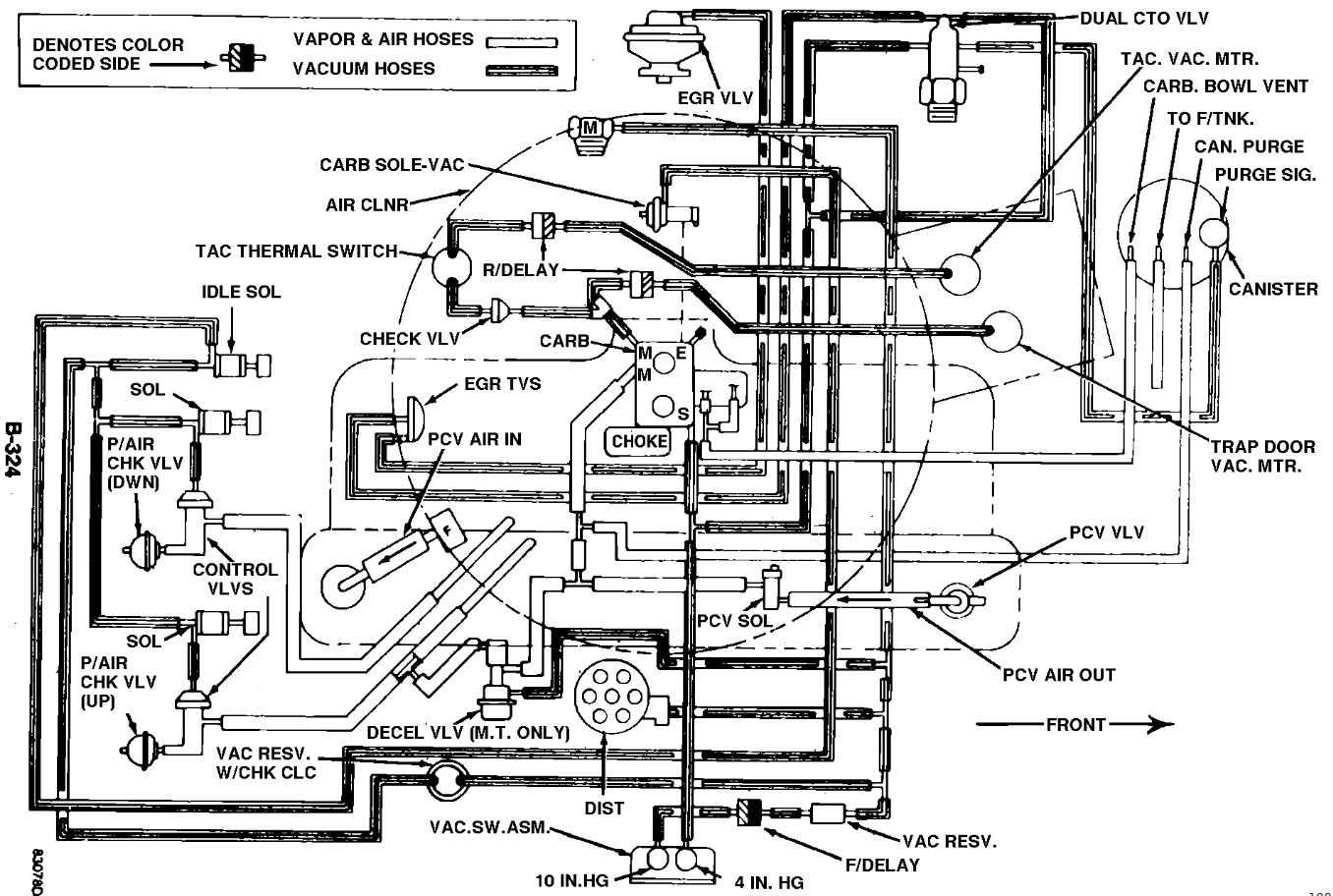

This is the vacuum line diagram for that Jeep and engine. That may help.

Well what do you know. The black vacuum fitting has a name now. "CTO valve". That is helpful. It is also interesting that the vacuum advance for distributor is taken from manifold vacuum, and not port vacuum from the carburetor.
I probably should clarify that my Jeep only runs one vacuum hose. Vacuum advance to distributor. All other vacuum has been plugged, disconnected, or just plain removed. I was asking about those fittings to understand what they did originally, so as to get to know my new lil buddy.

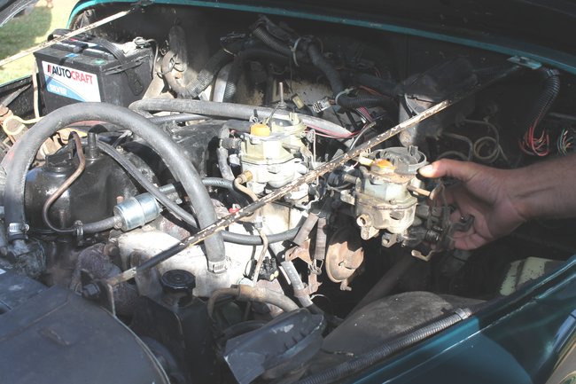

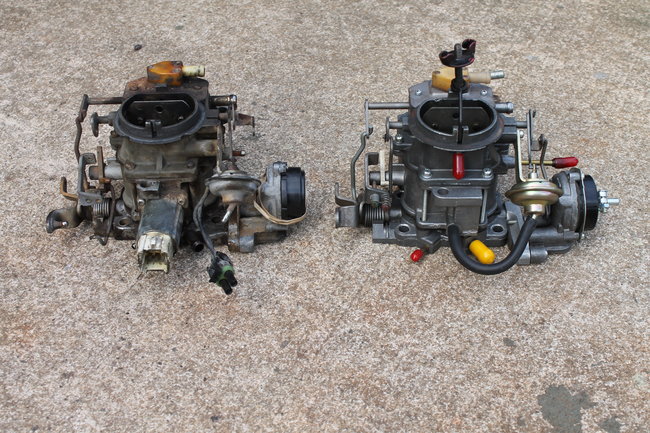

You'd be better off keeping that stuff disconnected and installing a BBD carburetor like a '79 (like the one on the right in my first picture)
Look! "Rick" just got his BBD from EBAY for $99.00 (what a deal!), the old stepper carburetor quit "steppin" years ago
Having hands on with his Jeep, we got rid of the crap, insured everything that was necessary was connected correctly.
Notice the same crap as yours is no longer in use.
Basically, he now has a 1979 CJ7 (engine wise), the best CJ year ever!
What issues are you dealing with, with your Jeep?

Hey Sarge, Thanks for the reply. Was not intending to hook any of it back up. I was just wondering what each of those were in case one of them might be a future issue as the sit now. I've been reading some of your stuff here, and at your recommendation to another CJ7 owner, I removed what was left of the ECM harness and the module itself a couple of Sundays ago. Cleaned up the firewall nicely. I'm in the process this week of replacing the column mounted ignition switch. Traced down the power feed for the blinkers and wipers to that spot. Mine has a Holley two barrel on it now, but the Carter came with the Jeep, in a box. No steppers attached. Someone has gone before me and bypassed the ECM putting me ahead a step or two in the process. Ha. The Lil guy is just dirty and tired. The main issue was the turn signals. Let me finish getting those going, so I can drive it on the street. I would be very happy to have your help with turning this Lil guy into a reliable get arounder. That's it for now. Don't want to go too long here. Look forward to hearing from ya.

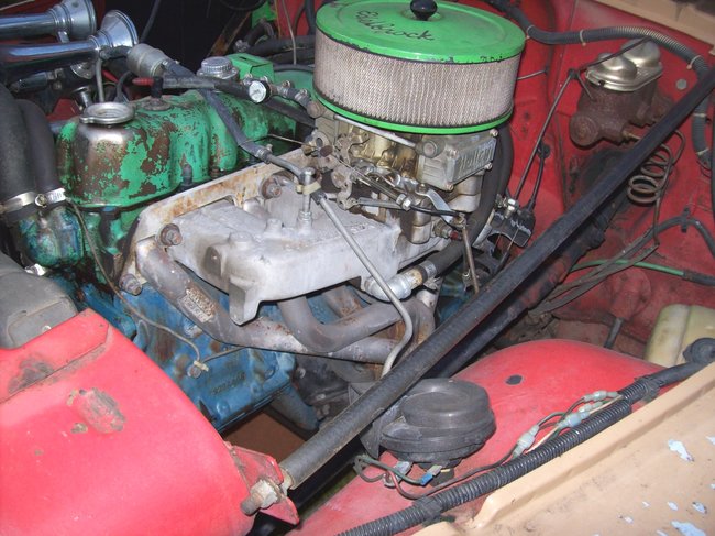

Nothing like an Offenhauser Intake and a 390 4 bbl Holley on a 258.
