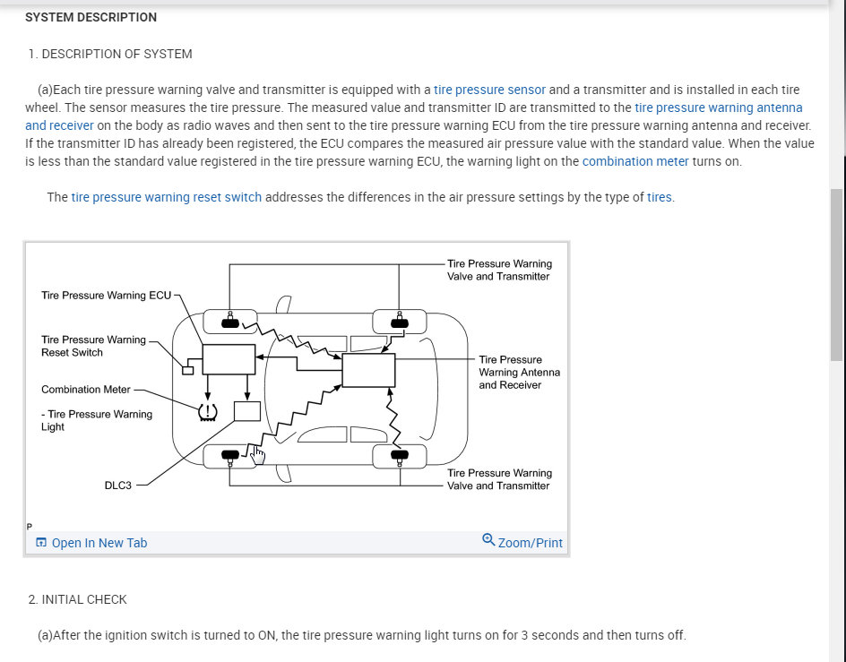

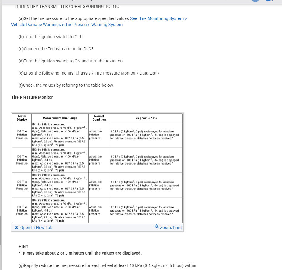

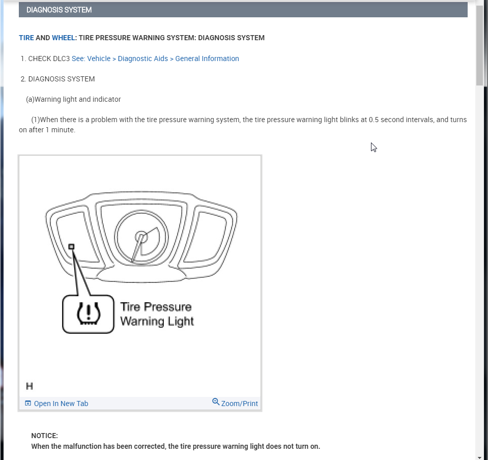

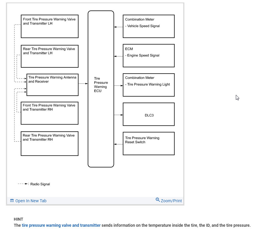

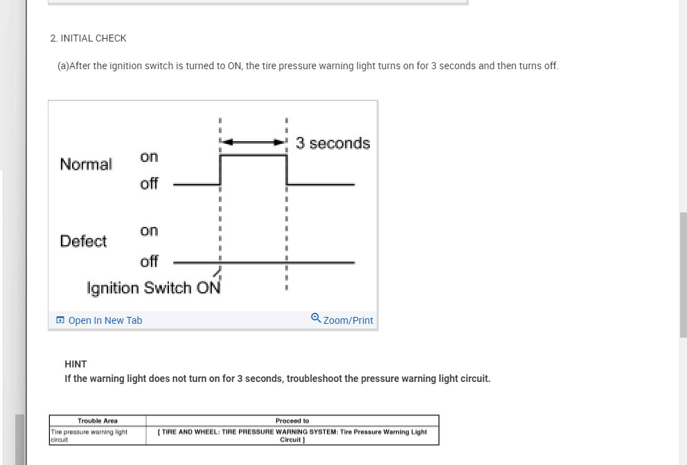

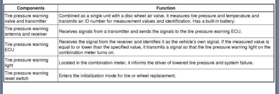

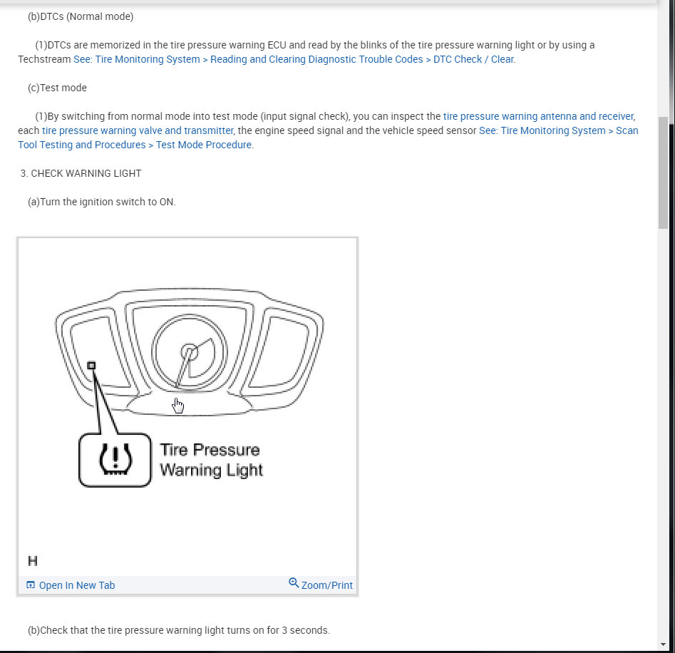

The fact that the light is blinking means there is a system issue. Unfortunately just resetting the module will more than likely not resolve this. We need to start with what codes are in the system and go from there. I attached a lot of info about this system including diagnostic steps to figure this out. More than likely the light is blinking in a pattern which has a meaning but just scanning the system with a scan tool will result in the codes needed to figure this one out.
Let me know what codes we have and we can go from there. Thanks

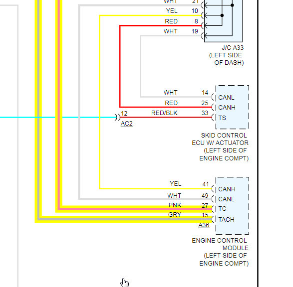

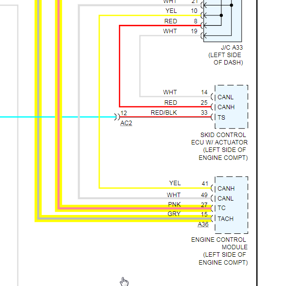

I have an OBD2 code scan tool and I am getting an "ERR" message. My scan tool works on other cars but for some reason I am getting an ERR message on this car. I am not sure why. Is this car OBD2? 2011 Scion XB.
Jan 20, 2020 at 10:21 PM

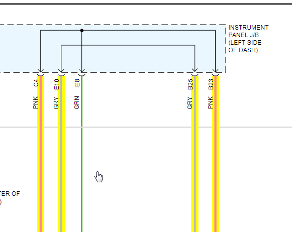

Yes. This is an OBD II car. All cars since the mid 1990's are OBD 2.

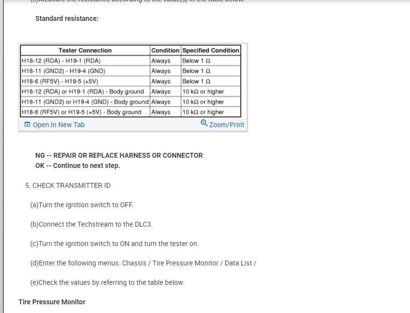

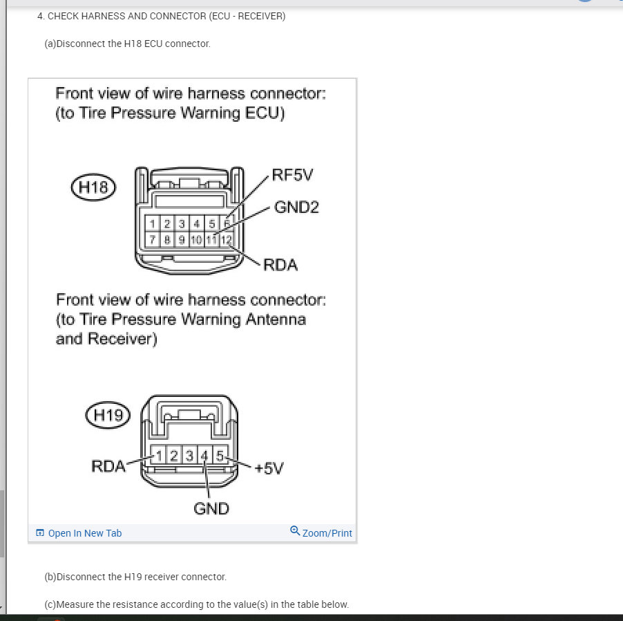

As for the error message, check with the manufacturer of the scan tool because that normally has a specific meaning but it varies on tool. Usually it means there is a communication issue with the ECM but let's double check that because if we chase that and its not what it means for this tool then we will just waste time.
If it is then we need to trace the wires from the DLC to the ECM. I would just ohm them out from end to end and see what they are. If you have an open on the pink or grey wire then that is the issue.

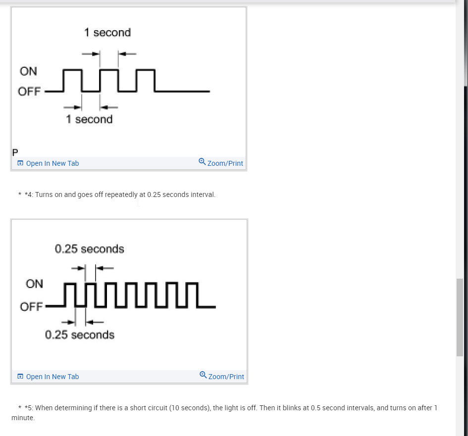

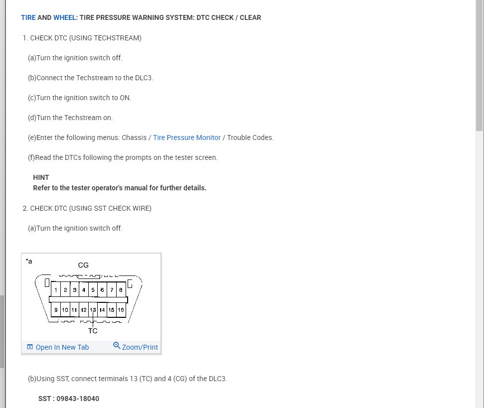

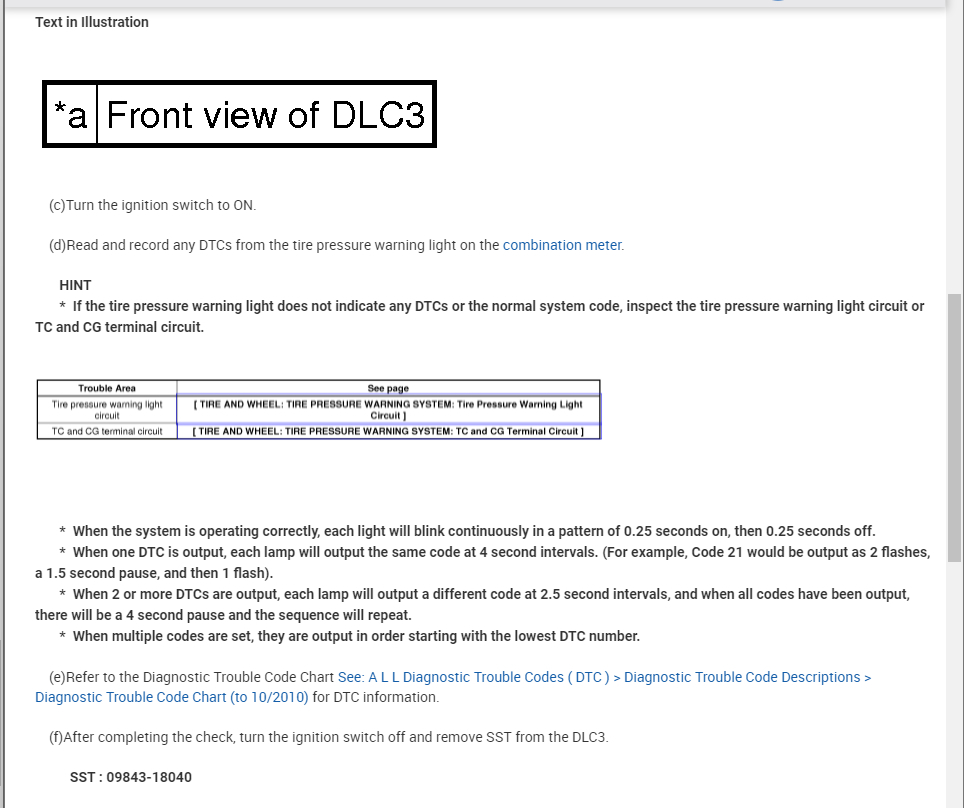

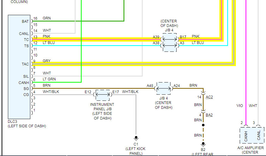

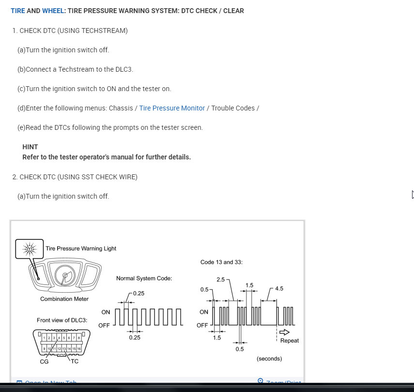

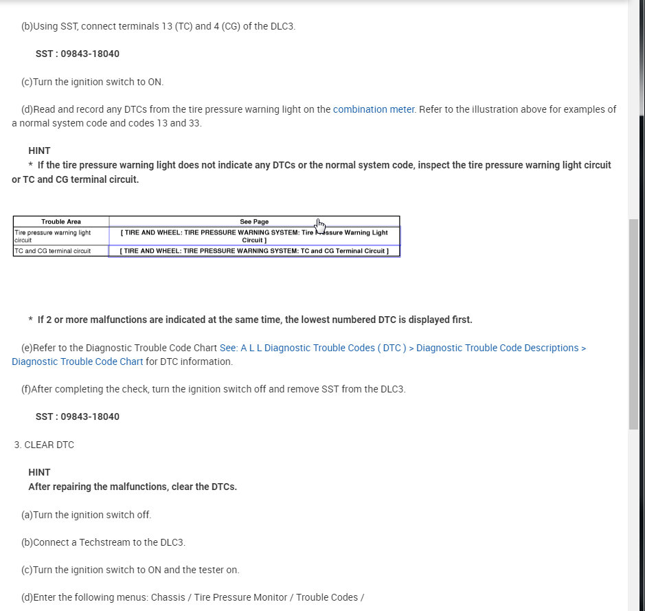

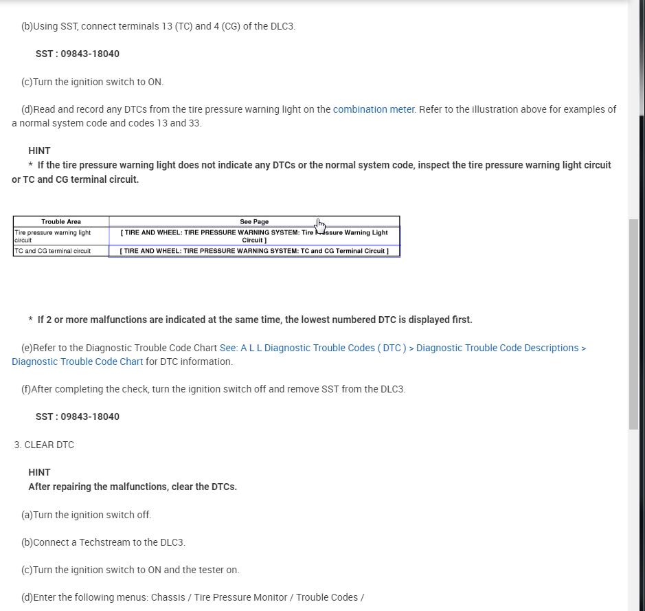

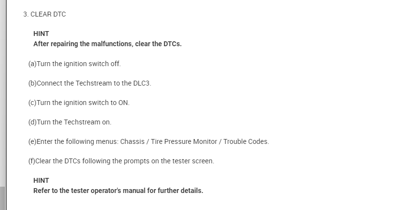

I purchased a new OBD II scanner and there are no DTC codes showing on the OBD II scanner. Do I need to jumper terminals 13 and 4 on the DLC3 to check for flashing codes? I don't have the SST tool. Will a jumper wire work?
Would something like this tool help?
Autel MaxiTPMS TS401
Dec 28, 2021 at 11:57 AM

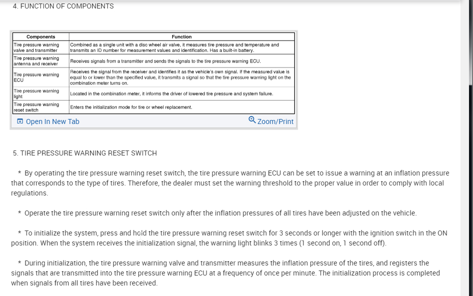

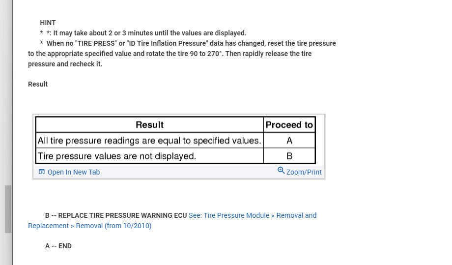

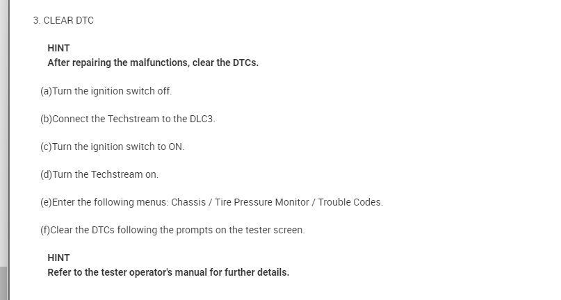

So, if you have no codes and another scan tool can communicate then we know there are no issues with the vehicle.
This means if the tire light is still flashing then there is an issue with the system that we are going to have to work through.

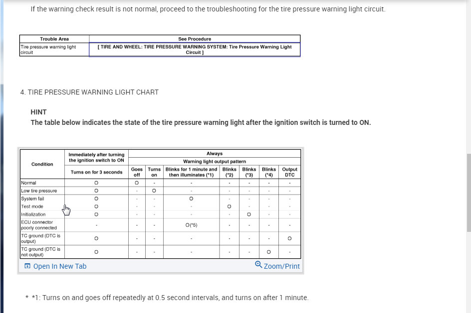

It appears just a jumper wire will work. I don't see any specific resistors in this one, so you need to jump them and check the codes we get.

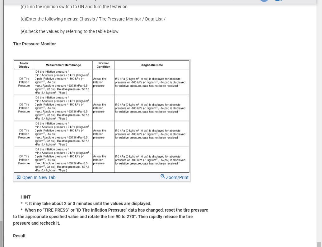

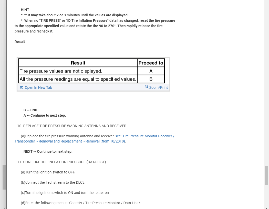

I attached all the info below on this.
Please run through it and let us know what you find. Thanks

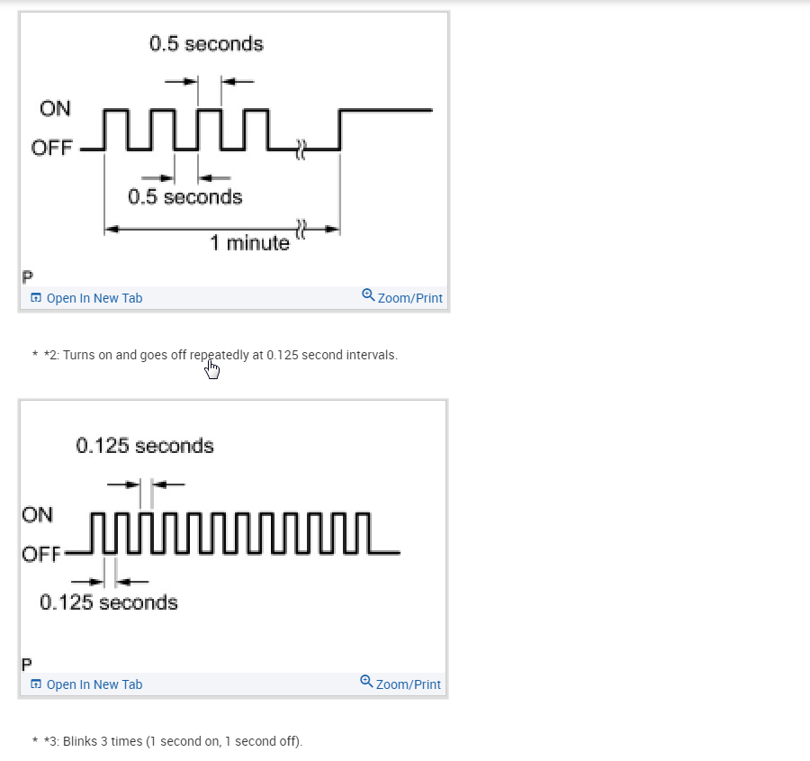

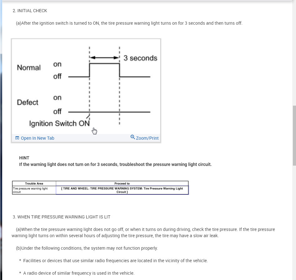

Actually, the light flashes only after you start the vehicle for a short period of time and then it remains on steady. With that said, does that change the situation about how to troubleshoot?
Dec 31, 2021 at 9:25 AM
Sorry I was not clear. It does not. If the light is on or staying steadily on, then that still means there is an issue with the system that needs to be run through to figure out what the issue is.

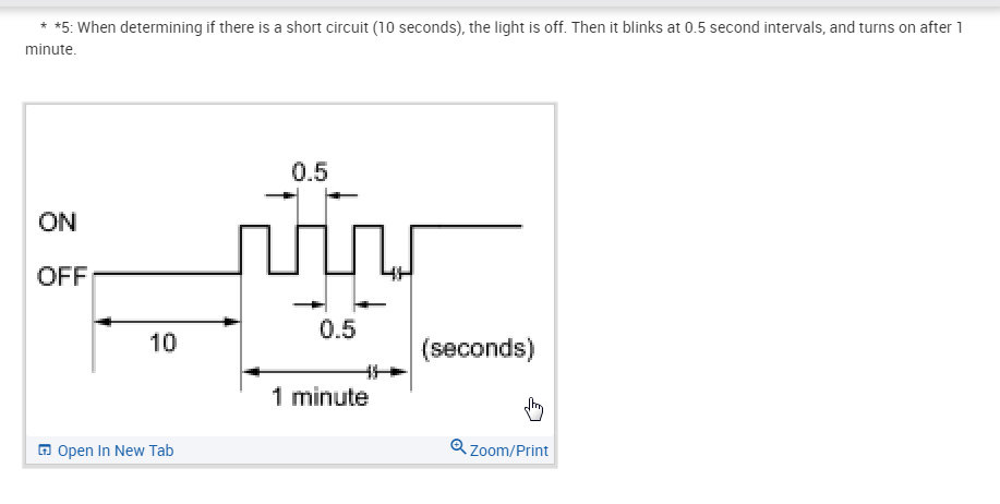

Okay, thanks for the continuous help with this issue as it has been taking a long time for me to get after it. I finally have the car being unused and I have free time. Also, I finally got a new OBDII tester!

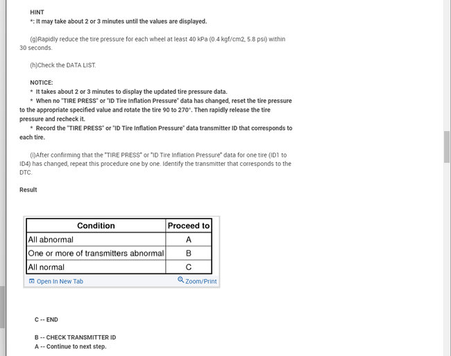

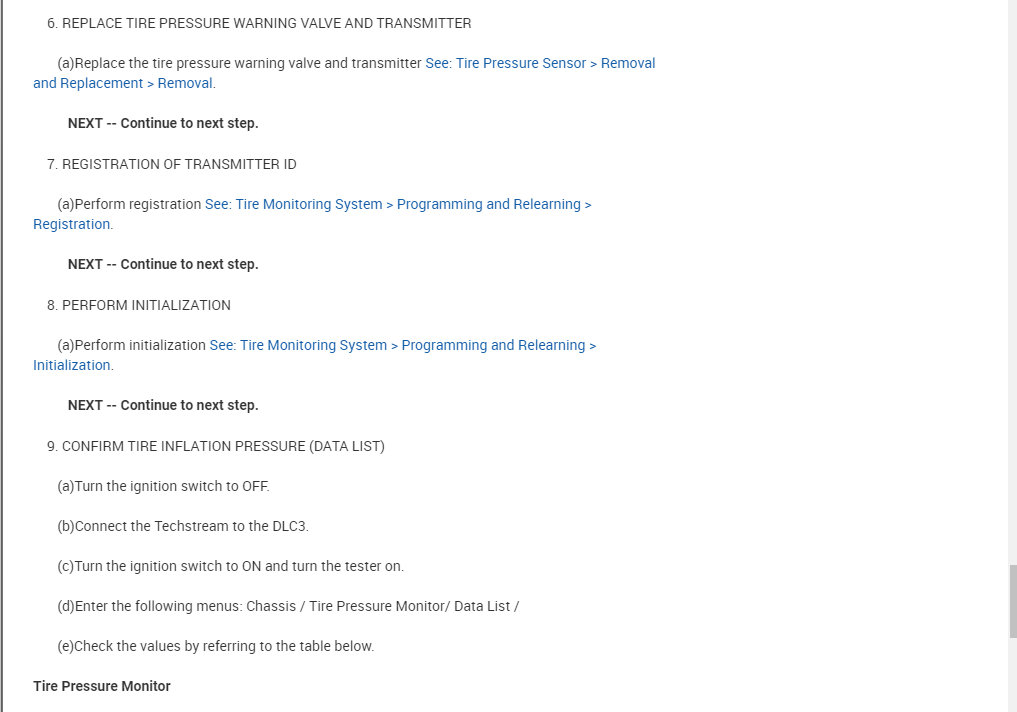

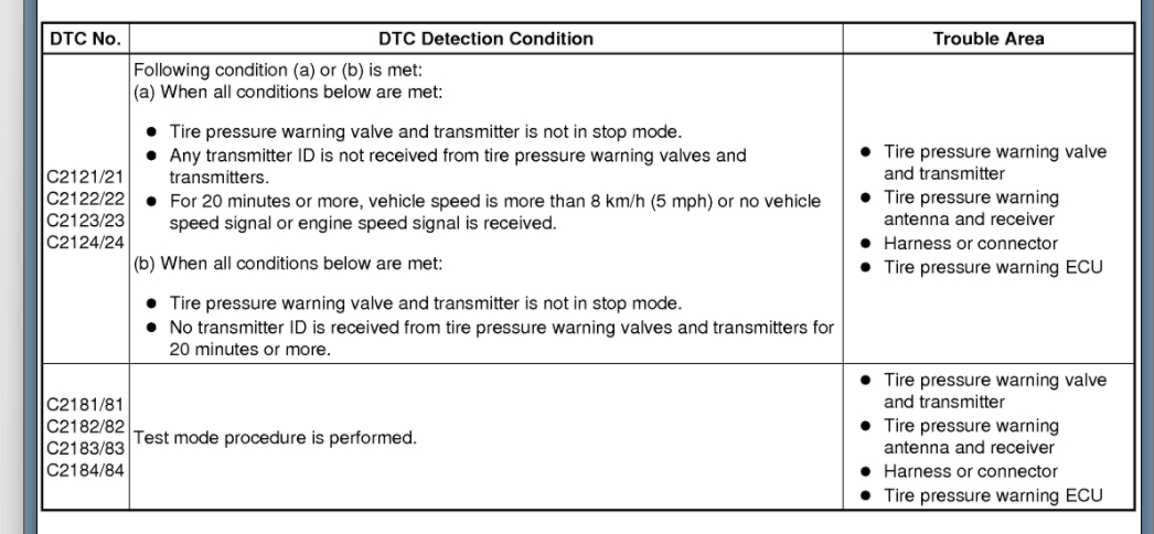

Anyway, I ran through the procedure with the two pins (13 and 4) on the OBDII jumped together. I retrieved two codes: 21 and 24. I counted two flashes, then one flash, then two flashes and four flashes. Then it repeated itself. Therefore, I feel confident that I saw code 21 and code 24. I look forward to knowing what these two codes represent for the TPMS. My car is a 2011 XB just so we are on the same page. In the first post I mentioned XD, but this car is an XB, 2011 model year.
Jan 1, 2022 at 12:41 PM

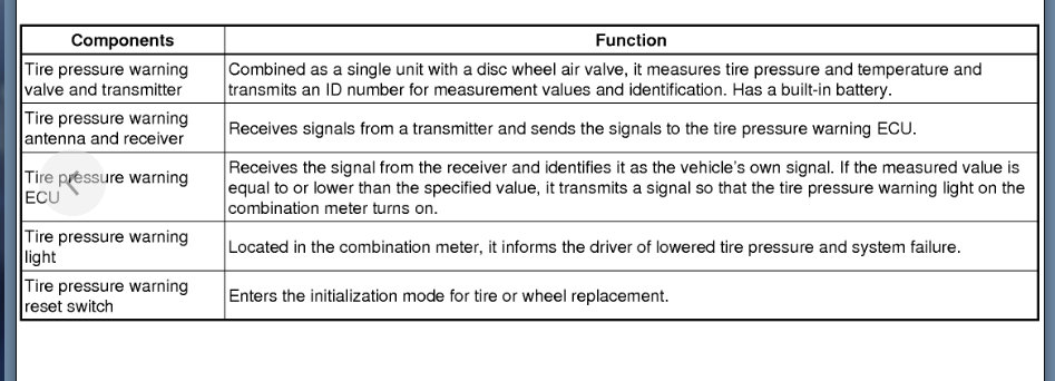

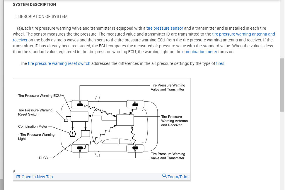

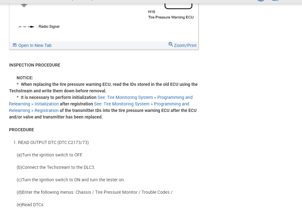

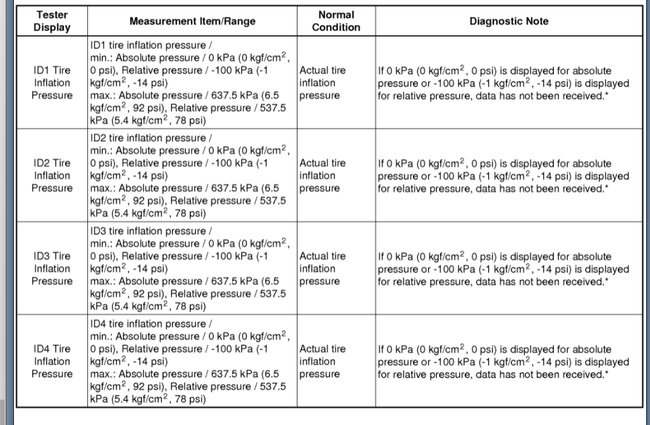

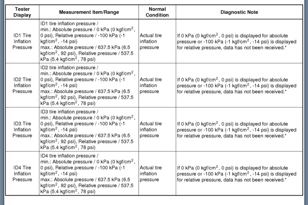

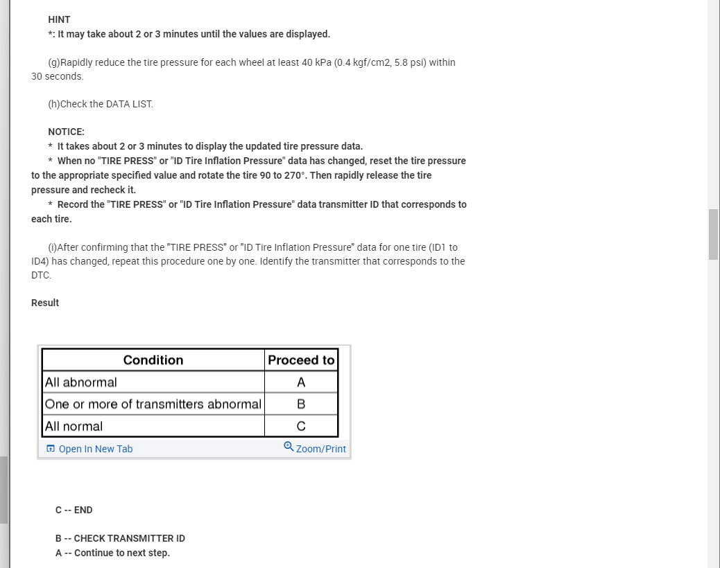

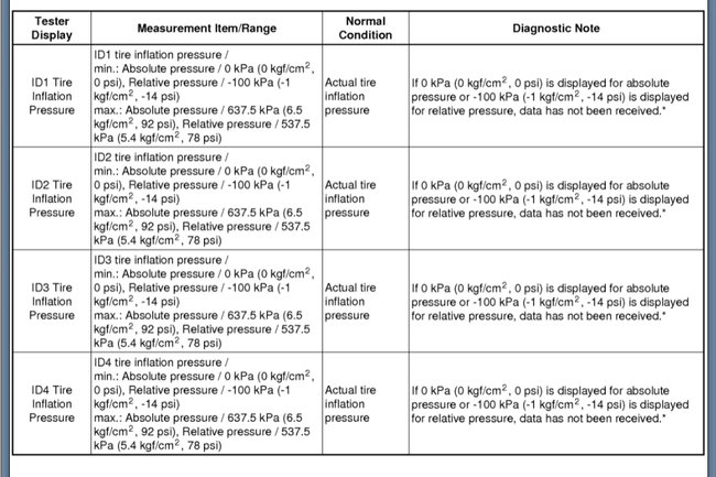

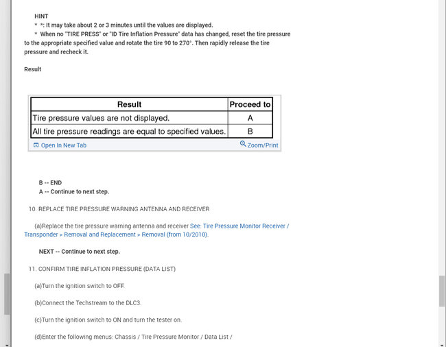

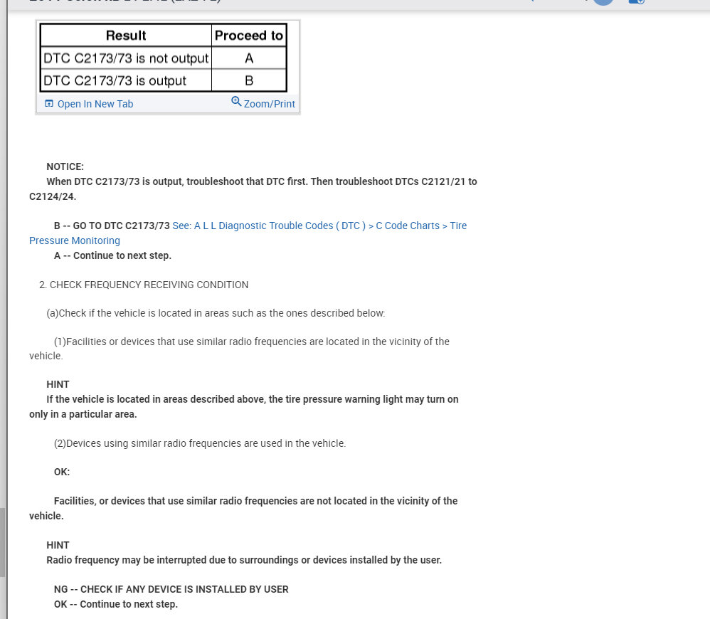

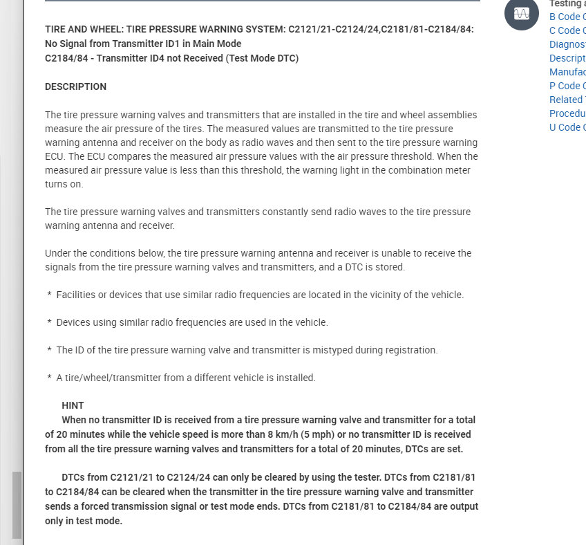

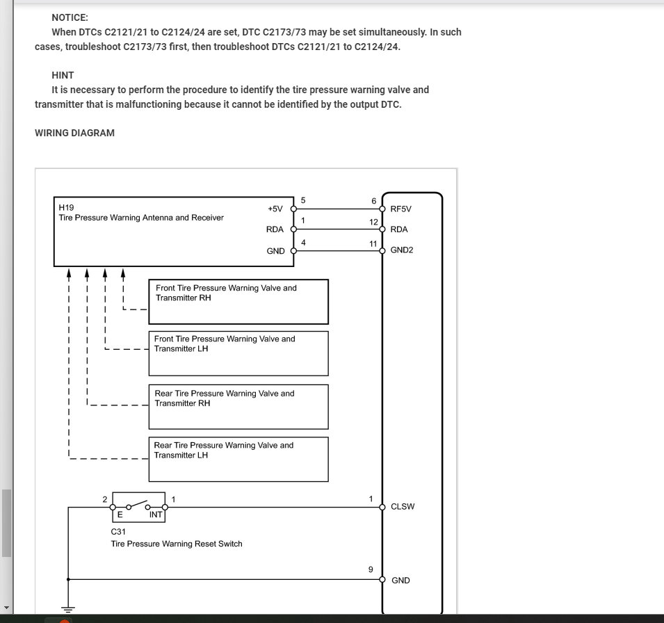

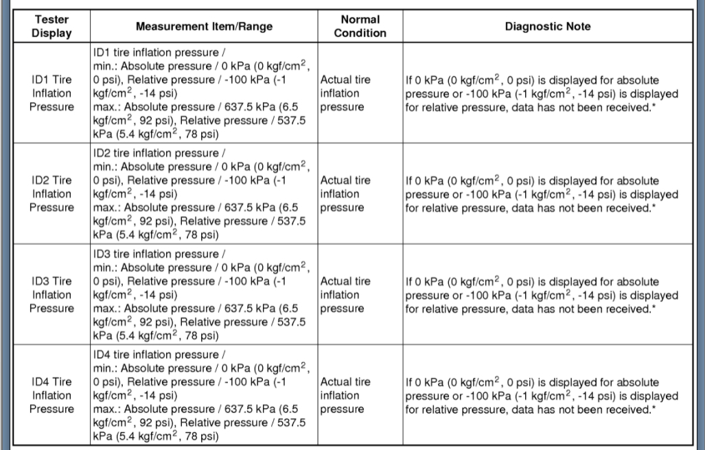

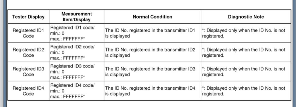

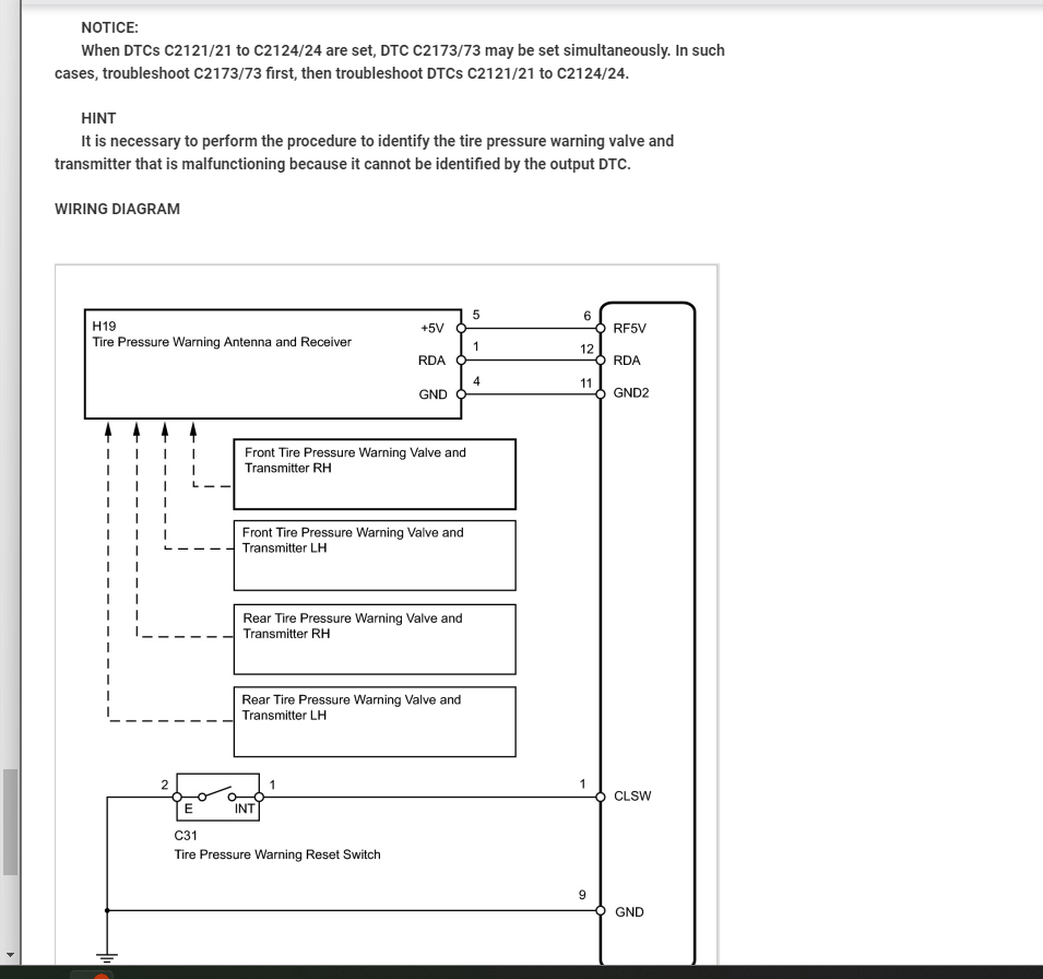

Okay. That is great. I am attaching the info on the 21 code. Basically, they are telling you the same thing except for different tires. This is telling you that the module is not getting a signal from transmitter 1 and 4.
Normally this is due to the transmitter itself in the tire, but it is worth going through the testing because if this light just came on then it is highly unlikely that you would have 2 sensors fail at the same time.
Jan 2, 2022 at 3:01 AM

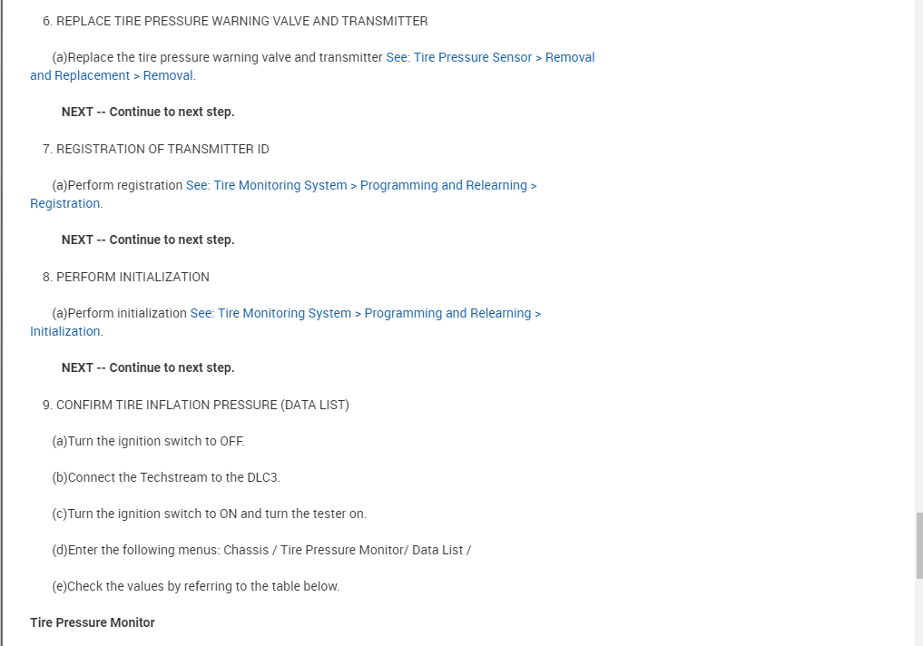

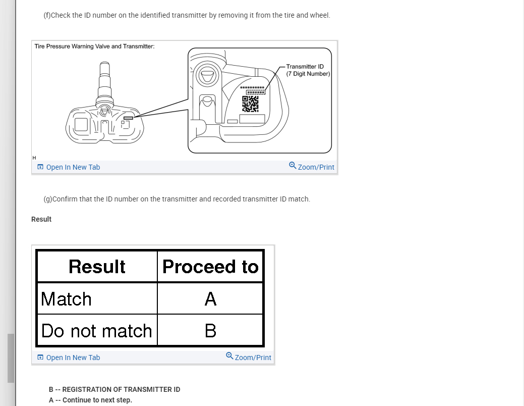

Okay, Thanks. If the other two transmitters were not sending a signal then I probably would have a code 22 or 23 as well? The warning light has been on for well over 3 years and I feel that a replacement of all 4 tire pressure transmitters should do the trick. I am planning to buy an Autel Maxitpms TS508 and their Autel MX-Sensors to fix the issue. Your thoughts?
Jan 2, 2022 at 5:05 AM
I don't have experience with those sensors, but it looks like they have good reviews.
However, that makes perfect sense then. Clearly one failed and then the other so I would do exactly the same thing.

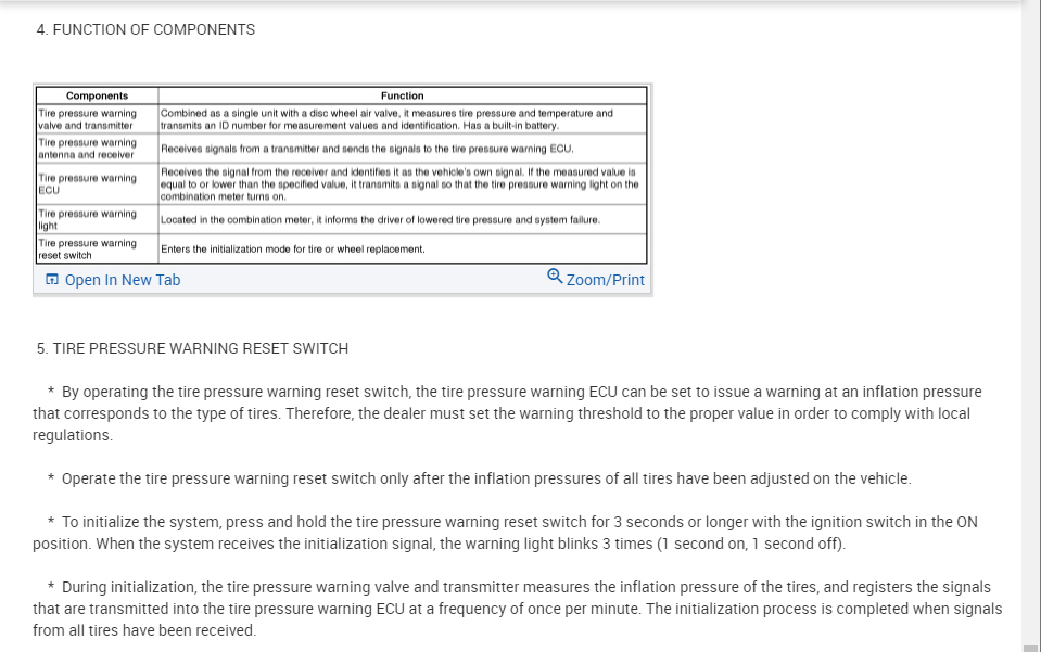

Okay, I will let you know the results. I've been planning to change all four tires and this would be a great time to address the TPMS. The tire change is also part of the reason why I haven't addressed the TPMS in so long. Which tires do 1,2,3, and 4 correspond to? Code 21,22,23, and 24 is assumed? LF RF etc. which tires do the codes correspond to?
Jan 2, 2022 at 7:07 AM
Correct. The last digit is the tire location, and it always starts on the driver side front, passenger side front, driver rear, passenger rear.
Totally understand. It would be great if the tires needed to be replaced at the same time.

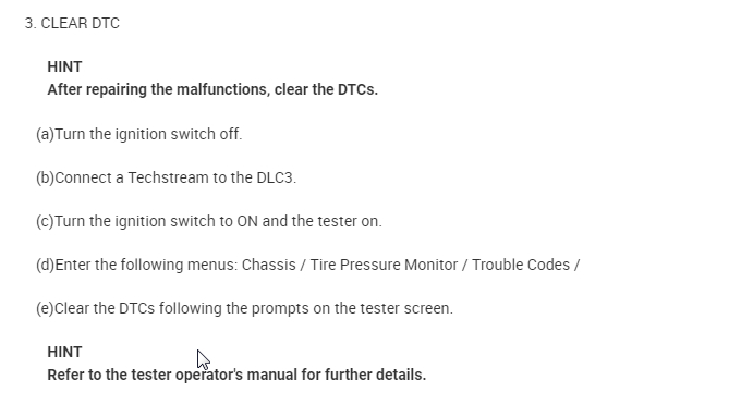

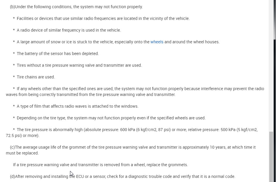

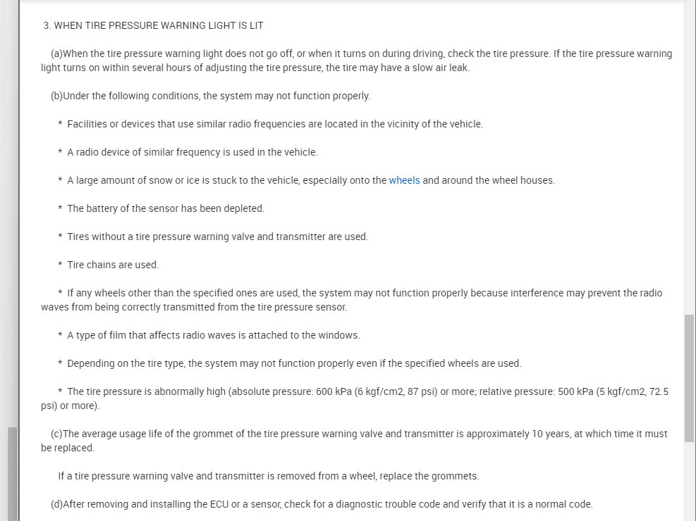

more than likely the battery in the sensors are just drained so they need to be replaced.
Jan 2, 2022 at 10:42 AM

Driver Front=1
Passenger Front=2
Driver Rear=3
Passenger Rear=4
Is this correlation correct?
Therefore, My Driver Front and Passenger Rear sensors are the likely culprit so far?
Jan 3, 2022 at 10:48 AM
That is correct. However, I will caution you and say that I cannot find that specific info on this exact vehicle. However, I have never seen any vehicle that was different. So, I am very confident that this is the case but I just want to be transparent and tell you the manual doesn't label them for us.
