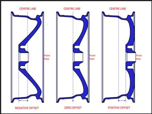

From the sound of this, you need to relocate things to fit the larger tires in. Unfortunately anytime you are doing this type of stuff, it is never just buy wheels and put them on. If the shock is in the way you will have to relocate the mount or get different wheels with different offset. Meaning the place it bolts to the hub is further in or out in relation to the edge of the wheel. See the attached info for more detail.
If changing the offset will get you the clearance you need it won't fix the issue of it sticking out from the fender. This is when you need to install a wheel tub. Meaning you cut out the fender well and install a larger one so that you can fit a larger tire.
It sounds like the solution to this is not an easy one no matter which way you go but let's get some pictures and I am sure we can figure out what is needed for sure. Thanks
