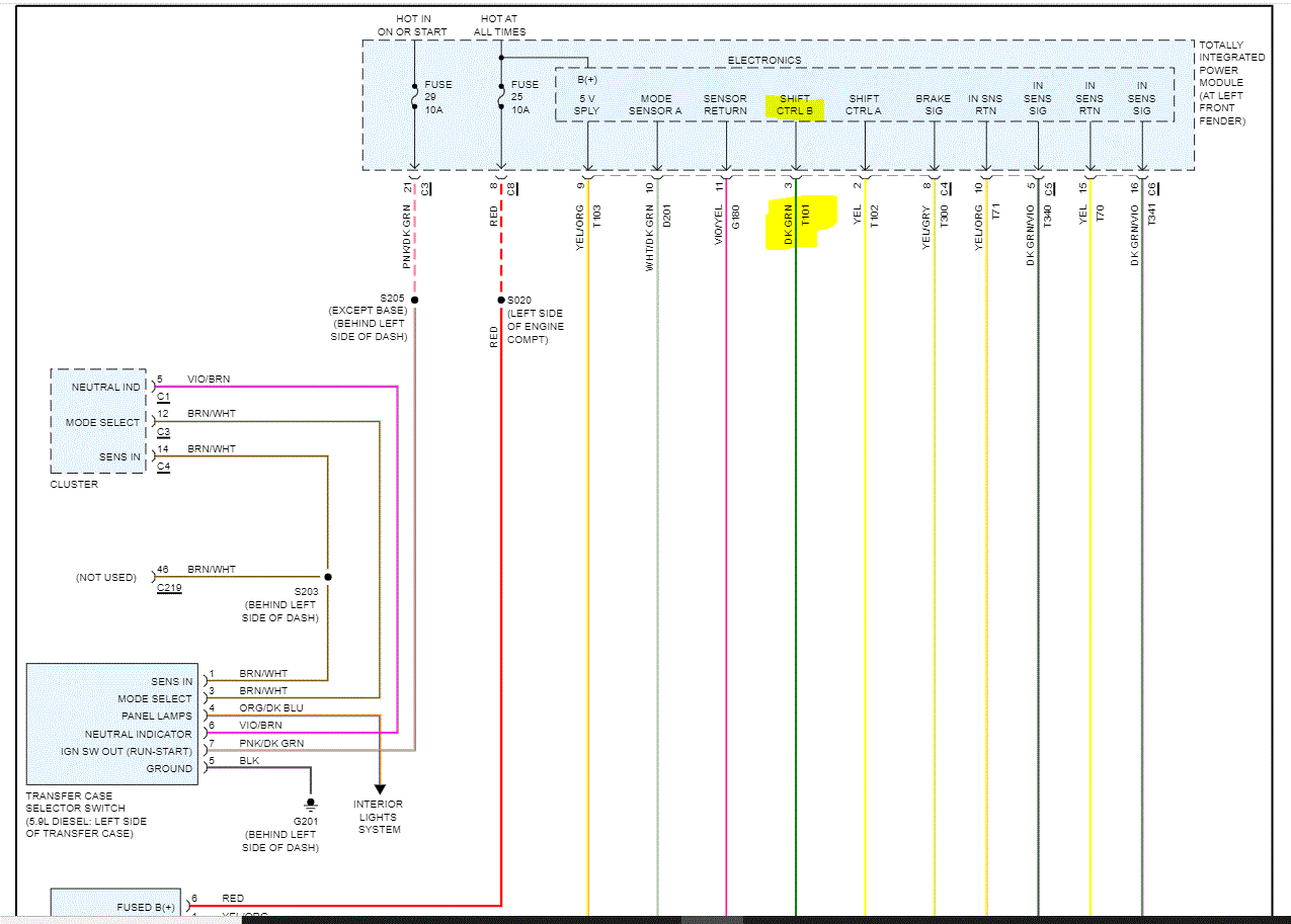

I replaced the transfer case and front driveshaft. original transfer case blew up. I have no 4wd. I have no input to the actuator at the yellow and green wires when I select 4WD or 2WD. I have no output from the TIPM C4 connection T101 and T102 (green and yellow) I have one code for the oxygen sensor. I also have 12V at the actuator A918 and 5V reference at the actuator T103. Should I replace the TIPM?

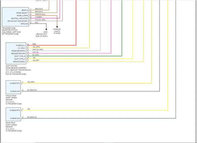

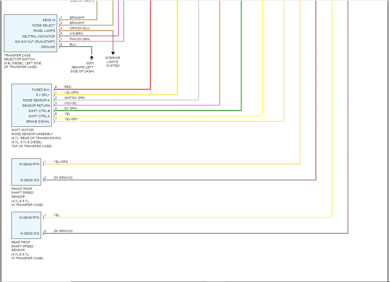

I attached the schematic below. Connector C T101 is shift control B. Note that the same fuse powers the t101 and t103.

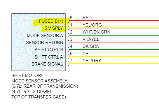

Go to the actuator motor and locate the yellow wire with an orange tracer. Does it receive a 5v reference from the TIPM? Does the red wire at the motor receive 12v? See pic 3.
Feb 5, 2022 at 10:47 AM
WHITEBUFFALO101
  • 8 POSTS
Hi, I have 12V at the red wire and I have 5V reference voltage at the TIPM. I have no voltage at green and yellow during 4WD command or 2WD command. I am using a power probe test light at the terminals at TIPM.

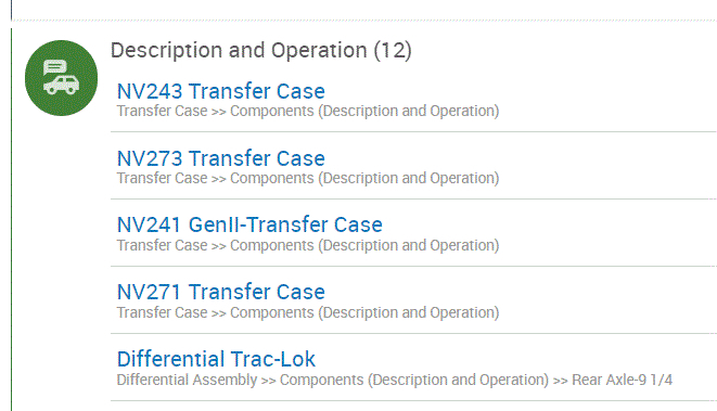

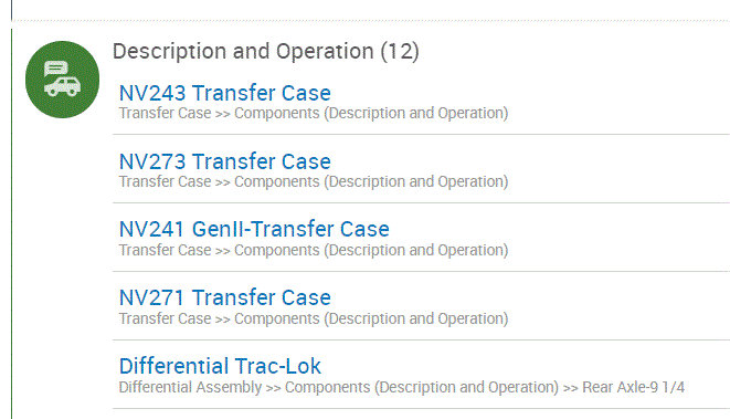

Do me a favor. Take a look at the list below and let me know which one you have.
Feb 6, 2022 at 10:35 AM
WHITEBUFFALO101
  • 8 POSTS
It's a 273 has 7 wires to the actuator.

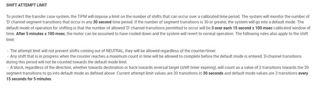

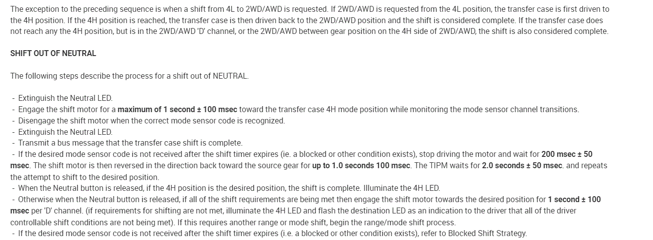

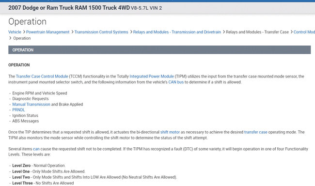

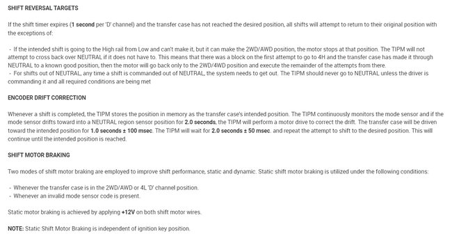

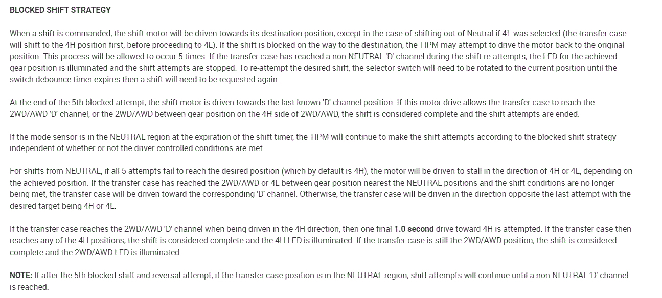

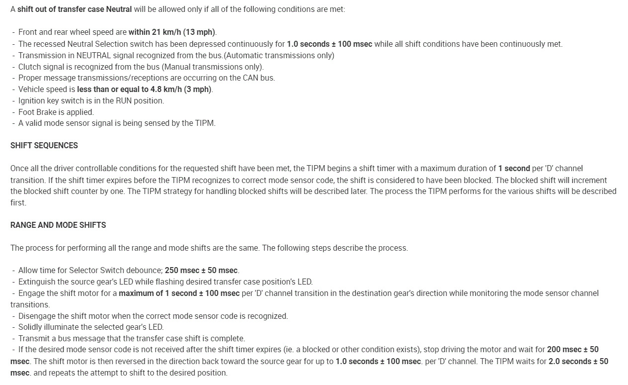

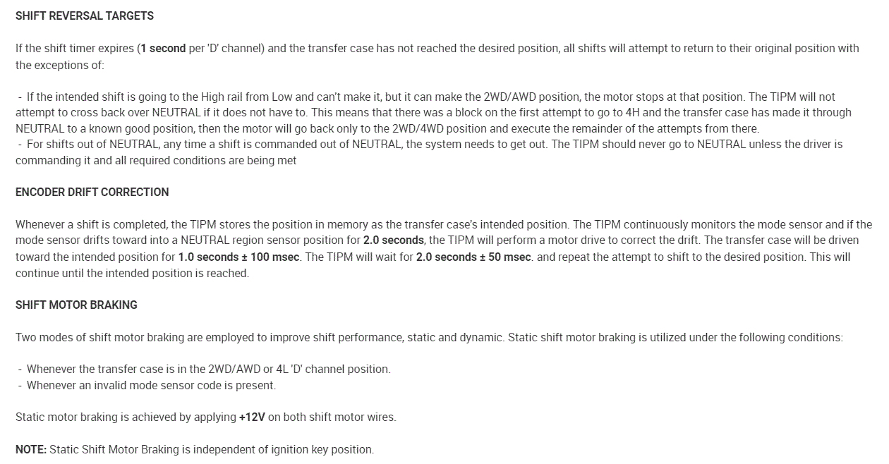

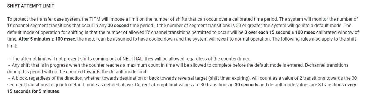

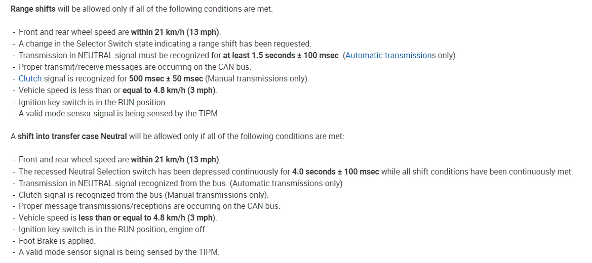

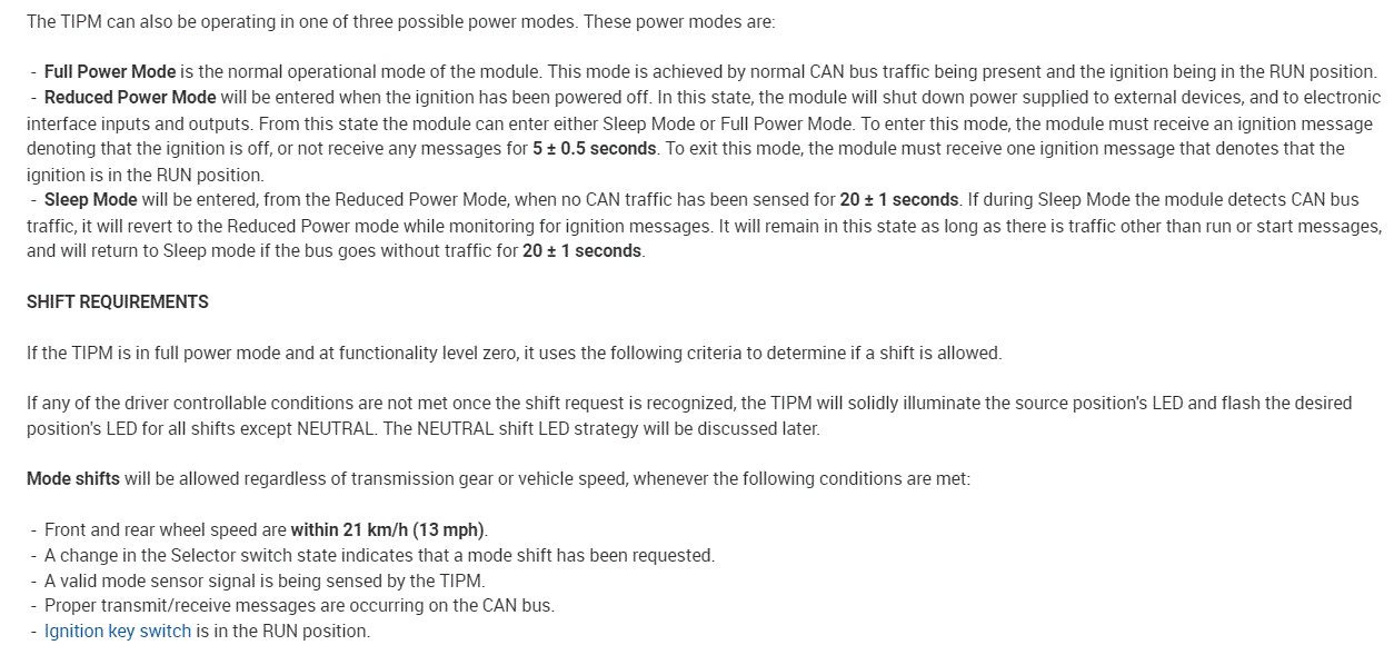

If you aren't getting power to the yellow and green at the shift mode sensor, I suspect the TIPM is bad. However, do me a favor. Take a look through the operation description specific to this transfer case. Let me know your thoughts.
Feb 7, 2022 at 12:20 PM
WHITEBUFFALO101
  • 8 POSTS
Hi Joe F, thank you so much for this information! I'm just getting back to this truck and trying to figure out where and how to test for sensor signal from the actuator. I never have any dash lighting up showing 4WD only the Service 4wd . If I can verify that a proper signal from the actuator is getting to the TIPM. D201 and or G180, I can rule out a fault with the actuator. I have a feeling the TIPM is shot but I have not collected enough evidence to pull the trigger, expensive.

Unfortunately, I have no voltage on the output terminals from the TIPM that go to the actuator for 4WD command. Yes, I replaced the actuator, as I was sure I had no signal from the actuator to the TIPM...Network issue? I think I will punt it to a guy nearby who has alot of used TIPMs and he can plug and play.
Feb 9, 2022 at 11:22 PM
  • 110,241 POSTS
I suspect the TIPM is bad. You need to get one specific for your truck. I know they rebuild them, and you can get one online. But like everything else anymore, they aren't cheap.
