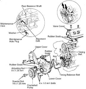

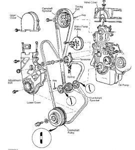

Install the timing belt and timing balancer belt in the reverse order of removal.
Only key points are described here.
- When installing only the timing balancer belt, go to step 13.
Note: Clean the upper and lower covers before installation.

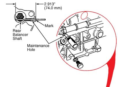

1. Remove the timing balancer belt drive pulley.
imageZoom/Print

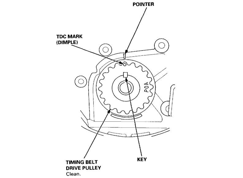

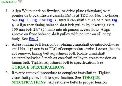

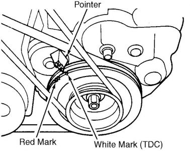

2. Set the timing belt drive pulley so that the No. 1 piston is at top dead center (TDC). Align the dimple on the tooth of the timing belt drive pulley with the V pointer on the oil pump.
imageZoom/Print

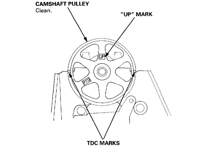

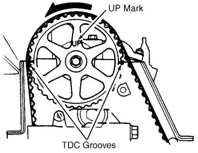

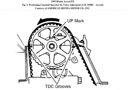

3. Set the camshaft pulley so that the No. 1 piston is at TDC. Align the TDC mark on the camshaft pulley with the cylinder head upper surface.
imageZoom/Print

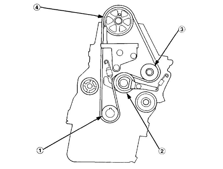

4. Install the timing belt tightly in the sequence shown.
(1)Timing belt drive pulley (crankshaft) -> (2) Adjusting pulley -> (3) Water pump pulley -> (4) Camshaft pulley.
Note: Make sure the timing belt drive pulley and camshaft pulley are at TDC.
5. Loosen and retighten the adjusting nut to tension the timing belt.
6. Install the timing balancer belt drive pulley and lower cover.
7. Install the crankshaft pulley, then tighten the pulley bolt.
8. Rotate the crankshaft pulley about 5 or 6 turns counterclockwise so that the timing belt positions on the pulleys.
9. Adjust the timing belt tension.

10. Make sure the crankshaft pulley and camshaft pulley are at TDC.
11. If the camshaft or crankshaft pulley is not positioned at TDC, remove the timing belt and adjust the positioning, then reinstall the timing belt.

13. Set the timing belt drive pulley so that the No.1 piston at TDC.
14. Lock the timing belt adjuster arm in place by installing one of the 6 x 1.0 mm bolts.
15. Loosen the adjusting nut 2/3 - 1 turn, and verify that the timing balancer belt adjuster moves freely.
16. Push the tensioner to remove tension from the timing balancer belt, then retighten the adjusting nut.
imageZoom/Print
imageZoom/Print

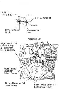

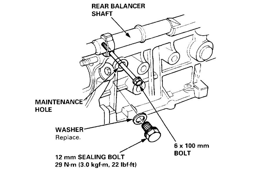

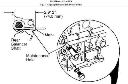

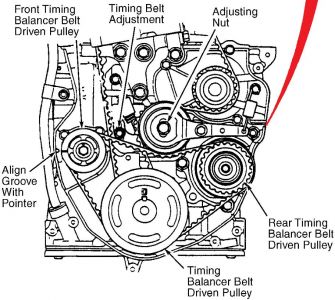

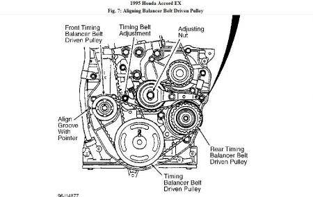

17. Align the rear balancer shaft pulley by using a 6 x 100 mm bolt or equivalent as a tool. Scribe a line 74 mm (2.9 in) from the end of the bolt. Insert the bolt into the maintenance hole to the scribed line.
imageZoom/Print
imageZoom/Print
18. Align the groove on the front balancer shaft pulley with the pointer on the oil pump housing as shown.
19. Install the timing balancer belt. Loosen the adjusting nut 2/3 - 1 turn to tension the timing balancer belt.
20. Remove the 6 x 100 mm bolt from the rear balancer shaft, then install the 12 mm sealing bolt.
21. Install the crankshaft pulley, then tighten the pulley bolt.
22. Turn the crankshaft pulley about one turn counterclockwise, then tighten the adjusting nut.
23. Remove the 6 x 1.0 mm bolt from the timing belt adjuster arm.
24. Remove the crankshaft pulley, then install the lower cover.
25. Install the rubber seal around the adjusting nut.
Note: Do not loosen the adjusting nut.
26. Install the crankshaft pulley, then tighten the pulley bolt.
27. After installation, adjust the tension of each belt.

24. Reinstall the alternator and belt.
25. Install the power steering pump and belt, tightening the bolts to 20 ft. lbs. (27 Nm).
26. Adjust the accessory belt tensions.
27. Install the side engine mount and the cruise control actuator if it was removed. Tighten the engine mount bolts to 29 ft. lbs. (40 Nm) and the nuts to 47 ft. lbs. (65 Nm).
28. Refill the engine coolant.
29. Connect the negative battery cable.
30. Start the engine, allowing it to idle. Check the work area carefully for any sign of fluid leakage or any indication of the belt rubbing or slapping the covers. Bleed the cooling system.
31. Shut the engine off. Reinstall the splash shield.
-Rob

Your going to want this
https://images.2carpros.com/forum/automotive_pictures/30961_1tb_1.jpg
