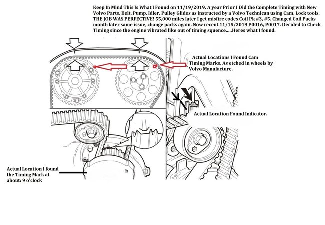

Problem: i accelerated hard to pass another vehicle, and then my car went into an extreme rough conditions “like timing jumped” codes came up “misfire cylinder #3 and #5, and ox sensors p0420 and p0430. The coil packs are not the issue, i’ve switched them around prior to checking the timing belt/crank alignment-and it’s still coded misfire #3 & #5 and oxygen sensors
(1) Worked Performed in Steps:
(2) Pulled Timing Cover Off
(3) Removed the Serpentine Belt
(4) Removed Harmonic Balancer
(5) Volvo Dealership Mechanic said I didn’t need to use
the cam locking tool at this point since he felt the
timing jumped...so I didn’t use it.
(6) Observed both Cam Wheels at 2 o’clock positions,
Crank Gear Mark at 9 o’clock
(7) Loosen Belt Tensioner.
(8) Removed Timing Belt.
(9) Cam Marks (intake & exhaust would only turn back to
12:30 (advanced) missing their original marks with
Timing Cover.
(10) Crankshaft mark was at 9 o’clock (retard)
(11) Hand turn Crankshaft Nut Clockwise to get at proper
Timing Mark.
(12) Hand turn Cam shaft wheels forward and back to stop
position (non-spring loaded) best I could get was about
12:30 position, not at 12 o’clock position with cover
marks.
(13) Reinstalled Timing Belt.
(14) Tighten belt tensioner as instructed by Volvo. Torqued
to Spec’s
(15) Hand Cranked Crankshaft two full turns Clockwise, No
metal sounds hitting,
(16) Reassembly car’s trim.
(17) Started car and get P0017 Code (Cam Position Sensor)
and rough idle, and co2 codes P0420 & P0430.
Keep in Mind: The Timing Belt, Water Pump, Tensioner, Glides Wheels, Serpentine Belt, Spark Plugs, Coil Packs (oem) I replaced 09/2018 @ 131.000 Miles. Installed to Volvo’s Specifications and Torque and per 2CarPros.com and VolvoSpeed.com. Everything was 100% perfect after the first Timing Belt Job, although I didn’t replace the Timing Belt Tensioner...I might have shot myself in the foot. The belt I think (not sure) jumped?
Where do I go from here? To get it all back on Track since nothing matches to marks.

The misfire codes P0303 cylinder #3 and P0305 cylinder #5 misfires could be setting P0420 and P0430 for the catalyst failure. If swapping the coils did not change then swap the spark plugs and then fuel injectors to see if any of those will follow.
As for the new code P0017 and the diagram you posted your timing is not set right. In fact you are so far off that I am surprised it even starts? At this point you now need the cam lock tool to properly set the timing now.

Now when I use the cam lock tool, which I've done in the past on my timing belt job and everything was 100% okay..after getting cams marks (hand cranking engine) set to timing belt cover timing marks-if the crank sprocket gear is off mark then what? Leave cams lock and clockwise rotate crank gear to it proper marks. PS., it does run without any misfire codes, only get the P0420 and 430 from the turbo and cat issue, which are semi okay but I have a new Volvo cat and rebuilt turbos to install in next few weeks. Issue now is what if all don't match up.

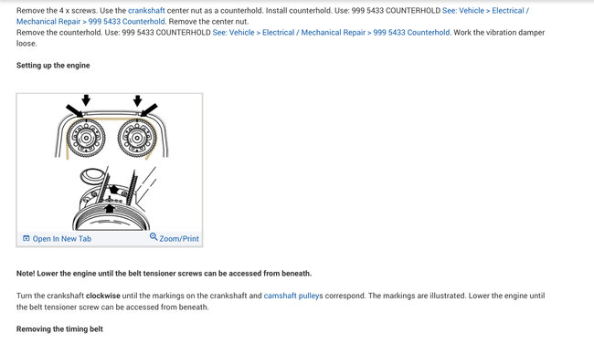

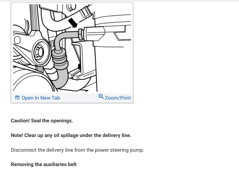

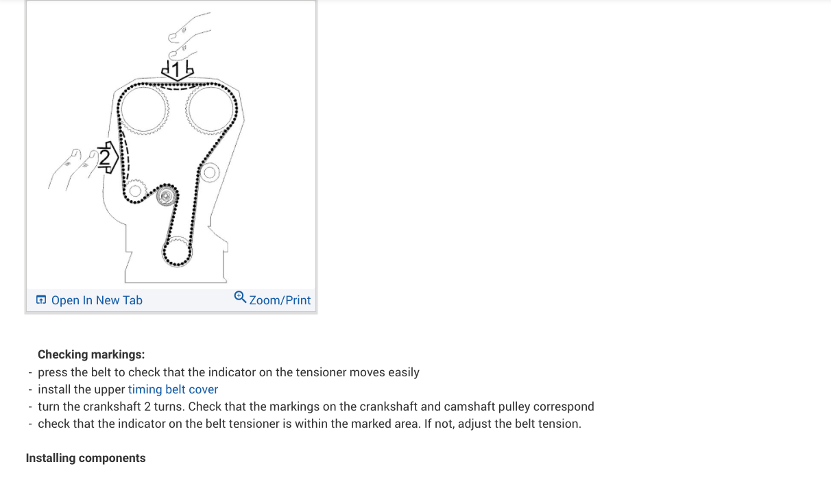

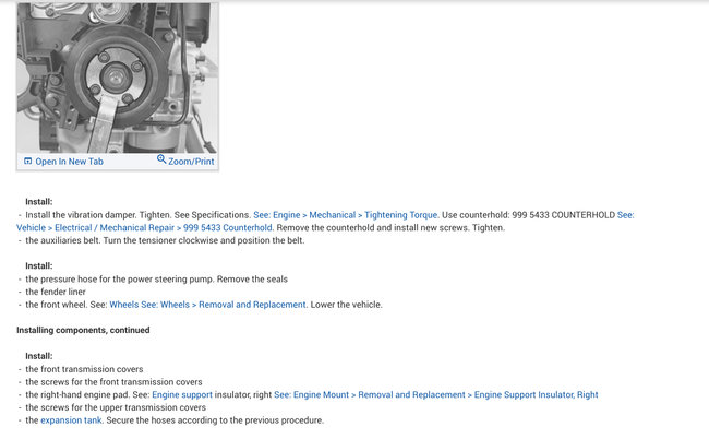

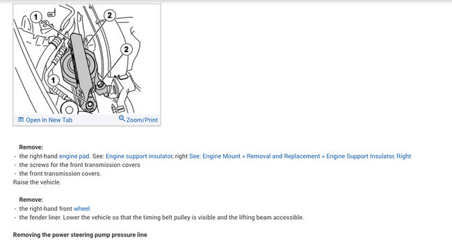

SCGRANTURISMO
  • 4,897 POSTS
Hello again,

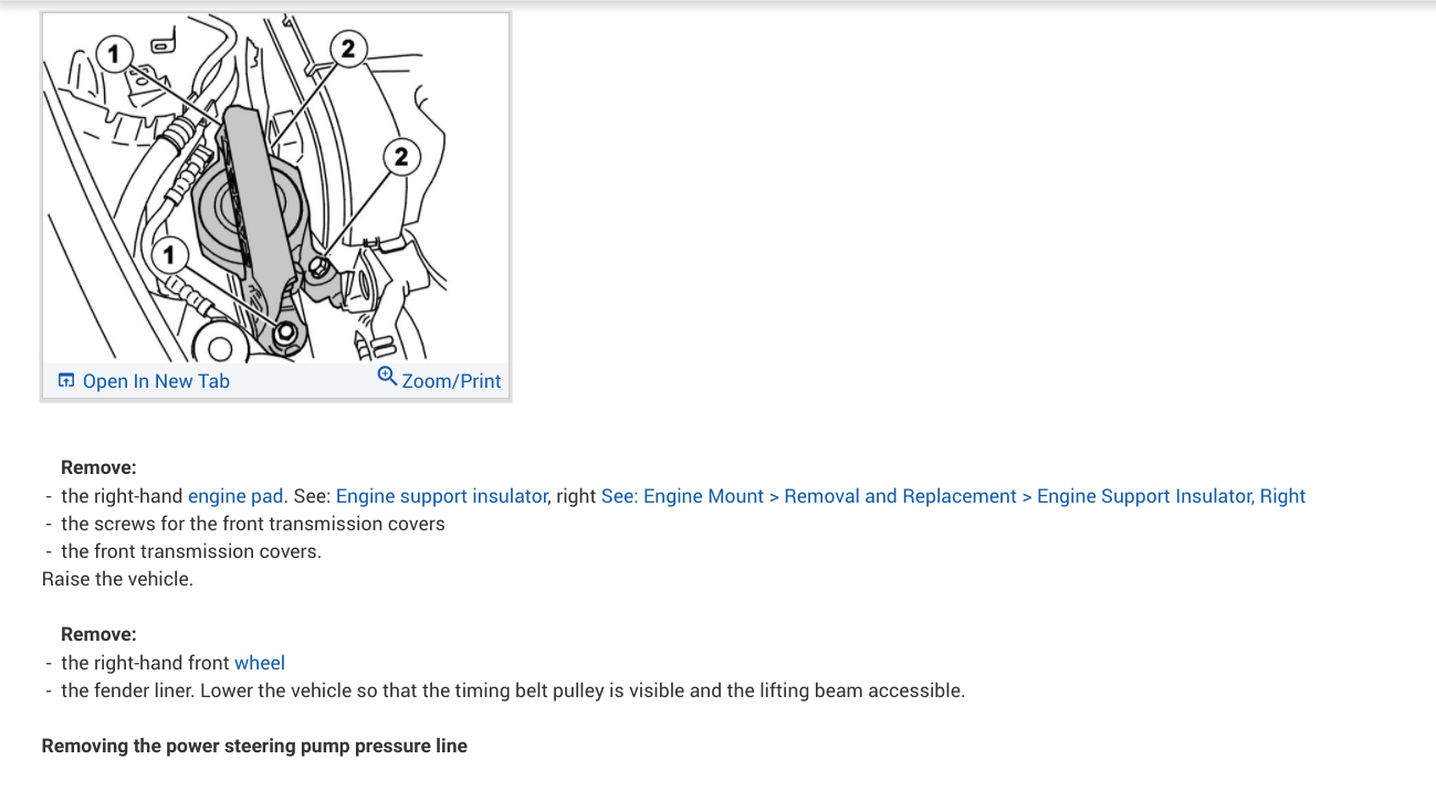

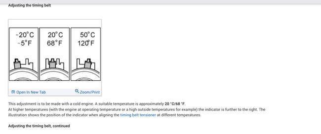

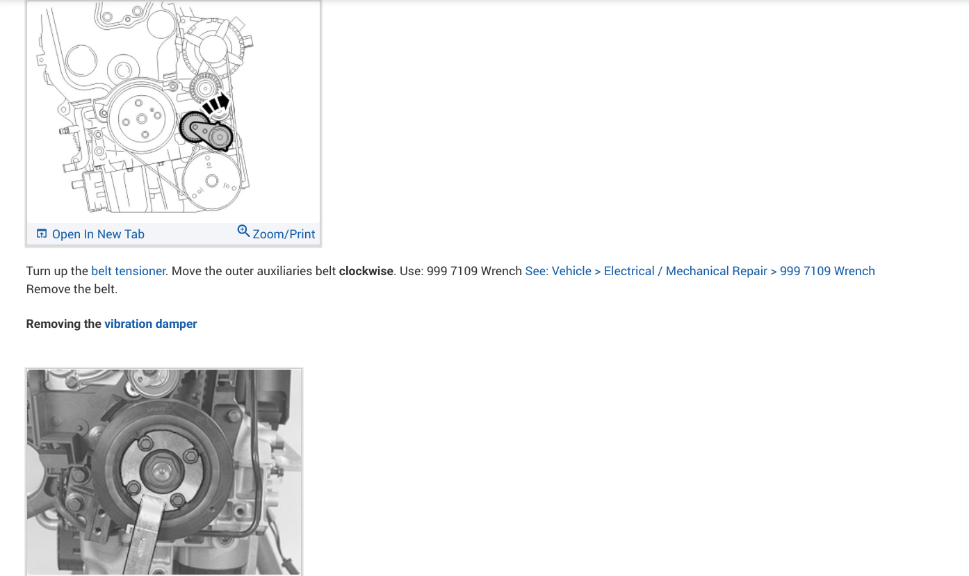

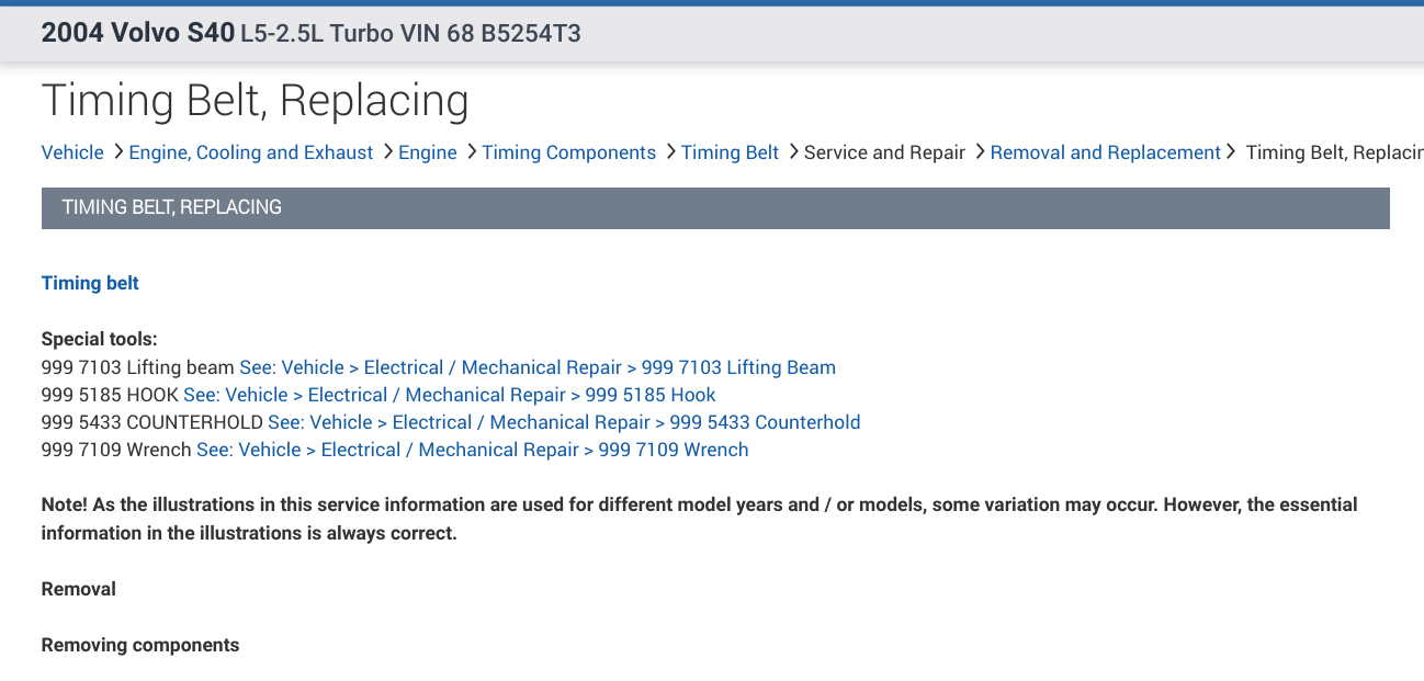

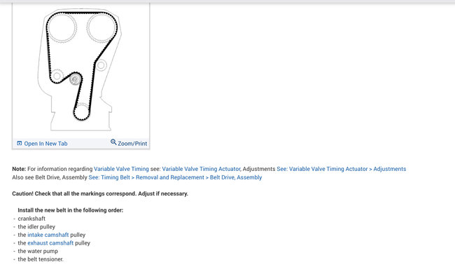

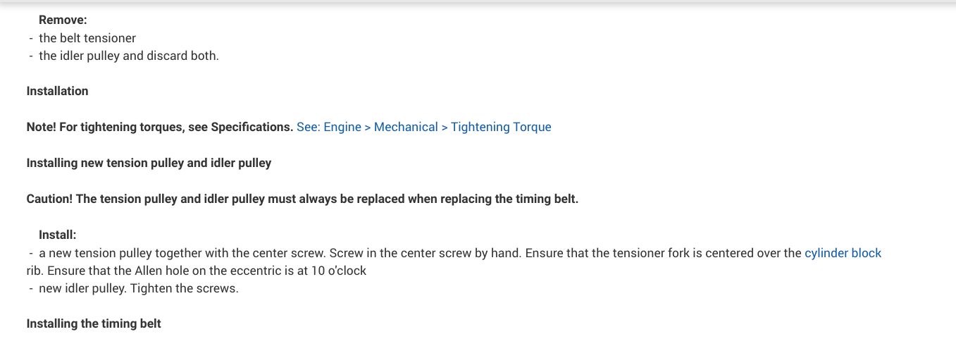

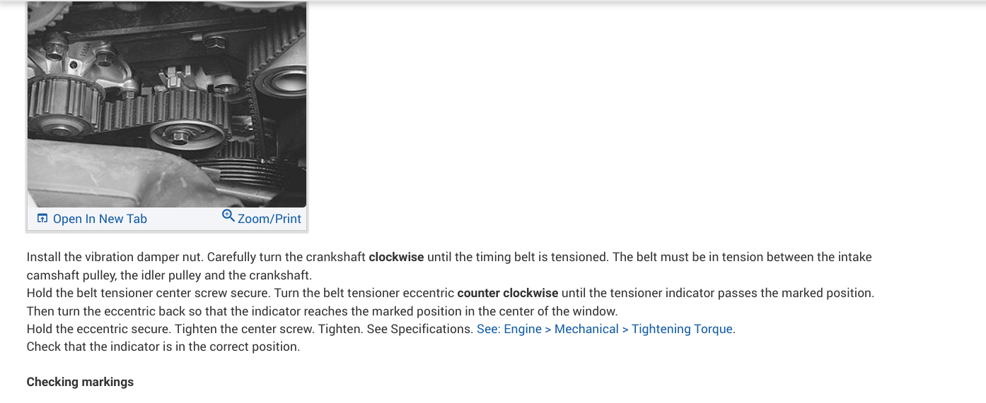

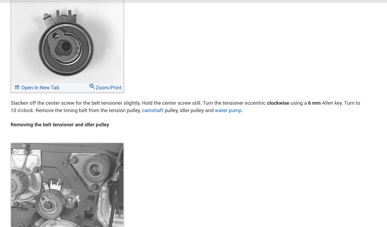

Okay, so in the diagrams down below I have included the instructions for the removal, installation, and adjustments for the timing belt for your vehicle from the vehicle manufacturer. Please go through this guide from the vehicle manufacturer and get back to us with how everything turns out. I hope that this helps. Happy Holidays.
Thanks,
Alex
2CarPros

ENGINEERINGDAD
  • 35 POSTS
Doesn't help me on the present issue of: "If timing belt jump crankshaft gear a couple notches" what to do next, to get everything back to a normal alignment? the images you've sent I've already done during last year's timing belt job and everything lined up. I just failed to install a new timing belt tensioner at that time and that's why the belt jumped in the present.

SCGRANTURISMO
  • 4,897 POSTS
Hello again,
The only way to be certain that your timing marks line as they should is to reset everything and go from there. The timing marks will never line up again once the engine has been rotated even one revolution. This is the only way that you can ensure that that timing is correct.
