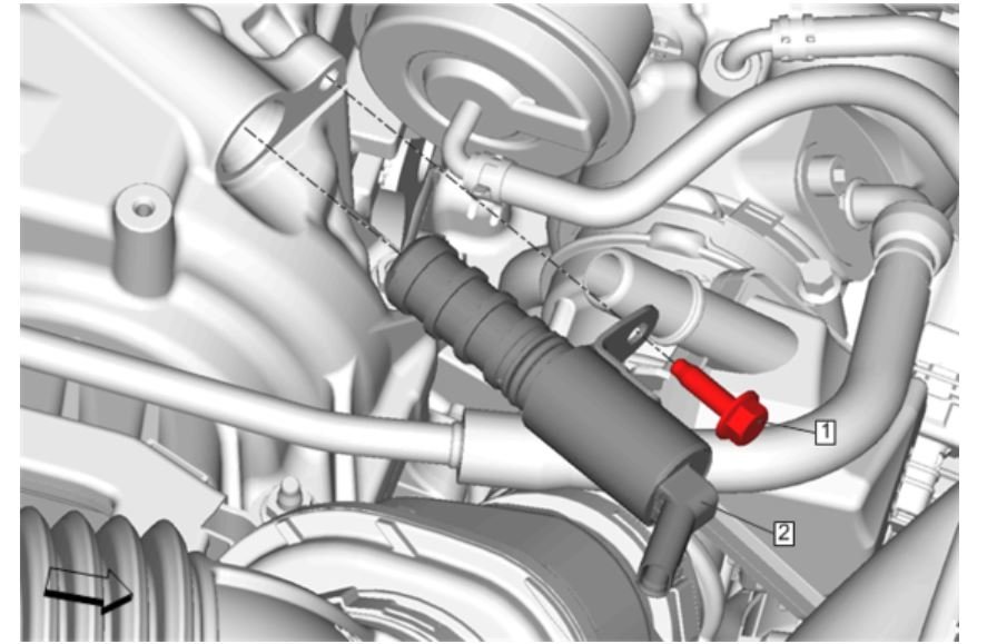

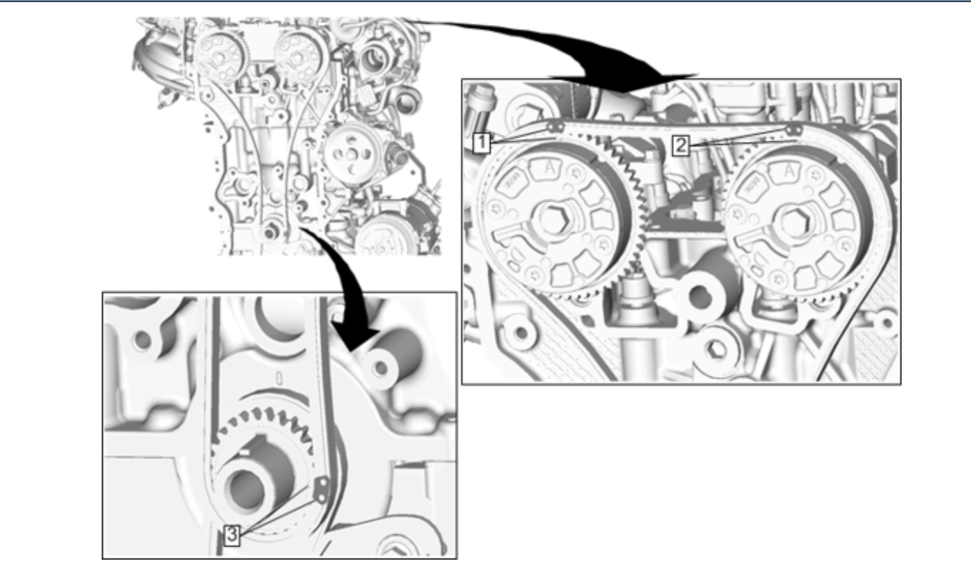

I had a burnt valves dude to overheating. I replaced valves. At first the car would start it kept flooding the engine (has) I went back in and noticed the sprockets on cams where not flush correctly . After I corrected this issue I checked all timing marks made sure all is well. I drove the vehicle turned on fine. After a few miles I parked and started the car again . It gave me timing codes p0014 and p0017 .

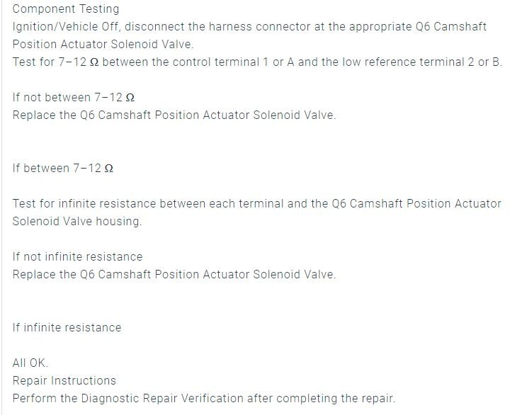

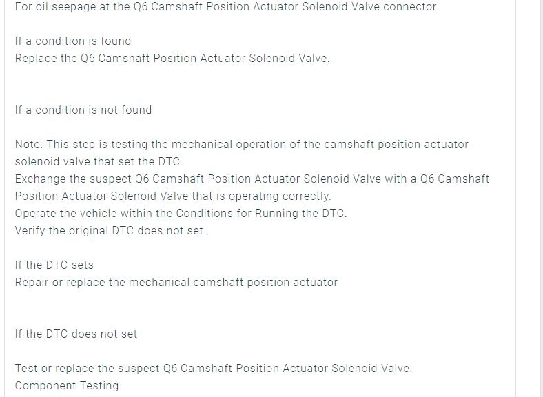

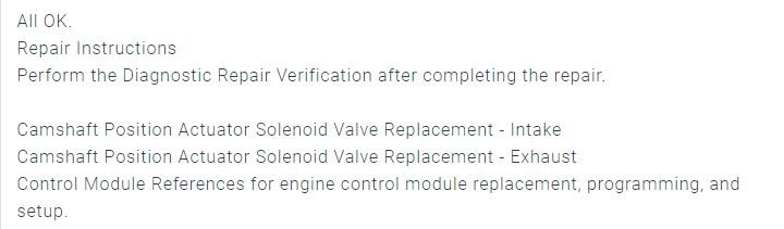

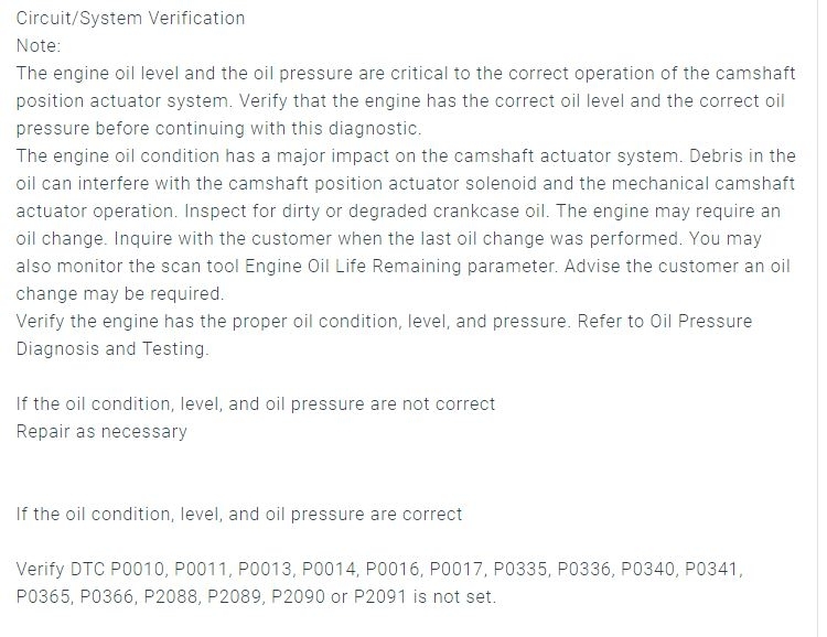

Good morning,

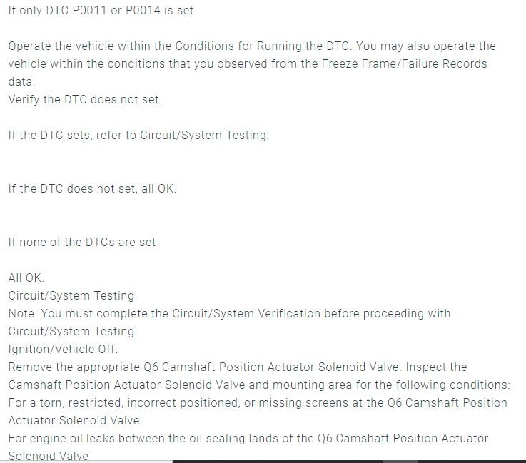

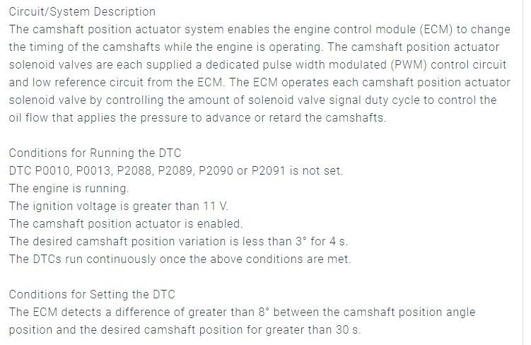

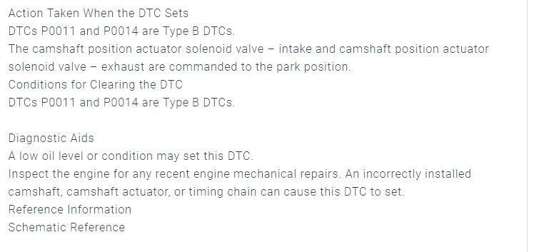

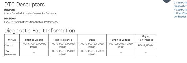

I attached the information for this.

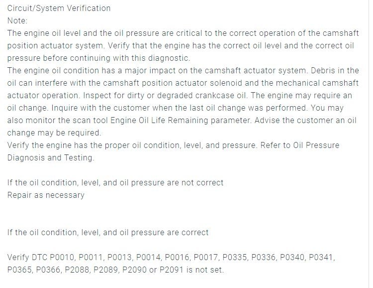

Did you flush the oil system of all dirt and debris? This is the most common issue for these codes along with the timing marks being incorrect.
I would suspect the solenoids could be the issue but needs to be confirmed. They get sludged up internally and will not allow oil flow for the timing adjustment.
Do you have a scan tool that can activate the solenoids so you can verify the timing change? If the ECM does not see the timing change, this is the resulting codes that will be set.

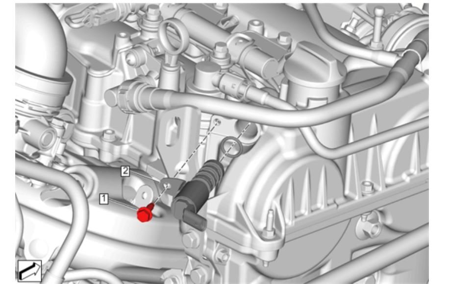

Cleaned oil and installed new cam solenoids, drive a bit better but codes came back up. P00014 and p00017 Keeps telling me the exhaust cam is too advanced . And no in sync with crank. I have a feeling i need to go back into my engine and check timing again. I’ve set the timing more than twice now. Should I just replace the chain and sprockets ? I have a feeling it’s jumping . Idle is not rough but it’s beginning to shake a bit more. Spending gas like crazy.
Jul 4, 2020 at 7:33 AM
Okay, did you replace the chain at any time?
You do not just adjust the timing of the chain. It will require replacing the chain, guides and the tension er.

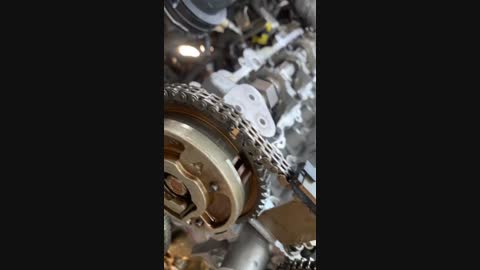

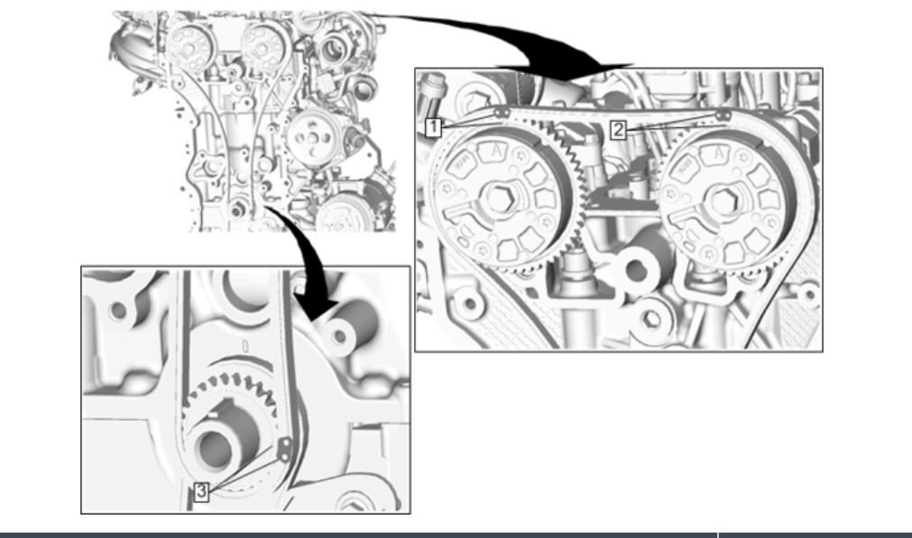

JAYCHAVEZ
  • 7 POSTS

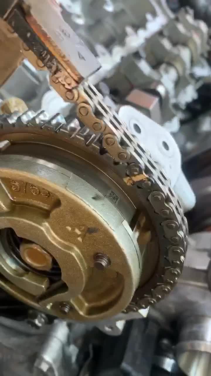

Hello . I’m back so I removed the timing cover again . Before I did anything I rotated my engine by hand . Went to find TDC and all my marks align at 12 o'clock. Now again I was recently getting codes P0014 and P0017. Could it be the actual phaser on my exhaust cam that could be getting stuck ?
Jul 10, 2020 at 12:59 AM
Yes, it can. Oil contamination is a common cause of this. Flushing the oil system with a pressurized cleaning agent is recommended before replacing the solenoid and phaser. You could contaminate the replacement parts if you do not flush the system.

I just drained oil . I already purchased phaser and new chain tensioner. Since I see the timing all aligning . I’m just concerned that chain isn’t jumping a tooth but phaser is getting stuck . Exhaust cam saying is too advanced.
Jul 10, 2020 at 1:33 AM
I would have the system flushed correctly and then hope the solenoid and actuators are still good.
