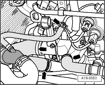

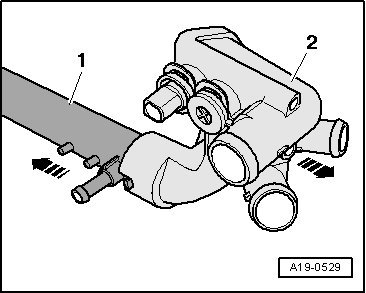

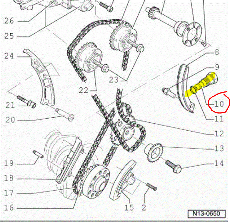

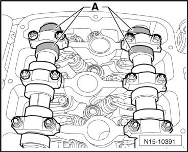

Are you referring to the camshaft chain tensioner? See pic 1. I have to be honest, if you are replacing a tensioner, I feel it needs to be taken apart. However, I believe the tensioner is exposed. My biggest concern is if VVT is changed, but as long as the chain doesn't move, it shouldn't change. You just won't be able to see it.

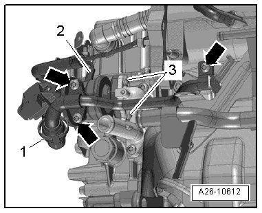

- Disconnect coolant hoses at positions indicated by - arrows -.
pic 3

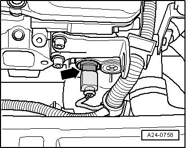

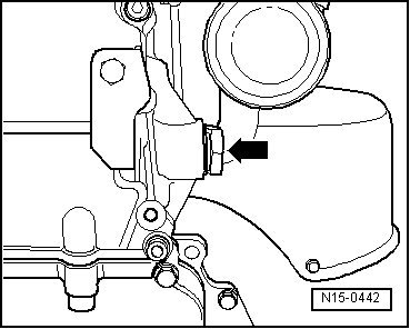

- Remove the bolts - arrows -.
pic 4

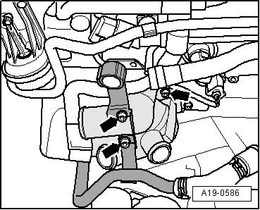

- Remove bolt - arrow - at wiring harness bracket.
pic 5

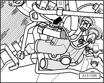

Press coolant pipe in direction of coolant pump using pry bar when removing coolant thermostat housing so that is not pulled off.
- Remove coolant thermostat housing - 2 - while pressing coolant pipe - 1 - toward coolant pump with pry bar.
pic 6

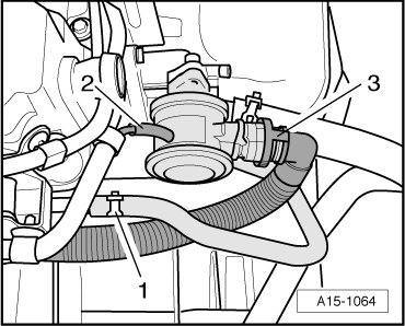

Vehicles with engine code BUB:
- Disconnect the hose - 3 - and the vacuum hose - 2 - from the Secondary Air Injection (AIR) combination valve.
pic 7
- Disconnect coolant hose - 1 -.

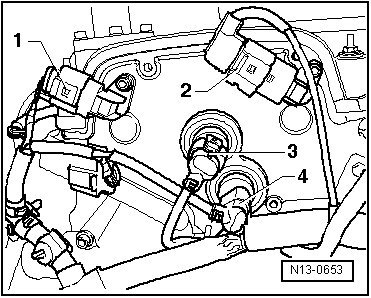

- Identify and disconnect electrical connectors:
pic 9
1. Camshaft position sensor (G40)
2. Camshaft position (CMP) sensor 2 (G163)
3. Camshaft adjustment valve 1 (N205)
4. Camshaft adjustment valve 1 (exhaust) (N318)

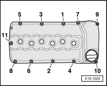

- Loosen cylinder head cover bolts in sequence - 11 to 1 -.
pic 10

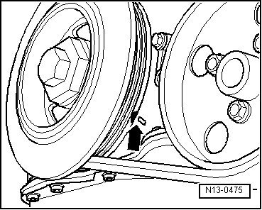

- Set crankshaft to TDC mark by turning crankshaft on vibration damper screw in direction of engine rotation - arrow -.
pic 11

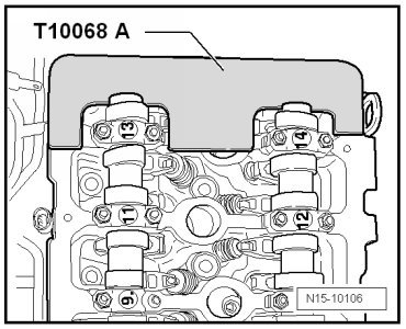

- Cams - A - of cylinder 1 must face each other.
pic 12
- At the same time, (T10068 A) must engage in both shaft grooves. Turn crankshaft 1 additional turn if necessary.

- Remove camshaft timing chain tensioner - arrow -.
pic 14
