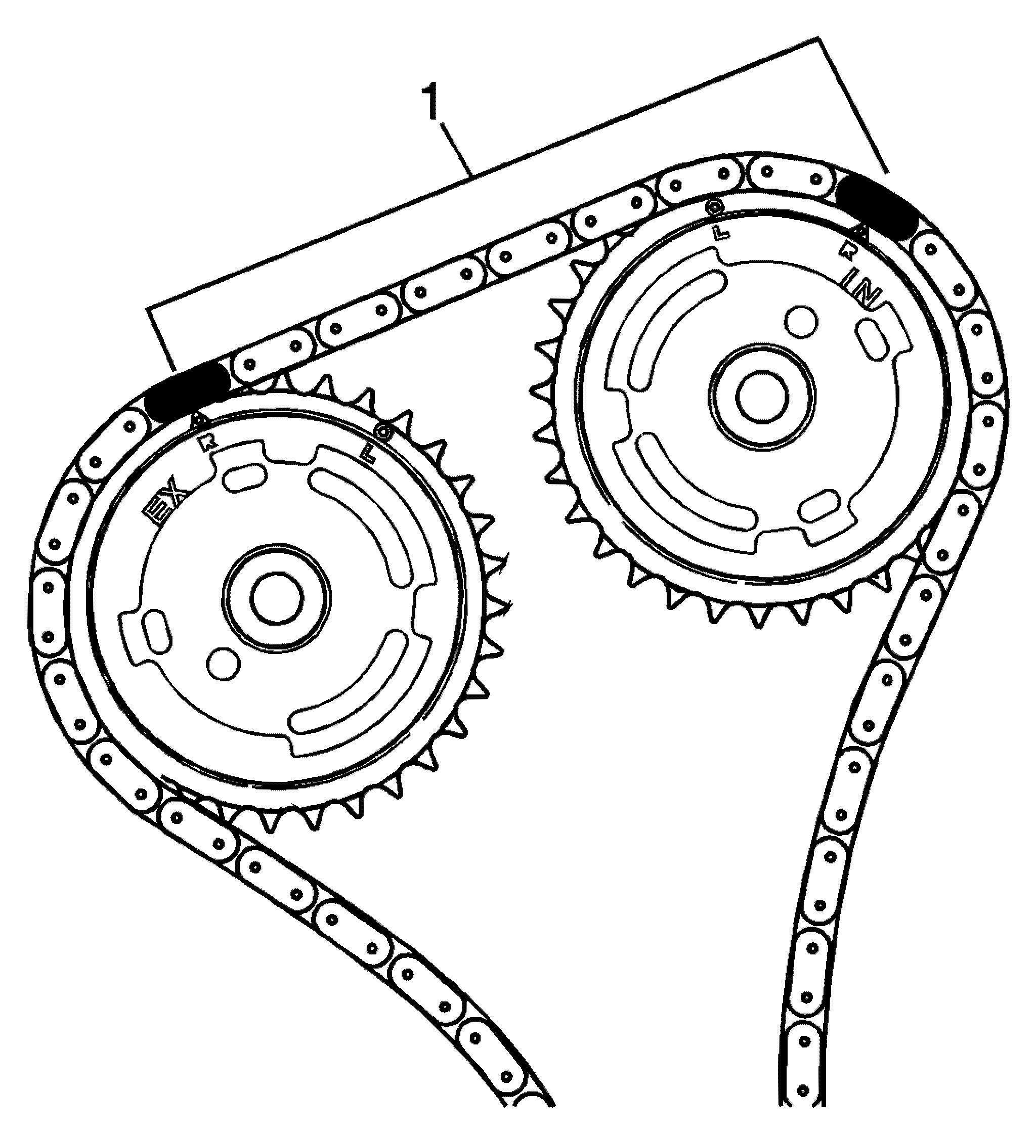

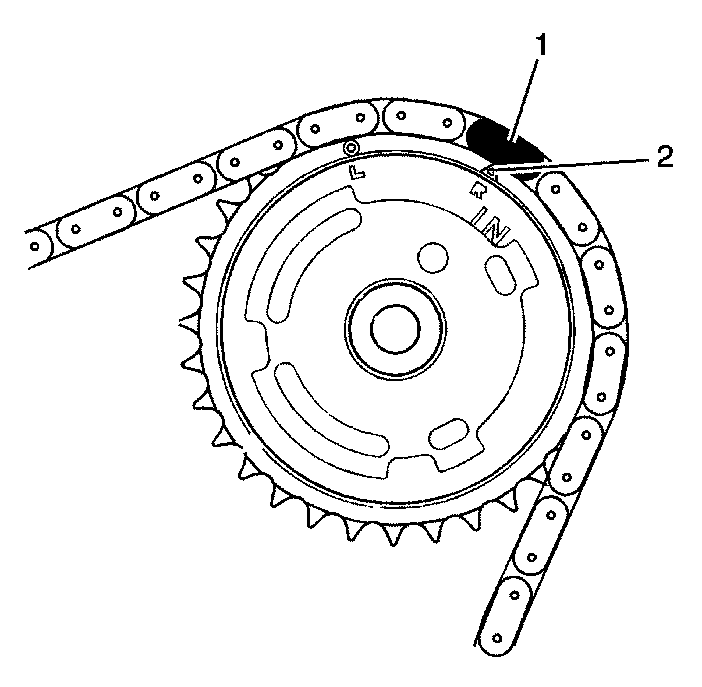

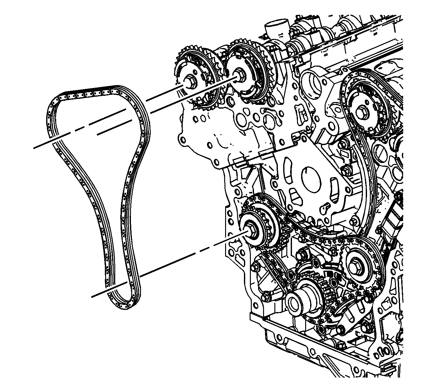

I have a timing chain issue on the right side as sitting in the vehicle. I ordered the kit and replaced tensioners, chains and most of the sprockets. I lined up the TDC mark and aligned the cam and such as the video showed. Now I am turning it by hand and the marks no longer line up on the cams properly. I have turned it several times and at no point is it correct anymore. Start all over again and same thing.

As long as it was correct when you installed it, you will be fine. The sprockets are different sizes so for them to align again can take a ton of turns.
If you provide me with the engine size, I can provide the directions so you can reconfirm you did it correctly.

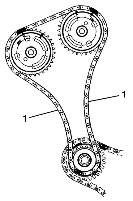

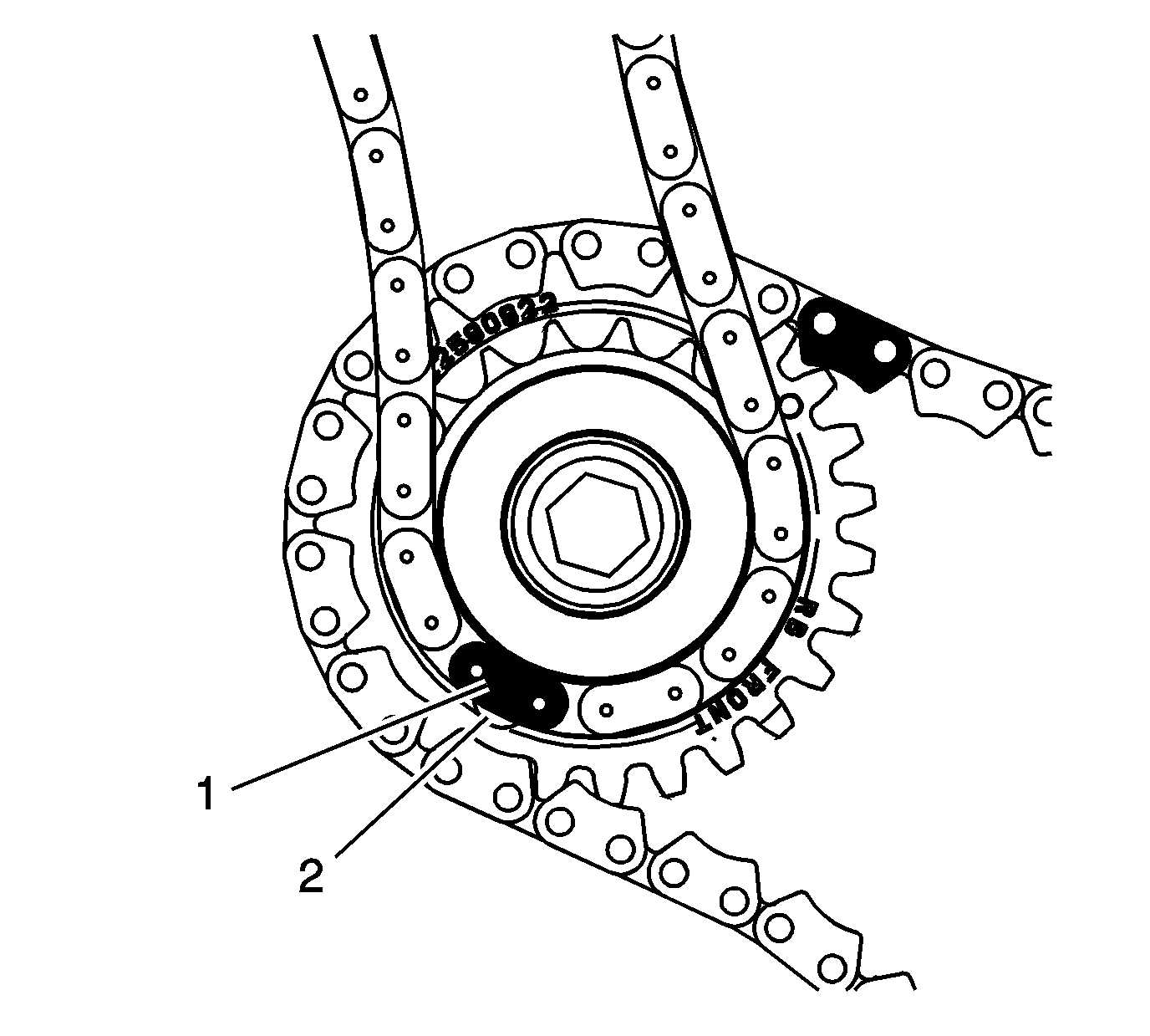

1. Ensure that the crankshaft is in the stage 2 timing drive assembly position (1).
pic 2
2. Install the right secondary camshaft drive chain.
pic 3

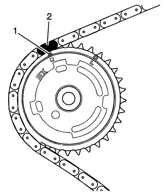

3. Place the secondary camshaft drive chain around the right camshaft intermediate drive chain idler outer sprocket, aligning the timing camshaft drive chain link (1) with the alignment access hole (2) made in the right camshaft intermediate drive chain idler inner sprocket.

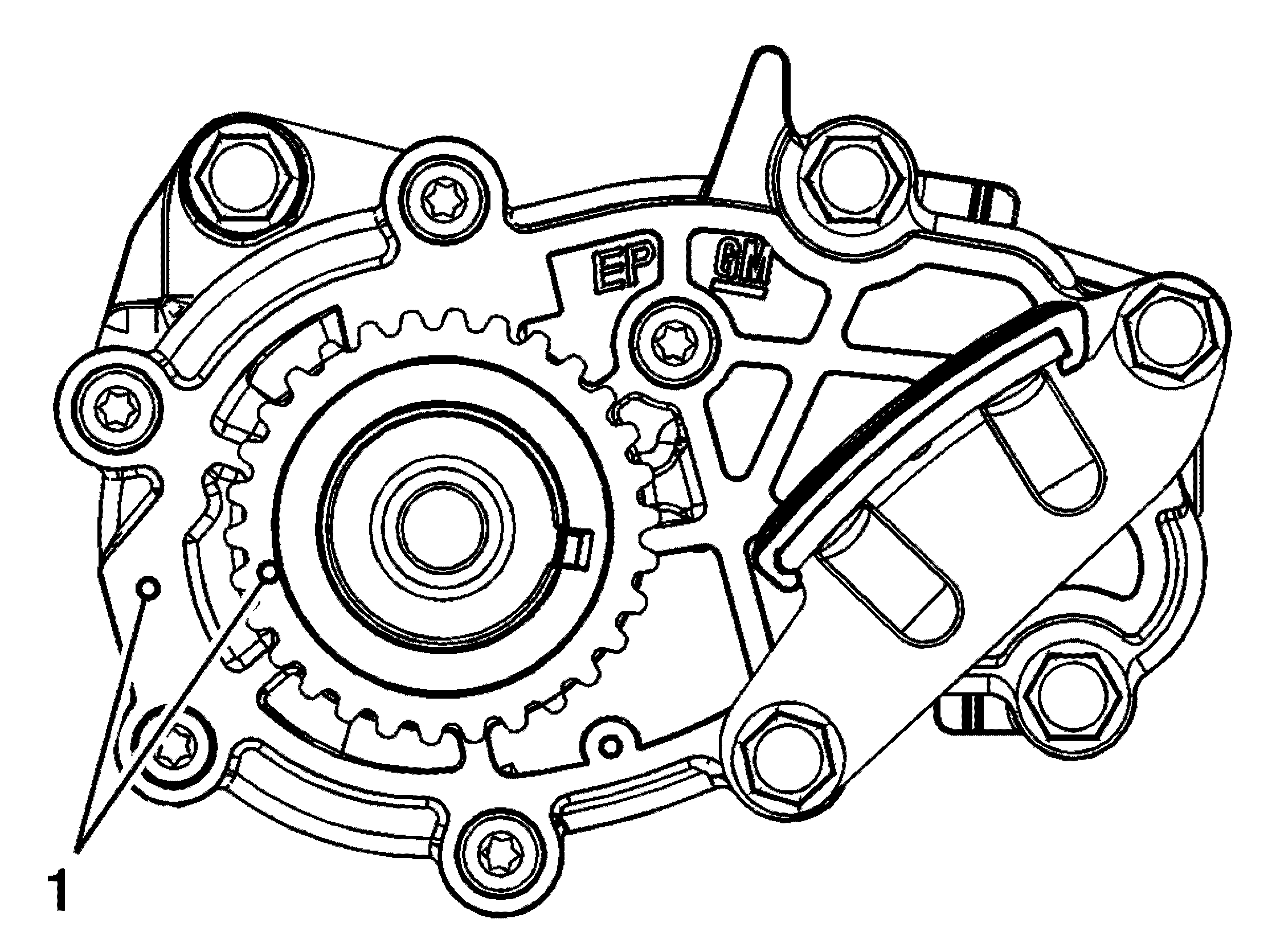

4. Wrap the secondary camshaft drive chain around both right actuator drive sprockets.
5. Ensure there are 7 links (1) between the timing camshaft drive chain links for the camshaft position actuator sprockets.
pic 5

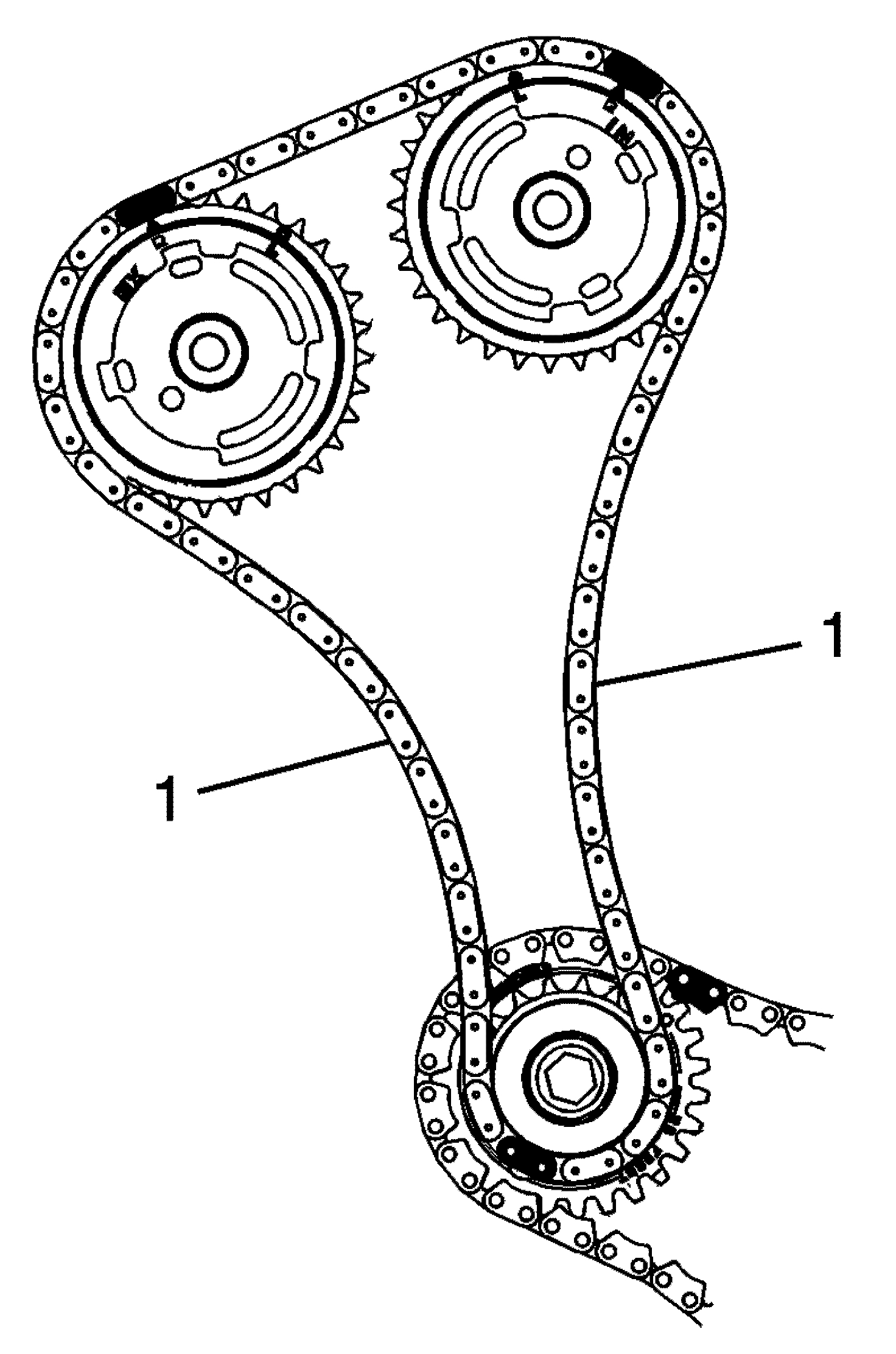

6. Align the right exhaust camshaft position actuator sprocket alignment triangle mark (1) with the timing camshaft drive chain link (2).
pic 6
7. Align the right intake camshaft position actuator sprocket alignment triangle mark (2) with the timing camshaft drive chain link (1).
pic 7
8. There will be 18 links (1) between the right camshaft intermediate drive chain idler timing camshaft drive chain link and each right camshaft position actuator sprocket timing camshaft drive chain link.

While looking through the manual to find this, I came across something that may put your mind at ease. Read this.
Even when only one sprocket is involved, multiple crankshaft rotations will not produce conditions where correct timing can be confirmed.
_____________________________________
As long as you had it right from the start, you should be fine.

Okay, I did everything just as described in the instructions to a T double and triple checked it all. Just out of curiosity before I got it all together ie I had the front cover back on and sensors and such plugged in but decided to compression check it and no compression on any cylinders. My first thought is that my crank was 180 out but with the L and R alignments it would not be possible? Any thoughts?
Sep 17, 2020 at 5:47 AM
  • 110,240 POSTS
This is an interference engine. Was the engine running when the chain failed?
