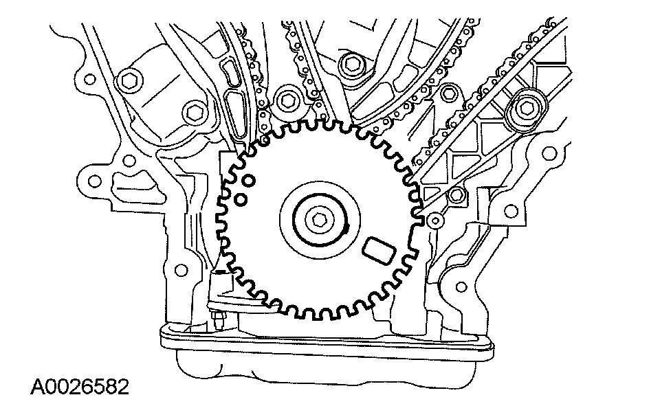

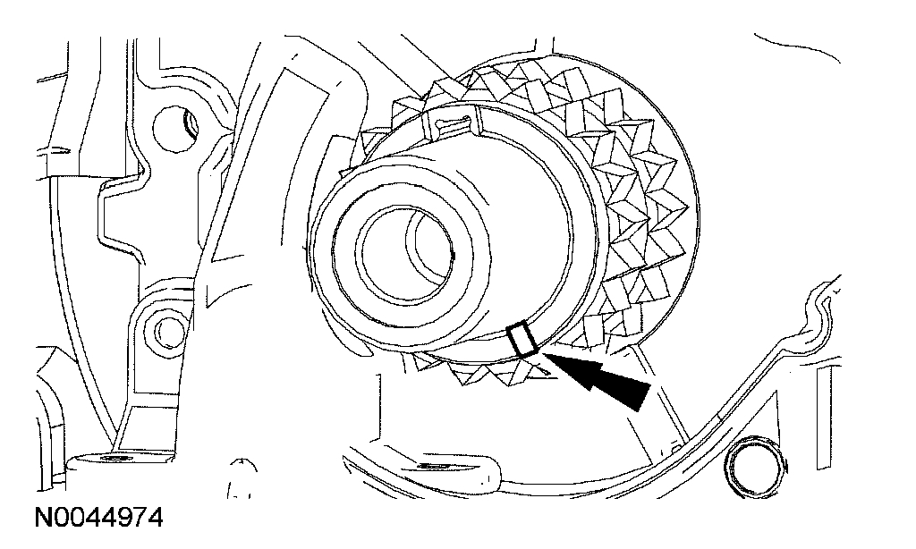

1. Remove the engine front cover.

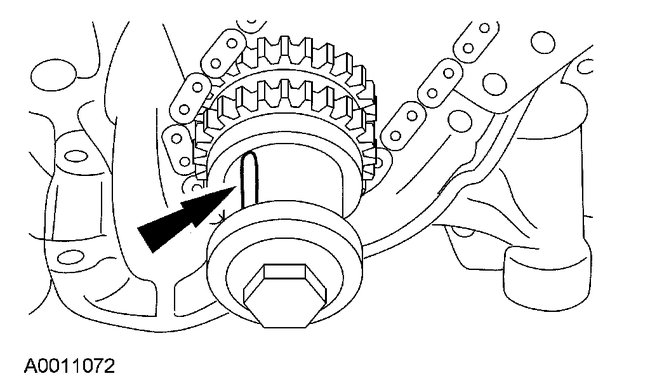

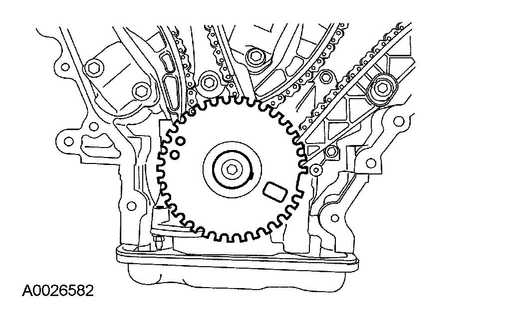

2. CAUTION: This pulse wheel is used in several different engines. Install the pulse wheel with the keyway in the slot stamped "30RFF" (orange in color).
pic 1
Remove the ignition pulse wheel.
pic 2

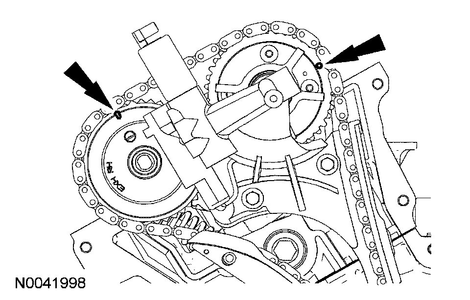

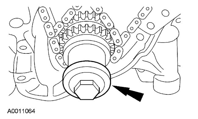

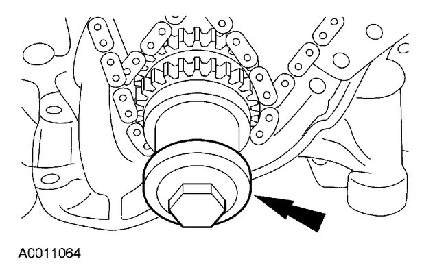

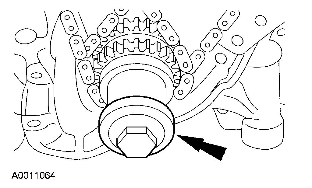

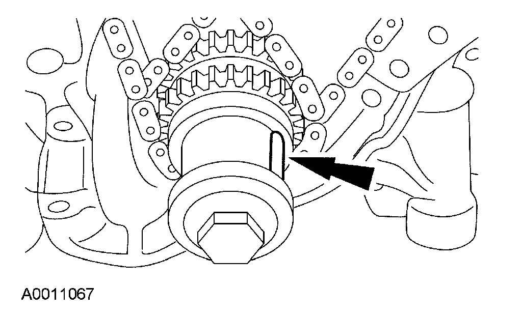

3. Install the crankshaft pulley bolt and washer.
pic 3

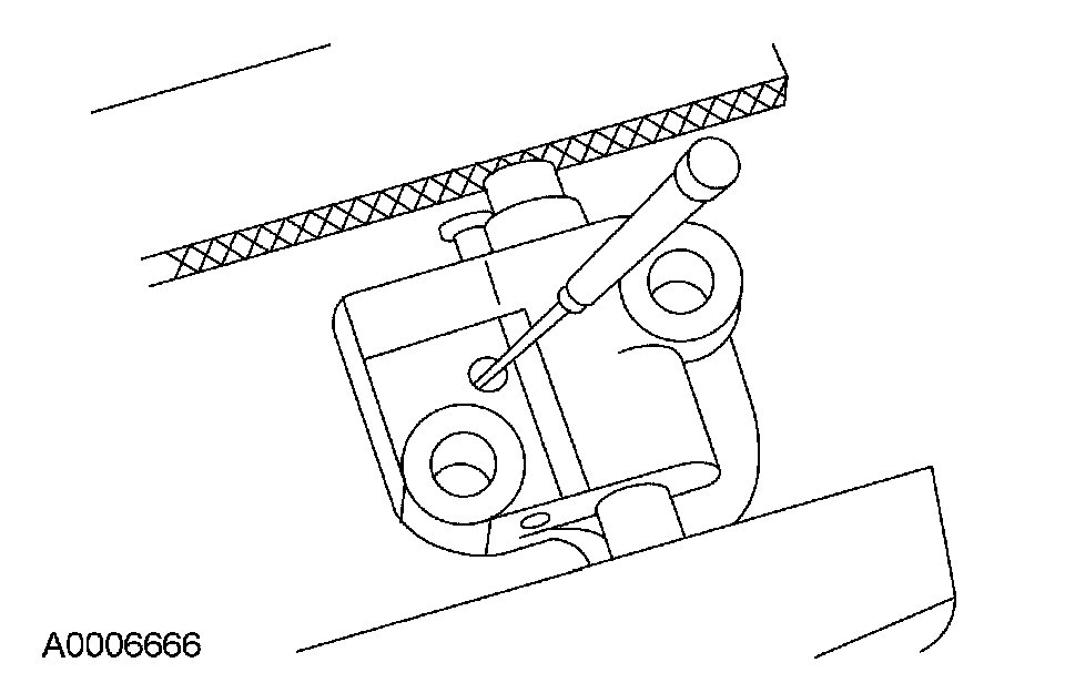

4. NOTICE: Only use hand tools when removing or installing the spark plugs or damage can occur to the cylinder head or spark plug,
NOTE: Use compressed air to remove any foreign material in the spark plug well before removing the spark plugs.
Remove the 6 spark plugs.
pic 4

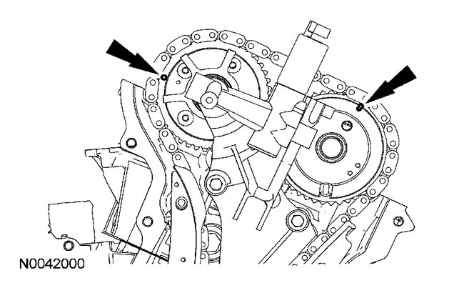

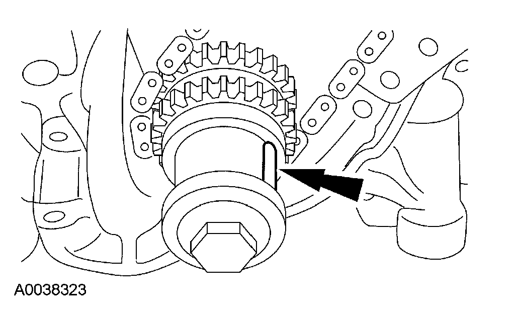

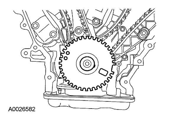

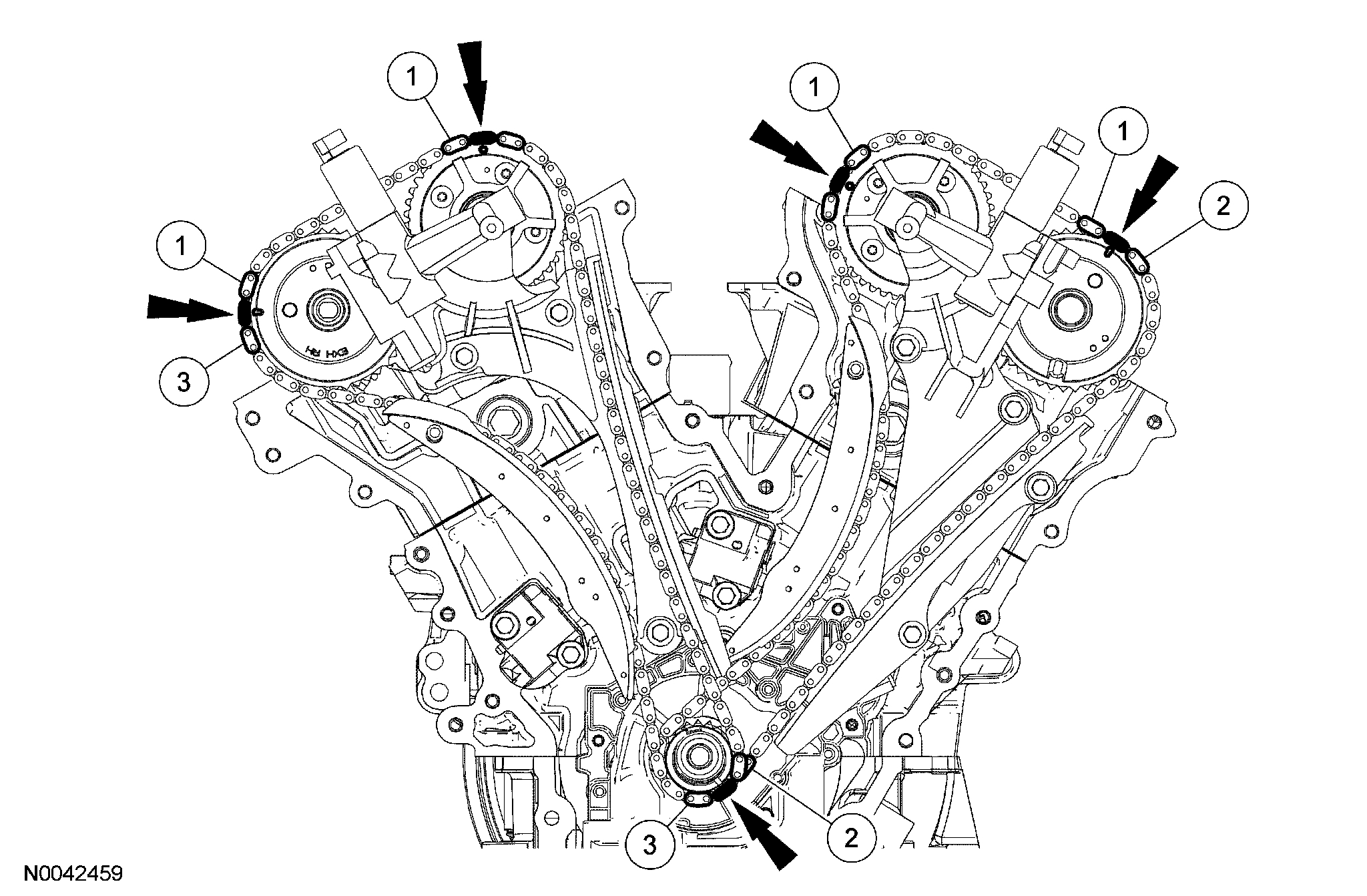

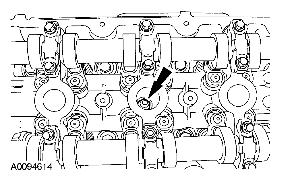

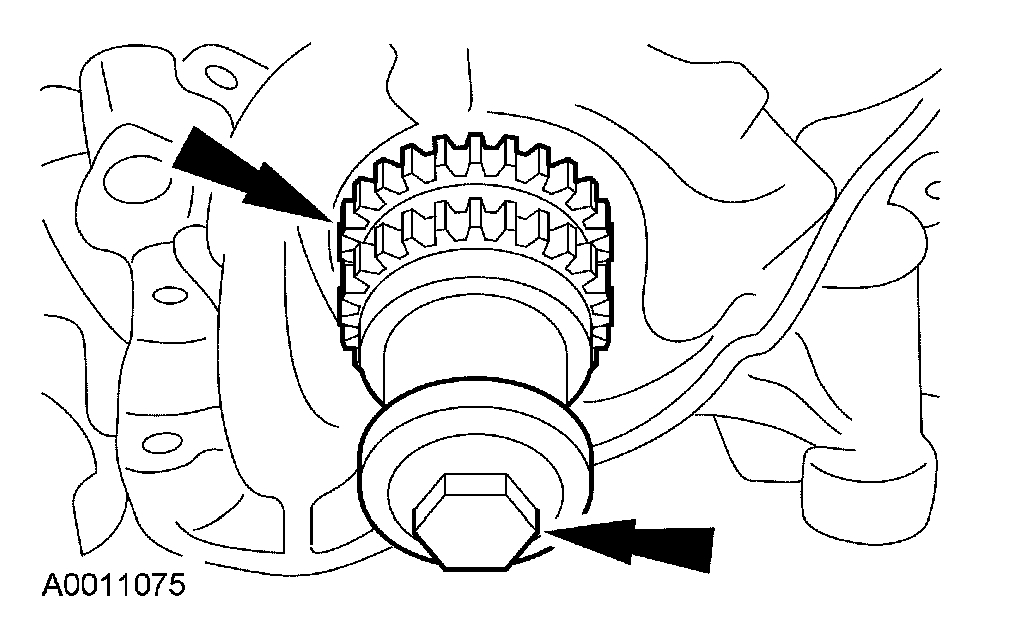

5. Rotate the crankshaft clockwise to position the crankshaft keyway in the 11 o'clock position and position the camshafts in the correct position. This will position the No. 1 cylinder at top dead center (TDC).
^ Verify that the camshafts are correctly located. If not, rotate the crankshaft one additional turn and recheck.
pic 5

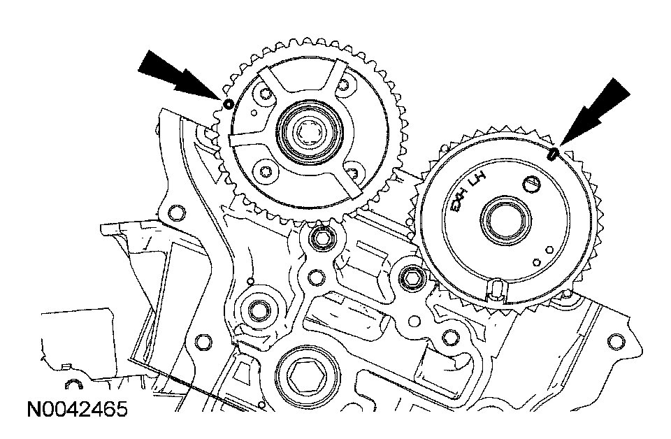

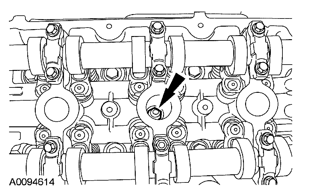

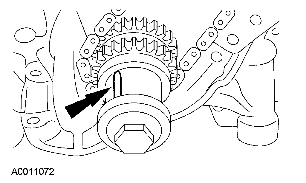

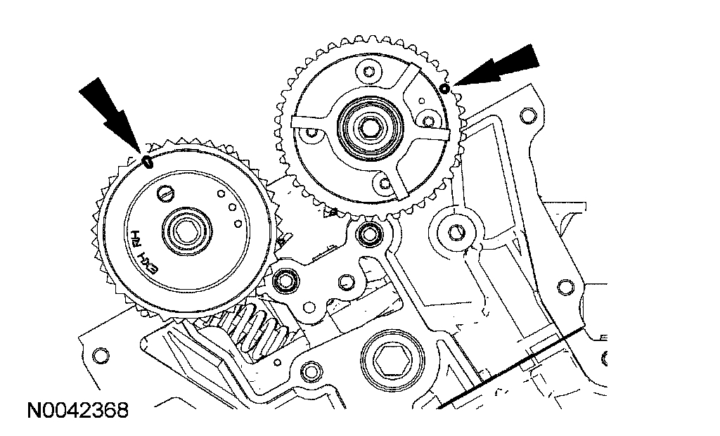

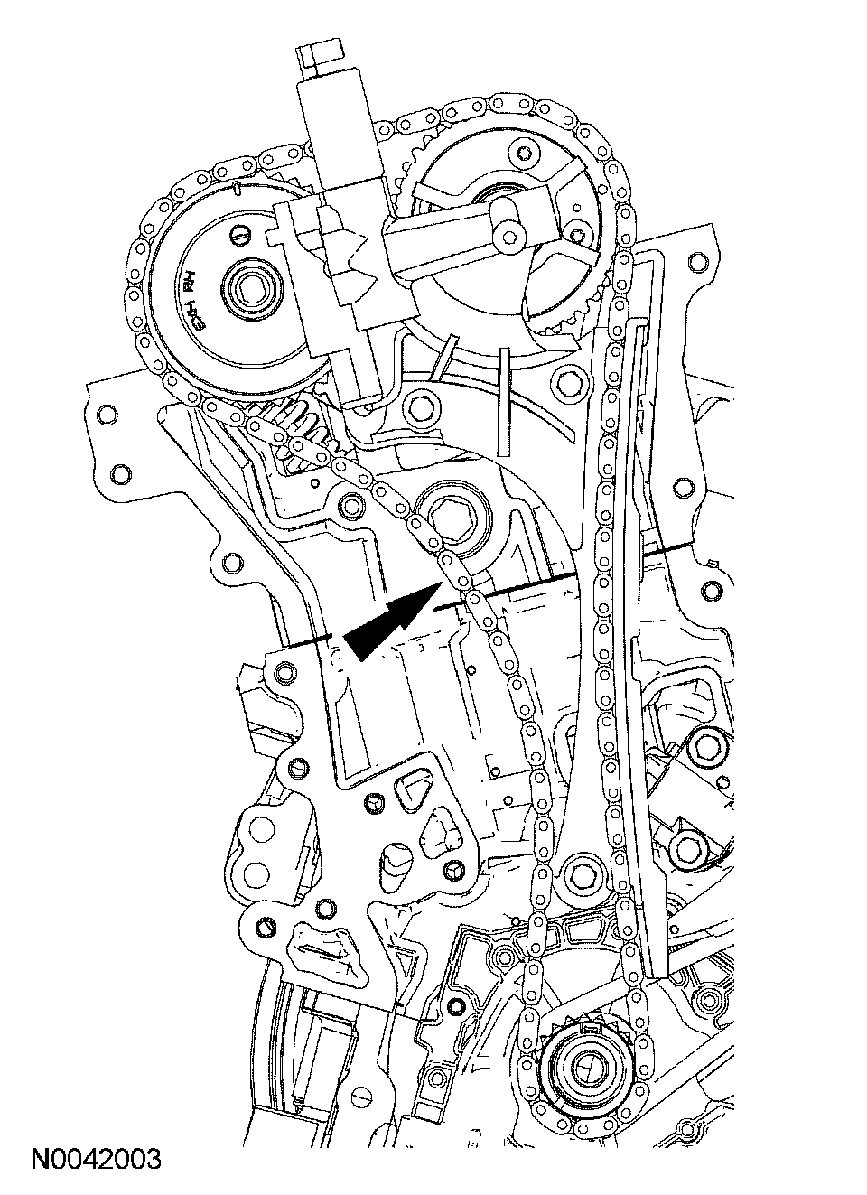

6. Rotate the crankshaft clockwise 120 degrees to the 3 o'clock position to position the RH camshafts in the neutral position.
pic 6
7. Verify that the RH camshafts are in the neutral position.
pic 7

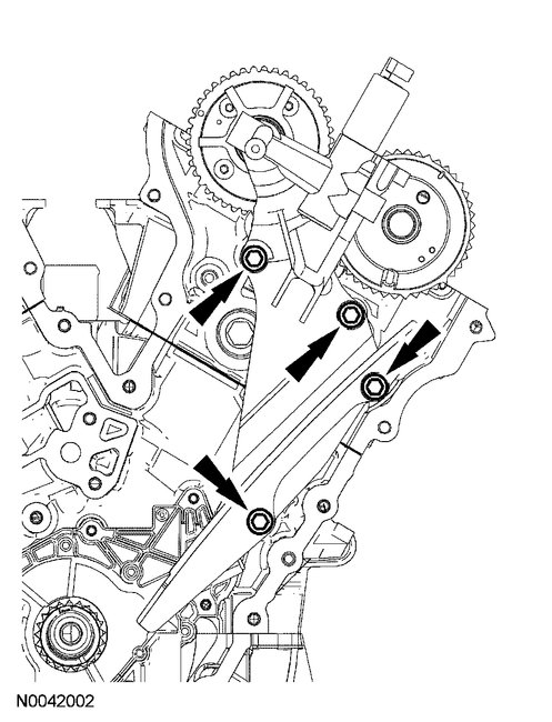

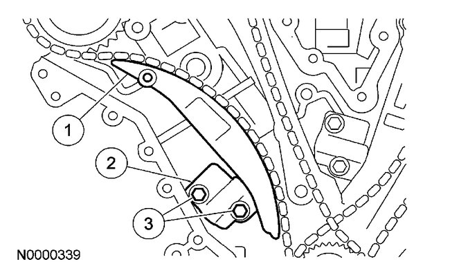

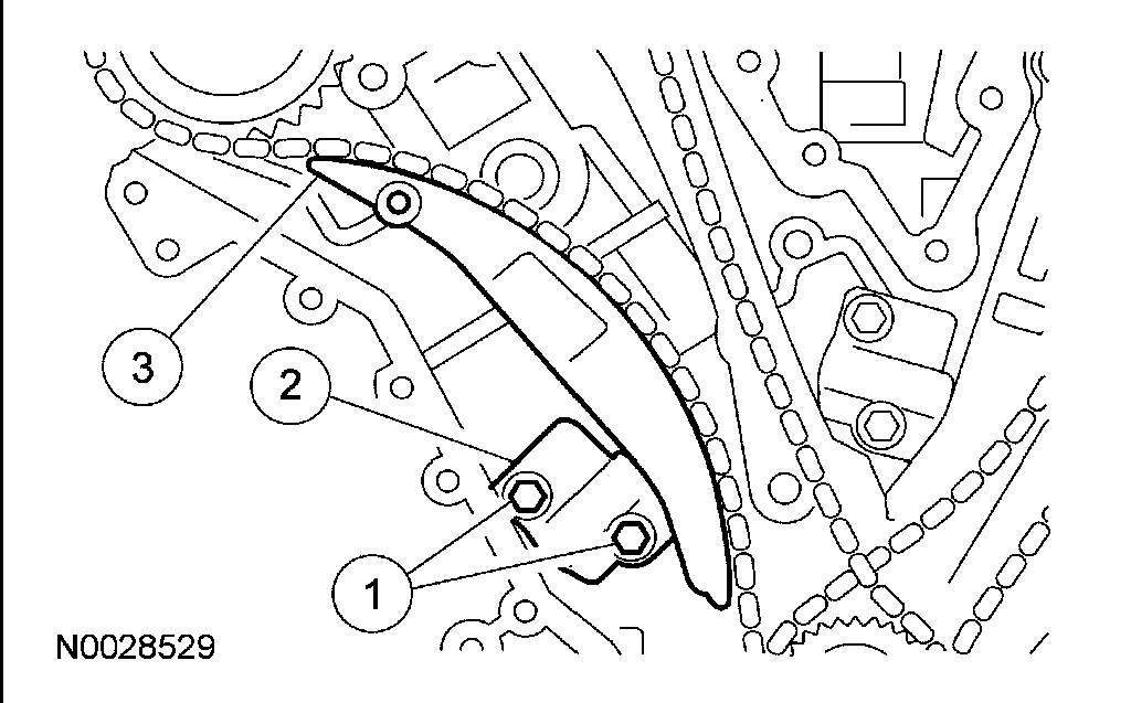

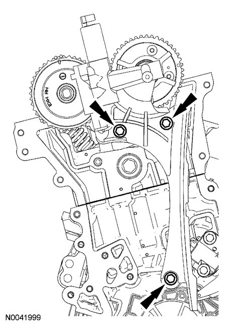

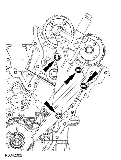

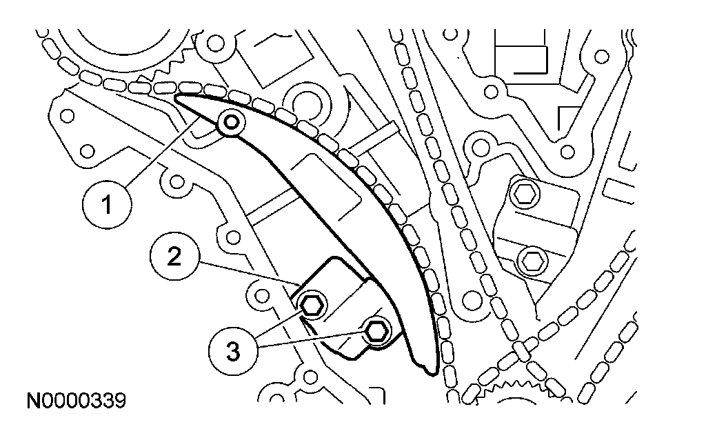

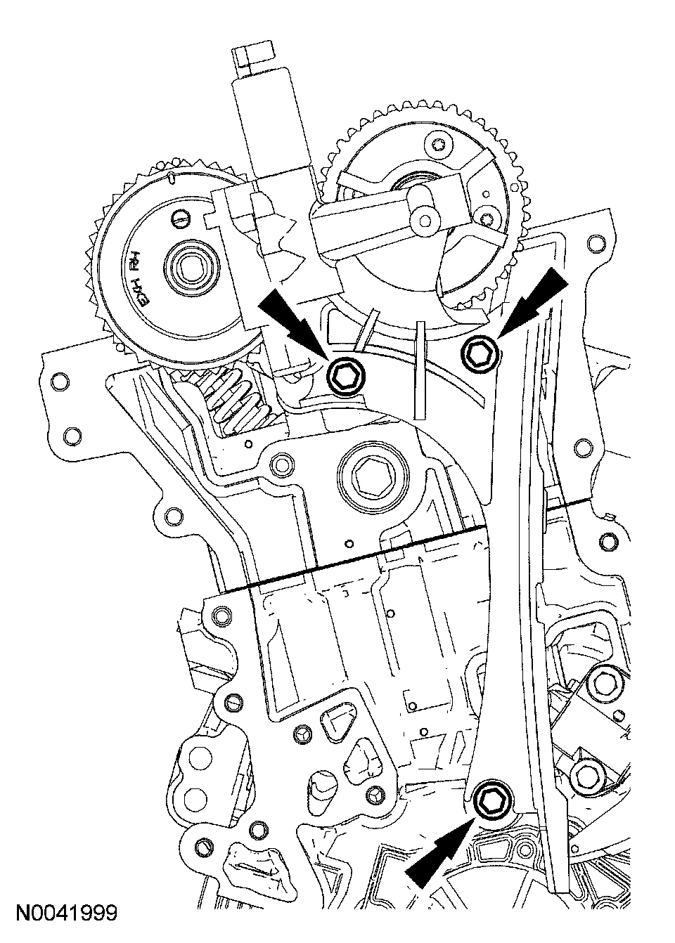

8. Remove the RH timing chain tensioner arm.
1 Remove the 2 bolts.
2 Remove the tensioner.
3 Remove the tensioner arm.
pic 8

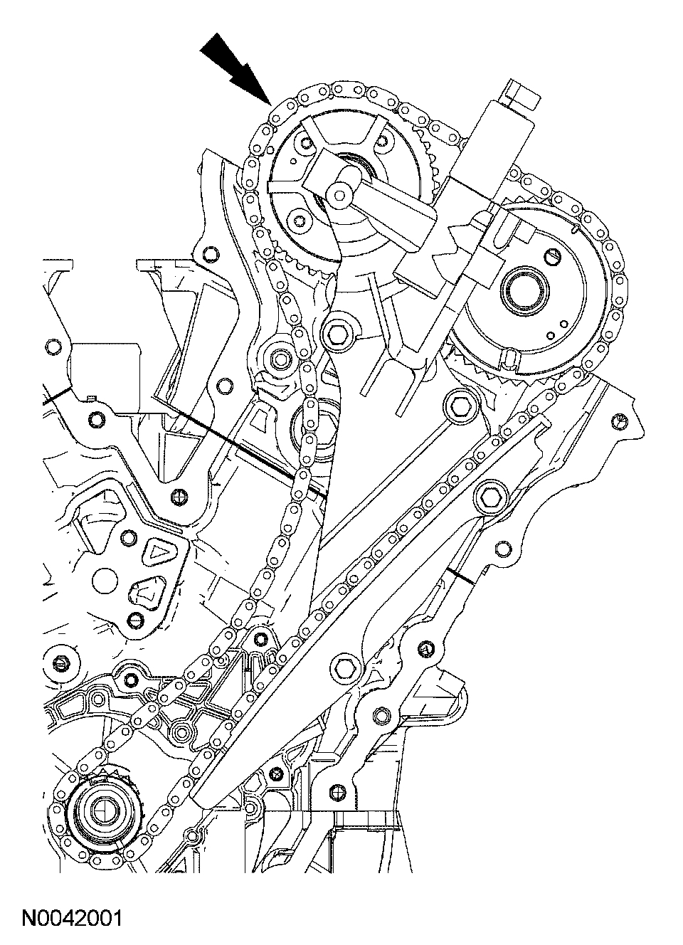

9. Remove the RH timing chain.
pic 9

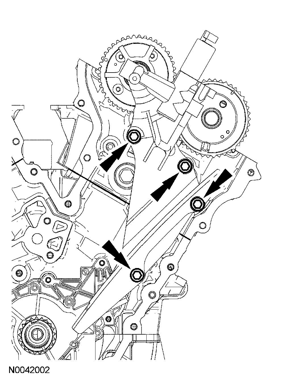

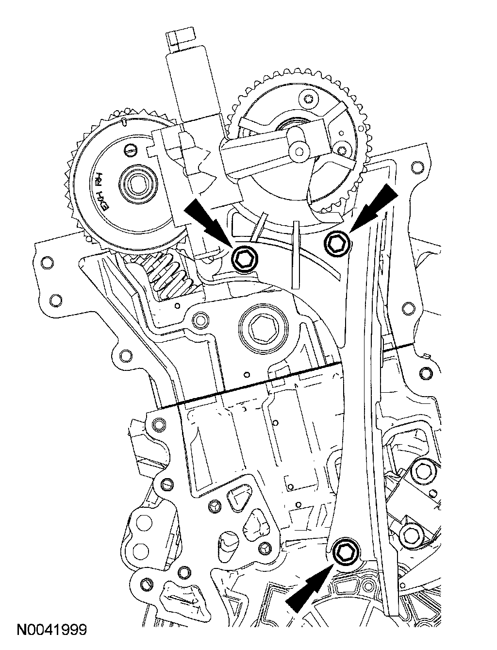

10. Remove the 3 bolts and the RH VCT assembly.
pic 10

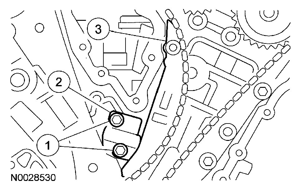

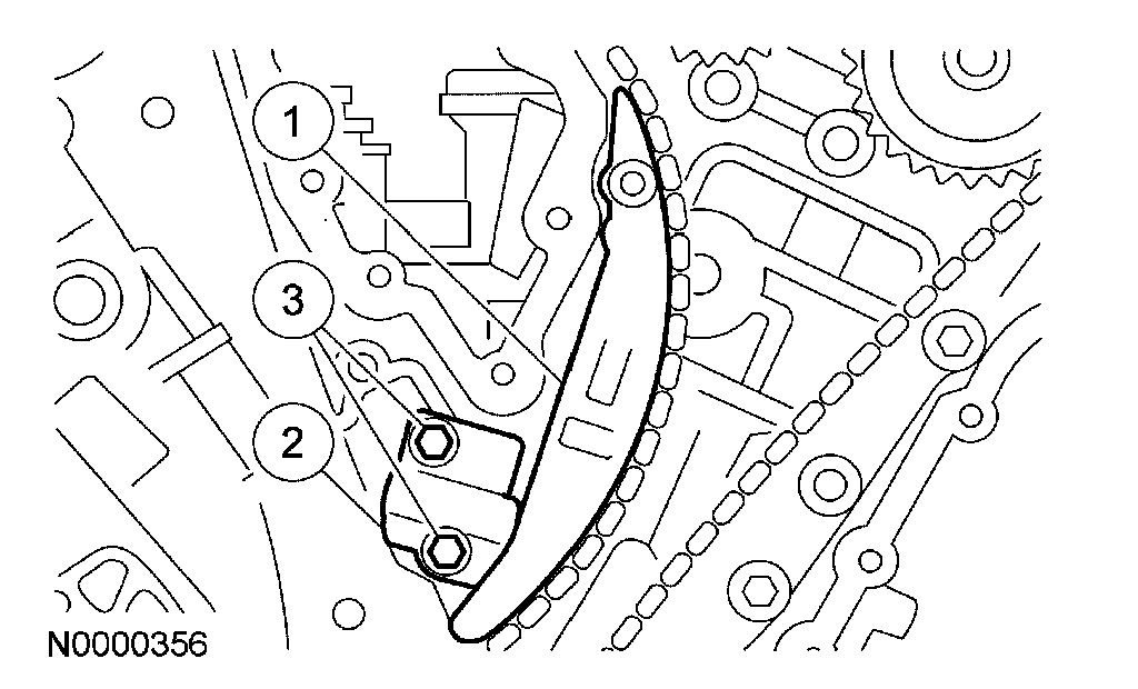

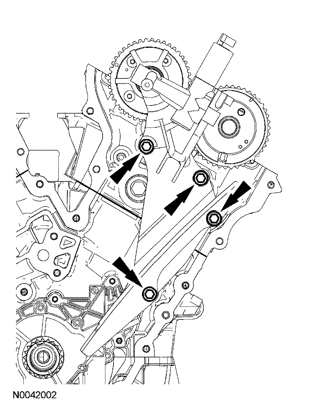

13. Remove the LH timing chain tensioner and tensioner arm.
pic 13

16. Remove the pulley bolt, washer and the crankshaft sprocket.
Installation
pic 16
1. NOTICE: Failure to verify correct timing drive component alignment will result in severe engine damage.
Install the crankshaft sprockets with the timing marks out.

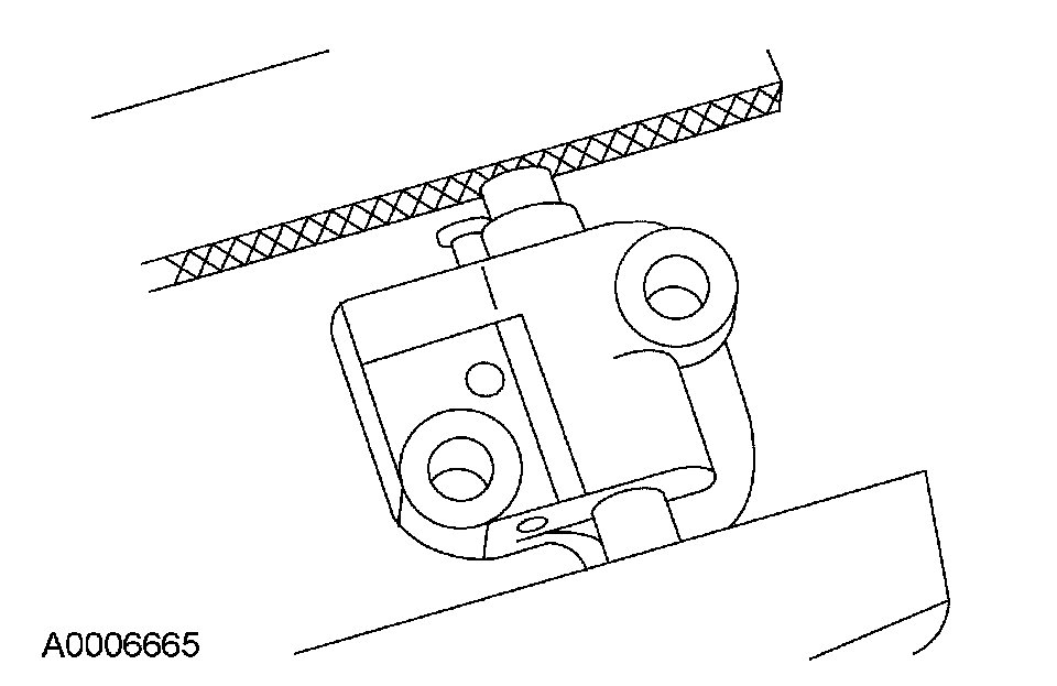

Position the chain tensioner in a soft-jawed vise.
pic 18
3. NOTE: LH shown, RH similar.

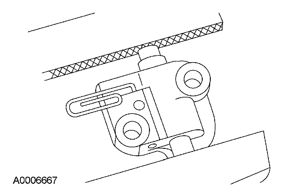

Hold the chain tensioner ratchet lock mechanism away from the ratchet stem with a small pick.
4. CAUTION: During tensioner compression, do not release the ratchet stem until the tensioner piston is fully bottomed in its bore or damage to the ratchet stem will result.
Slowly compress the timing chain tensioner.
pic 19
5. Retain the tensioner piston with a 1.5 mm (0.05 inch) wire or paper clip.
pic 20

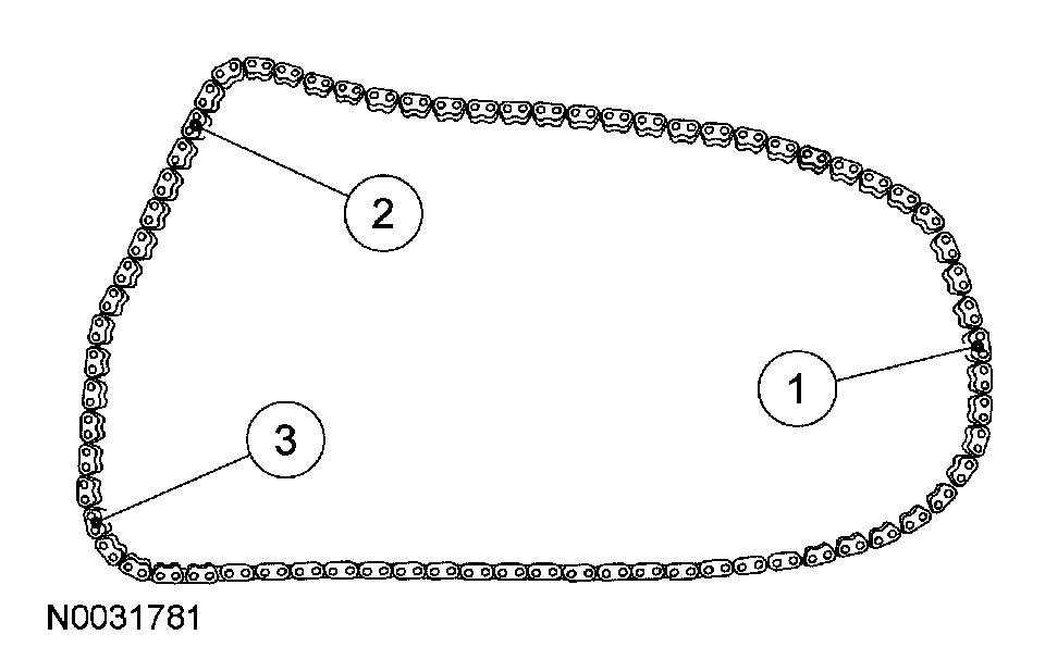

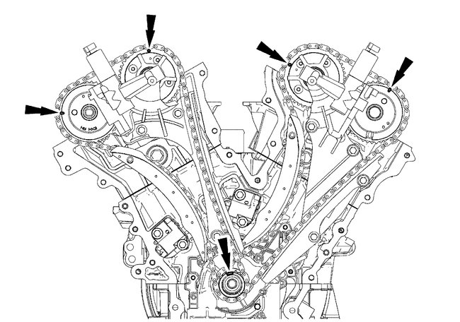

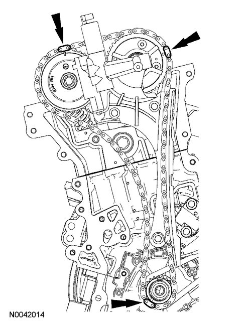

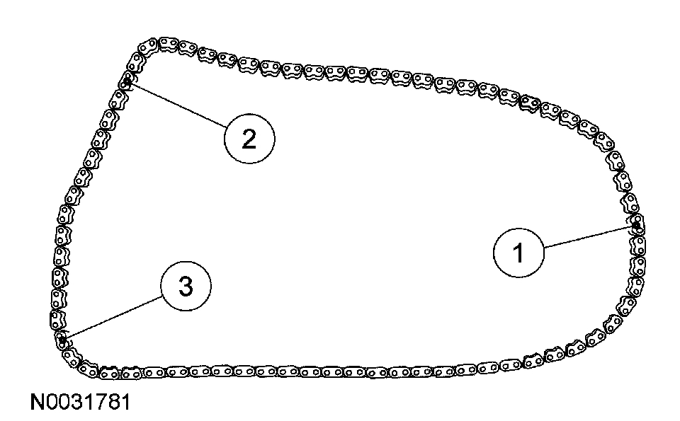

6. If timing marks in the timing chains are not evident, use a permanent-type marker to mark the crankshaft and camshaft timing marks on the LH and RH timing chains.
1 Mark any link to use as the crankshaft timing mark.
2 Starting with the crankshaft timing mark, count counterclockwise 29 links and mark the link.
3 Continue counting counterclockwise to link 42 and mark the link.
pic 21

8. Install the variable camshaft timing (VCT) assembly and the 4 bolts.
^ Tighten to 25 Nm (18 ft. lbs.).

10. Install the LH timing chain tensioner arm and the LH timing chain tensioner.
1 Install the tensioner arm.
2 Position the tensioner.
3 Install the 2 bolts.

11. Install the crankshaft pulley bolt and washer and rotate the crankshaft clockwise 120 degrees until the crankshaft keyway is in the 3 o'clock position.
pic 26

15. Install the RH timing chain tensioner and tensioner arm.

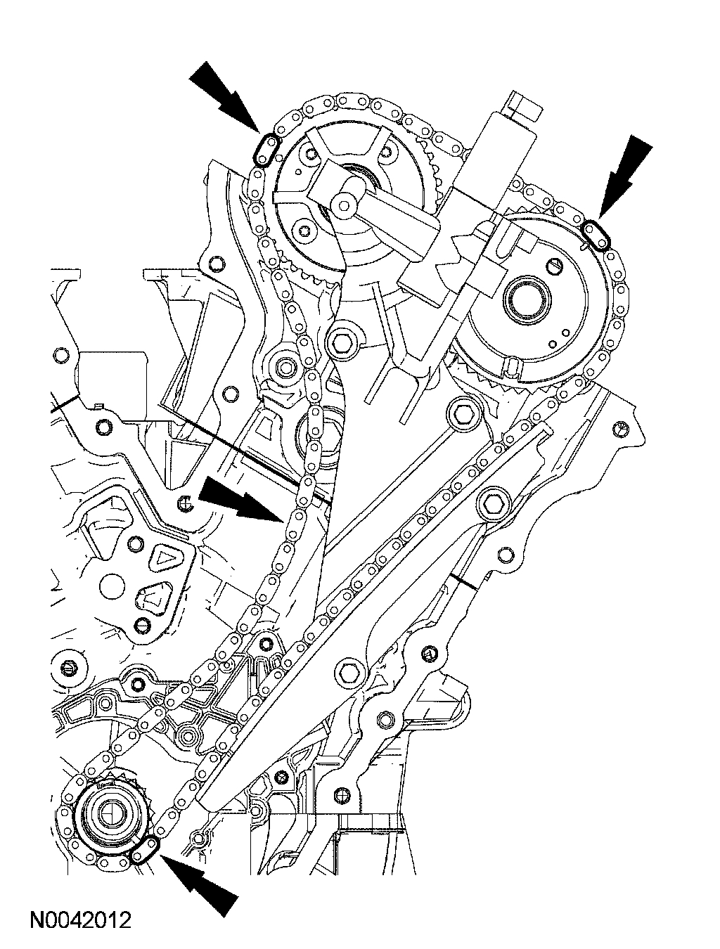

18. CAUTION: Failure to verify correct timing drive component alignment will result in severe engine damage.
Verify the timing with these steps.
1 There should be 12 chain links between the camshaft timing marks.
2 There should be 27 chain links between the camshaft and the crankshaft timing marks.
3 There should be 30 chain links between the camshaft and the crankshaft timing marks.
pic 31

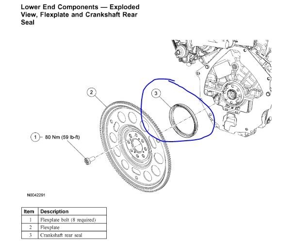

As far as the main seals, there is a lot involved. The rear main requires the engine and transmission to be separated and the torque converter and flywheel to be removed. If you look at pic 34, I attached an exploded view of the rear main seal. I circled it for you.

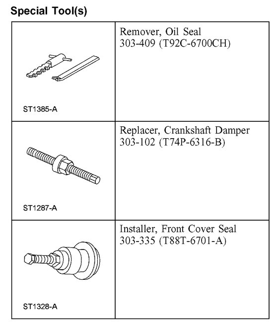

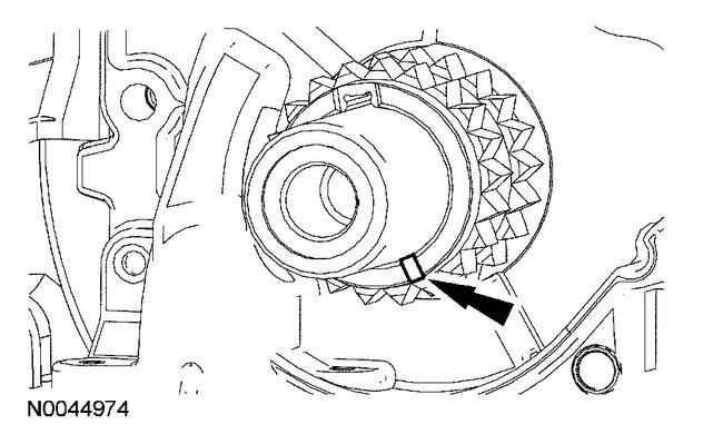

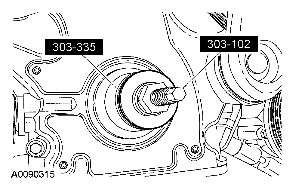

The front main seal will be easy to replace. It is located in the timing chain cover which you will already have removed. Here are the directions for replacement of the front crankshaft seal. The remaining pics correlate with these directions starting with picture 35.
______________________________________________________________
PROCEDURES
Crankshaft Front Seal
Special Tool(s)
pic 35

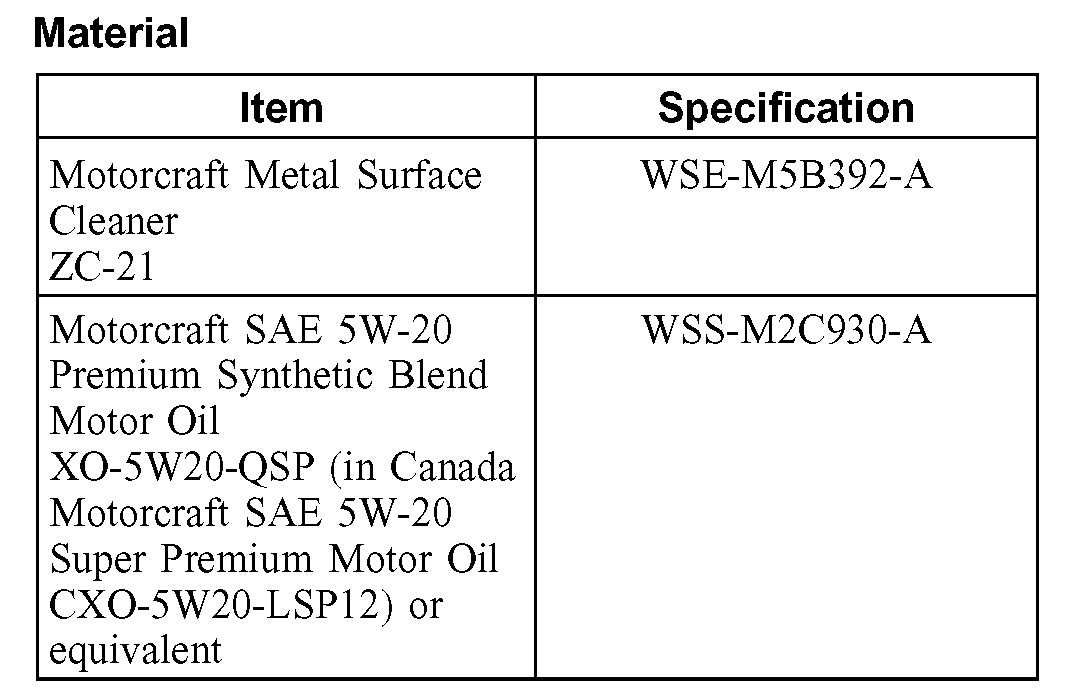

Material
pic 36
Removal

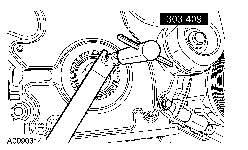

1. With the vehicle in NEUTRAL, position it on a hoist. For additional information, refer to Maintenance/Service and Repair.
2. Remove the crankshaft pulley.
pic 37
3. Using the special tool, remove and discard the crankshaft front seal.
Installation
1. NOTE: Clean all sealing surfaces with metal surface cleaner.
Apply clean engine oil to the seal lip and seal bore before installing the seal.
pic 38
2. Using the special tools, install a new crankshaft front seal.
