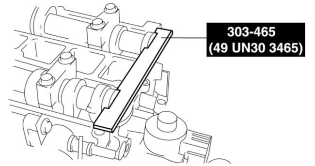

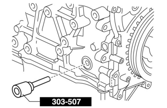

I attached a YouTube video for you to view of the replacement for the timing chain.
You will need a pin to lock the crank at top dead center and the tool for locking the cams at the rear.
https://www.youtube.com/watch?v=lEMtz_QrVK8
