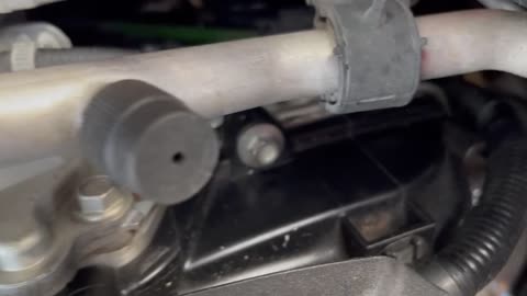

2.5L. I noticed a sound that is mainly there when under load, when parked i hear it like in the videos. You know of any common timing chain or lifters or phasers or anything else on these models?

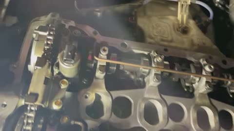

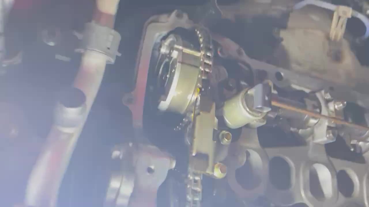

Definitely from above. Removed valve cover don't see anything out of the ordinary.

Very little up there, is it also possible noise is from phasers or chain from oil not reaching as much as it should. I will drain oil today.
May 19, 2022 at 3:58 AM
If the chain is slapping, then you are going to see it on the front cover. It is possible for the chain to be tight between the cams and loose from the crank to the cams.
However, the phasers would not make the noise. If they are not getting oil, then you are going to have timing issue and OCV codes.
The knocking noise is most likely going to be bearing or the chain is slapping the timing cover.
Will be interesting to see what is in the oil.
