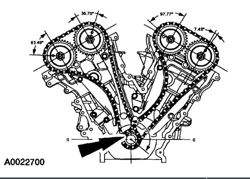

Timing chain jumped a link. how can this be fixed?

If it was not, then there is a reason for the timing to jump. Most likely you will need to replace both chains, the guides and the tensioners.

How far off is the timing?
I attached the diagram of the chains for you. Which gear moved and how much did it move?

How can i tell what link it was that jumped?

You will need to remove the front cover and check the alignment marks.
Does the engine run at the moment?
