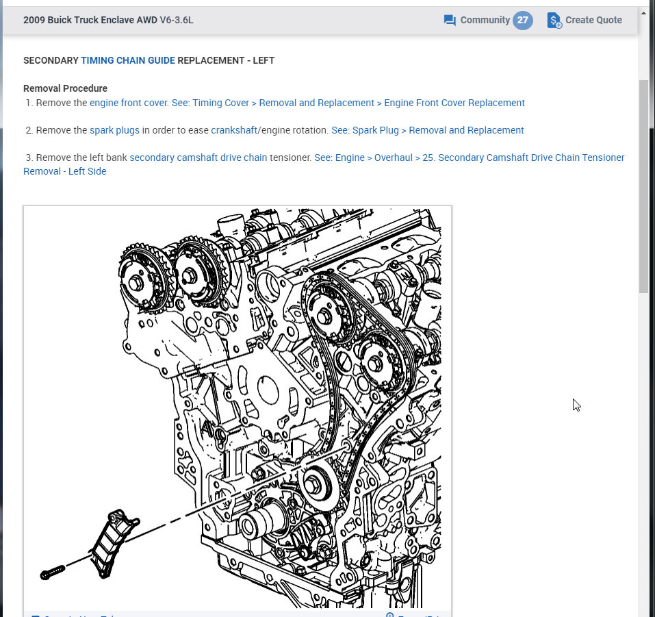

Timing chain guides not true
2009 BUICK ENCLAVE
126,000 MILES • 3.6L • 6 CYL • 4WD • AUTOMATIC
TOM MUGGEO
left secondary cam shaft drive chain shoe.
Oct 18, 2020 at 5:04 AM

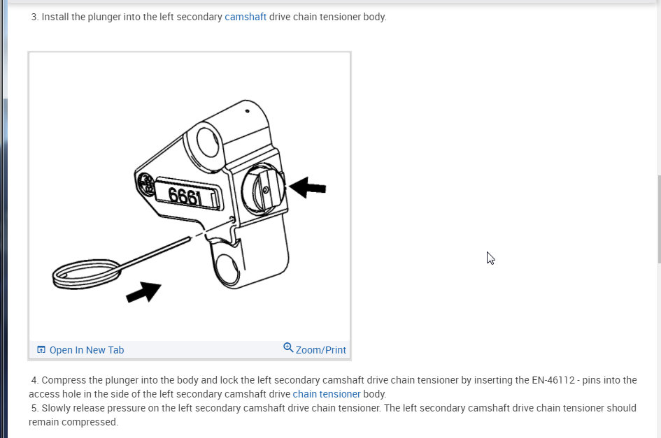

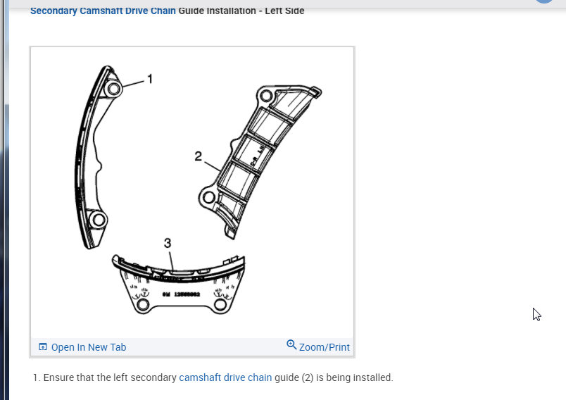

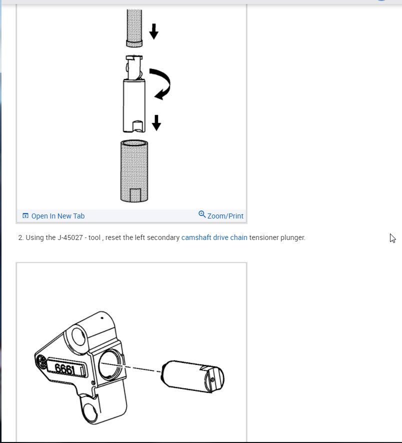

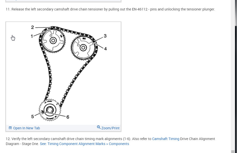

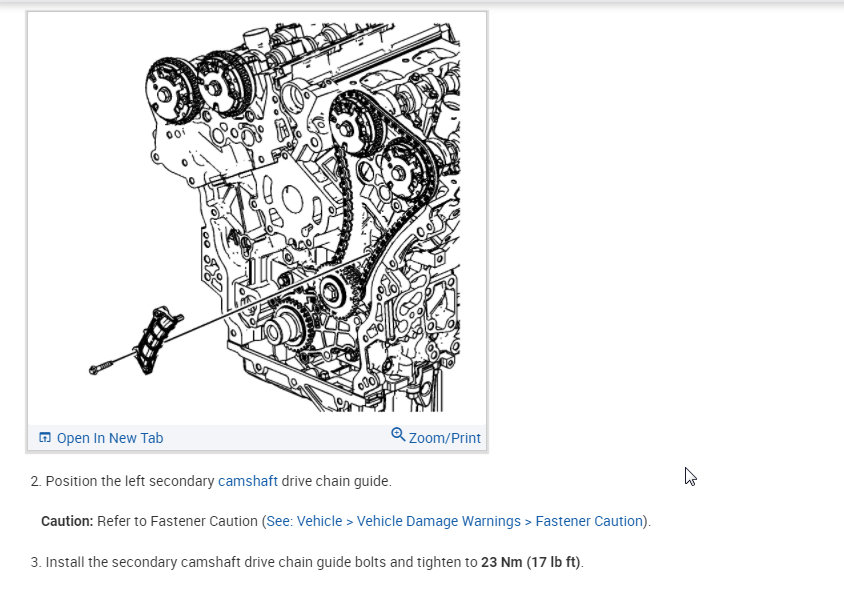

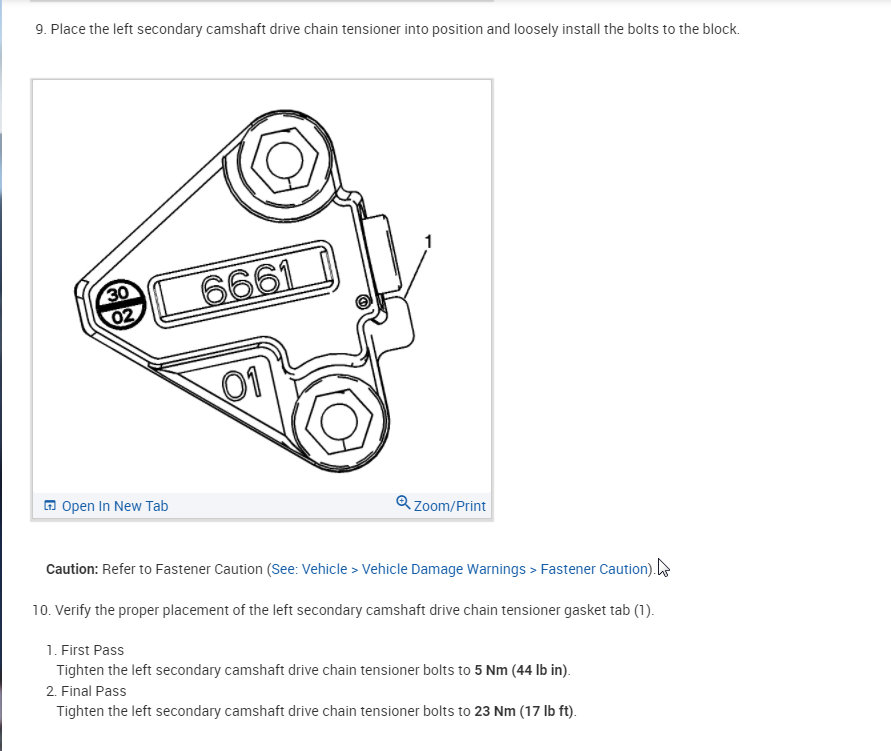

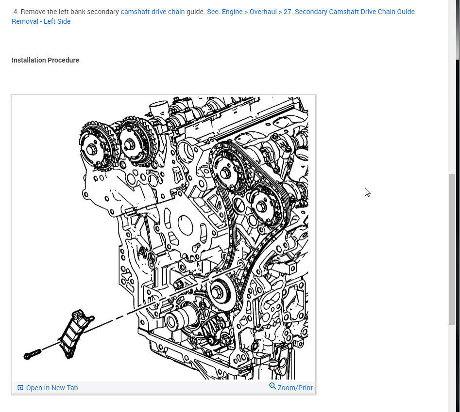

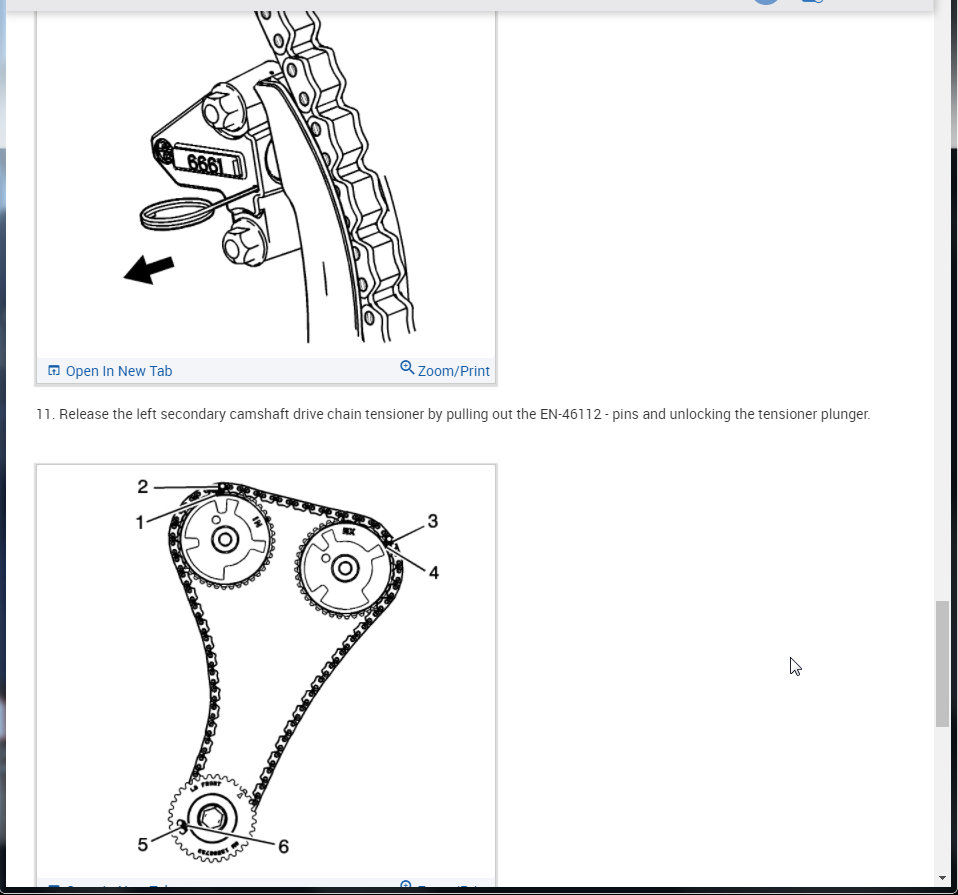

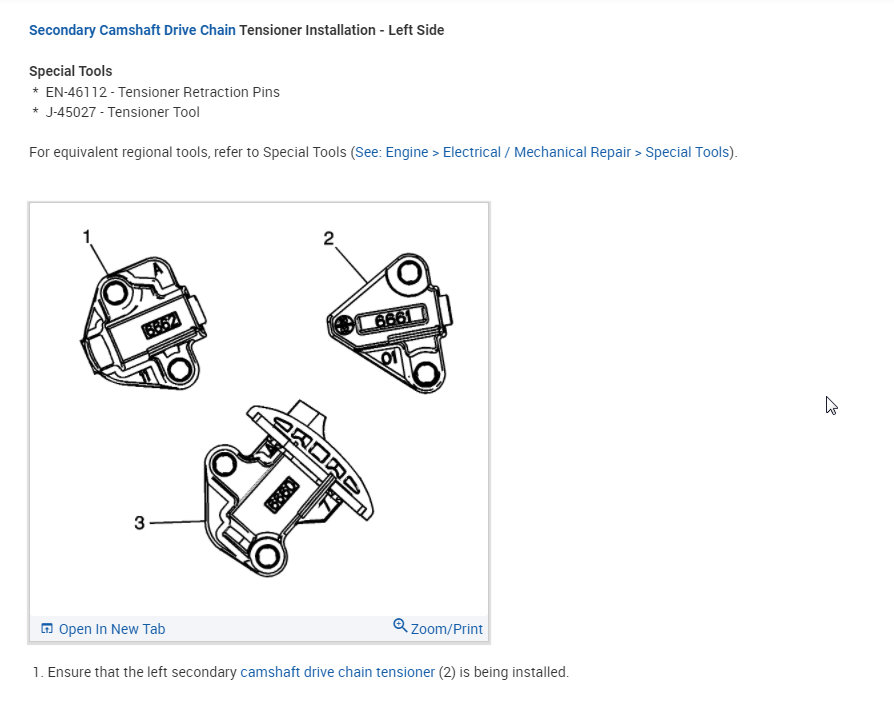

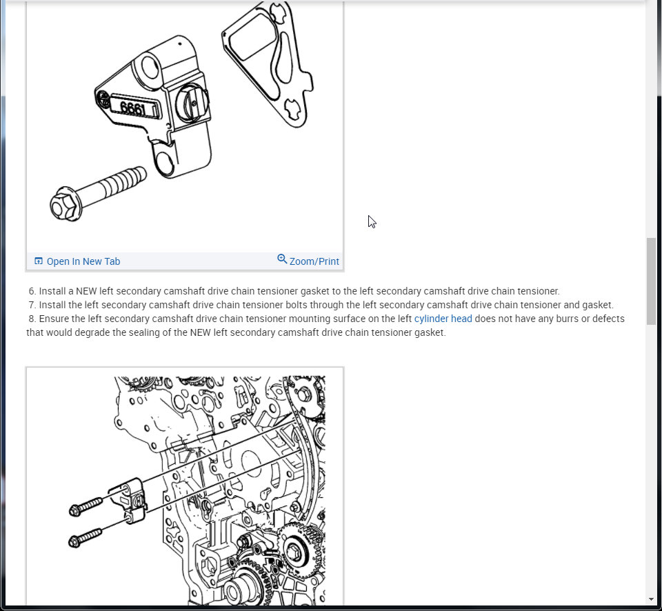

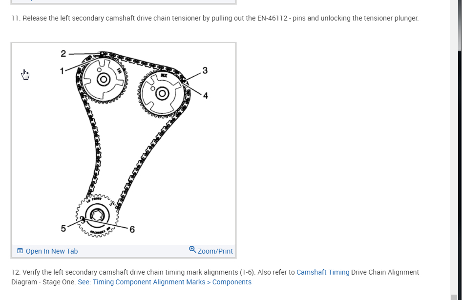

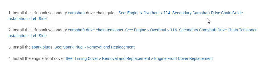

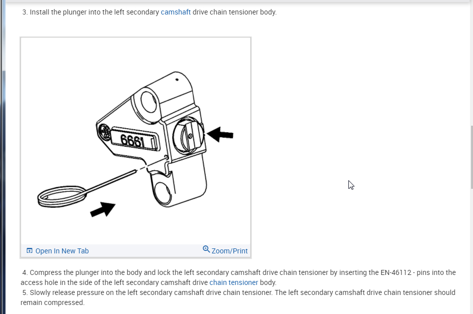

Can you let us know a little more detail about what the issue is? I attached the process to replace the secondary chain on that side in the event that is what you need. If not, maybe get some pictures of what you are dealing with and we can go from there. Thanks
