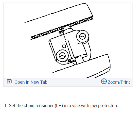

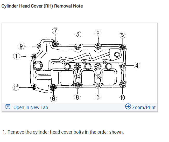

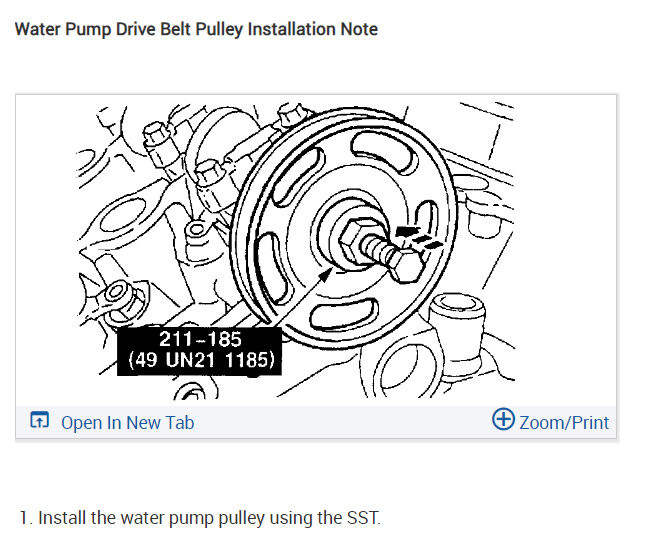

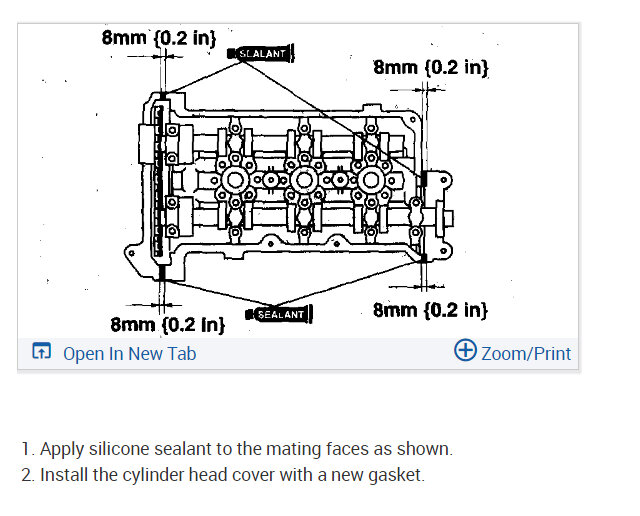

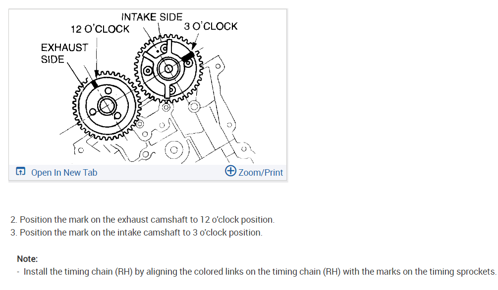

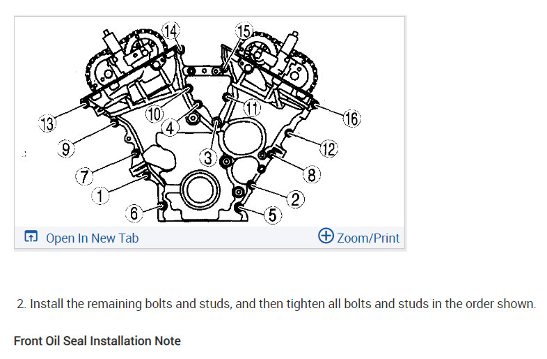

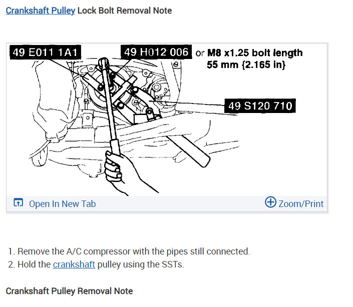

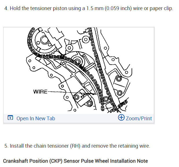

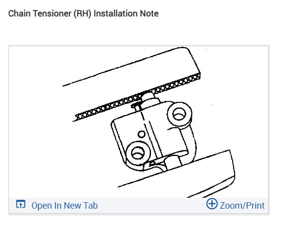

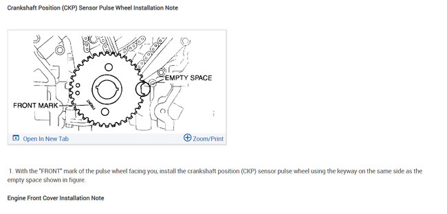

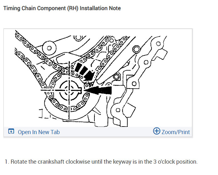

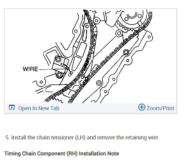

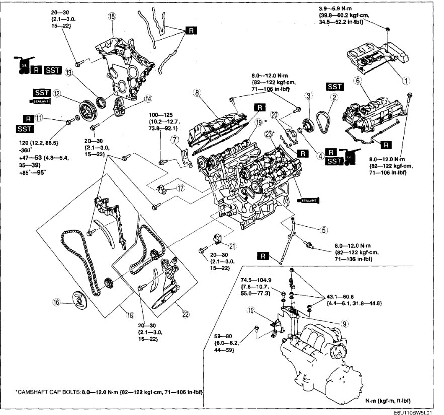

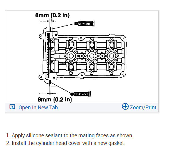

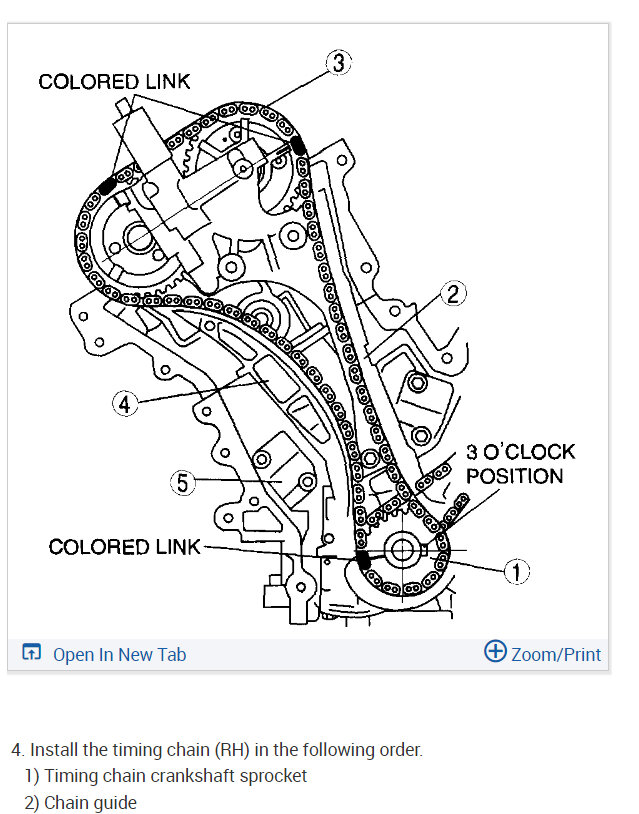

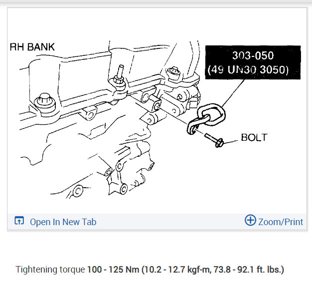

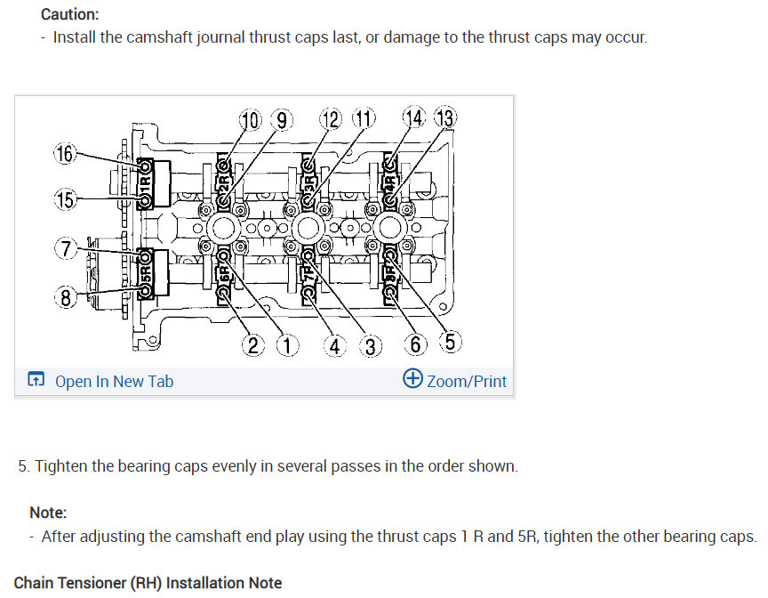

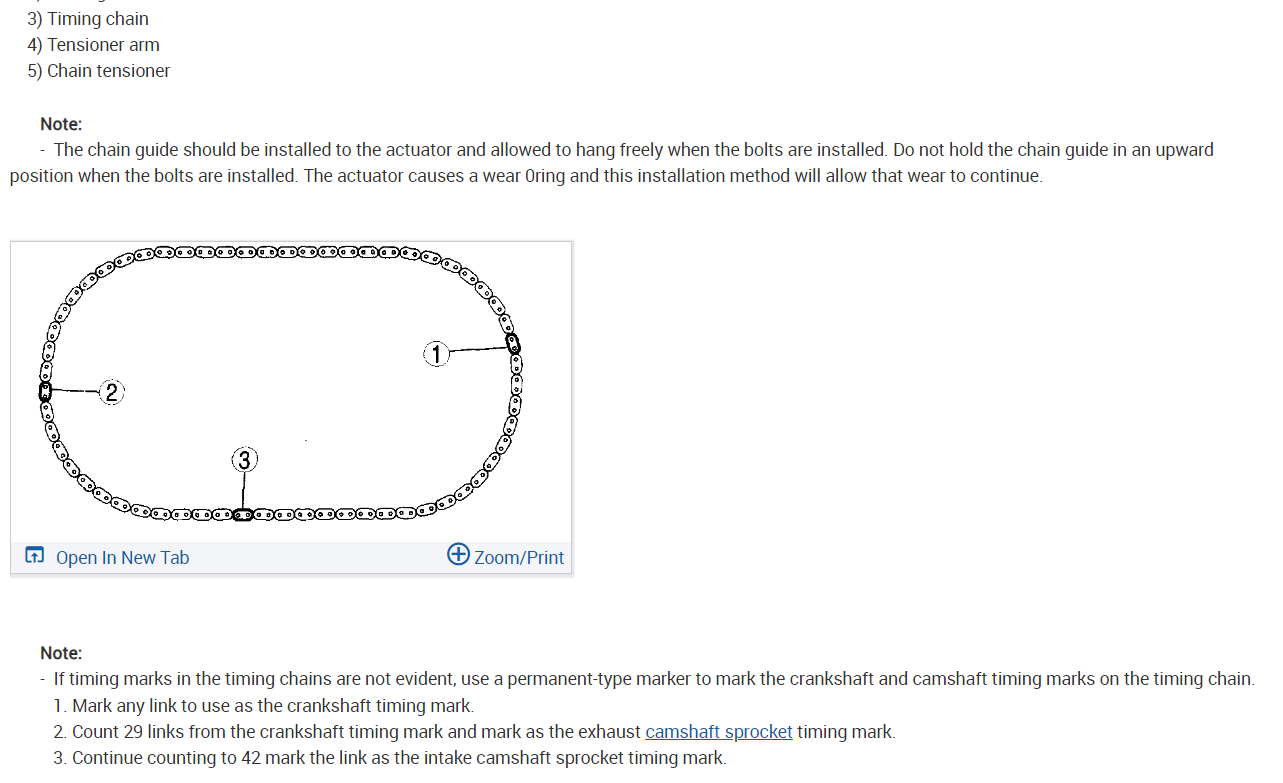

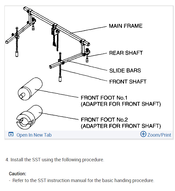

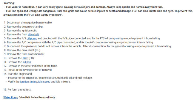

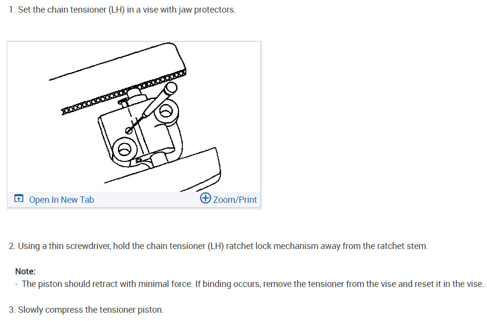

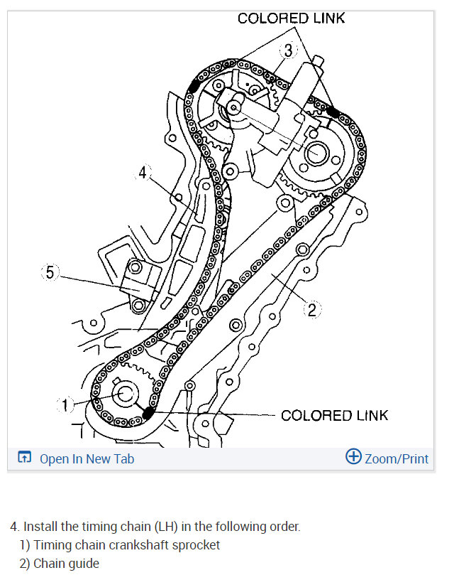

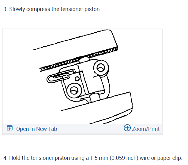

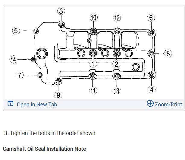

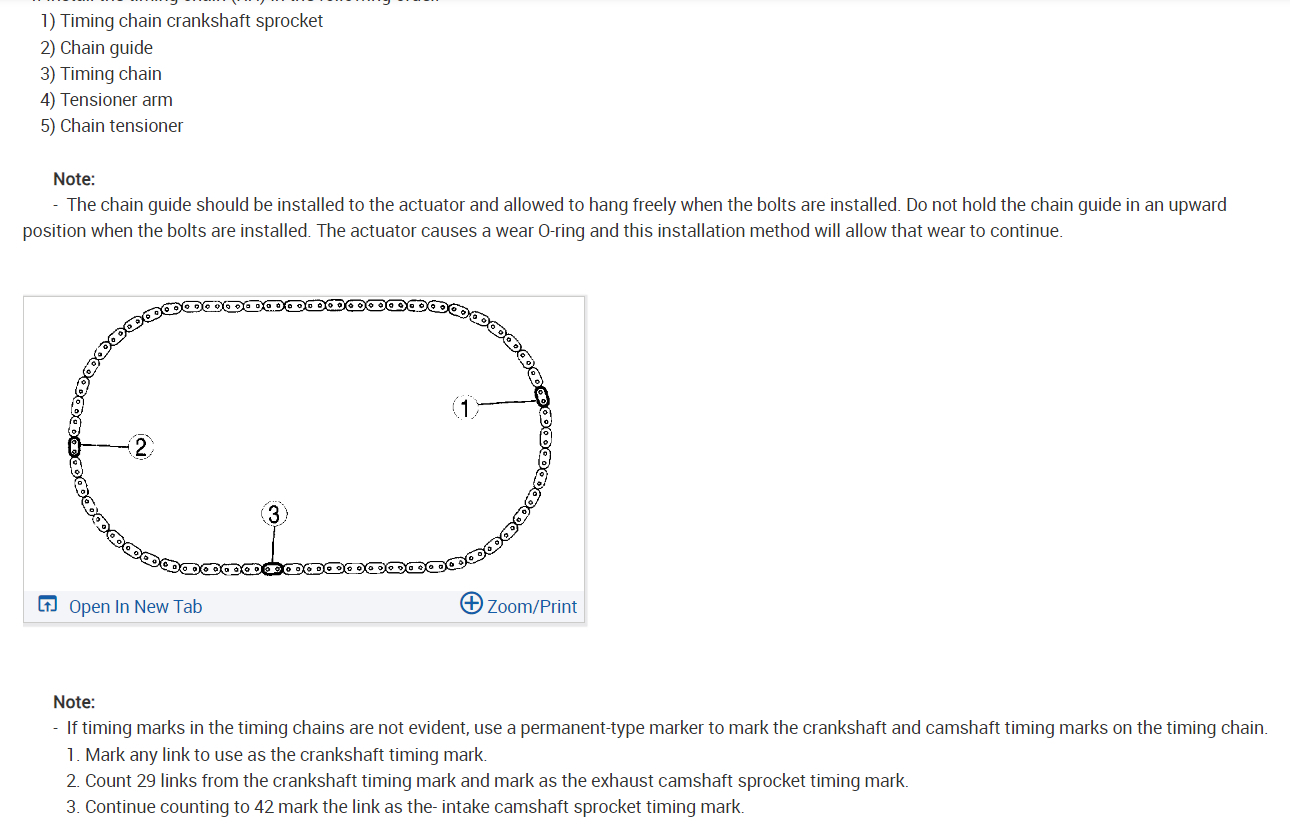

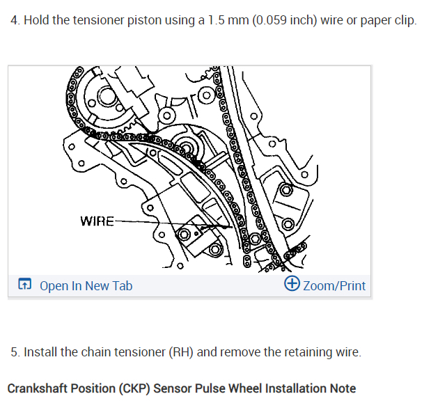

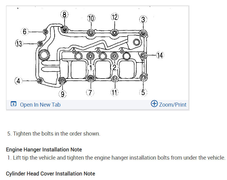

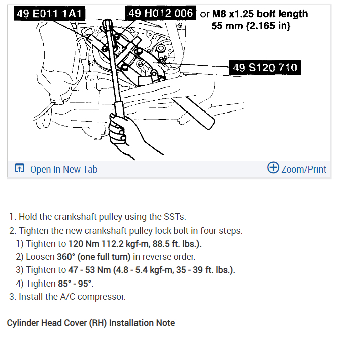

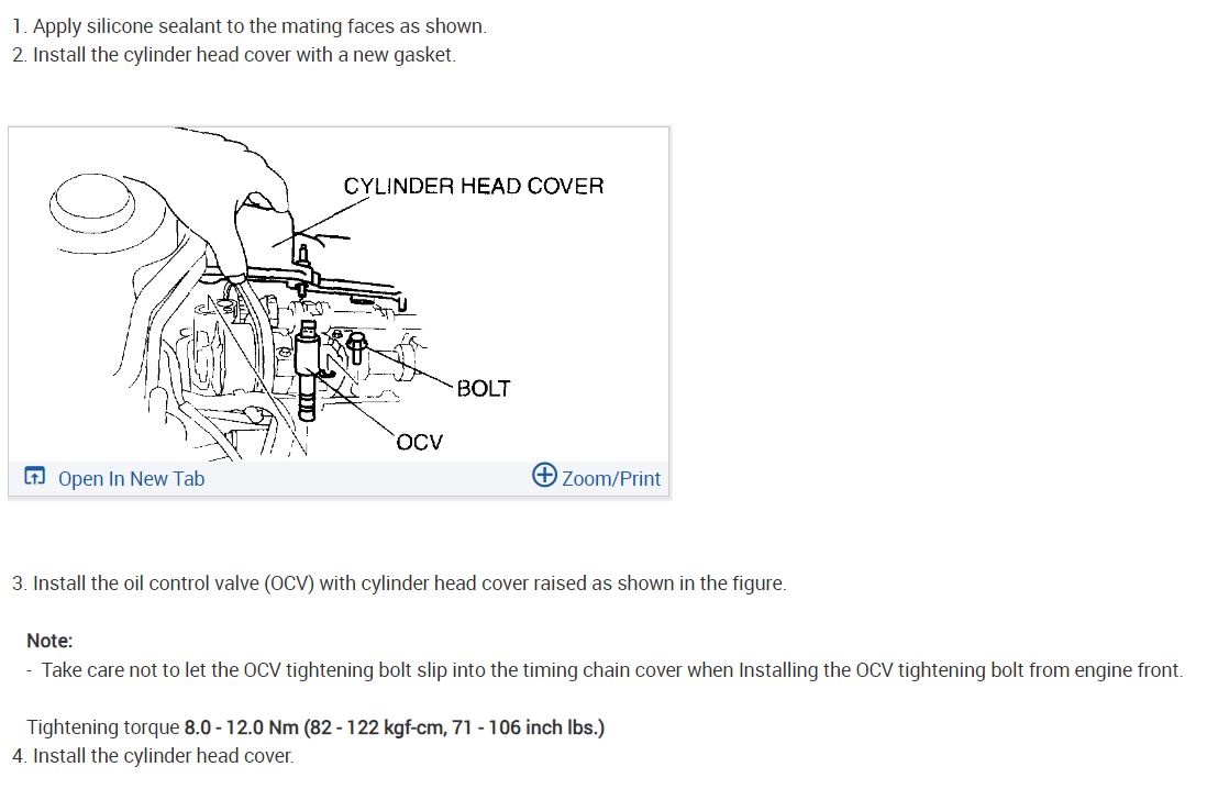

How to tighten up timing tensioners on timing chain on my car listed above?
Dec 7, 2023 at 2:09 PM
  • 55,433 POSTS

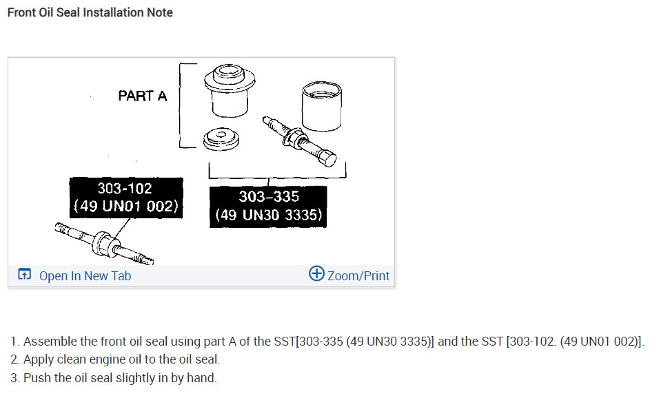

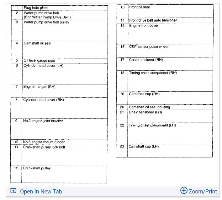

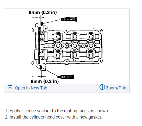

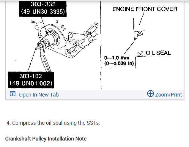

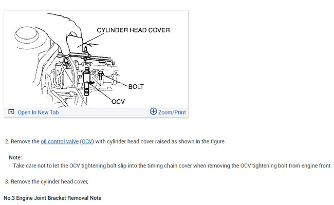

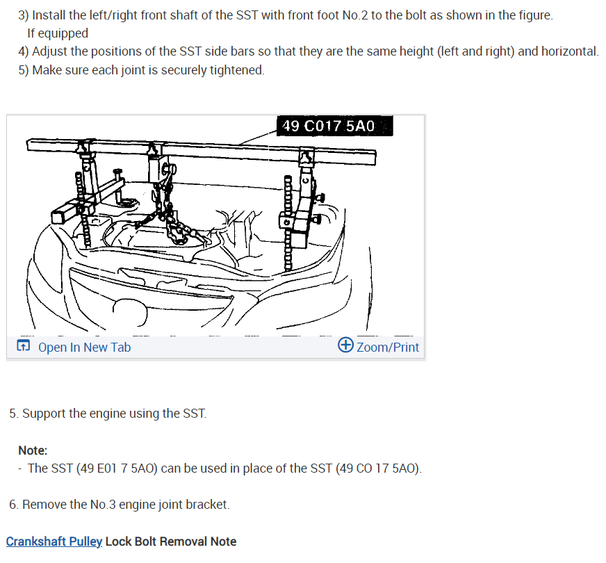

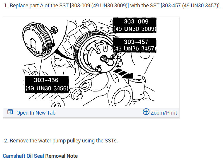

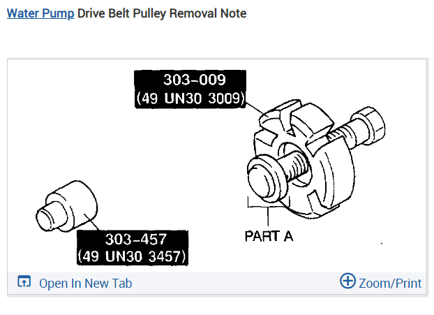

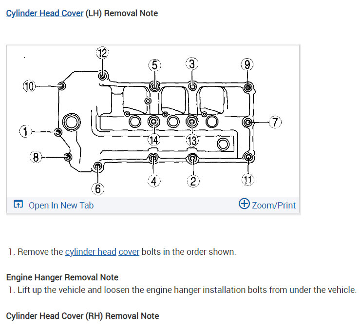

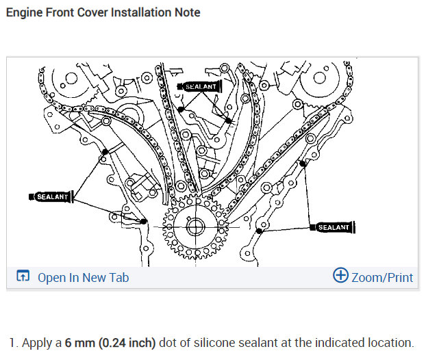

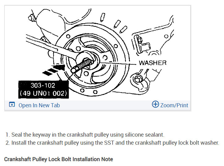

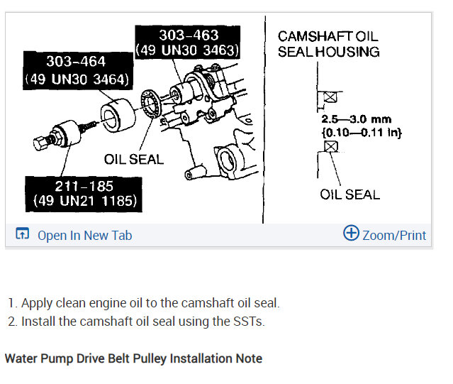

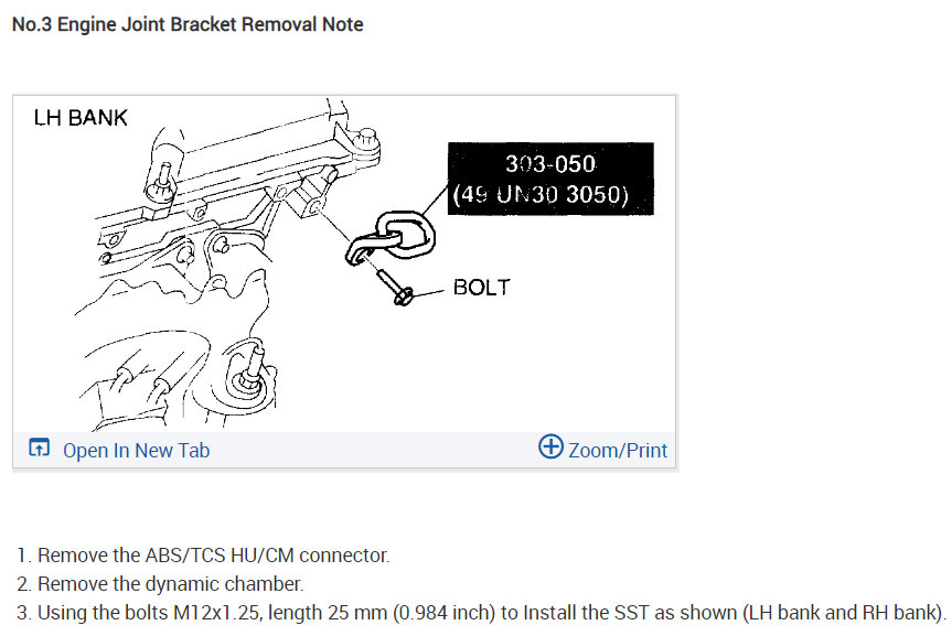

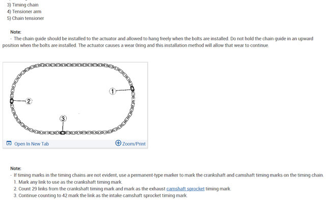

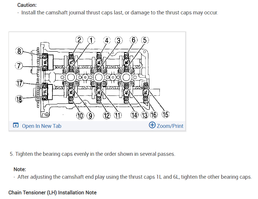

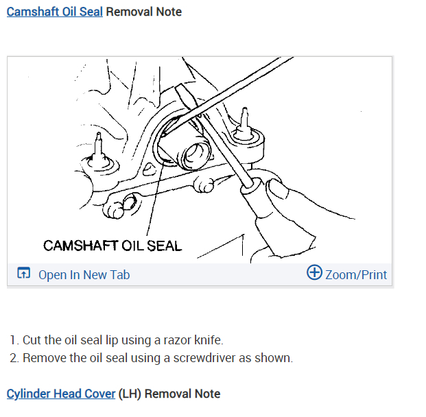

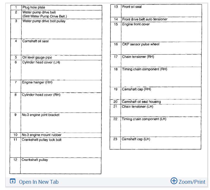

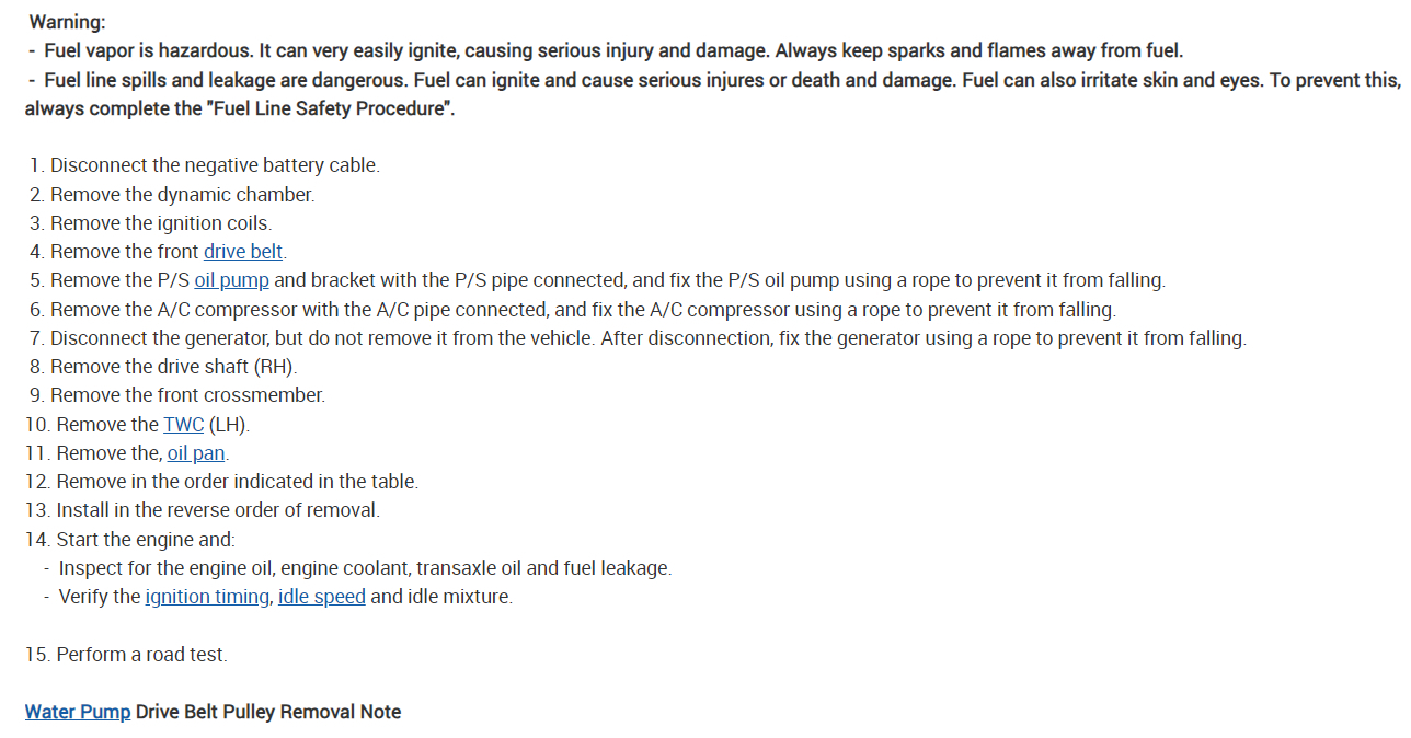

I am not sure if you mean what is the torque spec or if the chain is loose and you needed to know how to tighten it? If the chain has not been replaced that can be the cause of the loose chain. Here are torque specs and how to replace the timing chain. You can use a floor jack to support the engine from below, these instructions also show the timing marks for the chain and sprockets as well. Check out the images (below). Please upload pictures or videos of the problem so we can see what's going on.
