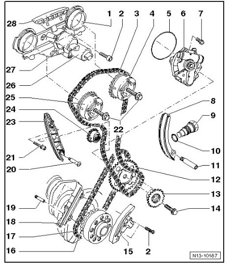

When they replaced the chain, were any other components replaced at the same time? I attached an exploded view of the timing chain and components. Take a look.
