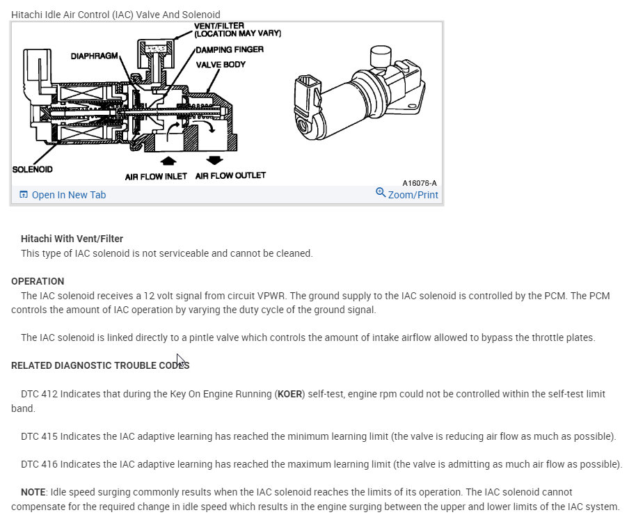

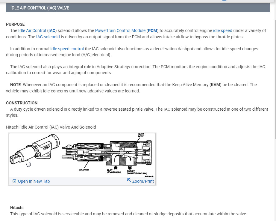

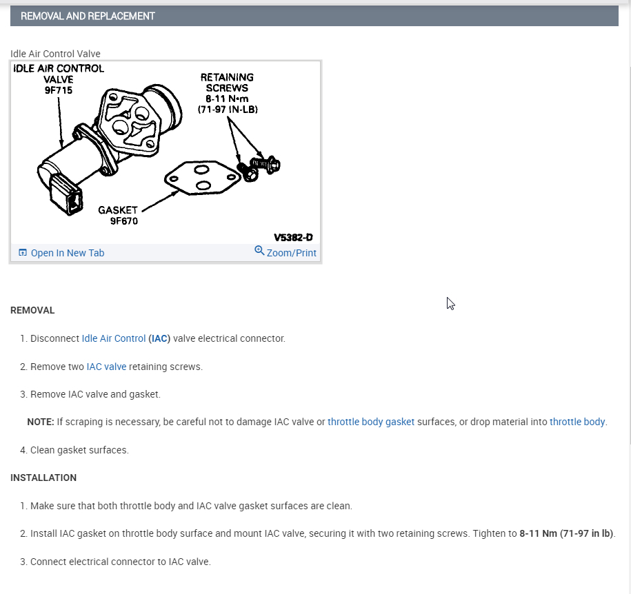

This sounds more like a failed IAC. Please see the attached documents for more detail. Basically, it is responsible for allowing a proper amount of air in when starting and idling.
I attached the procedure on how to replace it and the guide below explains what they are in more detail.
Also, if your plugs are wet, you want to change them out. This also points to an incorrect air/fuel ratio which is what you have with the IAC issue.
https://www.2carpros.com/articles/how-to-replace-an-idle-speed-control-motor-iac

Okay, I changed the IAC, to the tune of $72.00, and this did not correct the problem. I changed the plugs, re-checked the ignition wires to the coils, checked for power to the IAC-okay. The engine cranks, catches for a second or two and will not start. How can I tell if I am 180 degrees off on the timing belt installation? I have over $400.00 in new parts and still do not have a running truck. I am on disability and have terminal cancer so I can't afford to send it to a garage. I replaced a timing belt on my other 1994 Ranger last year and must have lucked out because all I did was line up all the marks per the Chiltons manual. This time I over thought and turned the crankshaft to where I thought was TDC-Compression just by feel. How do I absolutely know if I am at TDC on compression stroke? Would it not backfire through the intake if 180 off? I was driving this truck at the time the belt broke so I know it runs well. Plus, per Ford, it's a non-interference engine. Please Help. Thanks, Dale

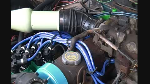

Here is the video of what the truck just keeps doing:
Monday, August 12th, 2019 AT 6:03 PM
Okay. I take it back when I said it does not sound like it is out of time. That is what an engine sounds like when it is out of time. At this point, I would be pulling the front down to check to see if you are on your marks when at TDC on compression stroke for number 1.

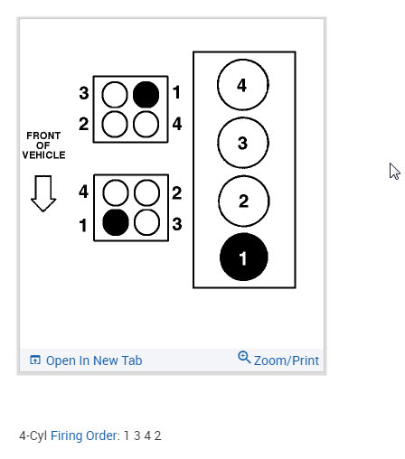

Also, make sure you have your plugs correct on the coil and going to the correct cylinders.

Thank you for finally figuring it out. I suspected I went too far with the two rotations. I will pull it back apart, reset the timing and hope that cures a several months long problem. Also I was lucky as the original coils from Ford were numbered and I installed the wires per the coils and just double checked with your diagram. I will report back. Thanks again for all your patience. Dale
