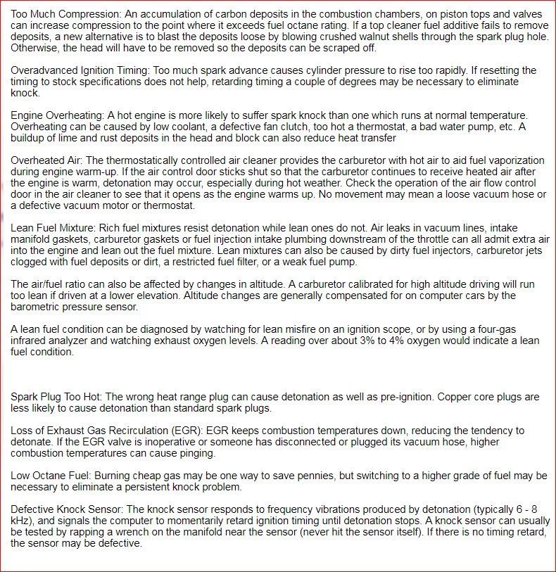

Hi FAB908,

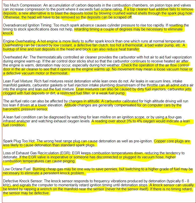

This sounds like detonation or spark knock. This is unburned fuel that ignites at the wrong time. It is either in the cylinder or in the exhaust when this ignites.
Here is a video of what this sounds like. You need to listen close but you can hear the rattling/clicking noise. If this is what yours sounds like then we need to address the causes of this. I attached a document that addresses the main causes of spark knock.
Also, if you want to confirm this is what it is, you can get a can of octane booster and put about 5 gallons of 92+ octane in your tank then drive the vehicle. If after about 35 miles it is gone, then spark knock is most likely your issue. Keep in mind that if it sounds like this but is not gone after doing this, it still could be spark knock. Basically, that means that you have a more severe case.

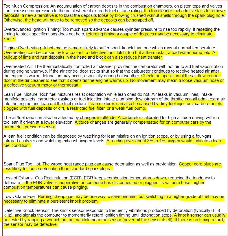

Kasekenny1, how would I resolve this? Would getting new spark plugs eliminate the problem or is it more complex than that?
May 12, 2019 at 11:42 AM
Take a look at the attachment. These are the most common causes and I highlighted the corrections. However, some of these are for carbs and do not apply to your vehicle but they still give you a good idea as to what to look for. Just changing the plugs will most likely not work.
The most common cause are deposits or carbon in the combustion chamber caused by low grade fuel, so using combustion chamber cleaner may help. If not, more aggressive tactics will need to be used and they are outlined in this attachment.
May 12, 2019 at 12:42 PM

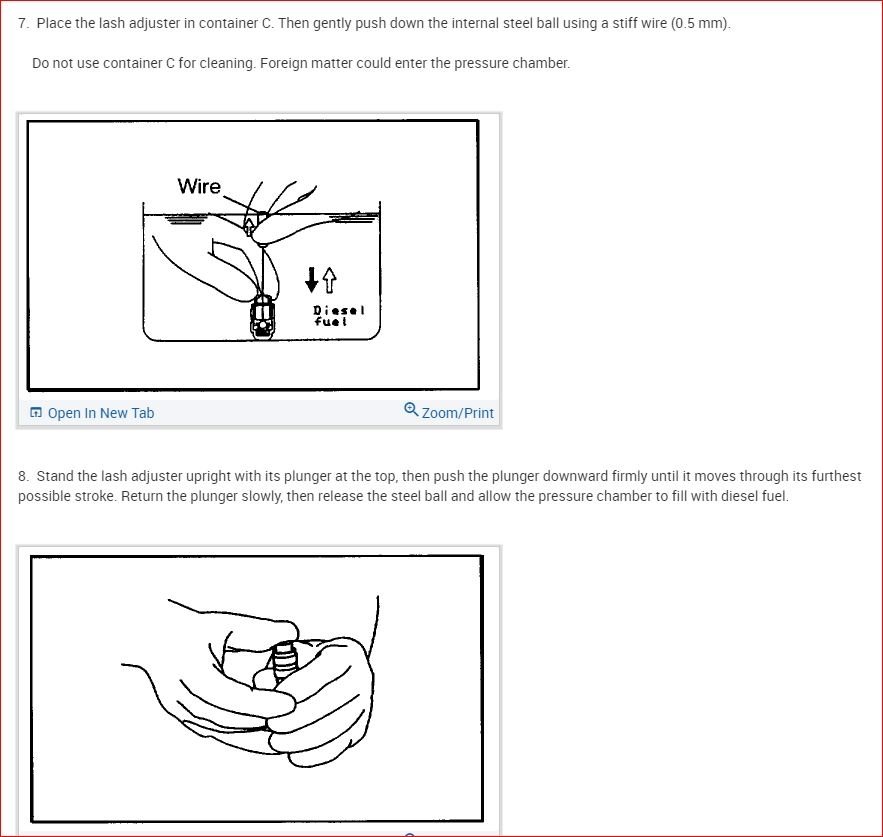

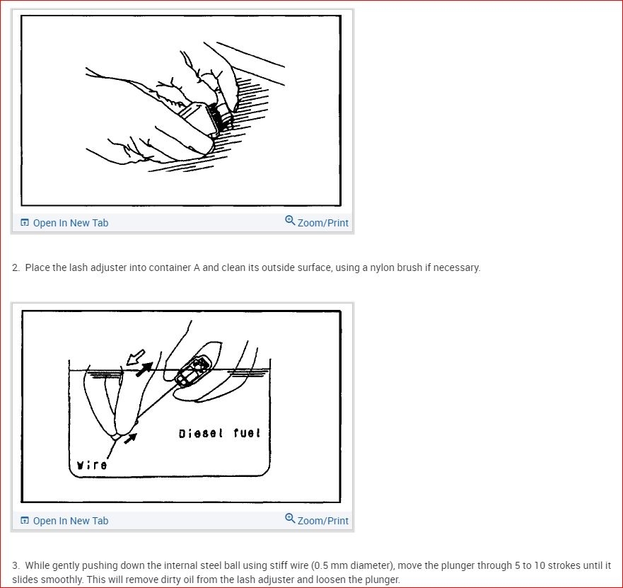

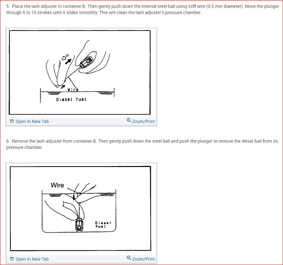

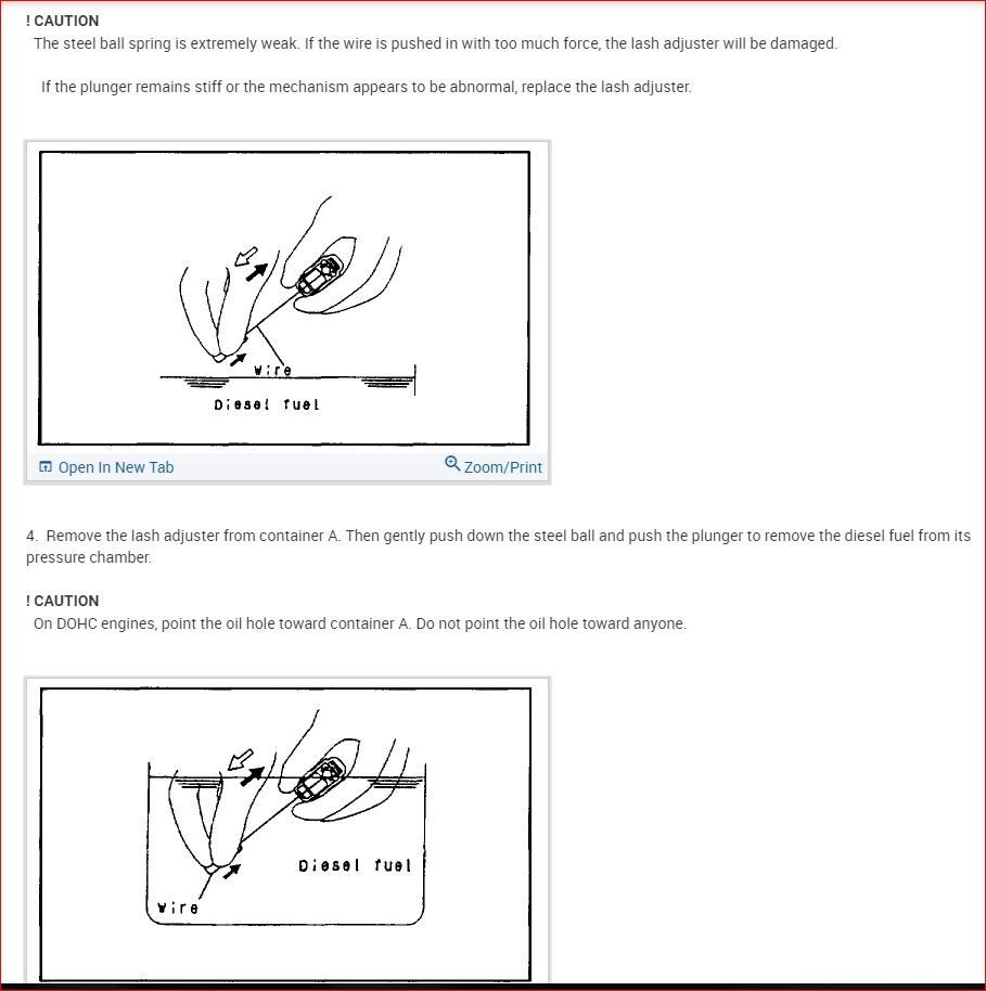

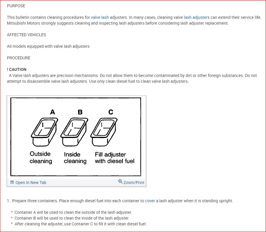

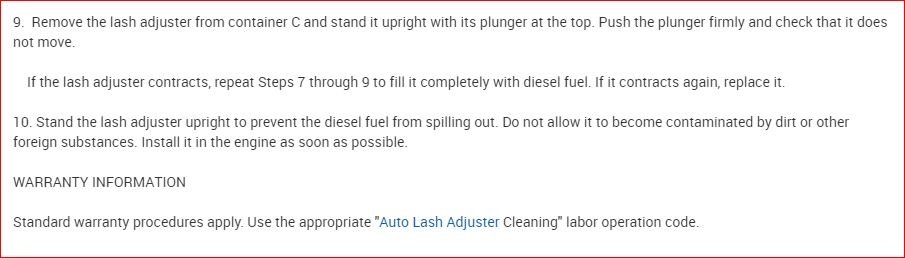

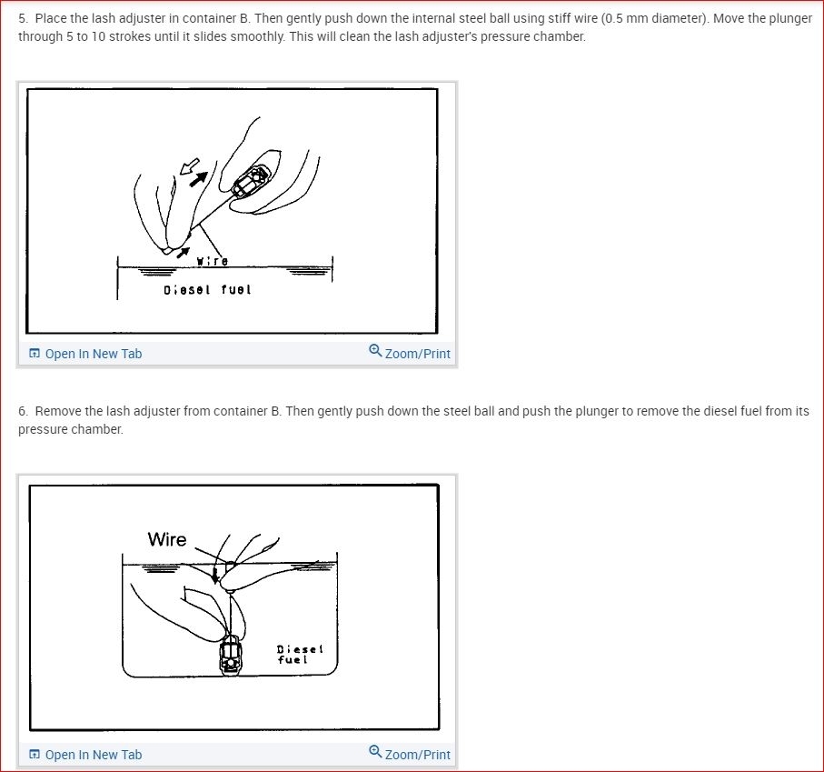

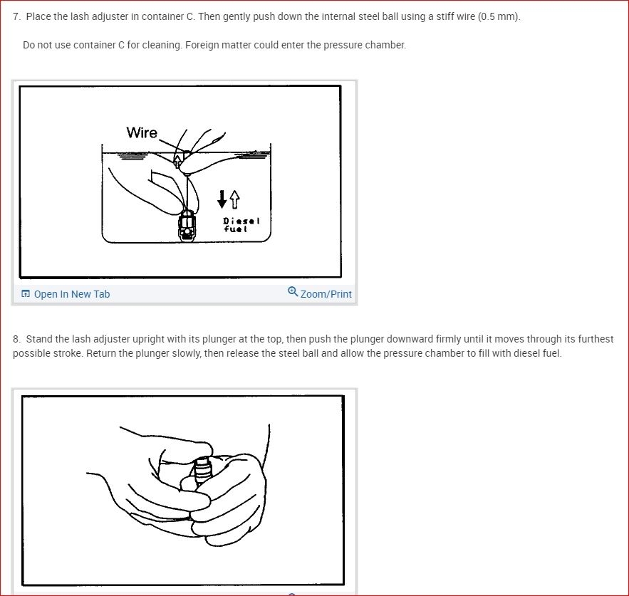

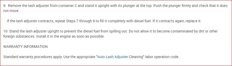

Okay. I agree. If this were spark knock more than likely it would have changed. In my opinion, that leaves one thing based on what you are describing and that is a valve train issue related to oil pressure like a lash adjuster or lifter. Basically, at higher RPM the lifter just doesn't stay pumped up and it starts clicking. Then when the RPM comes down it is able to pump back up and the noise goes away.
Unfortunately, there is no way to test them in vehicle. Basically, if they are noisy they need to be removed and cleaned or replaced.
Last thing I can suggest is if the noise is loud enough to get on a video, take a recording and post it to the site and I can help identify if this is a lifter/lash adjuster noise.
May 16, 2019 at 11:51 AM

If I remove them, would I need to replace the gasket ?
May 16, 2019 at 4:33 PM
Here is a video that shows basically how to do it on a similar engine.
As for the gasket, if it is original then yes you want to replace it. It should be a hard rubberized gasket which are reusable but when in doubt I always replace it because they are pretty cheap and not worth risking it.
https://youtu.be/SUo50VKmutc
