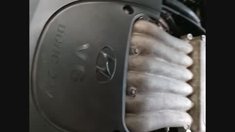

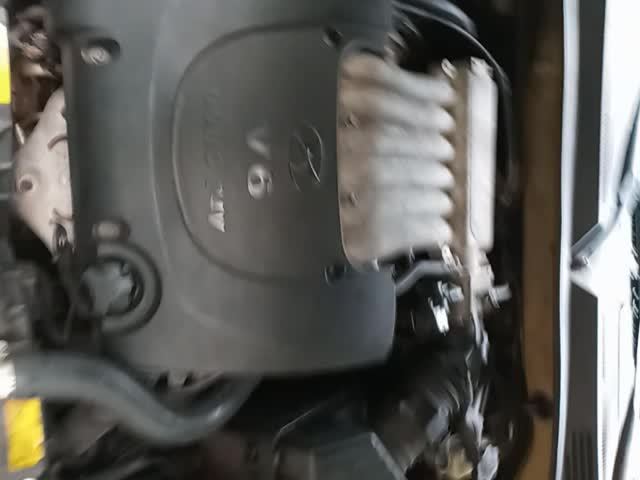

There is a ticking noise coming from engine when at idle and it gets faster as i accelerate

Can you get a recording of this? It could be just the injectors clicking when they fire or it could be an engine ticking. If this is an engine noise then a ticking is most likely an upper end issue like a valve train or cam issue. However, here it will really help us figure out what this is. Thanks

I don't have much doubt at all that this is an engine knocking. More then likely it is a bearing as it increases with the RPM. However, the other options are a wrist pin on the piston or an upper end noise. No matter what the engine needs to come apart to find it. The first things that we need to do is drain the oil and strain it to look for metal. Also, you can cut the filter apart and look for metal in there as well. Any metal and we have confirmed the engine is beginning to fail.
When you say there was some oil on there, how much was there? Also, you should have an oil pressure gauge in the cluster. Where is the needle positioned when the engine is on? It should be about half way up.
