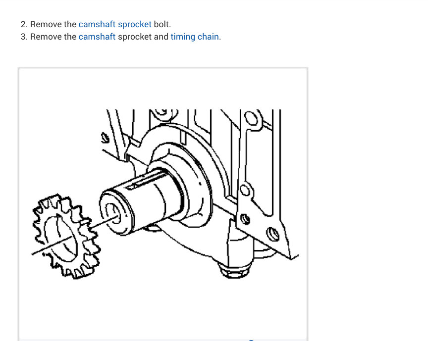

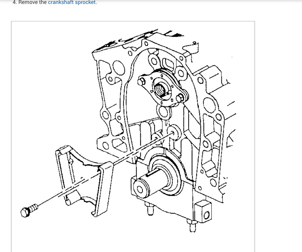

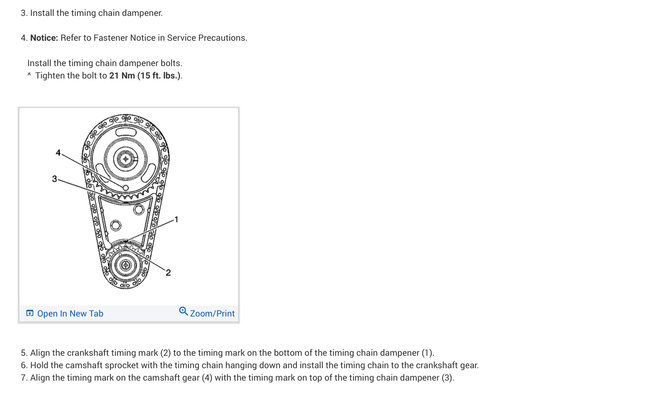

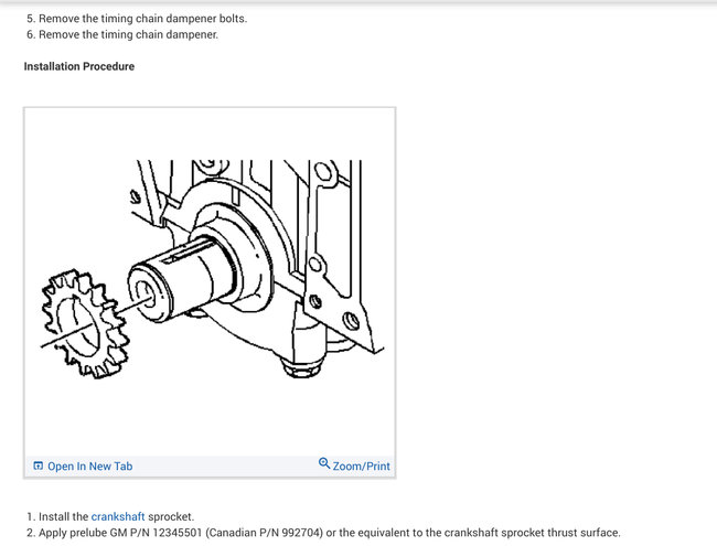

I was told it was a lifter when I bought the car but a friend told me it sounds like timing chain. It’s coming from the front end.
Dec 28, 2019 at 5:01 PM
SCGRANTURISMO
  • 4,897 POSTS

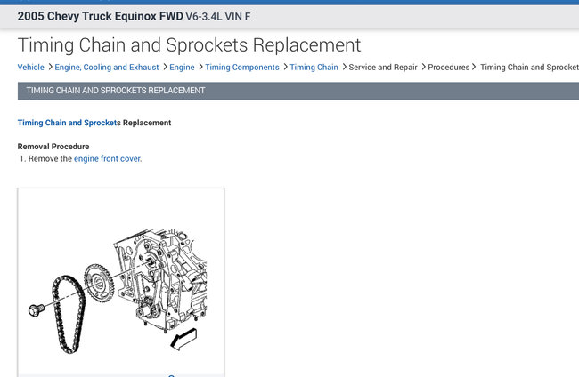

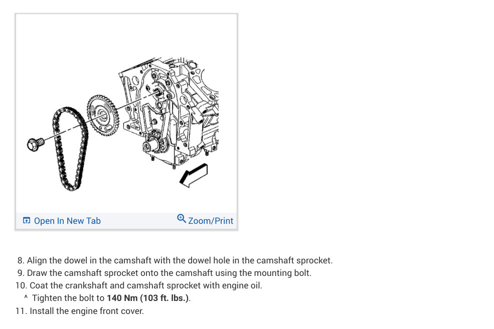

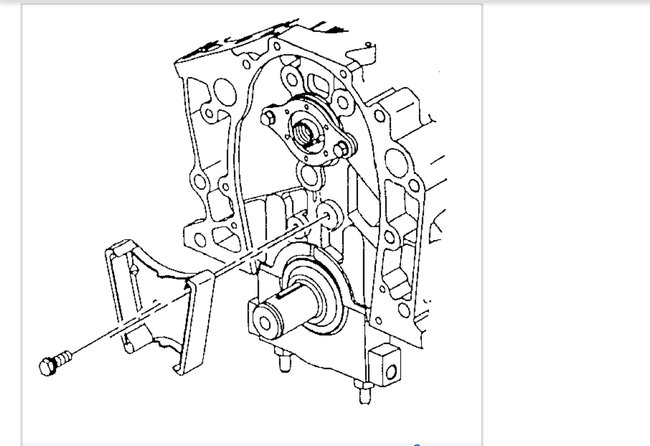

If the noise is coming from the front of the engine then chances are that it is going to be the timing chain or the timing chain damper. Your vehicle's engine is an interference engine, so I would get this job done ASAP. In the diagrams down below I have included the instructions for the removal and installation of the timing chain and sprockets for your vehicle from the manufacturer. Please go through this guide and get back to us with how everything turns out. Happy Holidays.

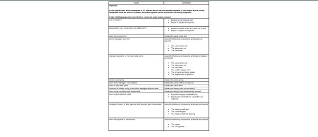

But could it still be the lifter? Or maybe new plugs?
Dec 29, 2019 at 4:25 AM
TOUGHDIVER
  • 226 POSTS
A ticking noise in the engine could be a number of things, Note the timing chain usually makes a rattle type noise, A collapsed lifter will make a ticking type noise, Either noise will be in-sync with engine rpm's. Low oil pressure or wrong oil filter is usually the culprit. I'm attaching a diagnostic chart and some information on engine noise. And lifter replacement below.
Please let us know what your problem is and what you did to correct it.
