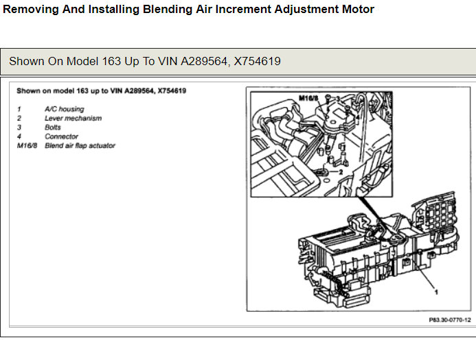

There is a constant ticking noise coming from my dash.
Apr 29, 2018 at 2:27 AM
  • 55,748 POSTS

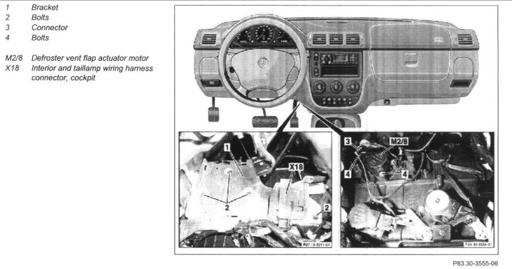

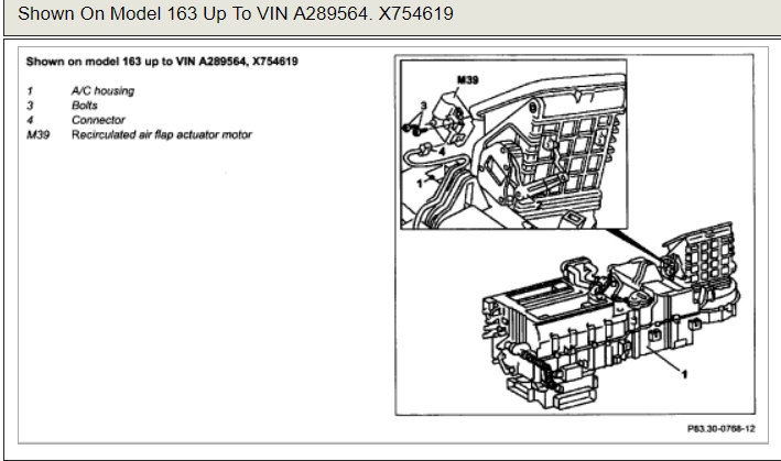

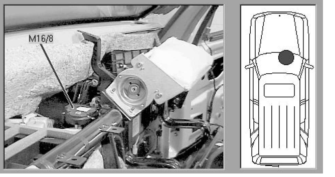

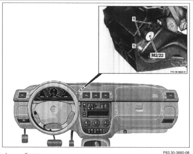

This sounds like a blend door actuator is out causing the noise which is common. Here is a guide to help you see what you are in for when doing the job:
Here is the location for your car. The best thing to do is put your hand on each and feel which one is giving you the trouble.
