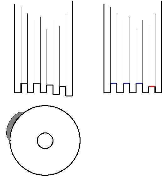

This drawing shows two types of broken belts to look for. The most common is on the left. You'll see the hump in the tread as the tire goes around. Be careful when running your hands over that area as it is often accompanied by wires from the steel belts sticking out. Those really hurt when you get poked by them.
The broken belt on the right is a lot harder to spot. With this one, the belt comes apart over such a long period of time the tread has a chance to wear flat, or even, with the rest of the tread. You won't see the characteristic hump. In fact, the tire will look just fine, but in that area, the sidewall doesn't offer the support the rest of it has. That lets the wheel and spindle drop a little each time that spot hits the road surface. Very often there is that one magical speed where the vibration seems to go away. To identify that, look at the grooves as shown with my red line, instead of the tire's surface that hits the road surface. As the tire rotates, you'll see that area rise in one spot. It can take a trained eye to determine if that is bad enough to call a broken belt. There's also little bumps in those grooves that are wear indicators. Those are much smaller than the raised area caused by a broken belt.
