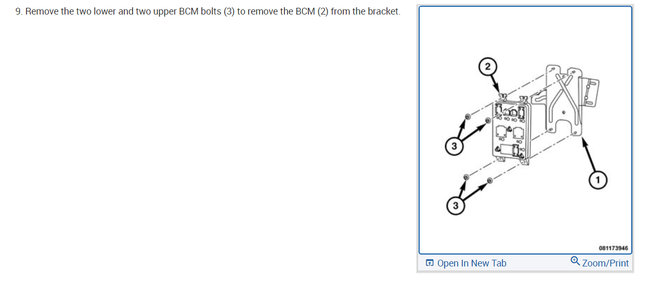

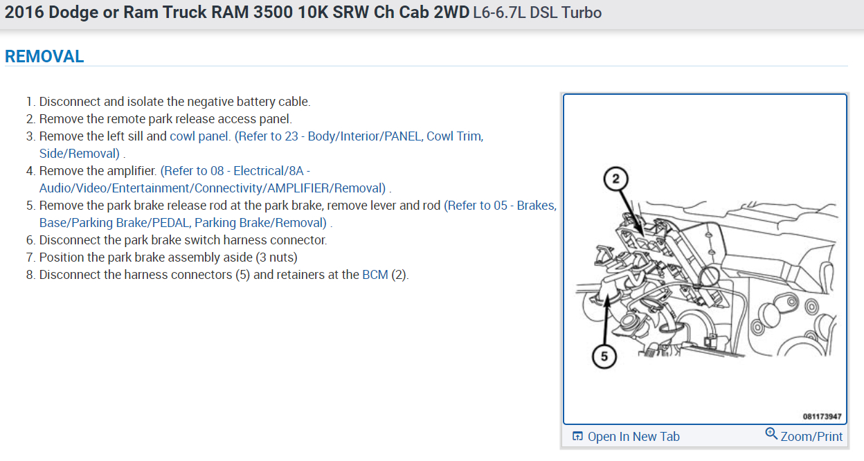

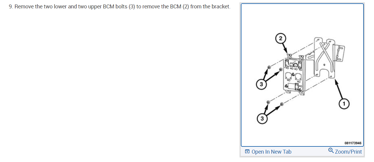

This sounds like you have a BCM (body control module going out. To be sure lets do CAN scan to confirm the issue. a CAN scan which is the future of automotive repair you can get a CAN scanner from Amazon for about $50.00. here is a video to show you how:
https://youtu.be/InIlnsjOVFA
Here is how to change out the BCM if confirmed in the diagrams below. It does not say it needs programming so it must self initialize. Check out the diagrams (below). Let us know what happens and please upload pictures or videos of the problem.
