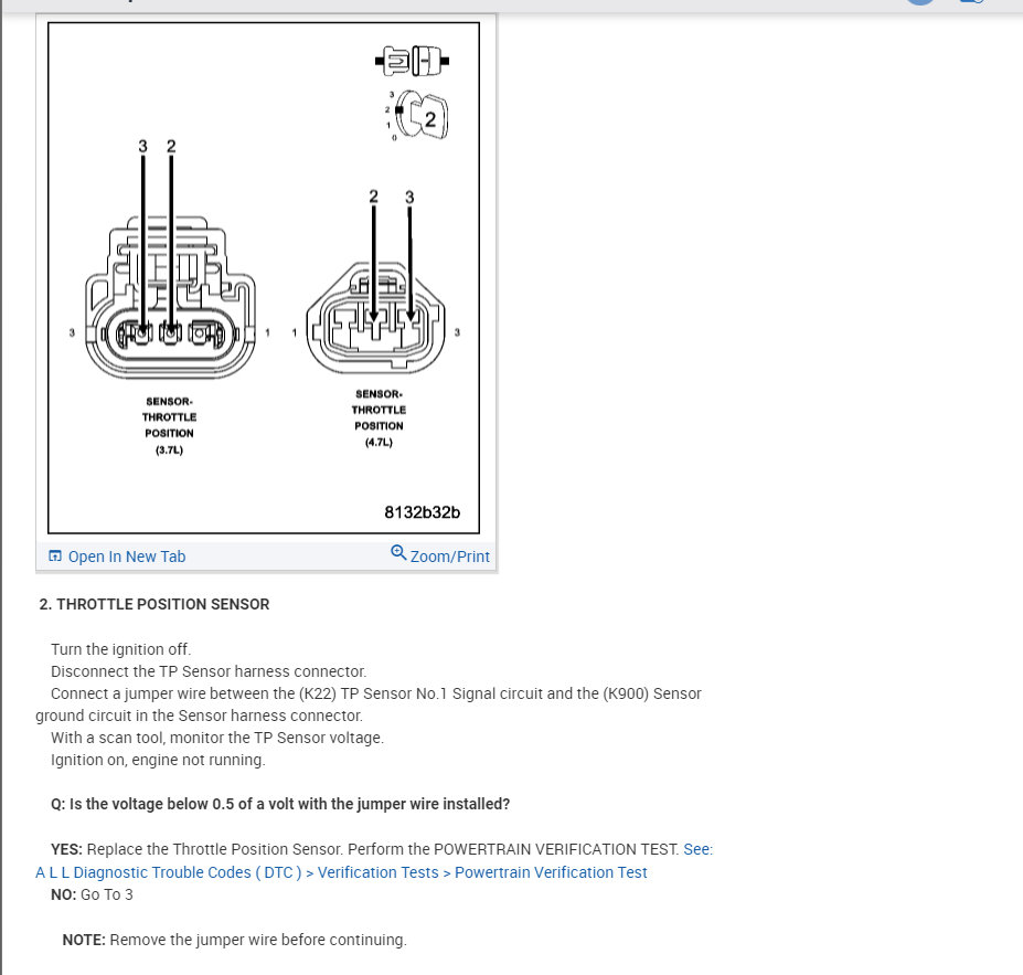

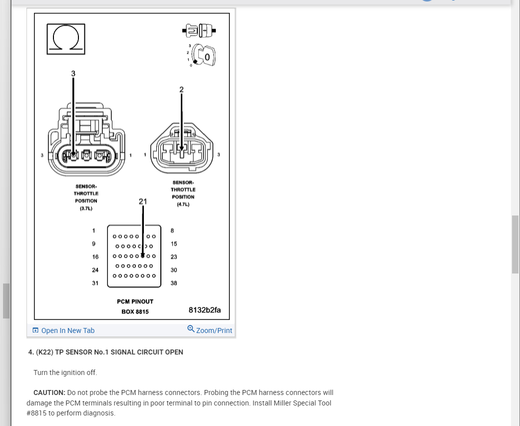

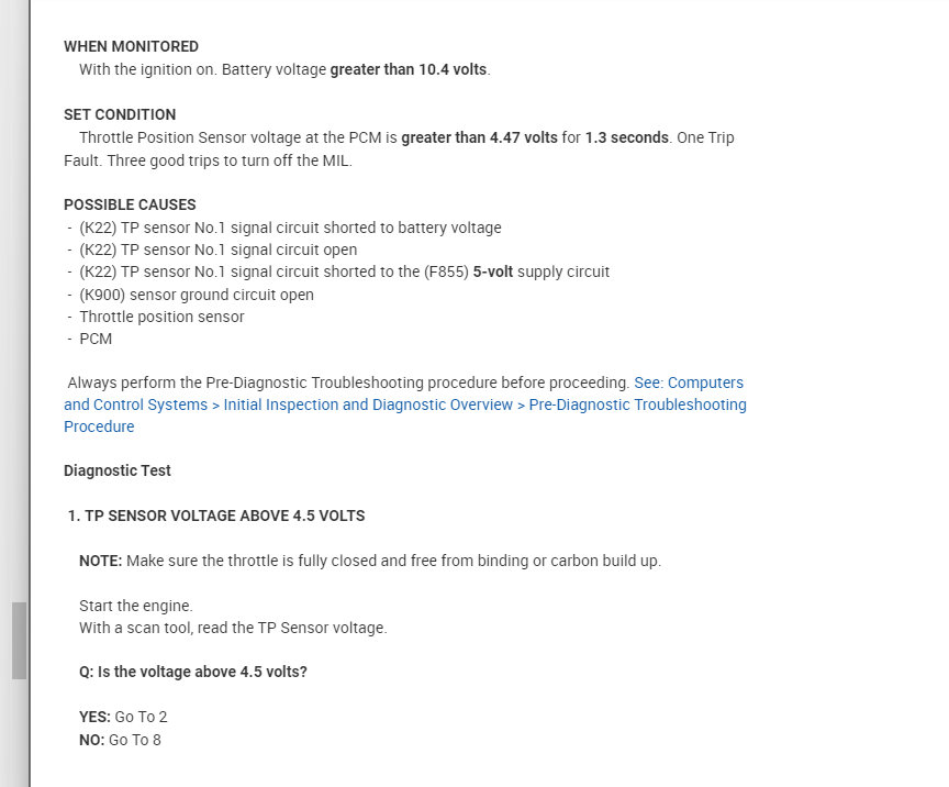

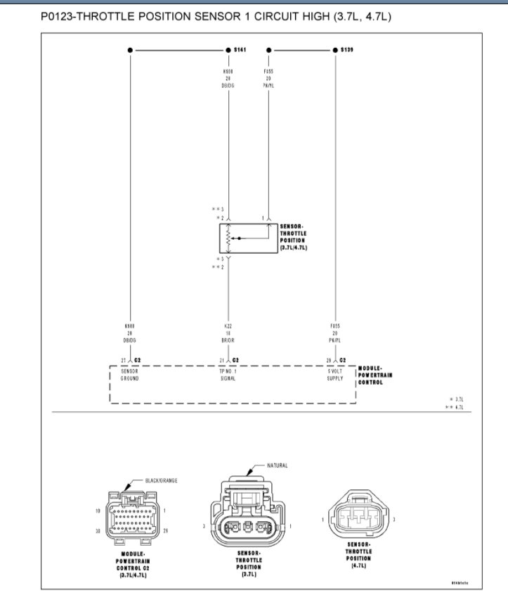

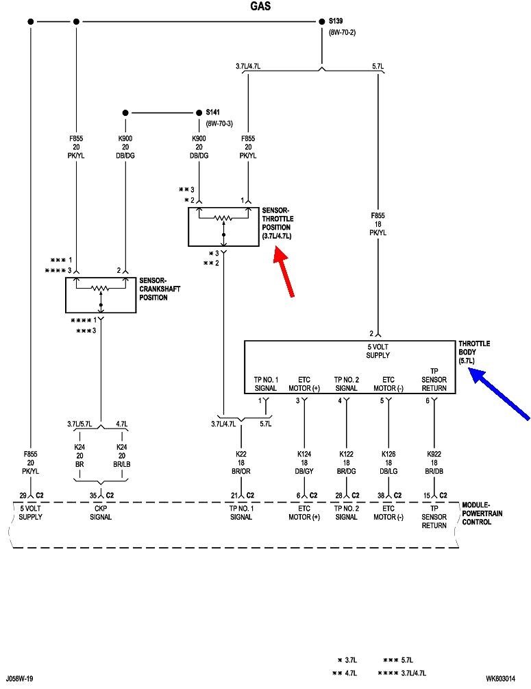

P0123 - Throttle/Pedal Position Sensor/Switch A Circuit High Input

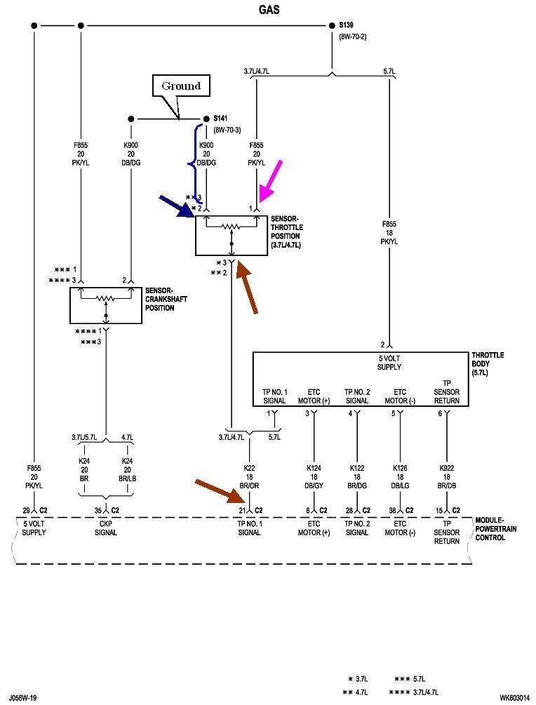

Dandy. Since you already replaced the sensor, there's only two things that can set this code. We know 5.0 volts has to be getting to the sensor on the pink / yellow wire so that circuit is okay.

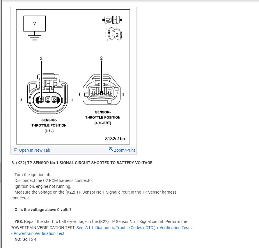

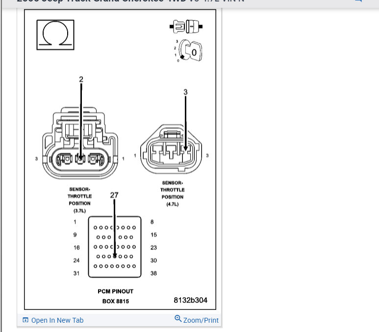

A break in the ground circuit will do this, but that circuit is shared with multiple other sensors Measure the voltage on the dark blue / dark green wire by back-probing through the rubber seal around the wire. Remember, these are only accurate if the connector remains plugged in to the sensor. You should find 0.2 volts. If you find 5.0 volts, there's a break in the section with the blue bracket. If it was in any other part of that circuit, you'd have fault codes for other sensors and the engine wouldn't run
The signal circuit can be more confusing. First, if you do find a break in the dark blue / dark green ground wire, there will be 5.0 volts on the brown / orange signal wire too. Any voltage outside the standard range of 0.5 to 4.5 volts is what sets these codes, and the only way to get these voltages is by having a break in one of the circuits.
If the ground circuit does have 0.2 volts, but you find 5.0 volts on the brown / orange signal wire, there has to be a break inside the sensor, or between one pair of mating terminals in the connector. The 5.0 volts gets there through a "pull-up" resistor inside the Engine Computer. That resistor is tied internally to the regulated 5.0-volt power supply, but it is so big electrically that when the circuit is working properly, it has no effect. It's only when a defect exists that it puts the 5.0 volts onto the signal wire to force the defective condition to be detected.
Now for the confusing part. Once you understand how these sensors work, the diagnosis can be sped up by taking just one voltage reading. That's on the signal wire as you work the throttle from "idle" to "wide-open-throttle" by hand. You should see a smooth change from 0.5 to 4.5 volts. The only way to get that proper operation is if the 5.0-volt feed and ground circuits are okay. No need to test them. Those voltages are for training purposes. In actual practice, you might see 0.72 to 4.2 volts, for example. The exact values aren't important and will be different for every throttle position sensor you install. The point is it must never reach 0.0 or 5.0 volts.
What we're looking for here is if you find that proper voltage sweep at the sensor, but the computer is seeing 5.0 volts all the time. The only way to know that is to see it on a scanner while viewing live data. The same voltage has to be seen at both brown arrows in this diagram. The only way they can be different is if there's a break between those two points. Here again, with a break in the brown / orange wire, the pull-up resistor will put 5.0 volts on that signal terminal inside the computer to force the defect to be detected.
Tell me what you find with these voltage readings. Be aware too, especially with spread connector terminals, these defects can be intermittent. A momentary break when you bounce over a bumpy road is enough to set the fault code, but the circuit could go back to proper operation. This is where fault codes can seem to have an elusive cause. The best way to work on that type of problem is to take a scanner along on a test-drive.

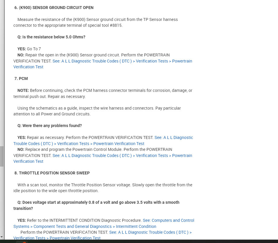

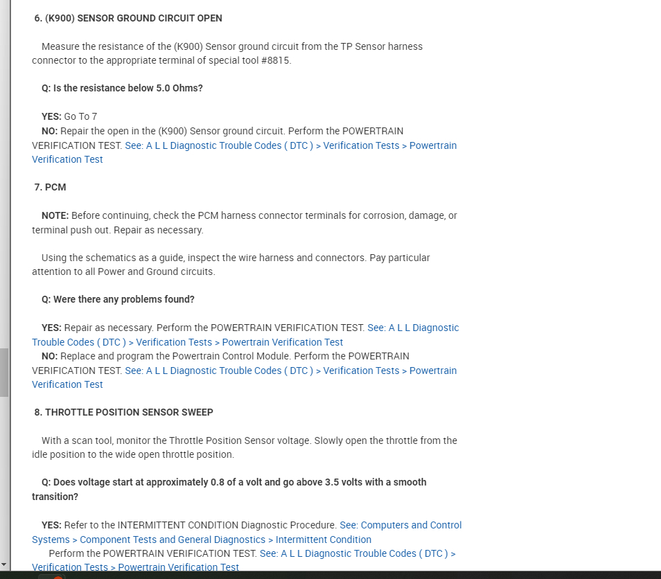

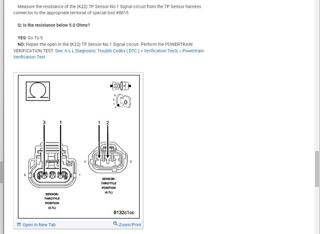

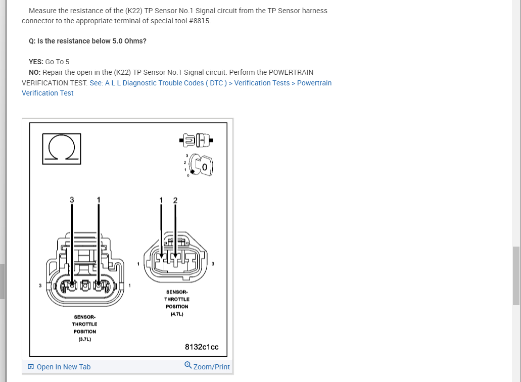

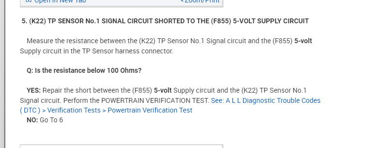

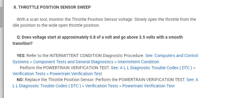

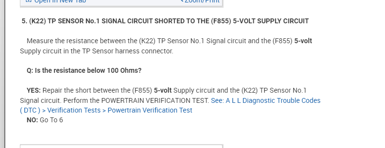

Just reading through this info, I want to be sure we are providing the testing from the manual.
It sounds like your PCM is the issue, but we need to run through this specific testing and confirm this.
Basically, if unplugging the TPS causes the issue to stop causes then the issue is in the 5-volt supply being sent to the TPS, the wiring, or the TPS.
If the TPS has been replaced and it is still acting up, there is a chance that this is wiring but that is less likely. However, this testing will prove that out.
I am sure you will find the answer by running through this testing so run through this and let me know if you have questions on any portion of this.

.02 volts is correct. Basically, this is a ground circuit where you would expect to find 0.00 volts. The difference here is many sensors have their ground wires tied together, then that circuit goes to ground through the Engine Computer. That's so the computer can monitor that circuit. The .02 volts is what is "dropped" across the monitoring circuit. Normally voltages that low we would call "0" volts, but every once in a while, someone is sharp enough to see that little voltage and question it.
I still want to know the exact range of signal voltage you see on the brown / orange wire. That will instantly tell us if the sensor is working correctly.

You still haven't posted the voltage readings I need. For the "4" and "5" you listed, are those engine speed as in 400 rpm, or 4.0 volts for the throttle position sensor reading?
Your mechanic would have used a scanner, so we know we have access to the information we need. All of the voltage tests I listed can be boiled down to just one thing on the scanner. That's the "TPS Signal Voltage". It must vary between roughly 0.5 to 4.5 volts from idle to wide-open-throttle. If that is what's seen on the scanner, that is what the computer is seeing, and that range can only occur if every other part of the circuit is working. At that point no other tests are needed or will provide any useful information.
The fault code(s) should be erased, then observe if and when it sets again. If it sets again immediately, there is a defect that is occurring right now and should show up as a wrong TPS signal voltage on the scanner. If the code comes back later, typically during a test-drive, we're looking for an intermittent problem. This is where spread or corroded connector terminals become the best suspect. Wiggling wiring harnesses might make the defect show up. Watching the reading during the test-drive can also help by showing what it takes to make the defect occur.
