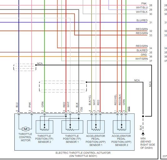

My car threw a "check engine" light, and I went to O'Reilly's and they checked the code and it was something to do with what seemed like my throttle positioning sensor. Little bit later in the week, the RPM's would surge up and down, and the gas pedal would randomly stop working. My throttle positioning sensor is attached to the whole gas pedal, so I got the new part, and replaced it. It cleared the symptoms except the check engine light, and then in the next couple days, the check engine light went off. Four days after replacing the part, every single symptom I back, and I am madder than mad. Any solutions? Could it be a vacuum hose? Could the fuel filter be going out? I have no clue, and I do not have to money to take it to the shop. Help, please.

First thing we need is the codes. It may not be a part issue. It could be wiring, but we need the codes to help narrow the area of failure.

Well, last time it was checked it threw three codes. We literally just changed it ten minutes before we checked it again. It is now throwing six codes. They are as follows:
P2101 Throttle actuator control motor circuit range performance (confirmed)
P0223 Throttle/pedal position sensor/ switch b circuit high input (confirmed)
P0123 Throttle/pedal position sensor a circuit high input (comfirmed)
P2135 Throttle/pedal position sensor/ switch a/b voltage correlation (confirmed)
P2101 Throttle actuator control motor circuit range/performance (pending)
P2135 Throttle/pedal position sensor/switch a/b voltage correlation (pending)
Mechanic friend is saying that it maybe a secondary sensor, or the motor on the actual throttle.
Jul 25, 2018 at 8:32 AM
Okay, the common denominator is is wiring. You have a harness issue. The wiring needs to be checked.
I would find another mechanic. He should have seen this on his own. If he did not then he is not familiar with these systems.
I attached a wire diagram for you to view. All this needs to checked and verified.

Okay.
First, clearing codes does nothing at all. The issue is still there and needs to be addressed. It will return with the same issues until it is diagnosed and repaired.
They need to inspect the harness carefully for any damage. The connectors need to be checked for damaged or burned pins.

The harness I am referring to is the harness at the throttle body. Tell him to follow it. Tell him to check all the connectors and look for any damage.
