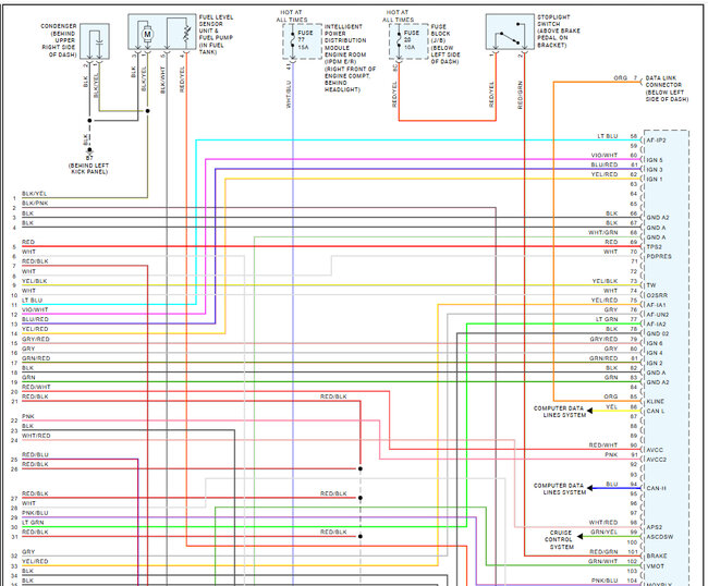

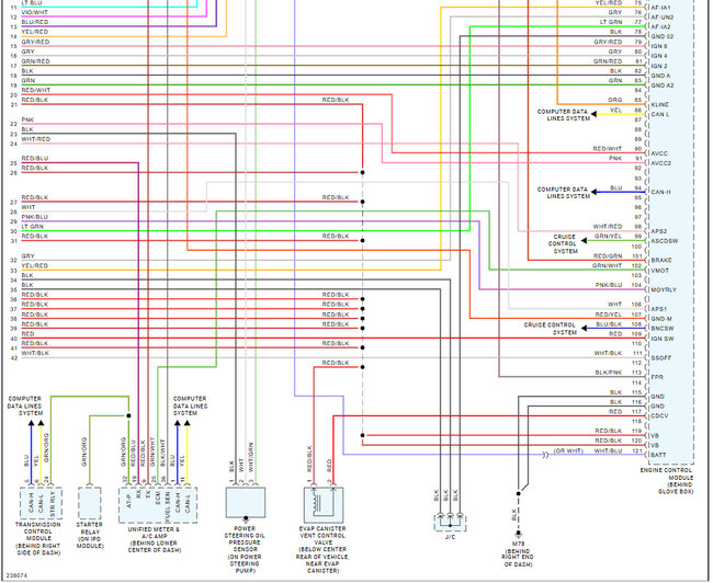

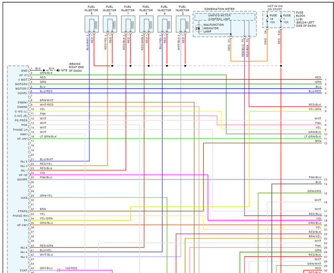

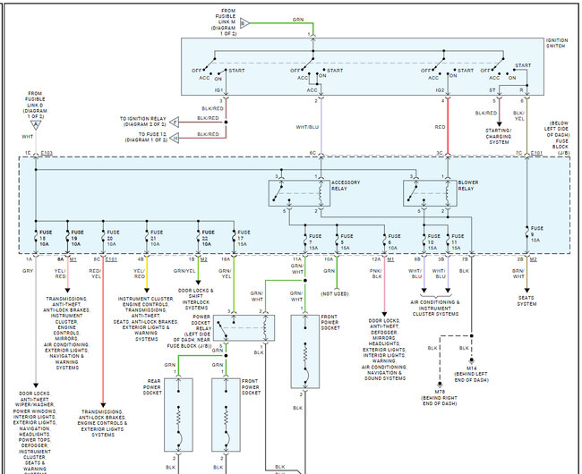

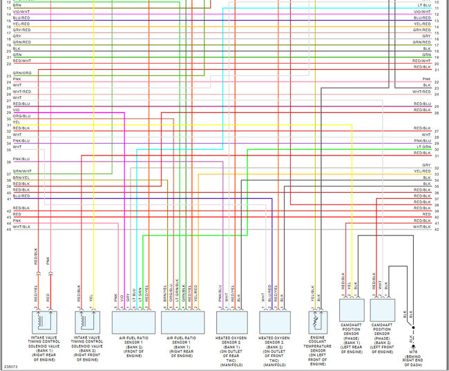

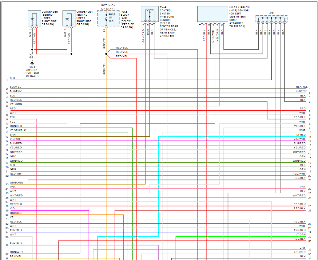

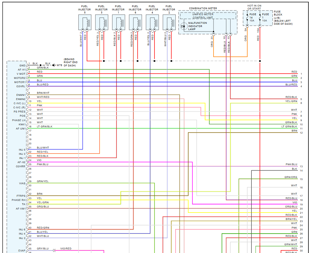

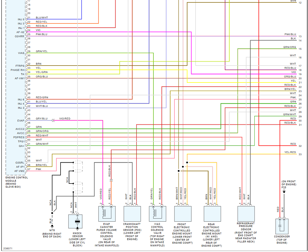

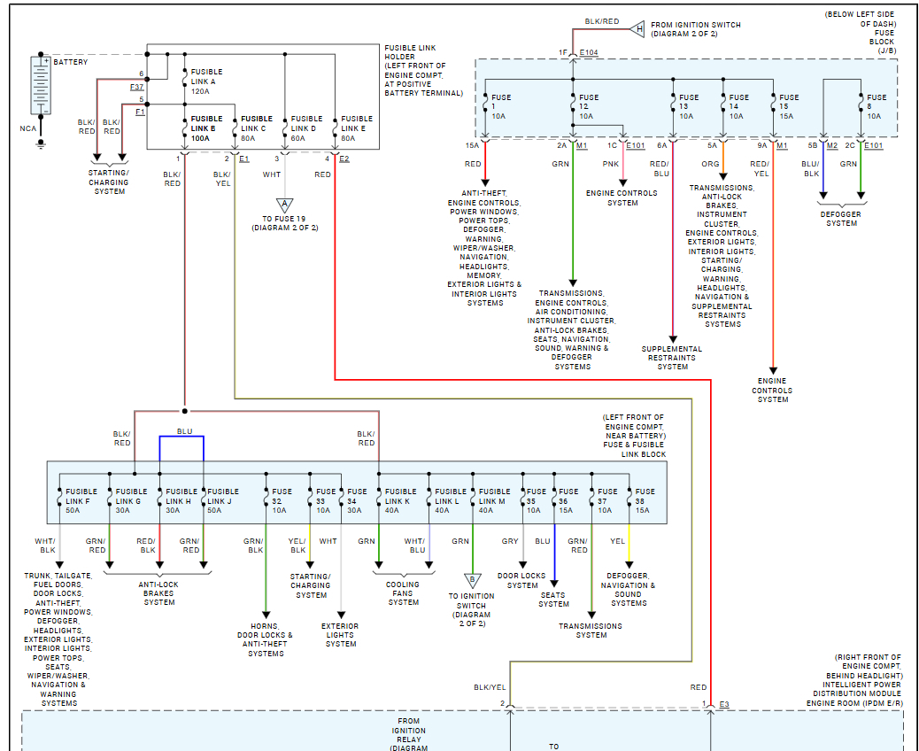

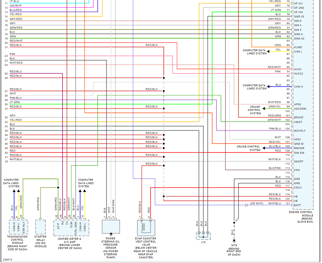

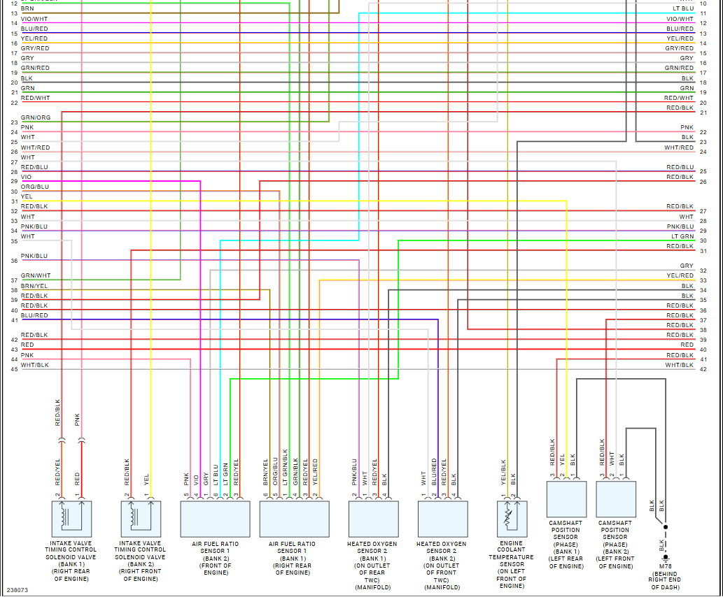

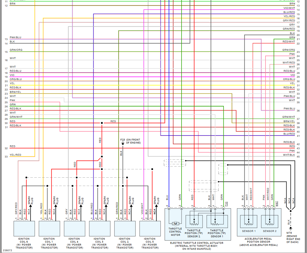

Thank you, the code that can cause all of this is the P2100. Before replacing the PCM let's check the wiring between the throttle body and PCM. Here is a guide to help and the wiring diagrams below to show you which wires to test.
P2100 - Throttle Actuator Control Motor Circuit/Open
P2101 - Throttle Actuator Control Motor Circuit Range/Performance
There are only five wires to test, here are the wiring diagrams for the throttle body, engine and PCM. Look for rodent damage while you are testing. Here is the location of the PCM as well. Check out the images (below). Please let us know what happens.

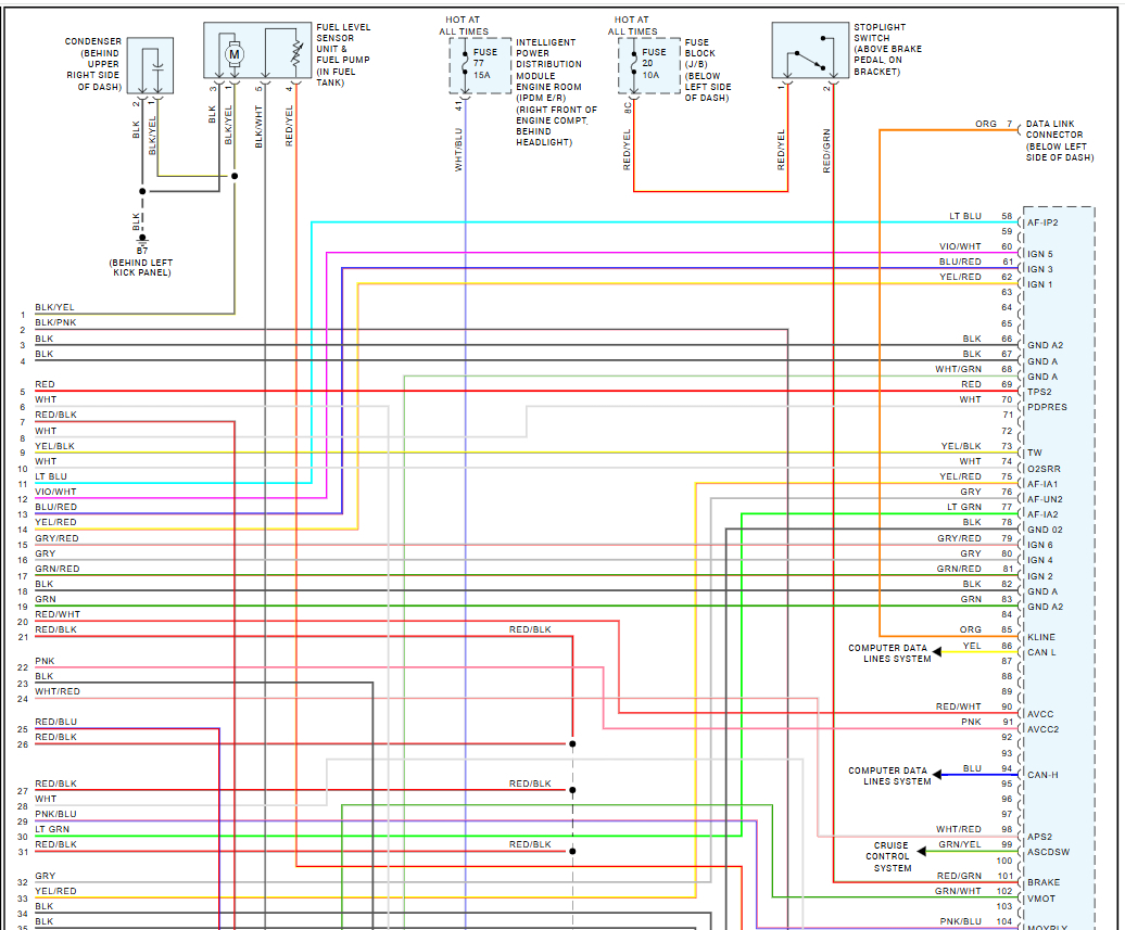

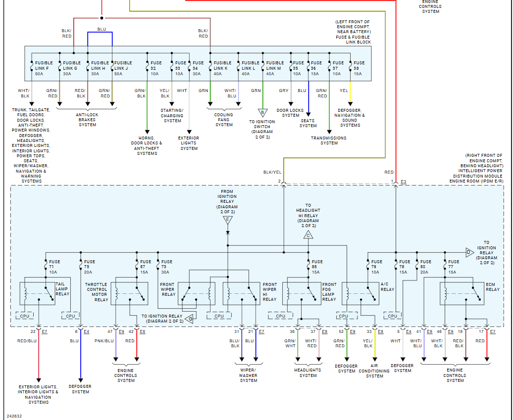

Hi, thanks for the reply. That was the information I was looking for; I really appreciate it. I followed the diagrams and found the following.
ECM is not receiving the 12 volts (pin 3) from the IPDM (from relay) i changed the relay and still no 12 volts coming out. I bypassed the relay and i jumped cable from battery (positive terminal) to the ECM Pin 3 and boom my throttle body is working like new.

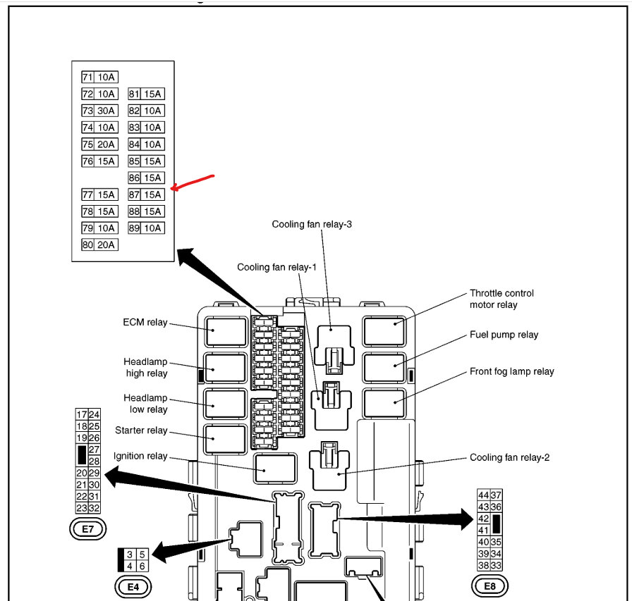

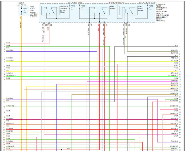

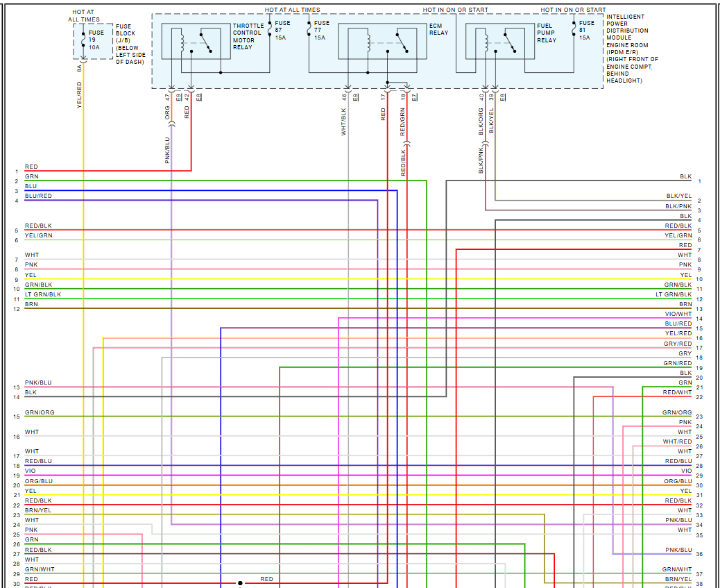

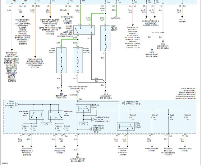

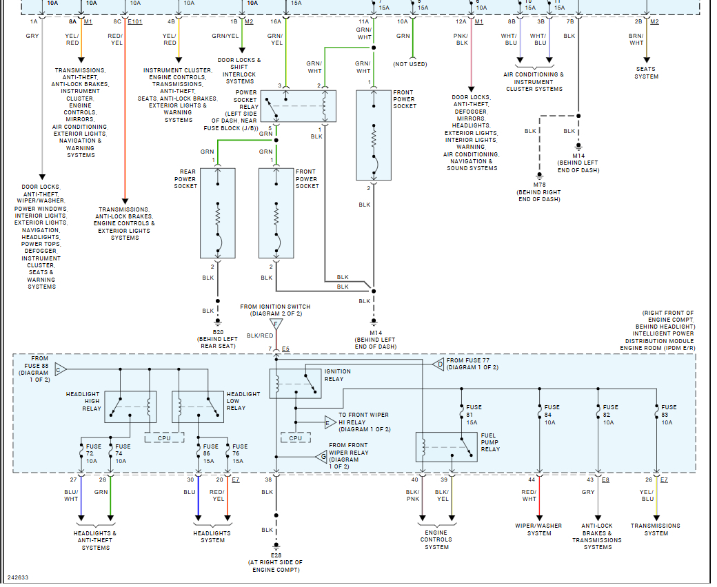

Can you please help with IPDM diagram to see what pin/terminal feeds the ground to the throttle relay?
For some reason realy is not engaging (clicking) to send the 12 volts to ECM.
Mar 19, 2025 at 1:38 PM
  • 55,214 POSTS
Great work! I would check for power at the fuse #87 15 amp this is where the power comes from. If there is no power the TIPM is bad. Here are the TIPM wiring diagrams as requested, you can see the power of the throttle control relay is from a fusible link C but it would affect other systems as well. Check out the images (below).
