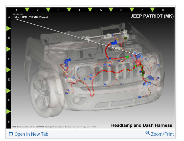

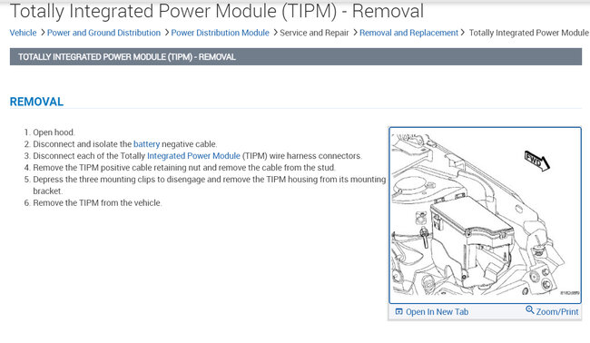

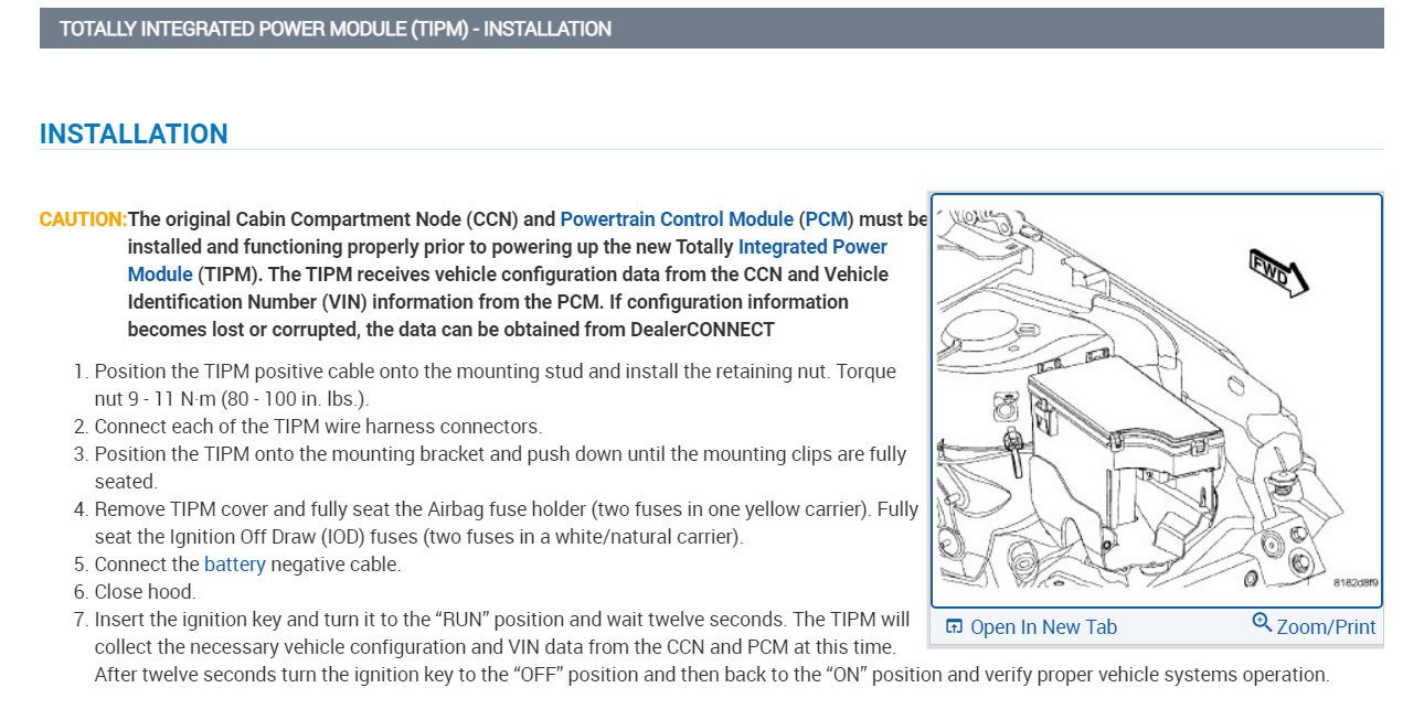

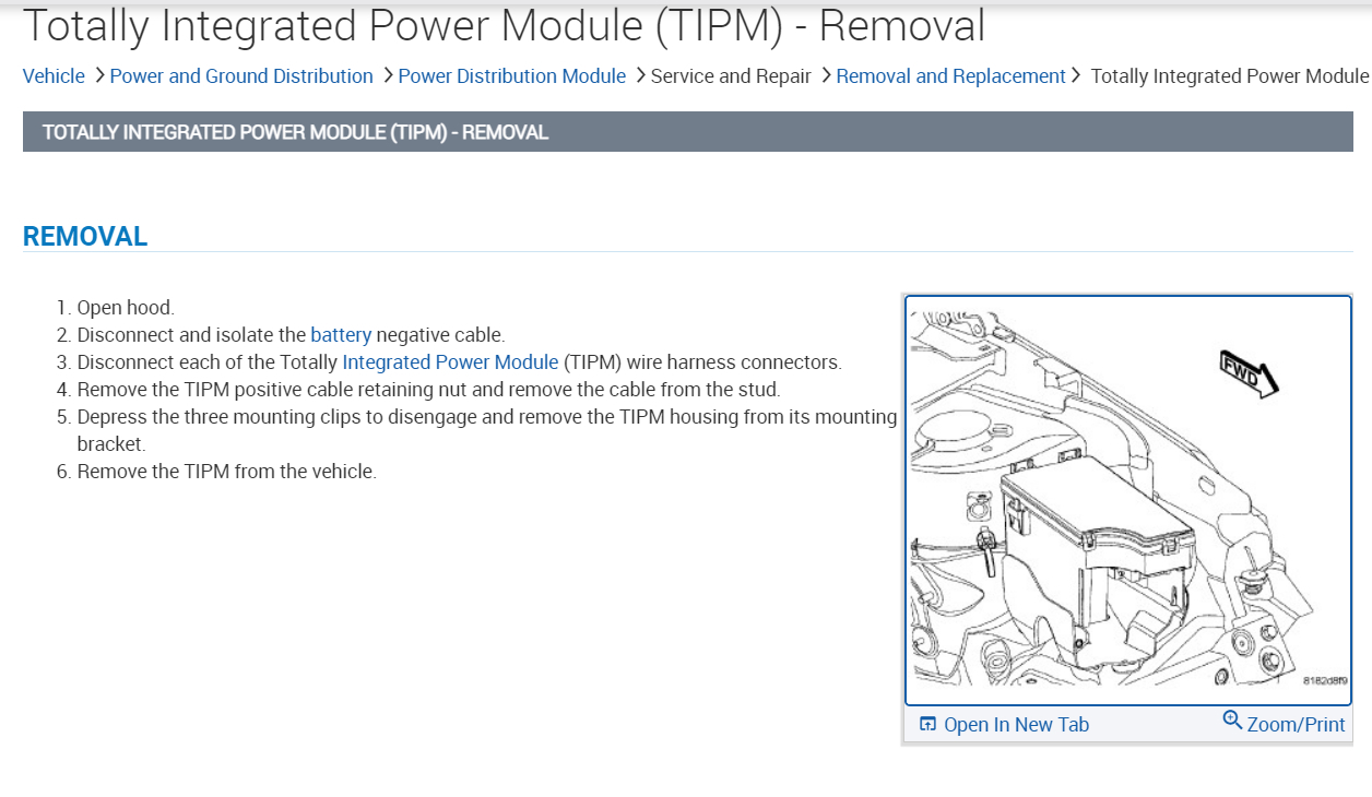

Yes, it can be a rodent problem which is common but to me it sounds like the TIPM has gone out which is a big problem with these cars. It is easy to replace because it-self learns. here is the location of the part and how to replace it in the diagrams below but a CAN scan would be helpful to confirm the failure. You can get a CAN scanner (Controller Area Network) which will work on most cars from Amazon.
https://youtu.be/u-4syLc-ifQ
and
It takes about .5 hours to replace and the shop rate please the parts price which rebuilt you can find for about $400.00 and new for about $800.00.
