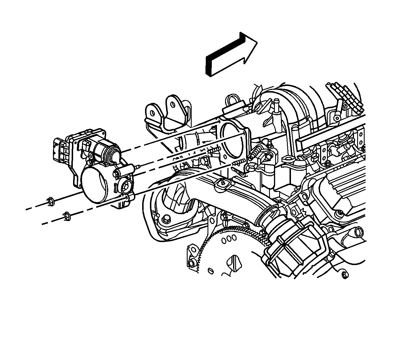

My car suddenly slowed from 65 mph to 40 mph check engine light came on. Went to auto parts after the scan he said throttle body actuator was malfunctioning. Question is, how difficult to replace? I went to dealer the part is over $400.00. I do not want to mess up the part. And does the scan answer sound correct?
Nov 2, 2018 at 12:02 PM
  • 110,240 POSTS
It is possible that is the problem. However, I would rather see the code they found to make a better determination.

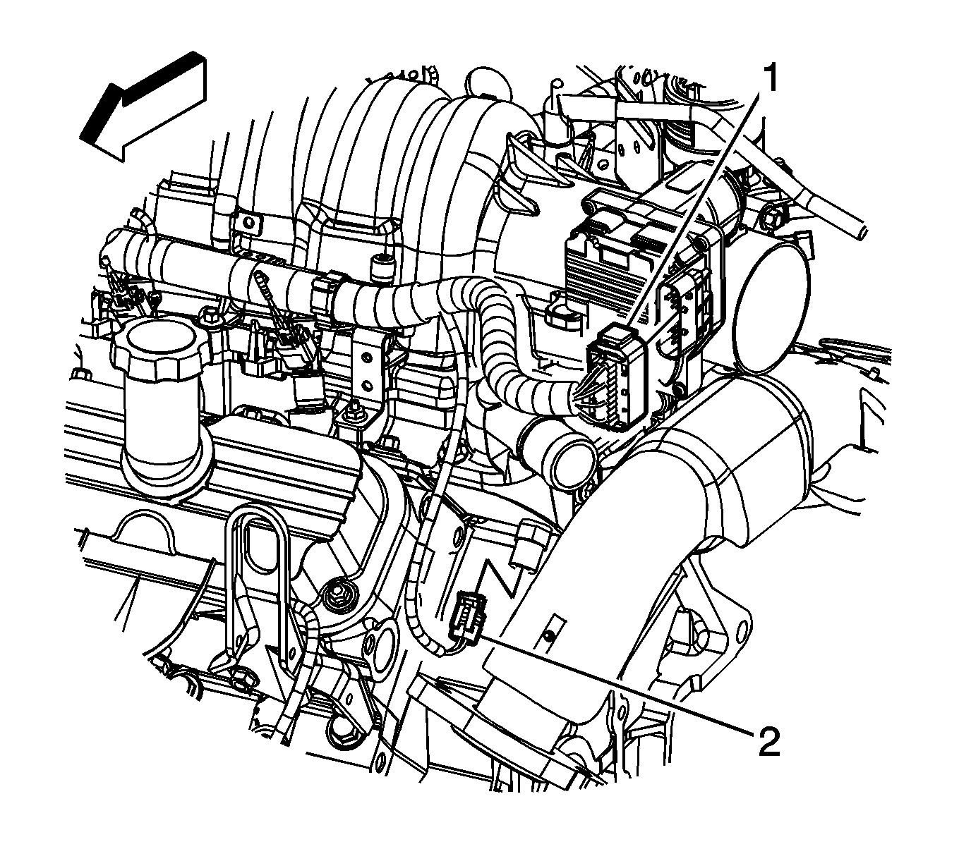

As far as replacing the part, it is not hard. Here are the directions. All attached pictures correlate with these directions.
___________________________
Throttle Body Assembly Replacement
Removal Procedure
1. Remove the air cleaner outlet duct.
2. Remove the secondary air injection (AIR) feed tube, if equipped.
3. Disconnect the engine harness electrical connector (1) from the throttle actuator.
4. Loosen the throttle body bolts.
5. Remove the throttle body nuts.
6. Remove the throttle body and seal.
Installation Procedure
1. Install the throttle body and seal.
2. Apply threadlock GM P/N 12345382 (Canadian P/N 10953489) or equivalent to the nuts.
3. Install the throttle body nuts.
Notice: Refer to Fastener Notice.
4. Tighten the throttle body bolts/nuts.
Tighten the bolts/nuts to 10 N.m (89 lb in).
5. Connect the engine harness electrical connector (1) to the throttle actuator.
6. Install the AIR feed tube, if equipped.
7. Install the air cleaner outlet duct.
