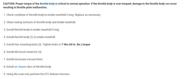

My throttle body light (the red lightning bolt) came up on my dashboard. But if I turn the car off and back on it goes away. When this happens the check gauges come on and the temperature gauge stays on C. Is there something wrong with the throttle body or is it not a concern? Note: I just got the radiator and thermostat changed. So, the temperature gauge is in working condition. Note: then sometimes I turn the car on a boom nothing on the dash car is working fine.

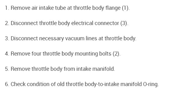

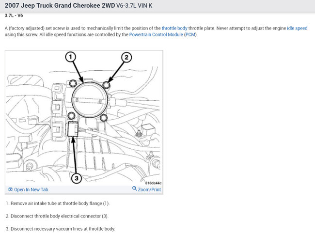

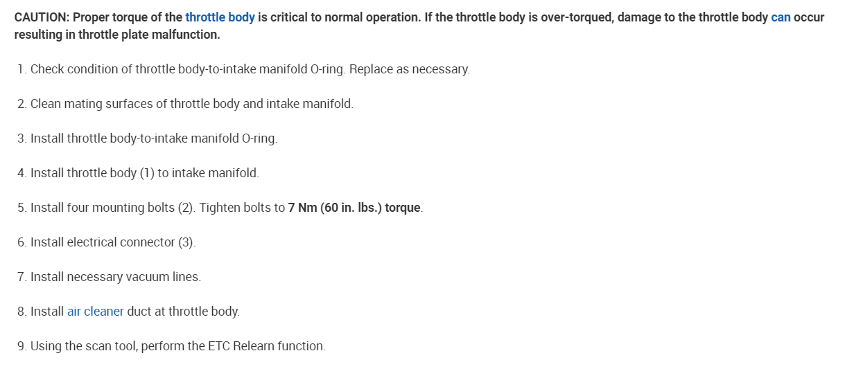

Yep, this happens when the throttle body needs to be serviced. here is a guide to help and I have instructions for your car in the images below.
Check out the images (below). Please let us know if you need anything else to get the problem fixed.
