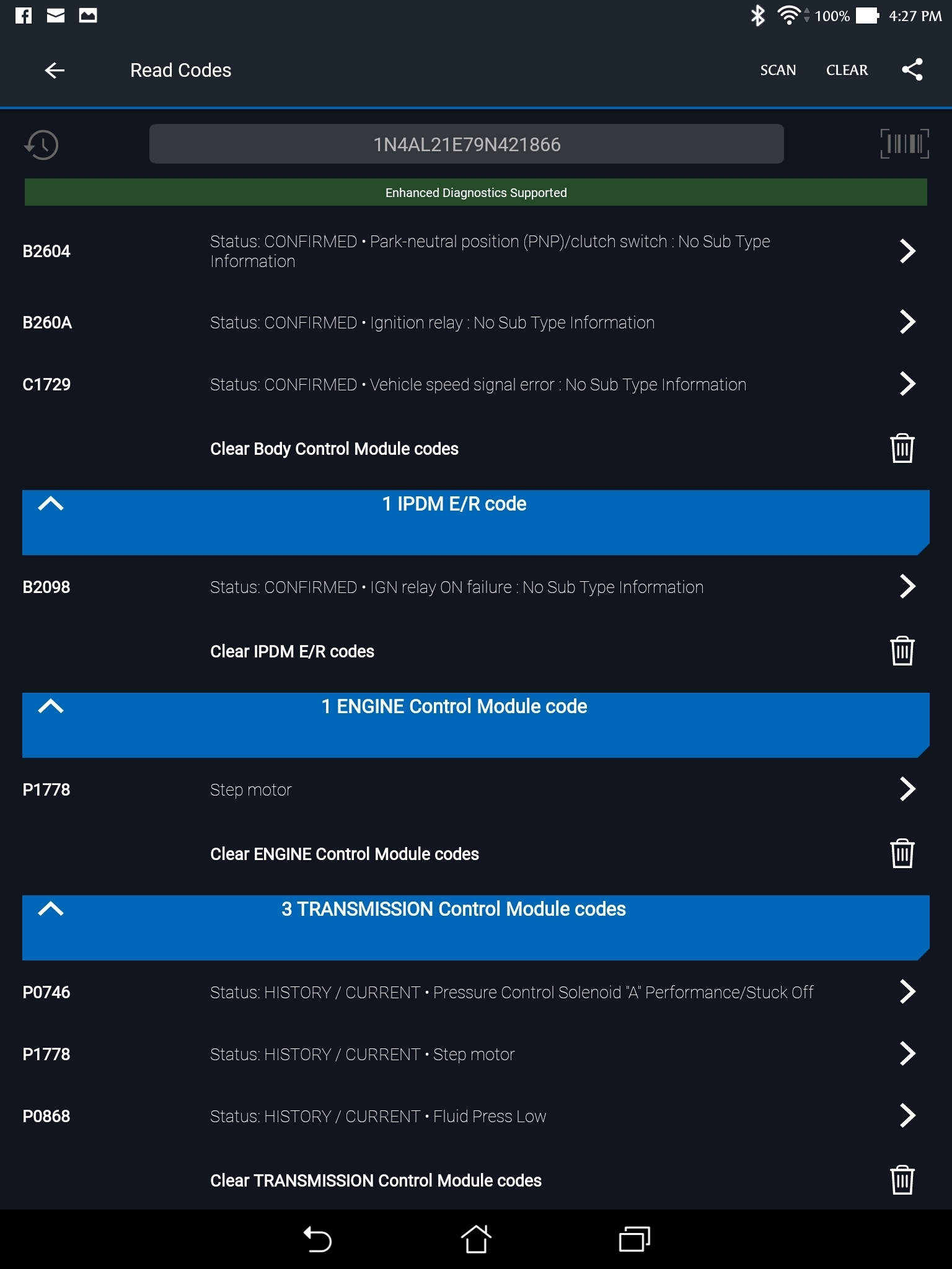

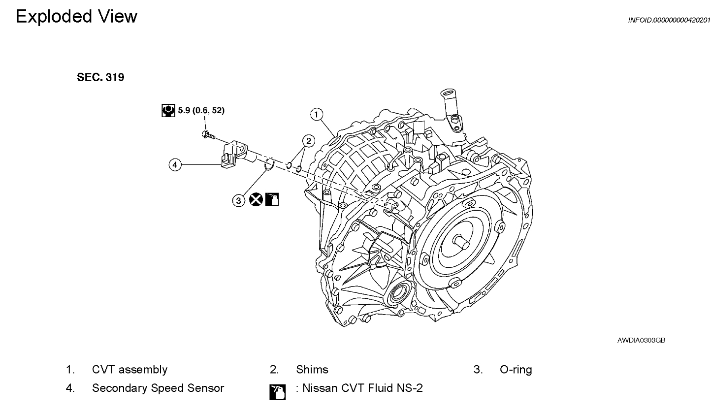

This vehicle has transmission noise and after which the owner replaced used transmission assembly and after being assembled, the vehicle stopped shifting gears and it was brought to my workshop and I diagnosed it and detected.
1. P1722: estimated speed signal
2. P1778: step motor function
3. P0746: pressure control solenoid A performance/stuff off
4. P0868: Secondary pressure down.
Then I replaced the valve body from the old gear, and I still used the step motor from the gear purchased because the step motor of old gear was broken. So, I test drove it and it didn't shift gear and I diagnosed it again, it return
P0746, P0868 and P1778. I checked transmission fluid and filter and CVT circuit from TCM to CVT UNIT, all checks okay. What could be the problem of this gear? Is it transmission pump that starves those solenoid oil and TCM is seeing it as a fault?
I attached the screenshot of the diagnostic report.
Jul 25, 2022 at 1:42 AM
  • 55,433 POSTS

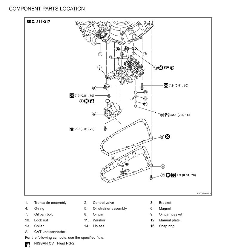

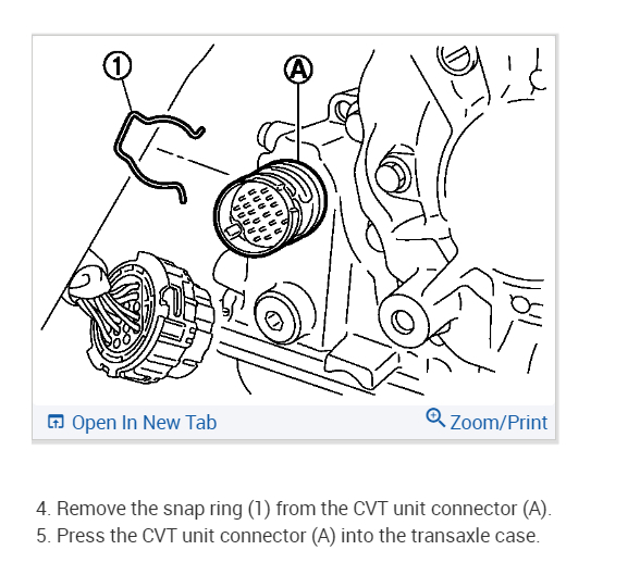

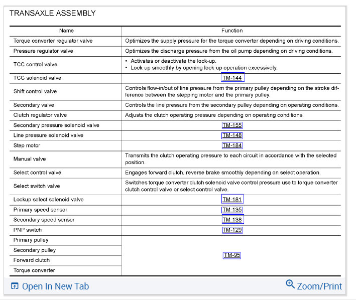

The P0746 code stands for “Pressure Control Solenoid “A” Performance/Stuck Off if this not working it will not operated correctly, also I seen the PC1729 no speed signal which will cause the same issue. So i would replace the pressure control solenoid and the VSS sensor or make sure they are connected. Also check the main transmission electrical plug for dirt or corrosion. Here is the location for both in the diagrams below. Check out the diagrams (Below). Please let us know what happens.
Jul 25, 2022 at 9:55 AM

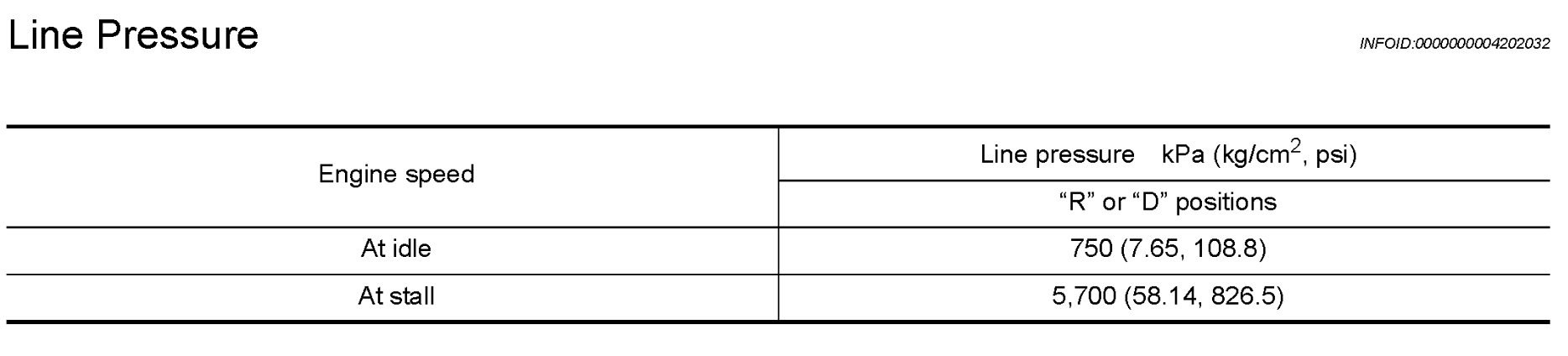

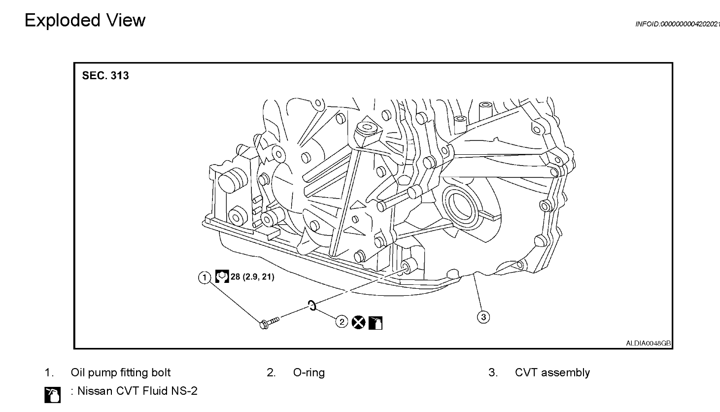

Okay! Thanks once again, I will change the vehicle speed sensor and also the Pressure control solenoid A as you said though you didn't show me the location of pressure solenoid A on the control valve but where I am looking at is the Transmission Pump since there are fault codes P0746 and P0868 indicating pressure issues because low pressure from failing transmission pump can make the computer to see the Pressure switches as being faulty whereas there's no oil pressure from the pump to operate the Pressure switches. Please show me how to test the TRANSMISSION PUMP while the engine is idling?
Jul 25, 2022 at 7:00 PM
  • 55,433 POSTS

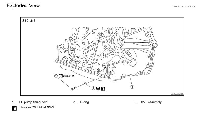

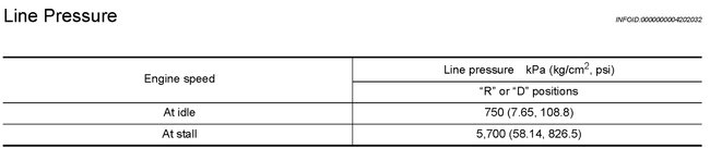

Here you go, this is how you can check the line pressure in the diagrams below.
Jul 27, 2022 at 5:17 AM
MALLYBOY
  • 329 POSTS
I have tested the pump by removing the hose from transmission housing to cooler housing and it checked okay. I test drive the vehicle and it didn't shift and I re-diagnose it and

Yes, the solenoids are pretty straightforward, two terminals connect a DVM to each and measure the OHMs it should close to zero. Also, you can put 12 volts to them, and you should here a click telling you they are working. The stepper motor and will need to go into the scanner prompt to see they offer that option.
