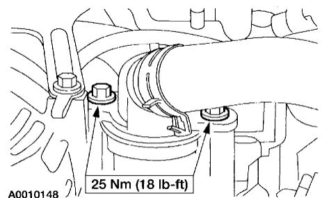

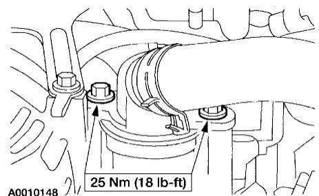

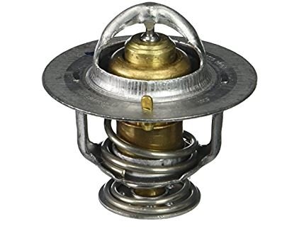

Well, the first thing I would do is scan it for codes, with your description I would expect a P0128. That is a code meaning the thermostat isn't working correctly and the engine isn't heating up. The easy solution is to drain the cooling system and replace the thermostat. As you have questionable coolant I would probably do a drain and flush just to get whatever is in there out, then install the new thermostat. On that engine you just remove the engine cover, then drain the coolant down and remove the two bolts, then lift off the thermostat housing and pull out the thermostat. Clean up the surfaces and install the new thermostat and gasket and tighten it back down. It uses plain green coolant or you can use the gold, which is still conventional coolant but more $$. Total capacity is close to 5 gallons. Make sure you get the correct thermostat as that car uses a bypass that gets closed as the thermostat opens. Ford # 7L3Z-8575-B
The code should clear itself once the thermostat works properly or you can clear it.
