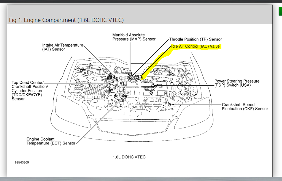

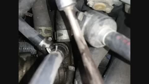

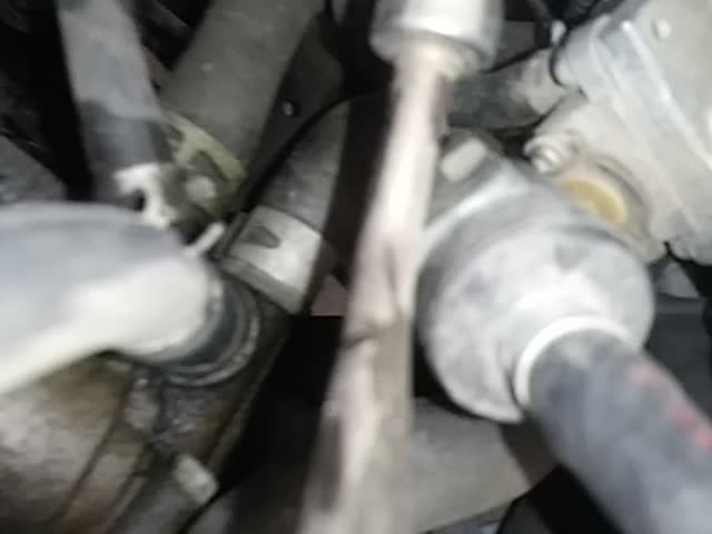

The thermostat housing one of the sensors, it has two hoses one goes to the air box and is connected to the air box. but the other hose is not connected to anything. My cars throwing code P0172.

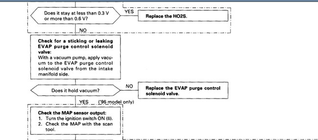

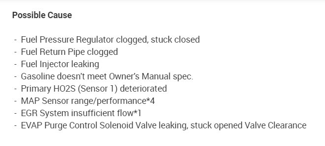

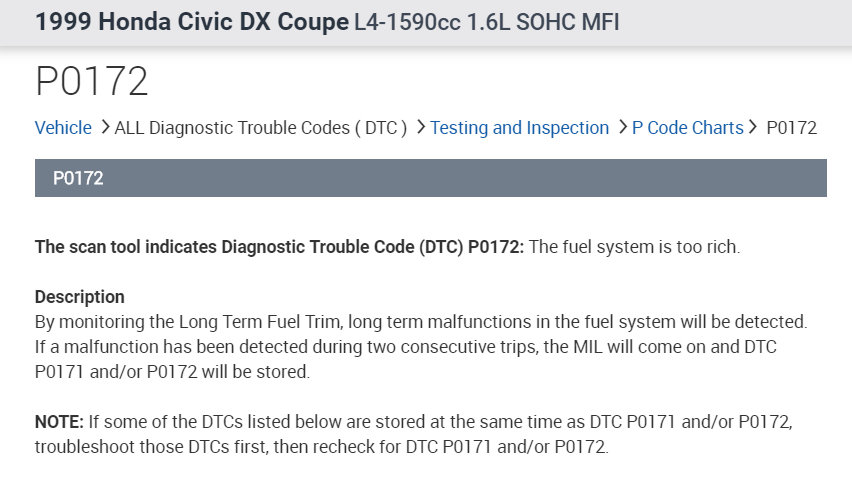

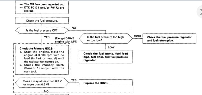

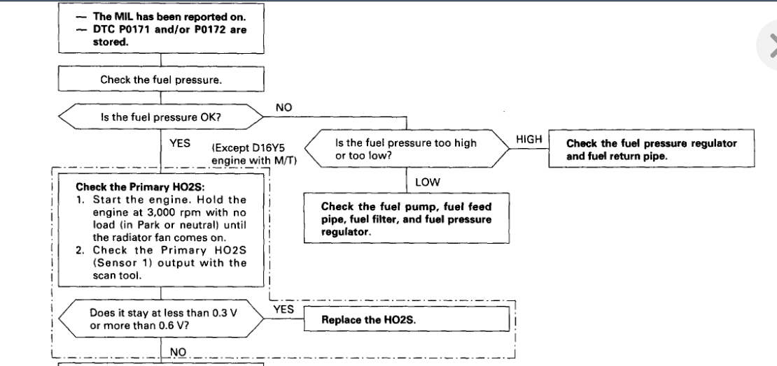

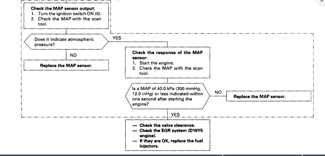

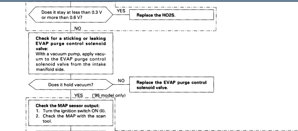

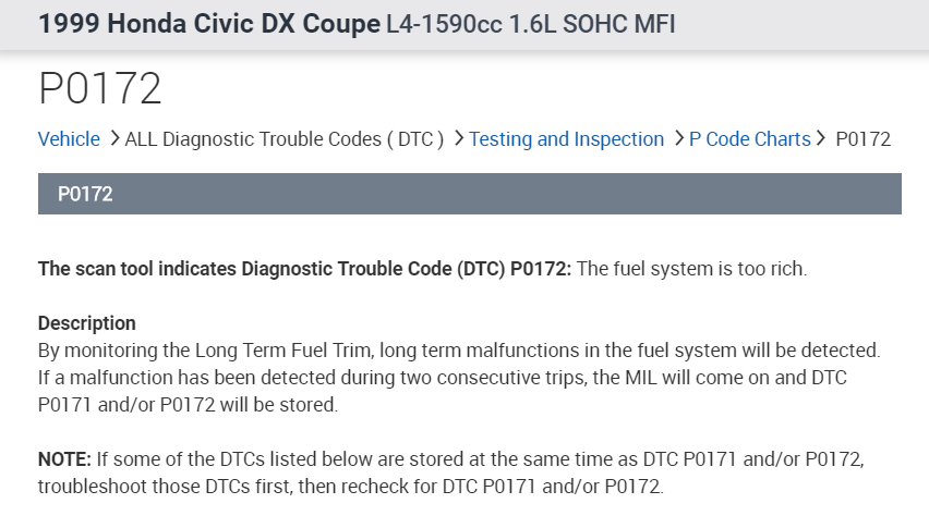

I can't really make a lot out from the video that you guys sent (thank you, by the way) but I think it is the Idle Air Control valve (IAC). If it is the engine uses this valve to bypass the closed throttle plate with air to keep the engine running when your vehicle is idling. If your vehicle is throwing Direct Trouble Code (DTC) P0172 then I have a factory troubleshooting flowchart for you that I have included in the diagrams down below. Please go through this diagram and get back to us with you find out and we can go from there. I have also included a diagram of the IAC valve. See if it corresponds to diagram in location as well to see if it's the right component from the video, please. And let us know , as well.

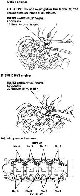

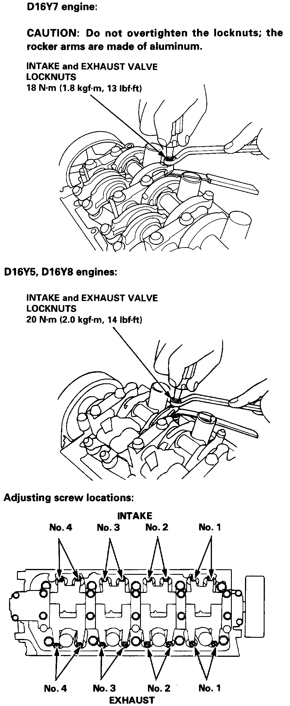

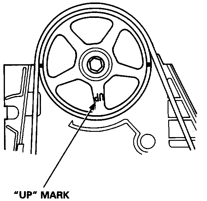

Hi, just to jump in and add to it. I recommend you check the valve clearance first. Very common problem with Honda where the exhaust valves get too tight and cause this condition. Here are the instructions on how to check and adjust the valves. I recommend you let the vehicle sit overnight and do the adjustment when cold.
Collision
Search vehicle information
17
1999 Honda Civic DX Sedan L4-1590cc 1.6L SOHC MFI
Adjustments
Vehicle Powertrain Management Tune-up and Engine Performance Checks Valve Clearance Adjustments
ADJUSTMENTS
NOTE:
- Valves should be adjusted only when the cylinder head temperature is less than 100°F (38°C).
- After adjusting, retorque the crankshaft pulley bolt.
1. Remove the cylinder head cover.
2. Remove the upper cover.

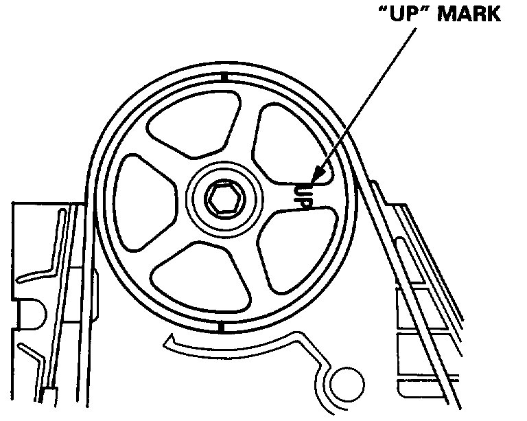

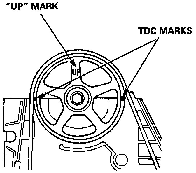

3. Set the No. 1 piston at TDC. The "UP" mark on the cam-shaft pulley should be at top, and the TDC marks should align with the cylinder head surface.
4. Adjust valves on No. 1 cylinder.
Intake: 0.18 - 0.22 mm (0.007 - 0.009 inch)
Exhaust: 0.23 - 0.27 mm (0.009 - 0.011 inch)

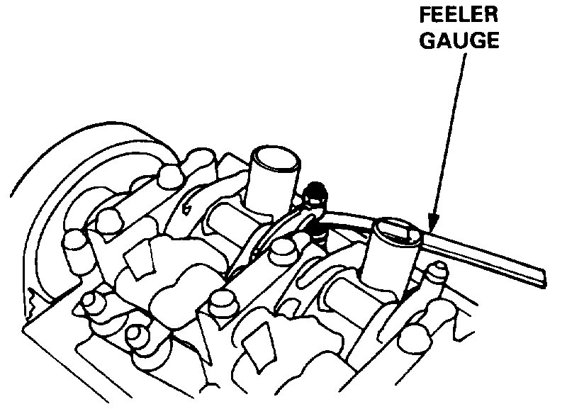

5. Loosen the locknut, and turn the adjustment screw until the feeler gauge slides back and forth with a slight amount of drag.
6. Tighten the locknut, and check the clearance again. Repeat the adjustment if necessary.

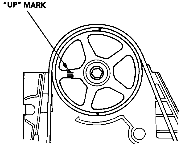

7. Rotate the crankshaft 180° counterclockwise (camshaft pulley turns 90°). The "UP" mark should be on the exhaust side. Adjust valves on No. 3 cylinder.
8. Rotate the crankshaft 180° counterclockwise to bring No. 4 piston to TDC. Both TDC grooves are once again visible. Adjust valves on No. 4 cylinder.
9. Rotate the crankshaft 180° counterclockwise to bring No. 2 piston to TDC. The "UP" mark should be on the intake side. Adjust valves on No. 2 cylinder.
Follow the firing order and let us know what the valve clearance looks like.
