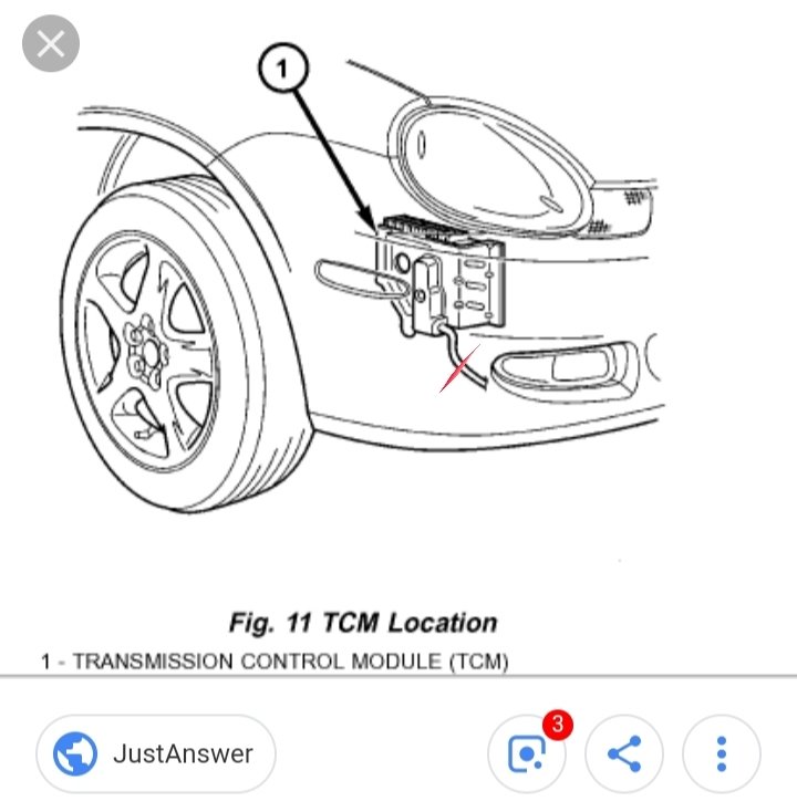

I ran something over on the right lower side of the car there's the TCM (transmission control module) the plug that goes bolted on to it with like thirty wires on it they ripped off. I got a used plug with replacement wires from a old car and spliced each wire and the car still isn't starting? Can anyone help me ?
Thank you!
The wires ripped where the red line is.

Good afternoon,
Does the engine crank?
Can you check for spark?
Do you hear the fuel pump run with the key on?
