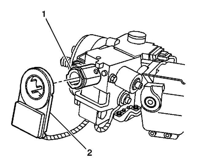

I took the car for a long block (re-manufactured) replacement. Now the car does not start. The shop says it’s the theft deterrent module. How can I reset it or do I have to replace it?

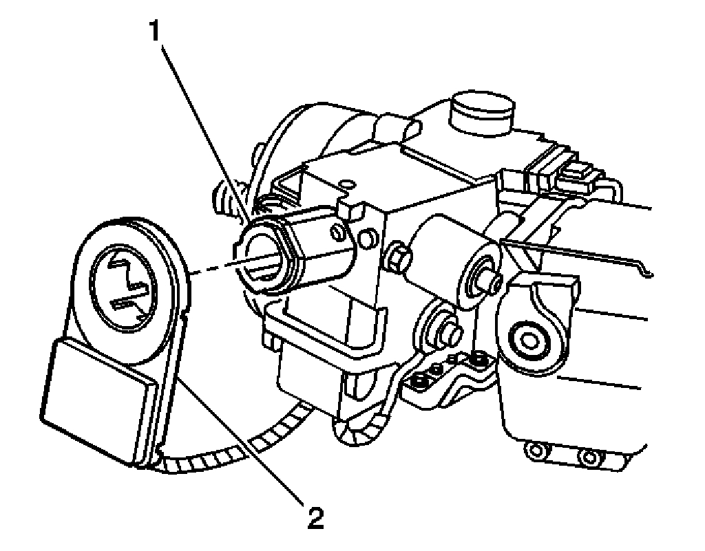

If the module needs replaced, here are the directions for that process. The attached pictures correlate with the directions. Note that the new module will need programmed.
___________________________________________________
2004 Buick Truck Rendezvous AWD V6-3.4L VIN E
Procedures
Vehicle Accessories and Optional Equipment Antitheft and Alarm Systems Alarm Module Service and Repair Procedures
PROCEDURES
THEFT DETERRENT CONTROL MODULE REPLACEMENT
REMOVAL PROCEDURE
1. Disable the SIR. Refer to SIR Disabling and Enabling Zone 3 in Restraint Systems.
2. Remove the trim covers.
3. Remove the theft deterrent module wiring harness from the steering column harness.
4. Disconnect the electrical connector.
pic 1
5. Pull the theft deterrent module (2) away from the lock cylinder housing (1).
INSTALLATION PROCEDURE
pic 2
1. Push the theft deterrent module (2), onto the lock cylinder housing (1).
2. Install the theft deterrent wiring harness to the steering column harness.
3. Connect the electrical connector.
4. Replace the steering column trim covers.
5. Enable the SIR system. Refer to SIR Disabling and Enabling Zone 3 in Restraint Systems.
6. Program the new theft control module. Refer to Programming Theft Deterrent System Components. See: Vehicle > Programming and Relearning
