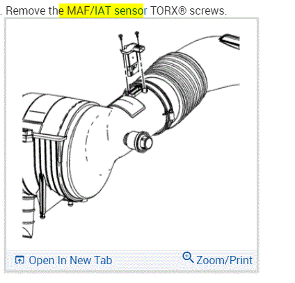

You indicated 2.32 HTZ at idle. My manual is indicating 2,300 at idle. Please confirm. Also, an EGR that is not fully closing can cause the 102 code. Have you checked that as well? Also, have you confirmed the air intake duct isn't collapsed or damaged?
At this point, if the above things have been checked and are in good condition, you really need to check for vacuum leaks which can be the issue causing both codes.

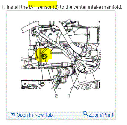

Additionally, the intake air temperature sensor is built into the MAF. However, there is an IAT 2 sensor on the intake. Have you checked both?

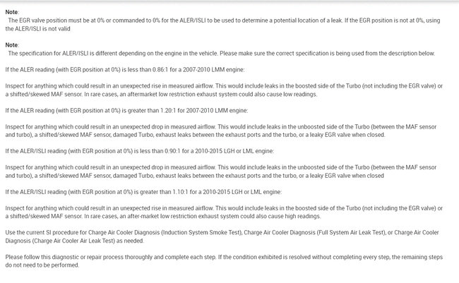

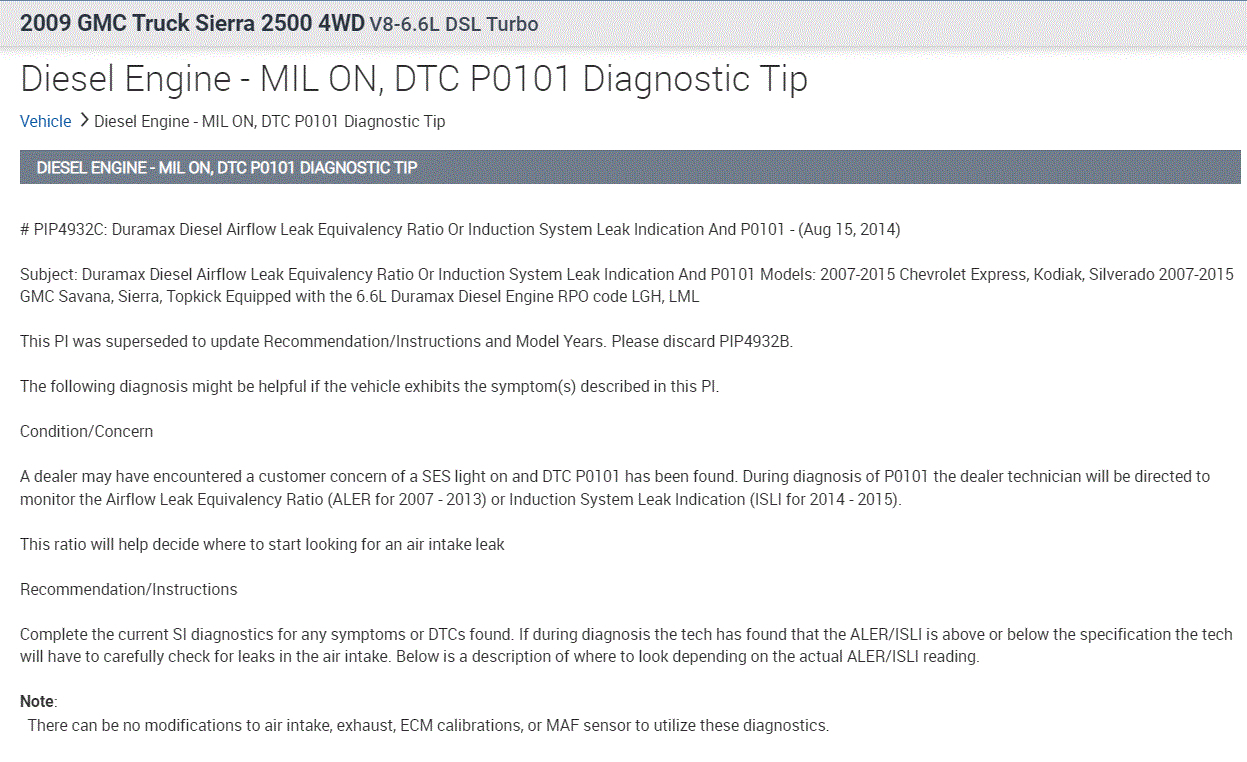

Let me know. Additionally, pics 1 and 2 show the locations of both IAT sensors. The remaining is a technical service bulletin related to the P0101. Both codes you have are tied together causing the same result (reduced power).
