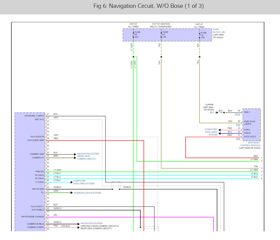

The meter that reads miles to empty is not updating
2018 NISSAN KICKS

It's not updating when I add gas at the pump?

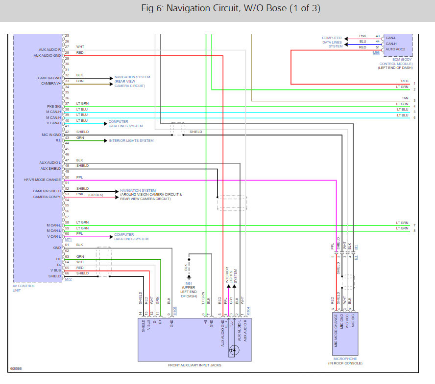

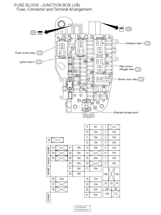

This is monitored by the navigation module, is there anything else that is not working? I would check all operations of the navigation to see if everything works. Also, let's check the fuses for system #36, 29 and 18 in the fuse panel on the left end of the dash. here is a guide to help and the fuse location in the diagrams below. If the fuses are okay a CAN scan will help you confirm the failure of the Nav module.
Here is how to do the CAN scan; it has a video in the guide:

Apparently it does it off and on.
Apr 29, 2022 at 10:22 AM
  • 54,837 POSTS
This is typical when the navigation module is going out. Did you do the CAN scan?
May 2, 2022 at 11:43 AM
SKOOTER24
  • 275 POSTS
It started back working once we filled up the gas, I'm go to my friend's house even if it's working the can scan will still show, correct?
May 2, 2022 at 12:08 PM
  • 54,837 POSTS
It should yes, but some intermittent problems will not show up. Please let me know.
