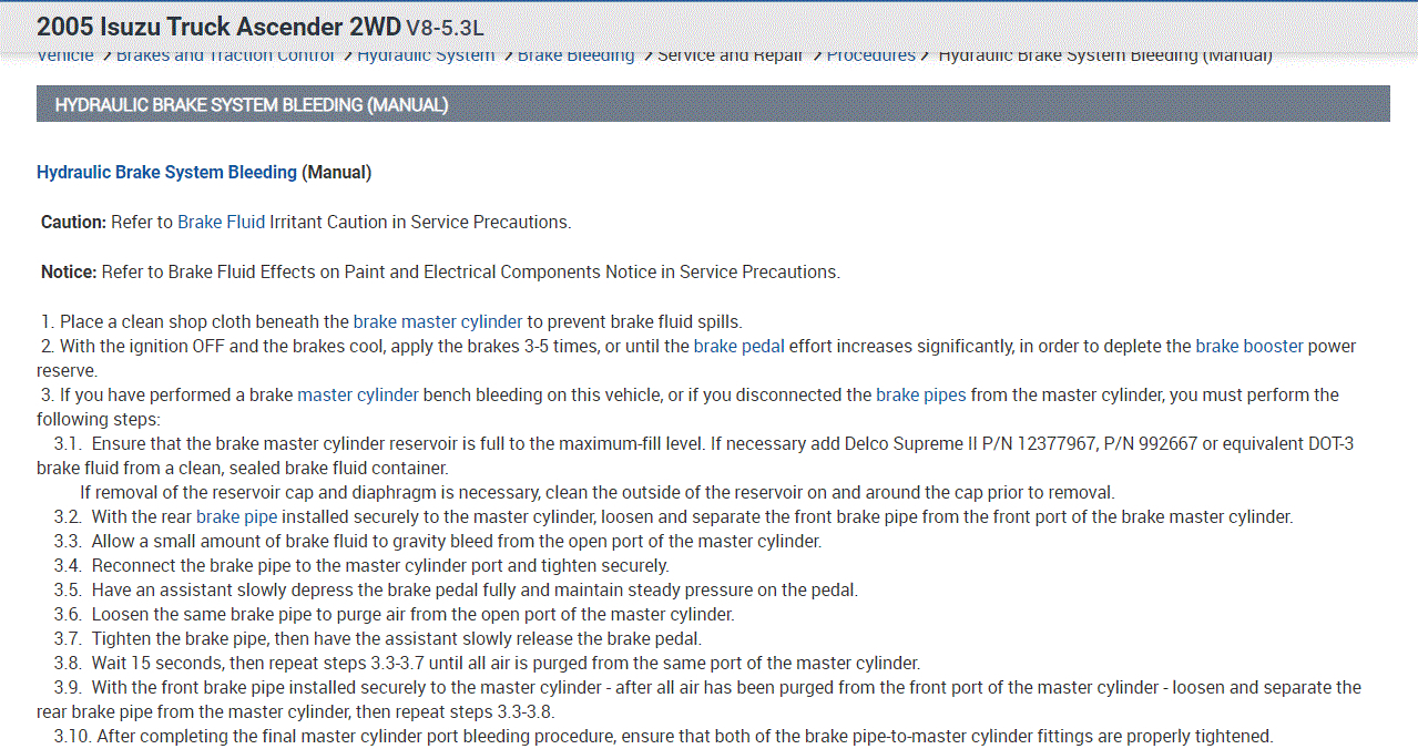

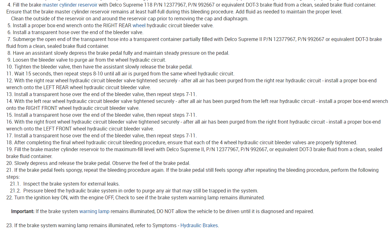

If you allowed the master cylinder to run dry, we have a lot of air to get out.

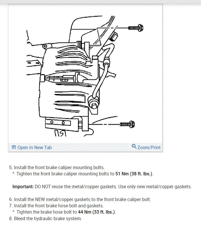

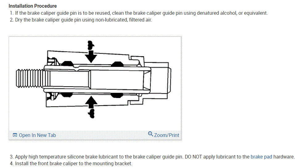

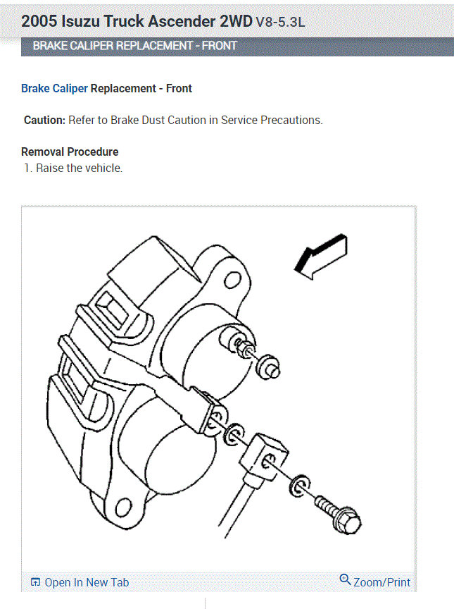

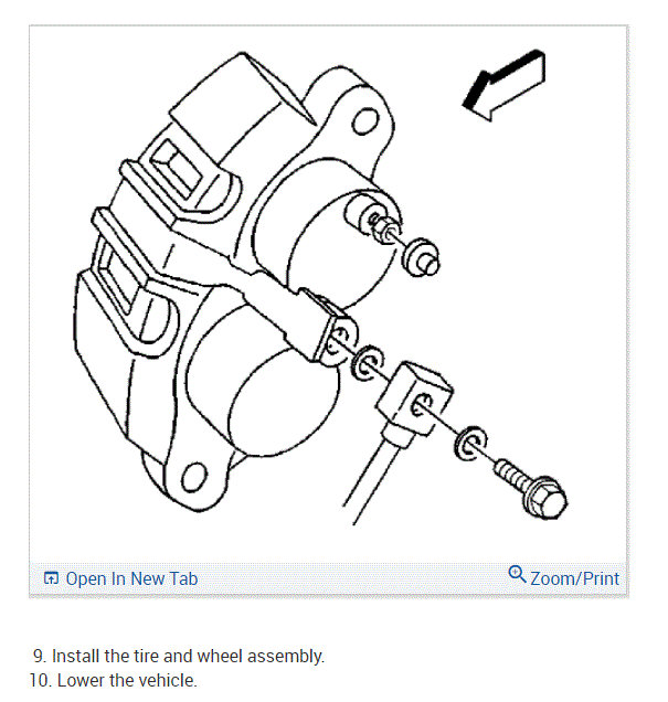

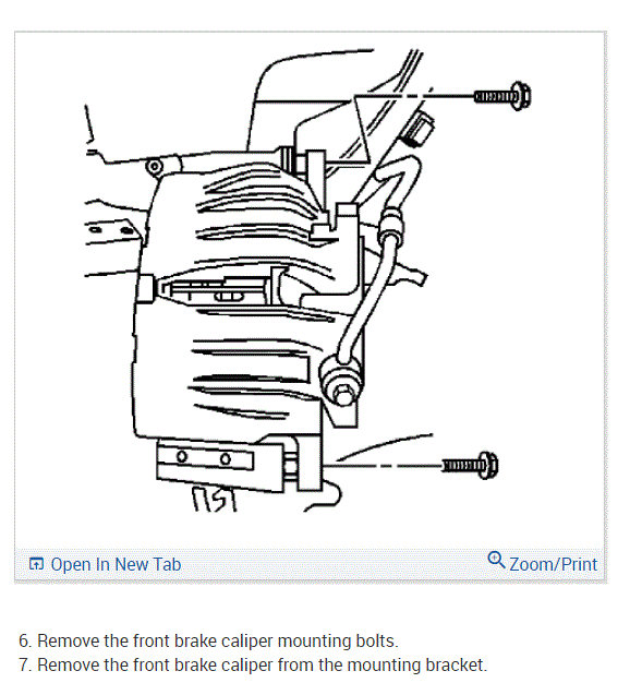

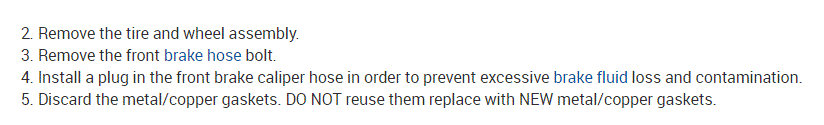

Let's try this first. Open the bleeder fully on the new caliper. Remove the master cylinder lid and make sure it remains full of brake fluid. Allow the vehicle to sit with the bleeder open for approx 15 minutes. During that time, you should start seeing brake fluid draining from the new caliper. Once it starts leaking, close the bleeder and then manually bleed the brake system.

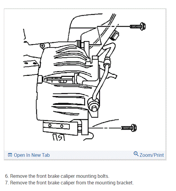

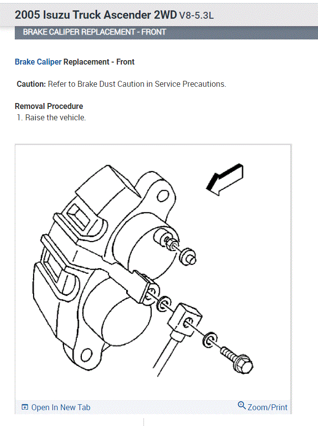

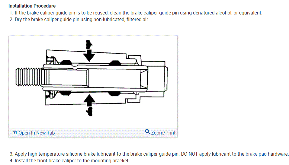

If you look below, I provided the directions specific to your vehicle for caliper replacement. Review the directions to confirm everything was done properly.
Starting with pic 7, the directions for bleeding the system begin.
_____________________________________
Let me know if that helps. Also, I have seen parts stores provide a caliper for the wrong side. That places the bleeder on the bottom of the caliper and makes it impossible to bleed. That is just a thought. Make sure the correct caliper was used.
Let me know what you find or if you have other questions. If this doesn't take care of the issue, the master cylinder may have been damaged, so let me know.

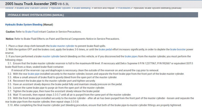

Do me a favor. When the wheels are hard to turn, open the bleeder on one caliper at a time. If the wheel gets easy to turn, then we know it isn't the caliper or a slide issue. If it doesn't get easier, we will need to remove the brake calipers again and inspect them.
You never removed the master cylinder, correct? Also, since the master cylinder went empty, did you bench bleed the cylinder prior to starting to bleed the brakes at the wheels?
