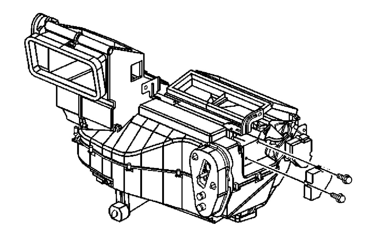

when I turn the heater on only cold air blows out. We replaced the thermostat and that did not fix the problem. The car is not overheating and the radiator is full. The control in the car works on all speeds but just blows cold air. At one point the heater worked and would not turn to cool, just blew hot air. Then just stopped working. The dealer told me that it would be at least 9 hours to diagnose the problem. Do you have any suggestions.

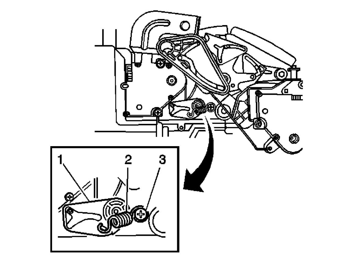

You could have a issue with the blend door or the blend door actuator. When you move from cold to hot or hot to cold can you see the blend door moving?Also you have auto climate control correct?
Heres some pics of where the actuator is

No auto climate control that I know of. How do I fix the blend door or blend door actuator?

On the first issue, you could have two possibilities. The thermostat may not be regulating temp correctly, and the air is warmer on the passenger side because of its proximity to the core, by the time it reaches the drivers side it is cooled even more. Or there could be a fault with the dual zone system, where one blend actuator is faulty and not working, or overtraveled and defaulted to full cold. The latter will set codes, they could only be checked with a scan tool.
