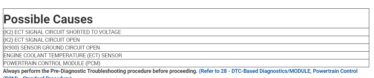

Okay. I just read through all the threads we wrote. Have you had the computer scanned to see if there are diagnostic trouble codes? Also, I realize you have to jump start it to make it run. If you don't jump it, does the engine still turn the same speed?
Jan 23, 2020 at 6:36 PM
MANUEL CONTRERES
  • 5 POSTS
No codes have came on for pass month or so except today. I try starting truck without jump starting but no luck. since it's been parked the engine light came on after jump starting. so I drove to local auto parts store to check the engine light and a p0118 code came up, but before today there have not be any codes come on. When it first started having trouble the ETC service light came on had it checked out and was replaced but no codes.
As for engine still turn at same speed without jumping I'm not to sure what you mean. When I don't jump start all it does is crank only.
Jan 23, 2020 at 10:25 PM
  • 110,194 POSTS
The new code indicates an issue with the ECT sensor (engine coolant temperature sensor). Now interestingly, that can cause a no start. The ECT is used by the computer to determine the air/fuel ratio needed for the outside temperatures. What I would suggest is to get your hands on a live data scanner and check what signal the ECT sensor is sending the computer. If it is way off, it may not start.
At this point, I'm not sure how the jump start changes that, but anything is possible. I attached a pic of possible causes. Take a look through it. Also, if you feel confident and can get your hands on a live data scanner, I can get you the diagnostics related to this code. What I can tell you is it seems there is a short to power at the sensor.
Jan 24, 2020 at 8:58 PM
MANUEL CONTRERES
  • 5 POSTS
Hello Joe, finally got the truck to start running for now without having to jump start it every time. The fuel pump relay that is solder on the TIPM was the problem.
Feb 20, 2020 at 4:55 PM
  • 110,194 POSTS
Wow. Good job finding that. I have to be honest, the TIPM is a real nightmare. The pins in the connectors are weak and they fail so often. To make it worse, darn near any component on the vehicle can fail as a result.
Regardless, I'm glad you got it running. If you continue to have issues, you can purchase re-manufactured ones online that I have had luck with. However, they aren't cheap.

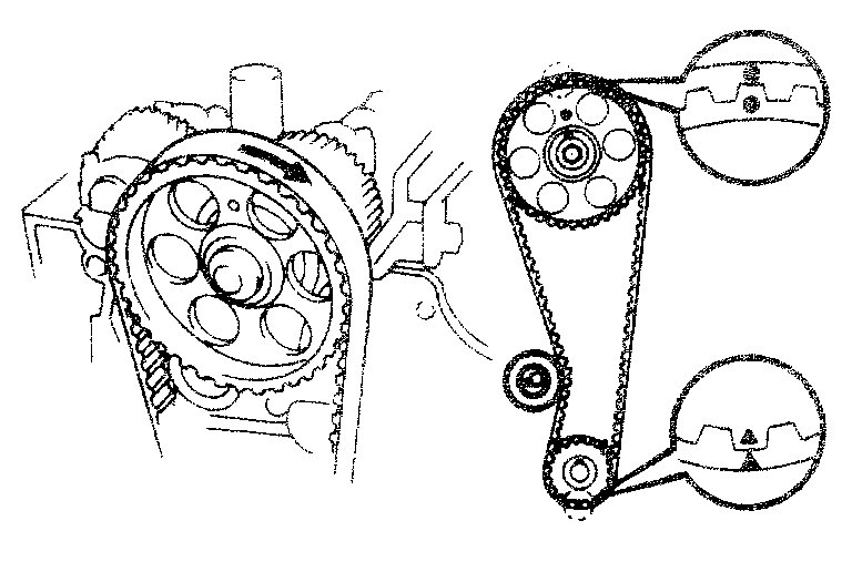

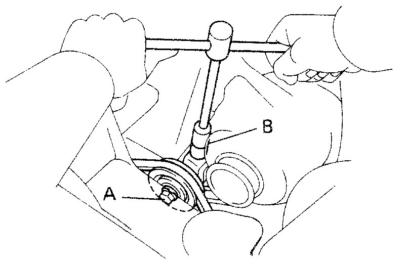

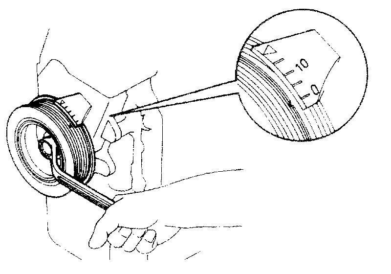

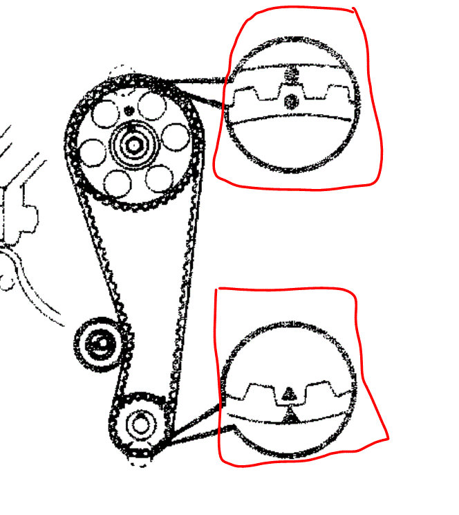

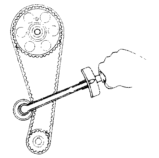

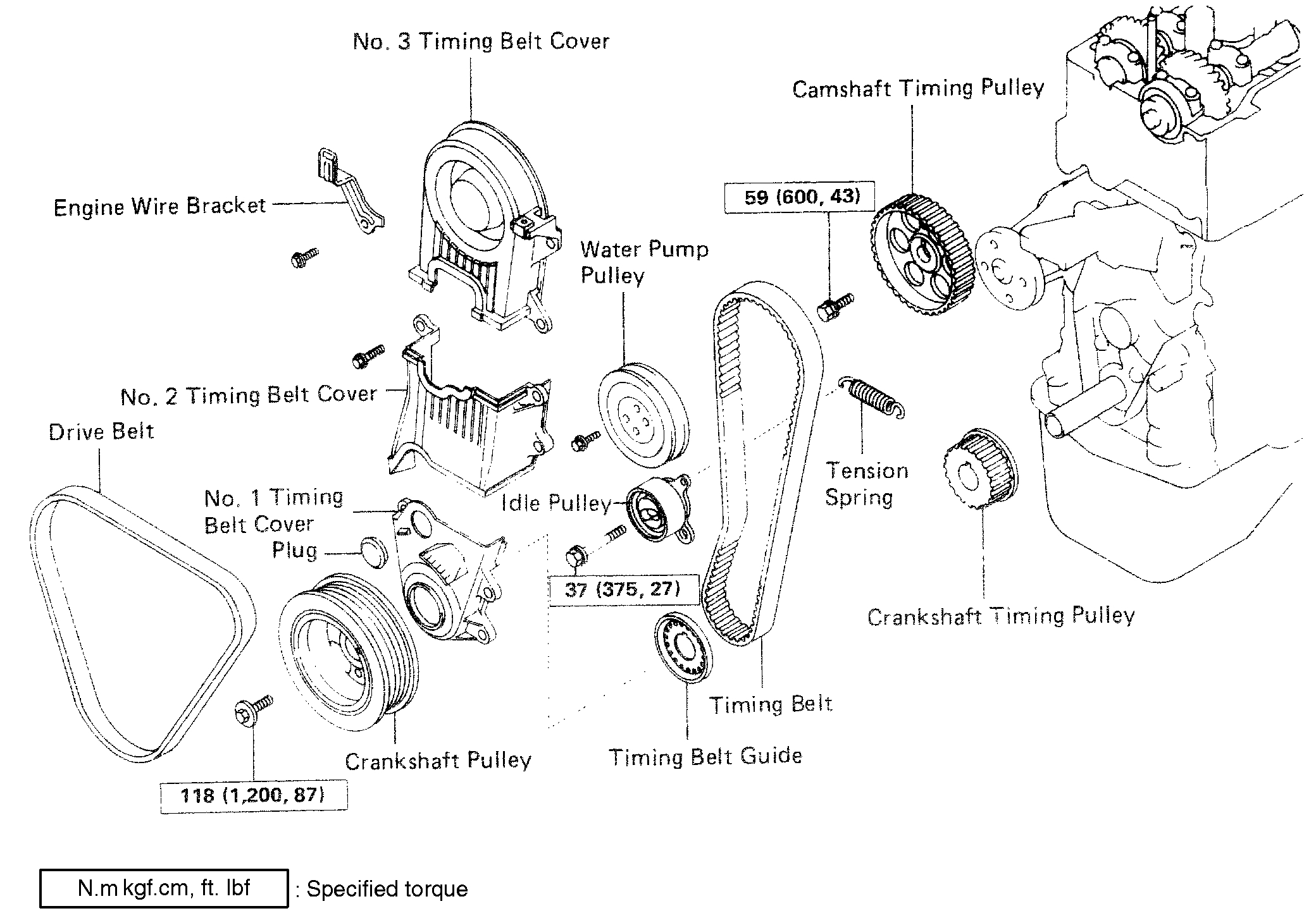

If you look at the first picture below, it shows the timing marks. If you are replacing the belt, here are the directions for removal and replacement. All pics correlate with the directions.

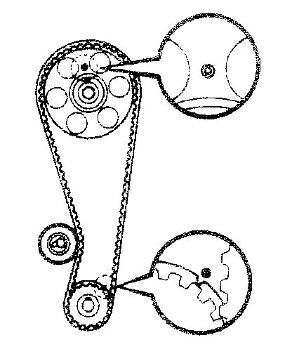

pic 2

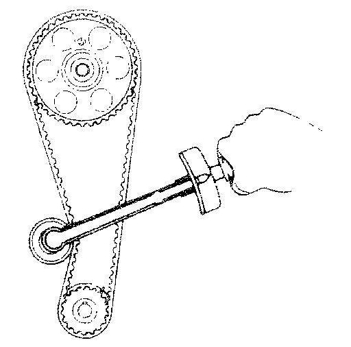

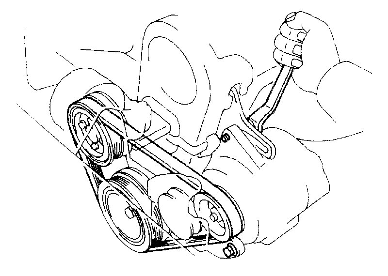

4. Loosen water pump pulley bolts and remove alternator drive belt.
pic 3

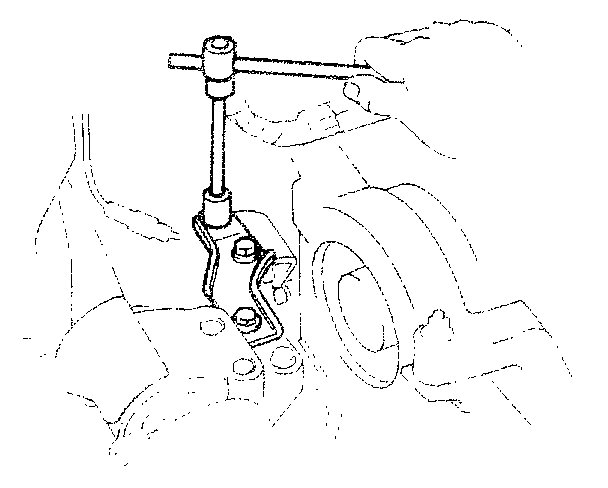

(a)Stretch the belt tight and loosen the water pump pulley bolts.

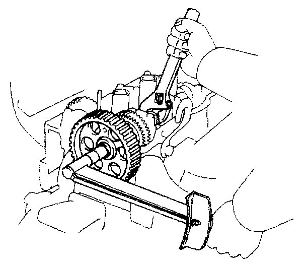

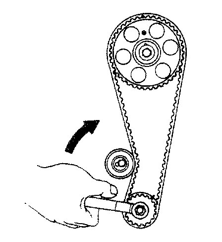

pic 4

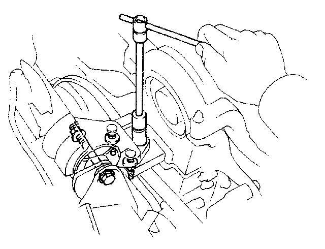

(b)Loosen the pivot nut and adjusting bolt, and remove drive belt.

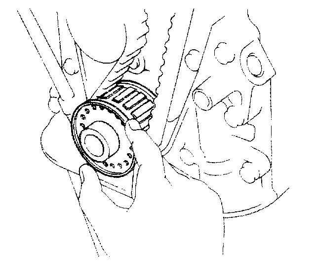

pic 5

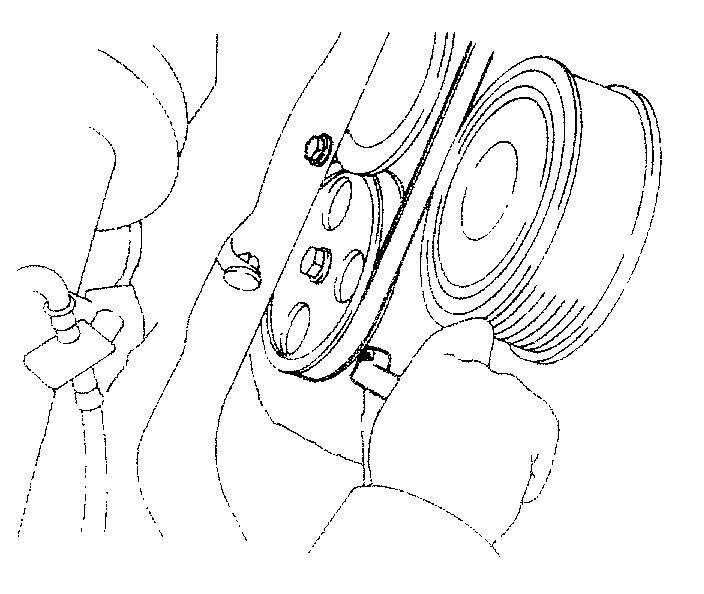

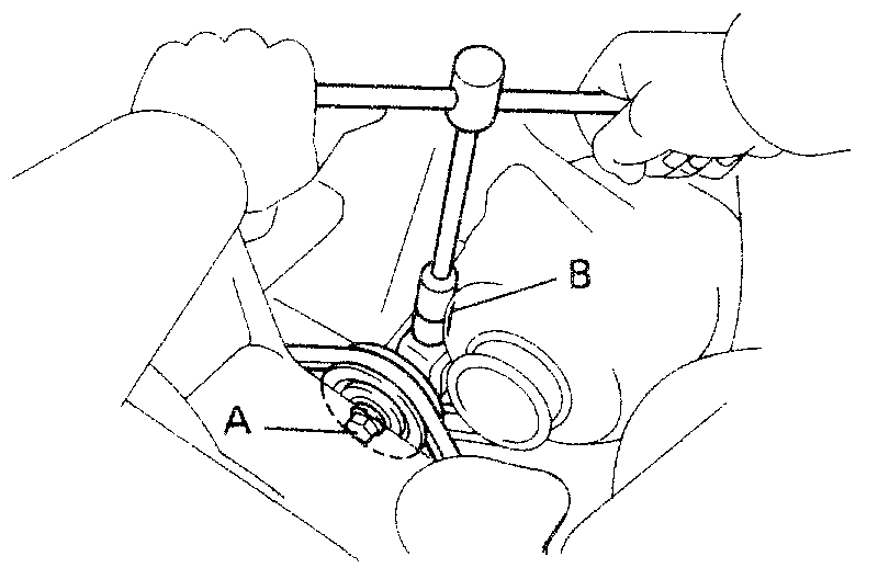

5. On vehicles with A/C, remove A/C compressor drive belt.
(a)Loosen the idler pulley mounting bolt A.
(b)Loosen the adjusting bolt B and remove the drive belt

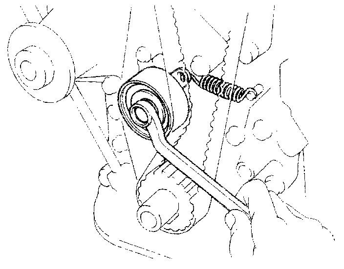

pic 6

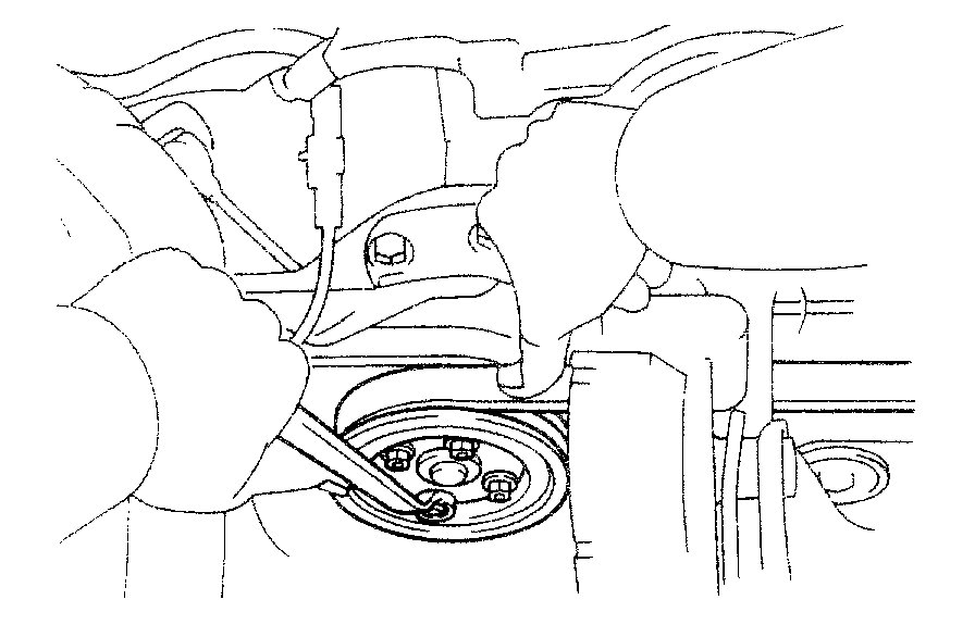

6. On vehicles with PS, remove PS pump drive belt.
(a)Loosen the pivot and lock bolts.
(b)Swing PS pump toward the engine and remove the drive belt.

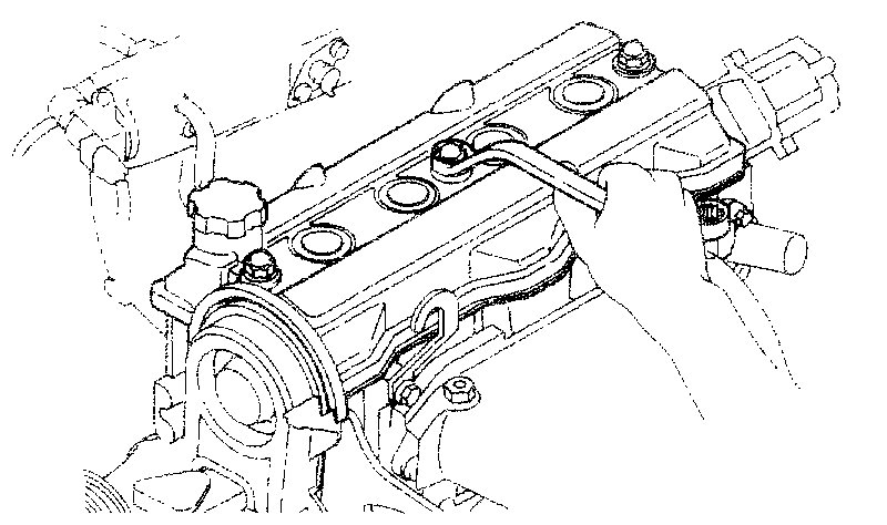

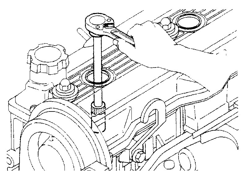

8. Remove spark plug.
(a)Disconnect the high-tension cord from spark plug.
(b)Using a plug wrench (16 mm), remove the spark plugs.
pic 9

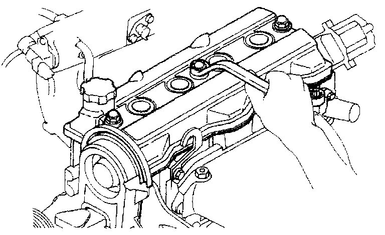

9. Remove cylinder head cover.
(a)Disconnect the PCV hoses from the cylinder head cover.
(b)Remove the three cap nuts, grommet and cylinder head cover with the gasket.

10. Set No.1 cylinder at TDC/Compression.
(a)Turn the crankshaft pulley and align its groove with the No.1 timing belt cover.

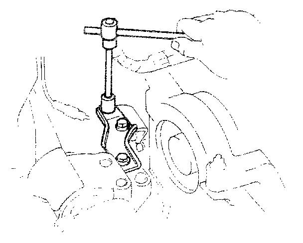

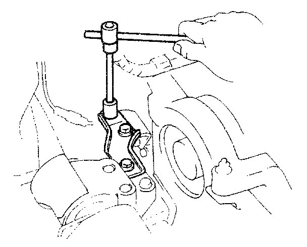

(b)Remove the three bolts and mounting stay.
pic 13
(c)Remove the bolt, two nuts, through bolt and RH mounting.

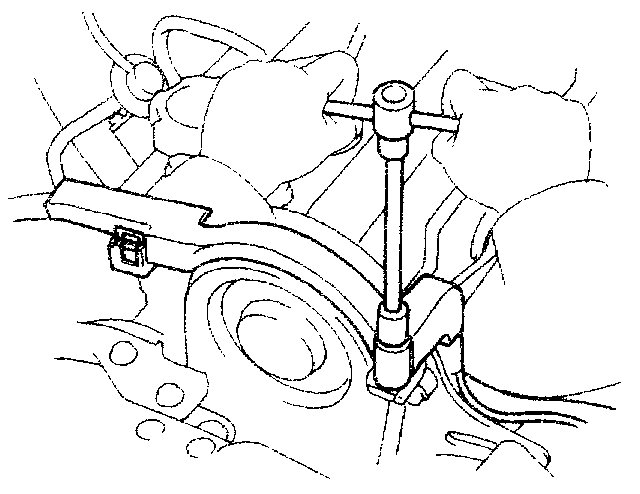

12. Remove water pump pulley.

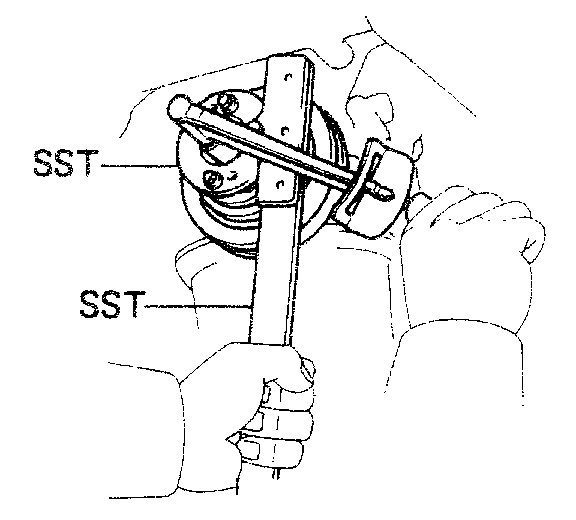

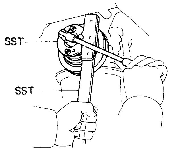

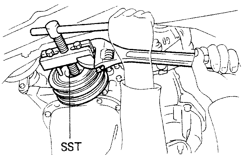

13. Remove crankshaft pulley.
pic 14
(a)Using SST 09213-14010 and 09330-00021 to hold the crankshaft pulley, remove the pulley bolt.

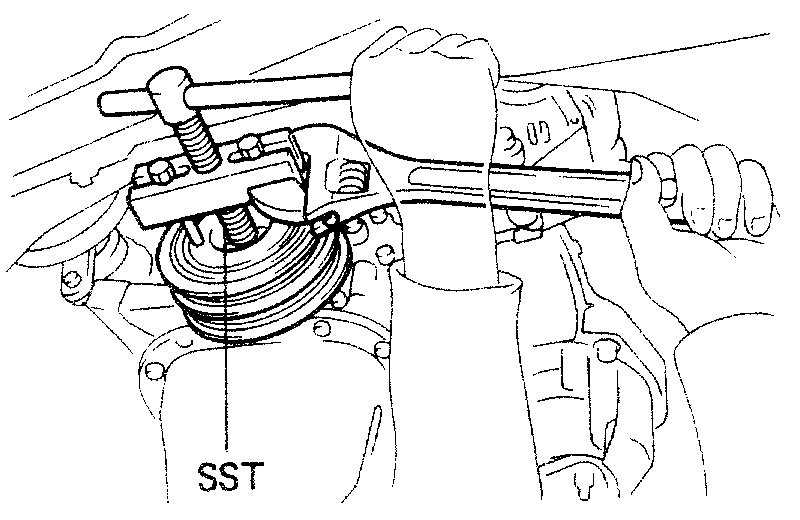

pic 15
(b)Using SST 09213-31021, remove the pulley.

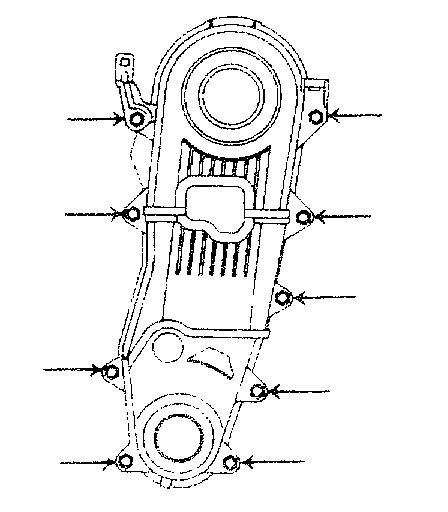

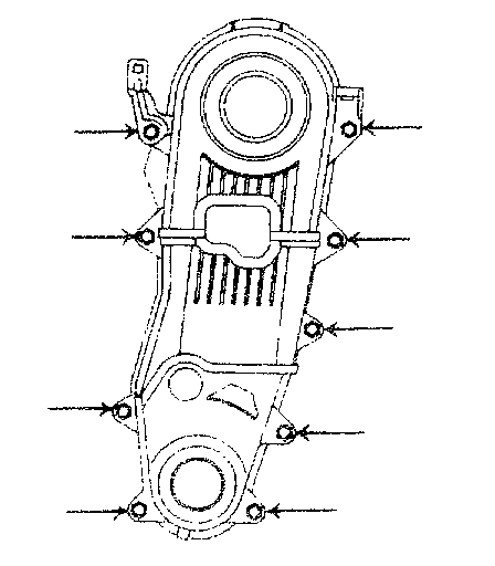

14. Remove timing belt covers.
Remove the nine bolts engine wire bracket and timing belt covers.
15. Remove timing belt guide.
16. Remove timing belt and idler pulley.
pic 17
HINT: If reusing the timing belt, draw a direction arrow on the belt (in direction of engine revolution), and place matchmarks on the pulleys and belt as shown in the Illustration.
pic 18
(a)Remove the bolt, idler pulley and tension spring.
(b)Remove the timing belt.

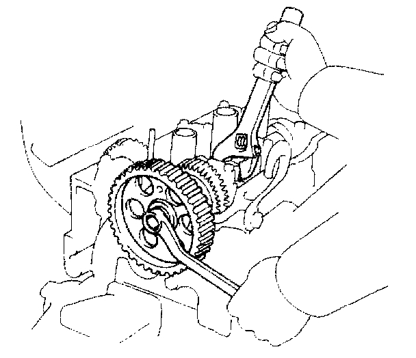

18. Remove camshaft timing pulley.
Hold the hexagonal head wrench portion of the camshaft with a wrench, and remove the bolt and timing pulley.
NOTICE: Be careful not to damage the cylinder head with the wrench.

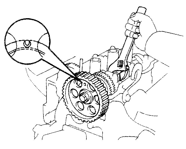

(d)Turn the hexagonal wrench head portion of the camshaft, and align the hole of the camshaft timing pulley with the timing mark of the bearing cap.

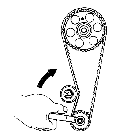

3. Temporarily install idler pulley and tension spring.
(a)Install the idler pulley with the bolt. Do not tighten the bolt yet.
(b)Install the tension spring.
(c)Push the pulley toward the left as far as it will go and tighten the bolt.

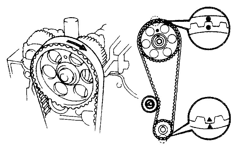

4. Install timing belt.
NOTICE: The engine should be cold.
pic 25
HINT: If reusing the timing belt, align the points marked during removal, and install the belt with the arrow pointing in the direction of engine revolution.

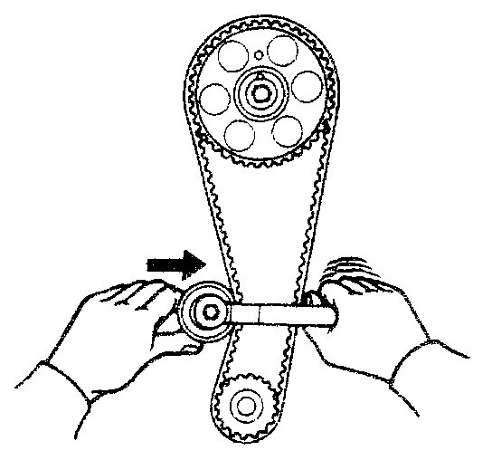

5. Check valve timing and timing belt tension.
pic 26
(a)Loosen the timing belt idler pulley mounting bolt.
pic 27
(b)Temporarily install the crank pulley bolt and turn the crankshaft two revolutions from TDC to TDC.
HINT: Always turn the crankshaft clockwise.
pic 28
(c)Check the valve timing.
Check that each pulley aligns with the marks as shown in the illustration.

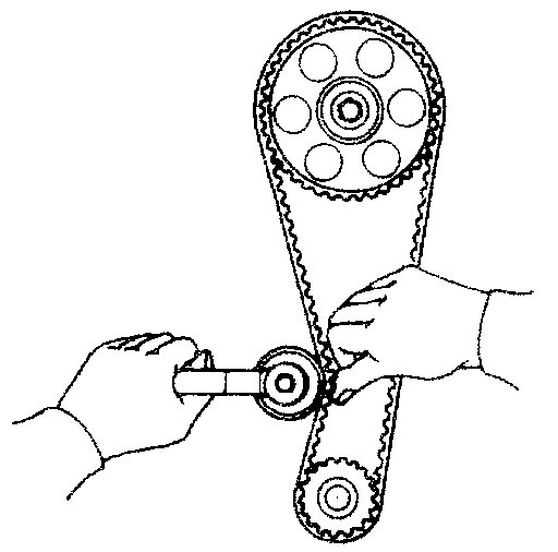

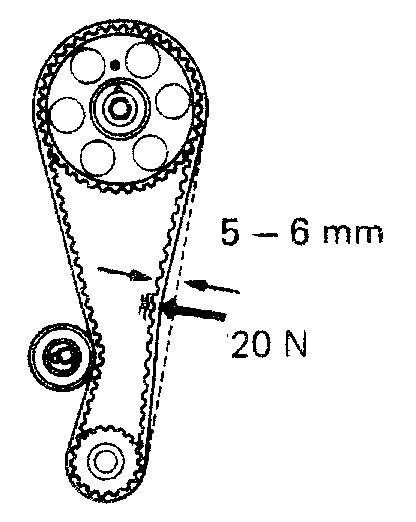

(f)(Reference) Measure the timing belt deflection as shown in the illustration.
Timing belt deflection: 5 - 6 mm (0.20-0.24 in.) at 20 N (2 kgf, 4.4 lbf)
pic 31
(g)If the measured value is not within standard, readjust with the idler pulley.

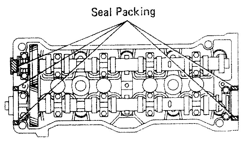

11. Install cylinder head cover.
pic 37
(a)Apply seal packing as shown in the illustration.
Seal packing: Part No. 08826-00080 or equivalent
HINT: Clean the indicated portions by removing the original sealant before recoating.

16. Install alternator drive belt.
17. Adjust drive belts.
Using a belt tension gauge, check and adjust the drive belt tension.
Drive belt tension:
Alternator Belt
New belt 160 ± 20 lbf
Used belt 130 ± 20 lbf
PS Belt
New belt 100 ± 25 lbf
Used belt 55 ± 20 lbf
A/C Belt
Used belt 100 ± 20 lbf
18. Tighten water pump pulley bolts.
19. Install washer tank.
20. Install RH engine under cover.
21. Install RH front wheel.
