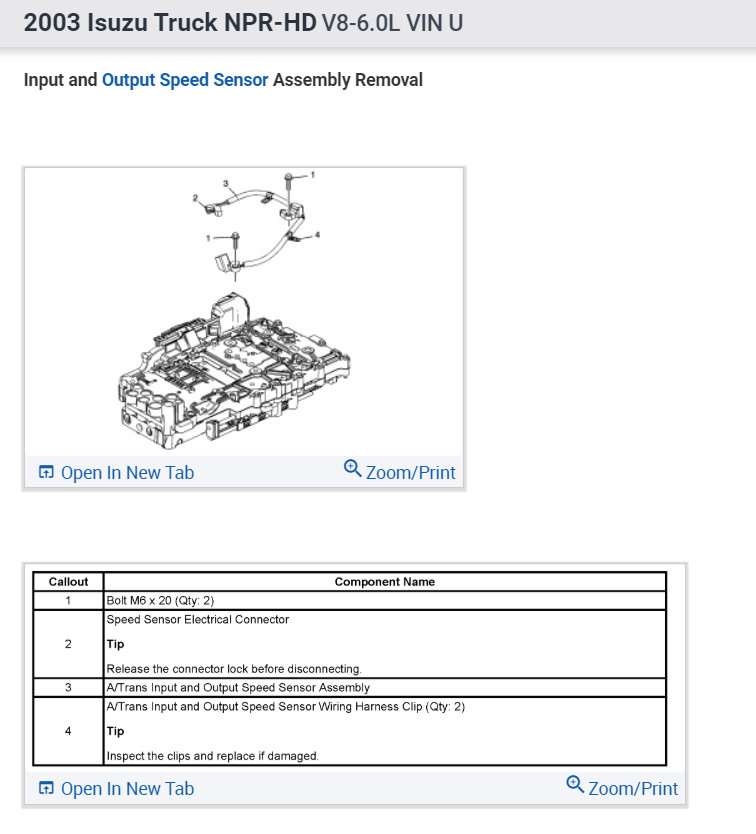

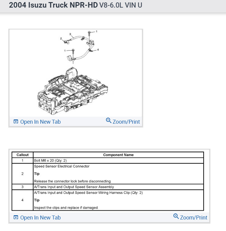

  • 55,433 POSTS
This is a common problem when the output sensor goes out which is inside the transmission. here is the instructions to change it out in the diagrams below. Check out the diagrams (below). Please let us know what you find.

  • 55,433 POSTS
I have seen the input shaft speed sensor cause this issue. here is the location to so you can check it out. Check out the diagrams (below). Please let us know what happens.
