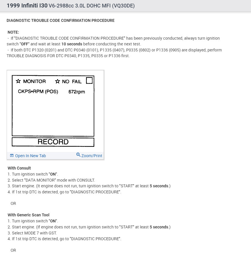

the car has check engine light on code p1320?
180,000 MILES • 3.0L • 6 CYL • 2WD • AUTOMATIC
HOWARD KYI

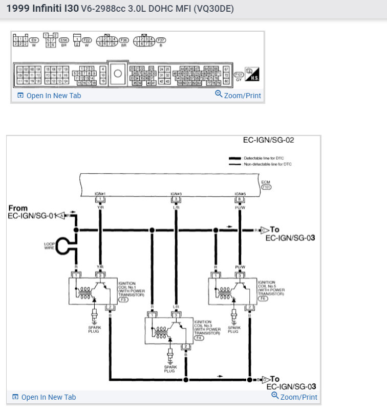

replaced number two , and number four cylinder coil pack ( ignition ) , but , check engine light still come on with p1320 , what do I do next now ?
Feb 14, 2016 at 8:27 AM
SQM
  • 6,383 POSTS

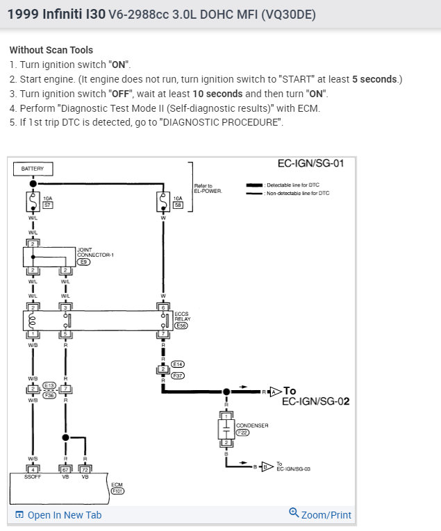

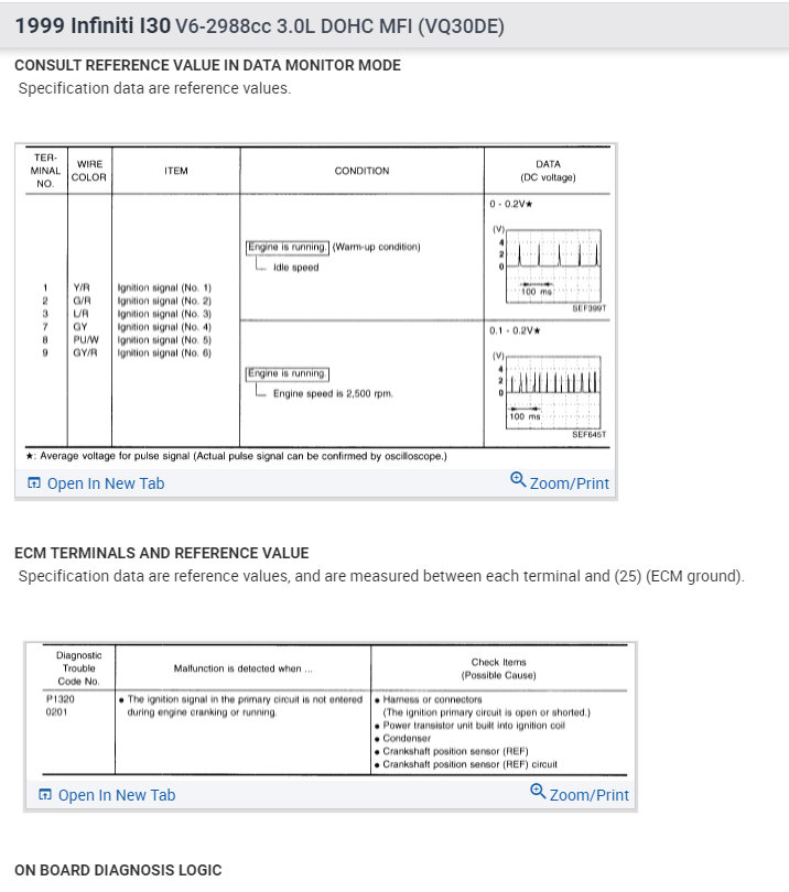

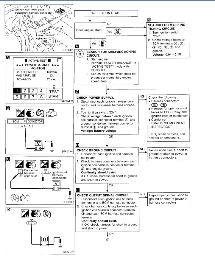

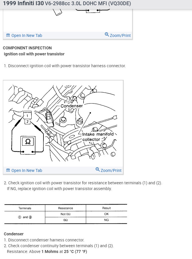

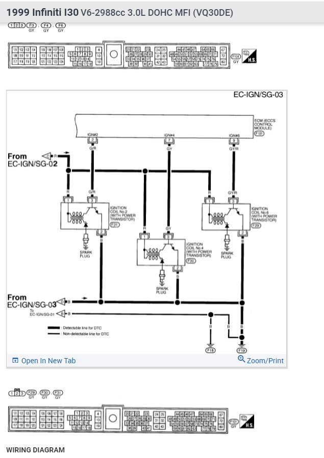

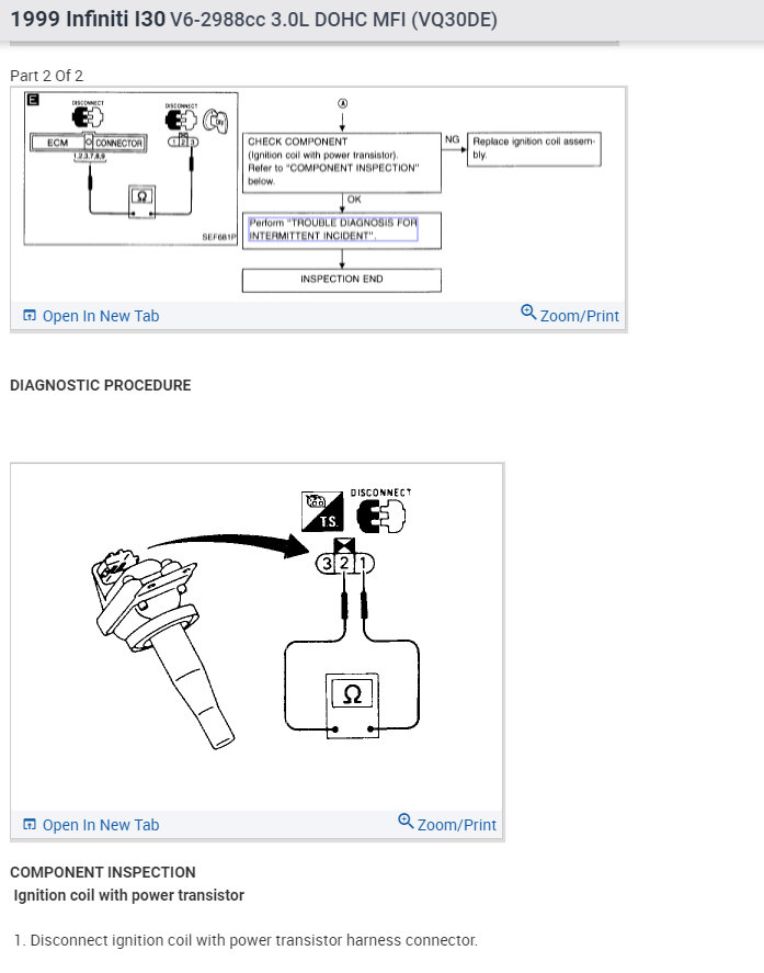

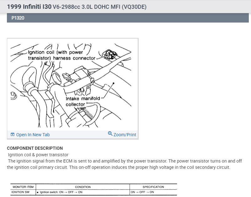

This code can be triggered due to a few different factors.
it could be due to a wiring issue for the ignition coils, faulty crank sensor or circuit.
The best option would be to take a step-by-step approach and go through the possibilities and find out the issue.
I have attached the trouble shooting guide for the code P1320 below.
Go through the steps as that can help you determine the reason for the code.
