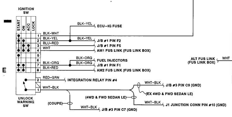

Was talking to mhpautos about a problem he said to repost. But all the info is at:
https://www.2carpros.com/questions/no-power-to-anything-needing-key-on
Trying to get where to test on back of plugs and what is what
here is my last reply:
January, 31, 2016 AT 1:47 PM
I can test back of plug but not sure which is which.
Back of 8 Pin: BLK/RED [ ] [ ] BRN
BLK/BLU [ ] [ ] BRN/WHT
BLK/YEL [ ] [ ] (OPEN)
BLK/WHT [ ] [ ]BRN/RED

Finaly found what I was looking for, this should help you with the switch wiring.
Tuesday, February 2nd, 2016 AT 4:09 AM

Ok I figured out what goes to what sort of.
I checked 3 input to switch brown from fusible link to Am2 is 12 v. Steady ok. But white was not clear at first I saw 12 v then I turned key to check one of its outs nada, but I lost 12 v in (white) AM1.
So currently on my way to work again. I think it has something to do of not getting 12v to arm 1. (Wht).
According to the diagram it comes directly from a fusible link, (on the battery or somewhere else?
Tuesday, February 2nd, 2016 AT 1:38 PM
DAVIDE123
  • 26 POSTS
There are 3 fusible links on right at the + side of the battery they all look to be making contact (not burned open. One is blue when is red one is green
Tuesday, February 2nd, 2016 AT 1:42 PM
DAVIDE123
  • 26 POSTS
So. It seems to go>>> +Battery terminal > Lug > Fusible link (not sure which one r/bl/grn) > Cable (wire) to ARM 1. What do you think?

Start with checking the continuity of the fusible links, we need to know if they are OK.

I took off the connector and boot at the
+ term with the 3 FLs. Clipped on to connector and got continuity at each place they connect. They do not seem to want to unplug. Also the visual looks ok.

Ok I watched a vid and pulled fuses. All have continuity at there lugs. Currently the are not installed.

I have put FusLinks back I am get a voltage +12 to arm2 but a drop at arm 1 (white wire from battery). I do not see anything between the switch and the fusLink.
Is there something that can cause the V to drop (getting about 9v).

Try running a jump wire to see if things improve, if you head down the path of checking the loom check for any points that have a bend or are unsupported as this is where you may find a damaged wire.

Thanks, for your suggestions. I assume the loom is the serrated plastic that covers the wires. Are there points where I can jump as I found a wire diagram.
BUT it shows sw continue F Link --- Bat+
Monday, February 8th, 2016 AT 9:58 AM
DAVIDE123
  • 26 POSTS
Ie no junction just strait wire. Thanks for your support.

Ok I m done. Thank you for all your support.
I undid the shroud. At the junction the wire was disconnected. It looke like blue perhaps old terminals
Monday, February 8th, 2016 AT 5:17 PM
DAVIDE123
  • 26 POSTS
The white wire had no connection. At the junction I cut the wires and splice a new wire. (Soldered in) reassembled taped WOW crazy I am tired.
Test drove OF now. Again thanks and hope this helps someone else trying to figure why they have no power to anythingggggggggggggggggggggggggggggg.
