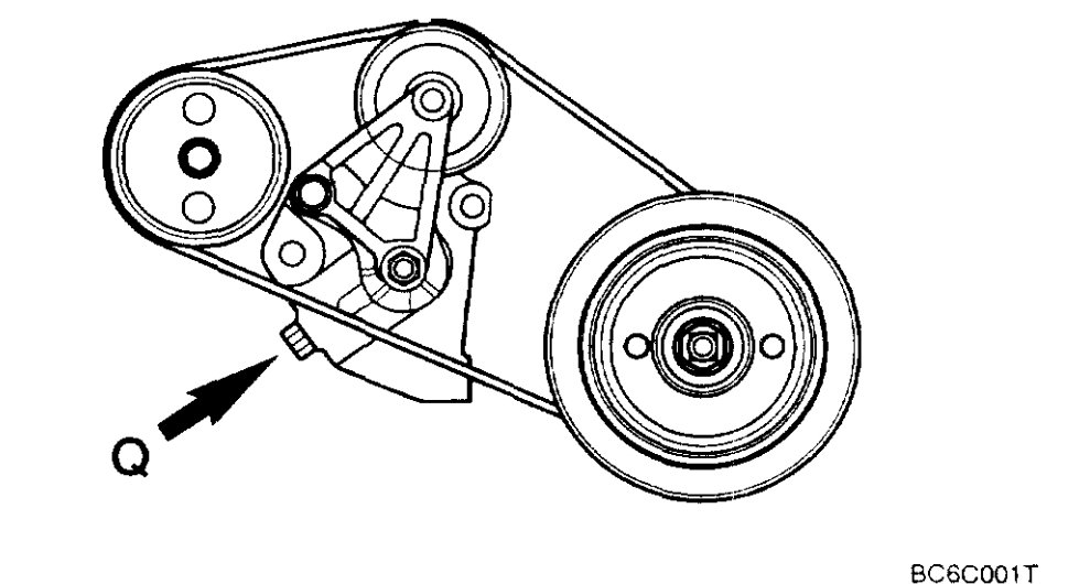

So, the tensioner pulley decided to leave us on Christmas Eve. It took with it the hardware holding it in place.
I bought a new pulley, also a couple M10-1.50 Nuts, and went home to find the M10-1.50 nuts did not thread onto the stud. I went back and got M10-1.25 nuts and, while I seem to have gotten one on there, it doesn't seem to be correct. The tension on the belt has loosened back up, so it appears I am still not repaired fully.
What size nut and thread do I need for this? Is there a sleeve or bushing needed (as I obviously am not getting pressure from the nut to hold the pulley in place)? Do I need to wholesale replace the tensioner assembly? (Is that possible?)
Thank you for your time!
Jan 2, 2019 at 9:31 PM

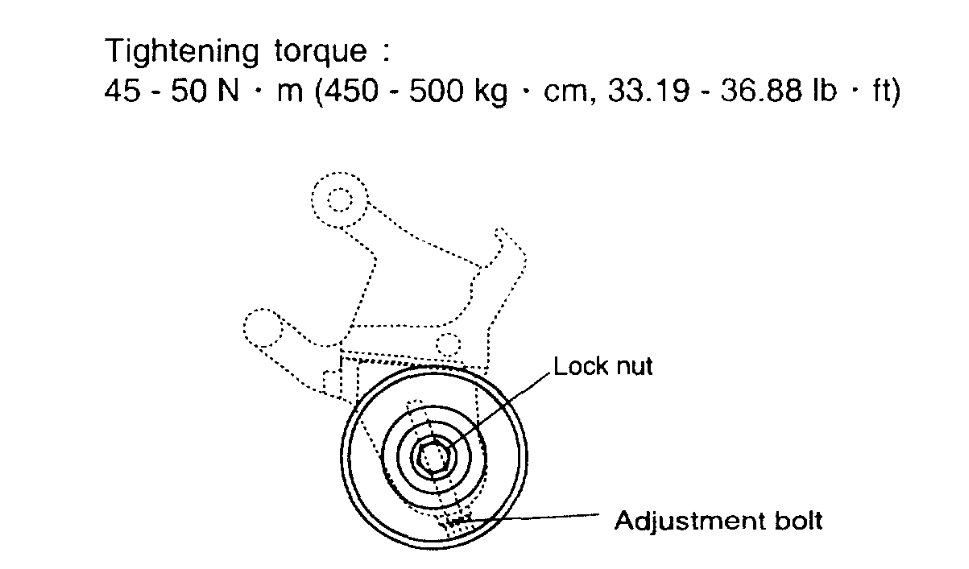

Good morning,
I attached two pictures. Could you tell me which one you have?
Also, since you installed the wrong nuts on the stud, it sounds like you will be replacing the tensioner assembly.
Jan 2, 2019 at 10:25 PM
ROLLNTHNDR
Hello, Roy. Thank you for your reply.
I have the second type. I may not need to replace though, as I didn't force them or cross thread. When it didn't feel right, I stopped. So, I am praying here!
