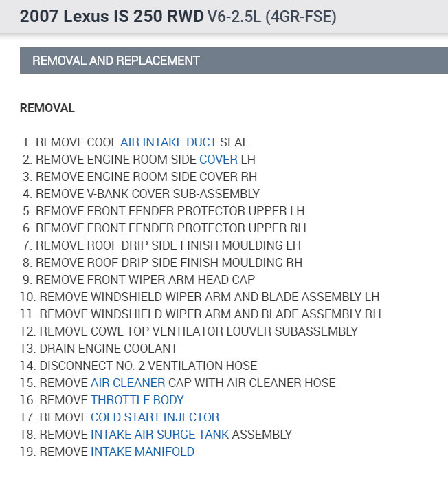

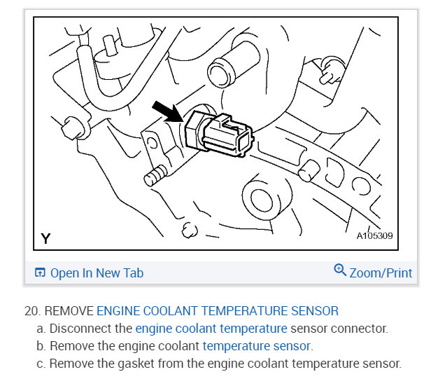

Here is a guide that will walk you through the basic steps and the instruction and location for your car below.
https://www.2carpros.com/articles/coolant-temperature-sensor-cts-replacement
b. Install the engine coolant temperature sensor.
Torque: 20 N.m (204 kgf.cm, 15 ft.lbf)
c. Connect the engine coolant temperature sensor connector.
Check out the diagrams (Below). Let us know what happens and please upload pictures or videos of the problem.
