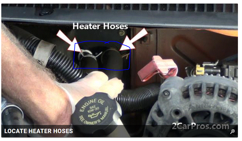

1) Start the engine and turn the heater on high. Allow the engine to reach operating temperature.
2) When it reaches temperature, feel both heater core hoses under the hood where they attach to the heater core at the firewall. (see pic 1 for example)
3) Check if the hoses are both hot.
___________________________________
If one is hot and the other isn't suspect a plugged heater core or an air blockage.
If both are hot, then we know hot coolant is flowing through the heater core. Thus, the heat is in the vehicle but not being distributed. That leads me to the blend air door.

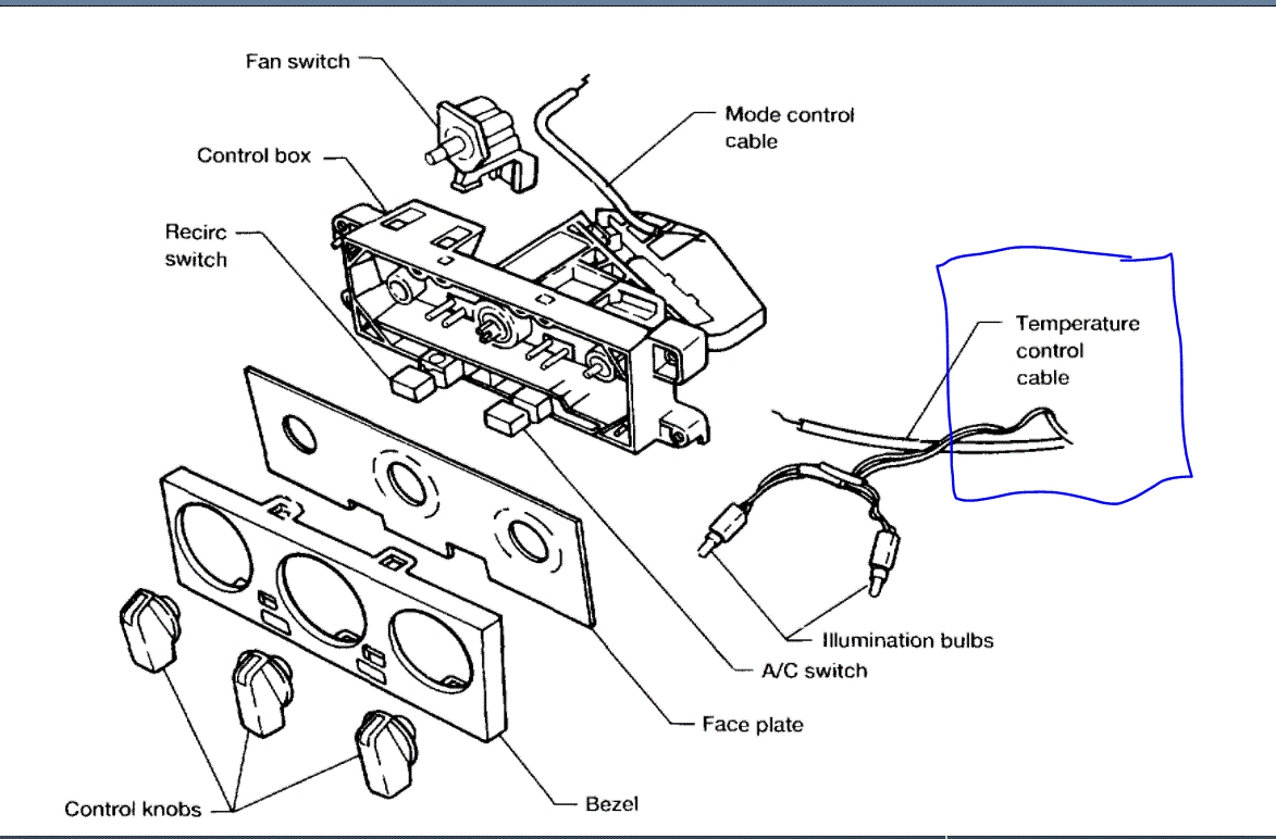

On this vehicle, the blend air door is actuated by a cable. You will need to locate the cable behind the controller and follow it. Check to make sure it is not broken or out of adjustment. I have seen the cable come off the mount near the blend door and when you adjust the door, the cable moves and not the door.
I attached a pic below (Pic 2) showing the cable I'm referring to. For some reason, the manual doesn't provide the other end of the cable. That is why I recommend tracing that cable.

Hey Joe, I followed the cable and watched as I changed the temperature back and forth I can see the cable and the groove the plastic piece that rotates, so doesn't look broken or adjustment. But I don't really know if the door is stuck or even opening.

Okay. Are you able to disconnect the cable and manually move it by hand to see if you then get heat?
