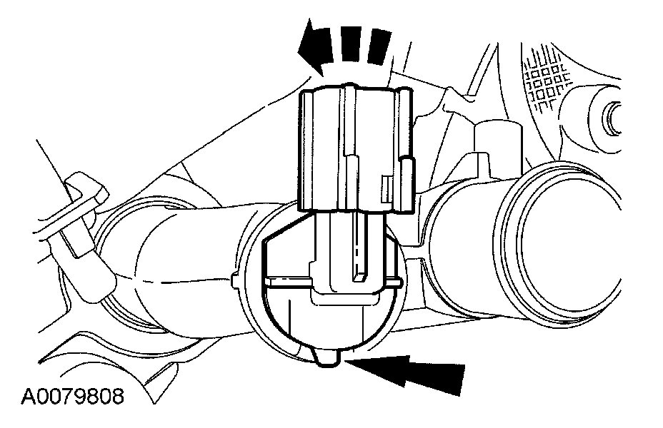

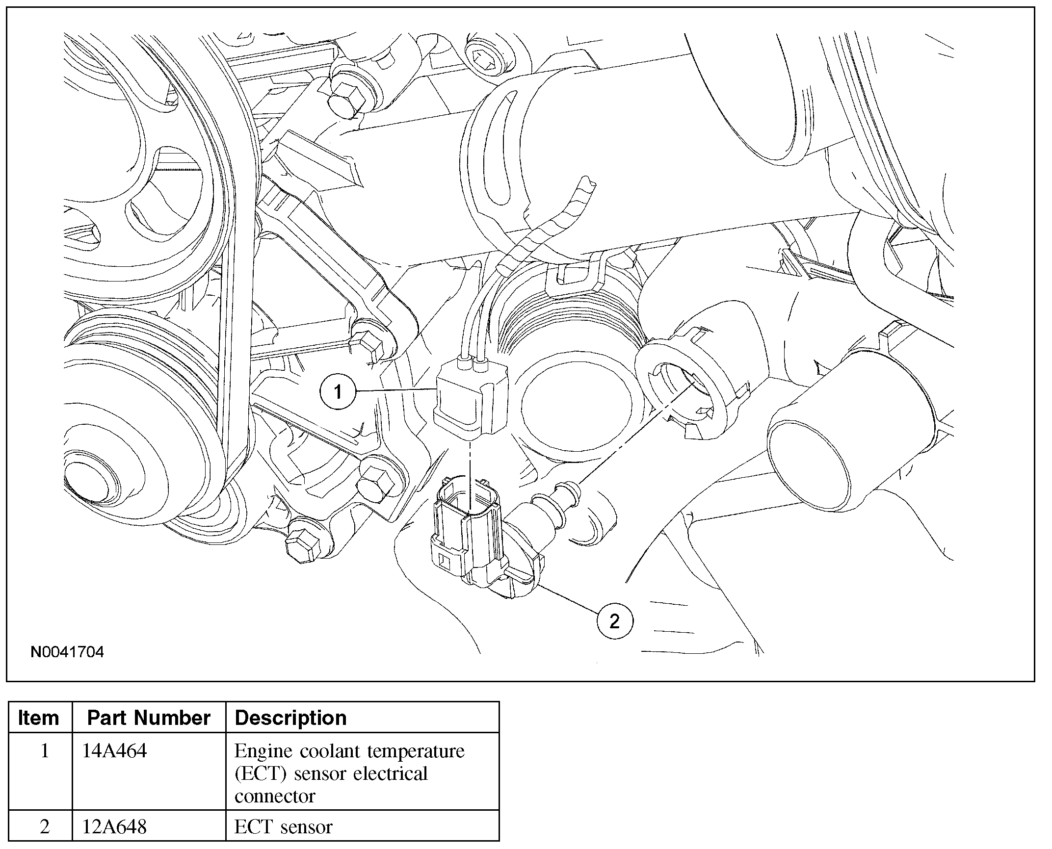

Here are the specific directions. The attached pics correlate with these directions.
ENGINE COOLANT TEMPERATURE (ECT) SENSOR
See Picture 1
Removal and Installation
1. Drain the cooling system.
2. Disconnect the engine coolant temperature (ECT) sensor electrical connector.

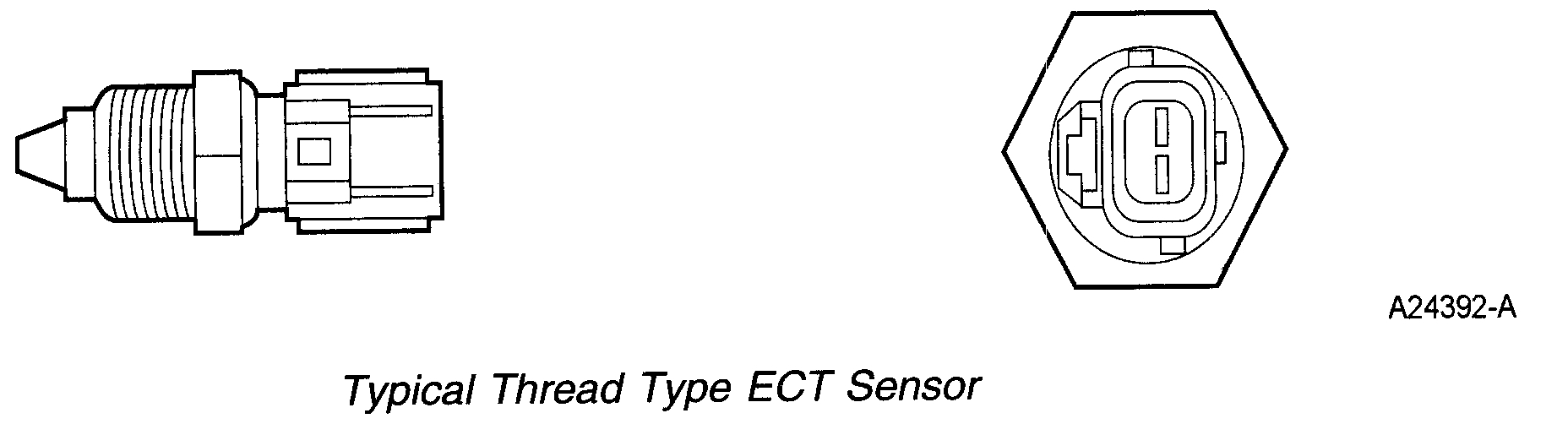

See Picture 2
3. Remove the ECT sensor.
- Pull upward on the locking tab.
- Rotate the sensor counterclockwise and remove.
4. To install, reverse the removal procedure.

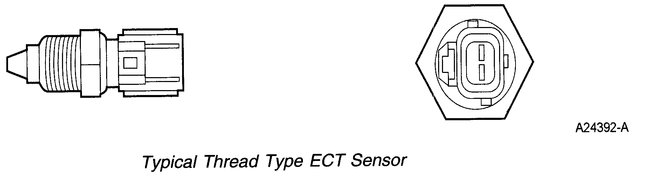

4 cylinder information.
1. Locate sensor on engine
See Picture 3
2. Disconnect wiring to sensor.

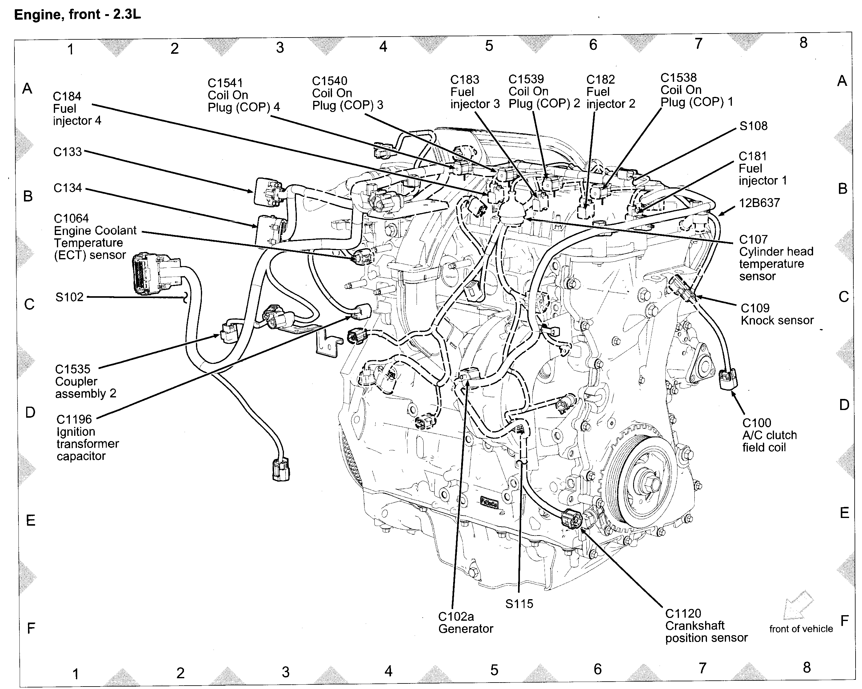

3. Remove sensor See Picture 4
