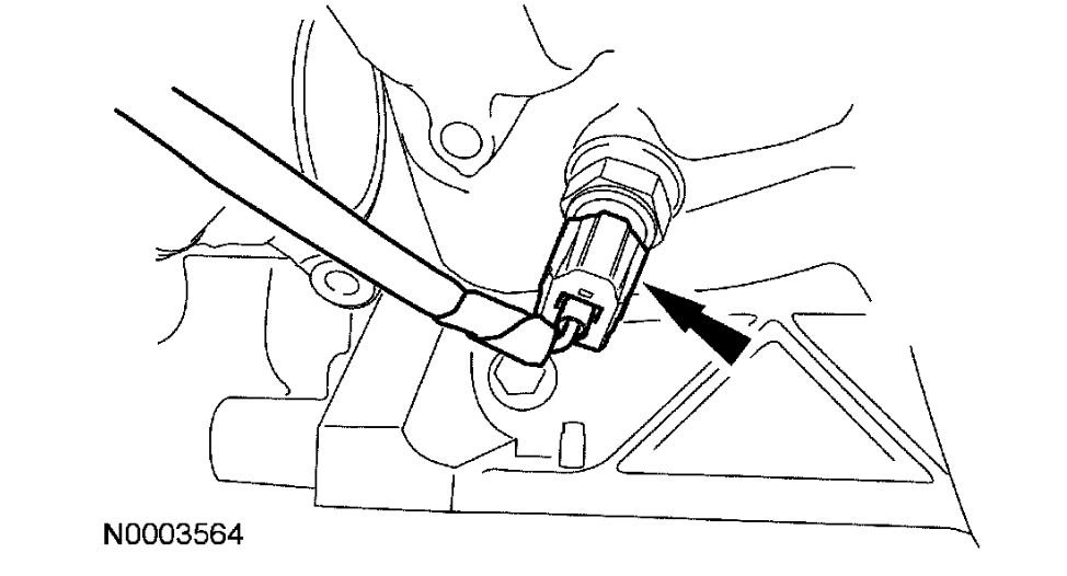

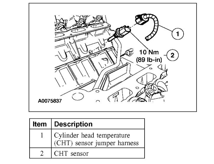

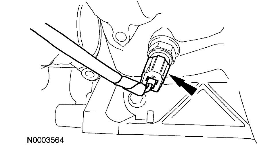

The temperature gauge does not read on my truck. I was told that it was a sensor that had to be replaced. What sensor and where is it located? Is a job I can do myself or should a mechanic do it?
Jun 3, 2020 at 12:32 AM

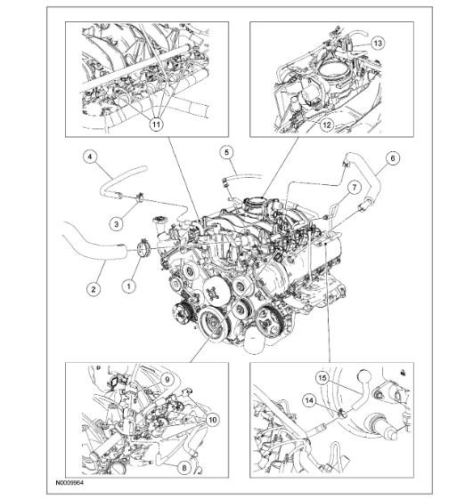

Good afternoon,
It is located under the intake manifold. It is a big job as you have to remove the intake manifold to access it.
Why are you replacing it?
Removal

1. Disconnect the fuel supply tube spring lock coupling.
2. Drain the cooling system.
3. Remove the generator.
4. Remove the air cleaner.
5. Disconnect the upper radiator hose from the thermostat housing.
6. Disconnect the heater coolant hose from the coolant bypass tube.
7. Disconnect the quick connect coupling and remove the evaporative emissions (EVAP) tube from the intake manifold.
8. Disconnect the fuel rail pressure and temperature sensor electrical connector and vacuum connector.
9. Disconnect the 8 fuel injector electrical connectors.

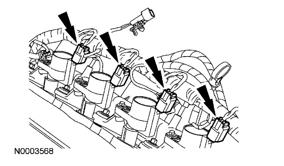

10. Disconnect the 4 LH ignition coil electrical connectors.
11. Disconnect the throttle position (TP) sensor and electronic throttle control electrical connectors.
12. Disconnect the heated PCV element electrical connector.
13. Disconnect the engine oil pressure (EOP) sensor electrical connector.
14. Disconnect the LH camshaft position (CMP) sensor electrical connector.
15. Disconnect the LH variable camshaft timing (VCT) solenoid electrical connector.
16. Disconnect the LH radio ignition interference capacitor electrical connector.
17. Disconnect the wiring harness retainers from the LH valve cover studs and position the harness aside.
18. Disconnect the brake booster vacuum hose from the intake manifold vacuum tube.

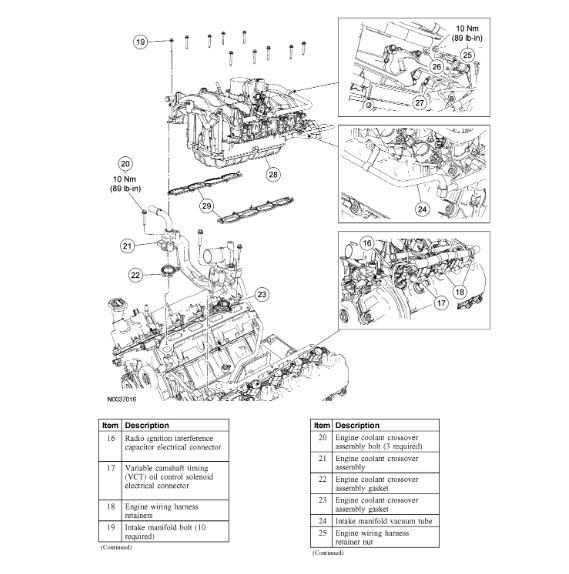

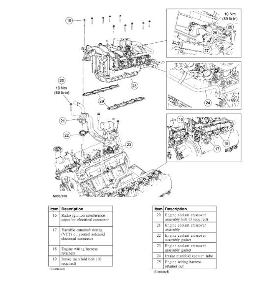

19. Remove the 10 intake manifold bolts.
20. CAUTION: Do not use metal scrapers, wire brushes, power abrasive discs or other abrasive means to clean the sealing surfaces. These tools cause scratches and gouges which make leak paths. Use a plastic scraping tool to remove all traces of old sealant.
Remove the 3 bolts, the coolant bypass tube and discard the gaskets.
Clean and inspect the sealing surfaces with silicone gasket remover and metal surface prep. Follow the directions on the packaging.

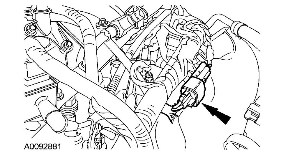

21. Disconnect the charge motion control valve (CMCV) electrical connector.
22. Disconnect the intake manifold vacuum tube from the valve cover stud and the support bracket.
23. Position the intake manifold assembly forward and disconnect the cylinder head temperature (CHT) sensor jumper harness electrical connector.
24. Disconnect the LH and RH knock sensor (KS) electrical connectors.
25. Remove the nut and disconnect the engine wiring harness retainer from the CMCV stud.
26. Disconnect the RH heated exhaust gas oxygen sensor (HO2S) electrical connector and detach the electrical connector retainer.
27. CAUTION: Do not use metal scrapers, wire brushes, power abrasive discs or other abrasive means to clean the sealing surfaces. These tools cause scratches and gouges which make leak paths. Use a plastic scraping tool to remove all traces of old sealant.
Remove the intake manifold and discard the gaskets.

It does control the temperature gauge on the dash.
Do you have a scan tool to see if the ECM shows engine temperature in live data? It could be the sensor, the ECM or the dash gauge itself.
Temperature Gauge
The PCM receives the engine coolant temperature status through hardwired circuitry to the cylinder head temperature (CHT) sensor. The instrument cluster receives the engine coolant temperature data from the PCM over the communication network. The instrument cluster monitors the engine coolant temperature data received from the PCM and provides the temperature gauge indication with a corresponding movement of the pointer. If the instrument cluster receives no signal the temperature gauge defaults to the COLD position.
