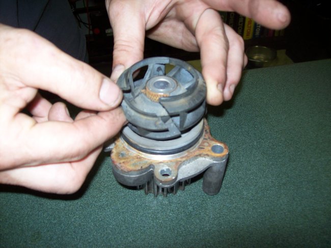

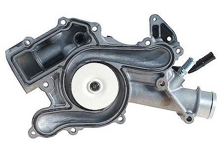

I looked at a auto store site, the water pump they show has a plastic impeller (first picture below) Another brand may be metal?

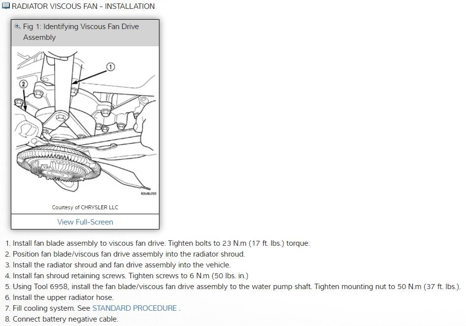

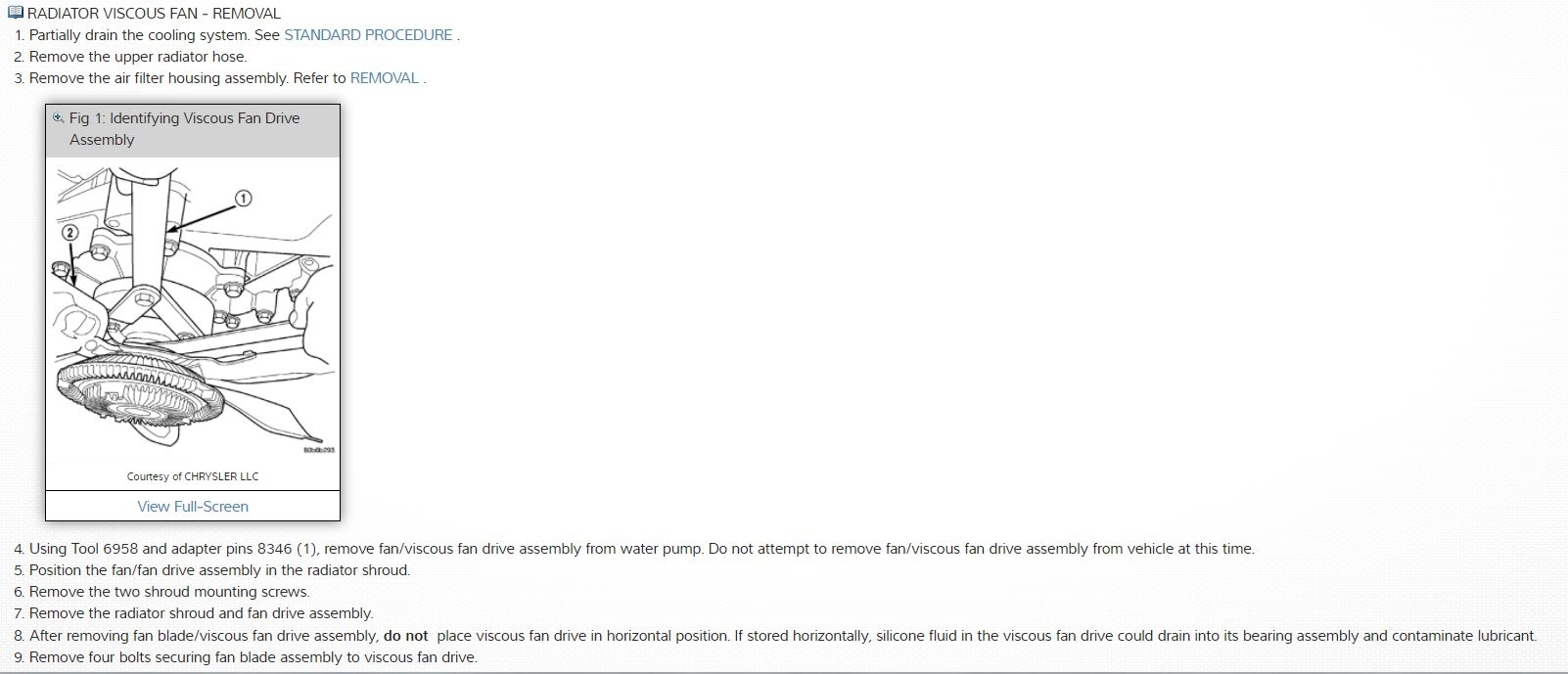

Here is more information from "repair guides", top right of our pages.

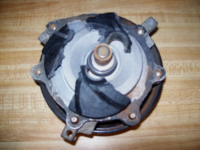

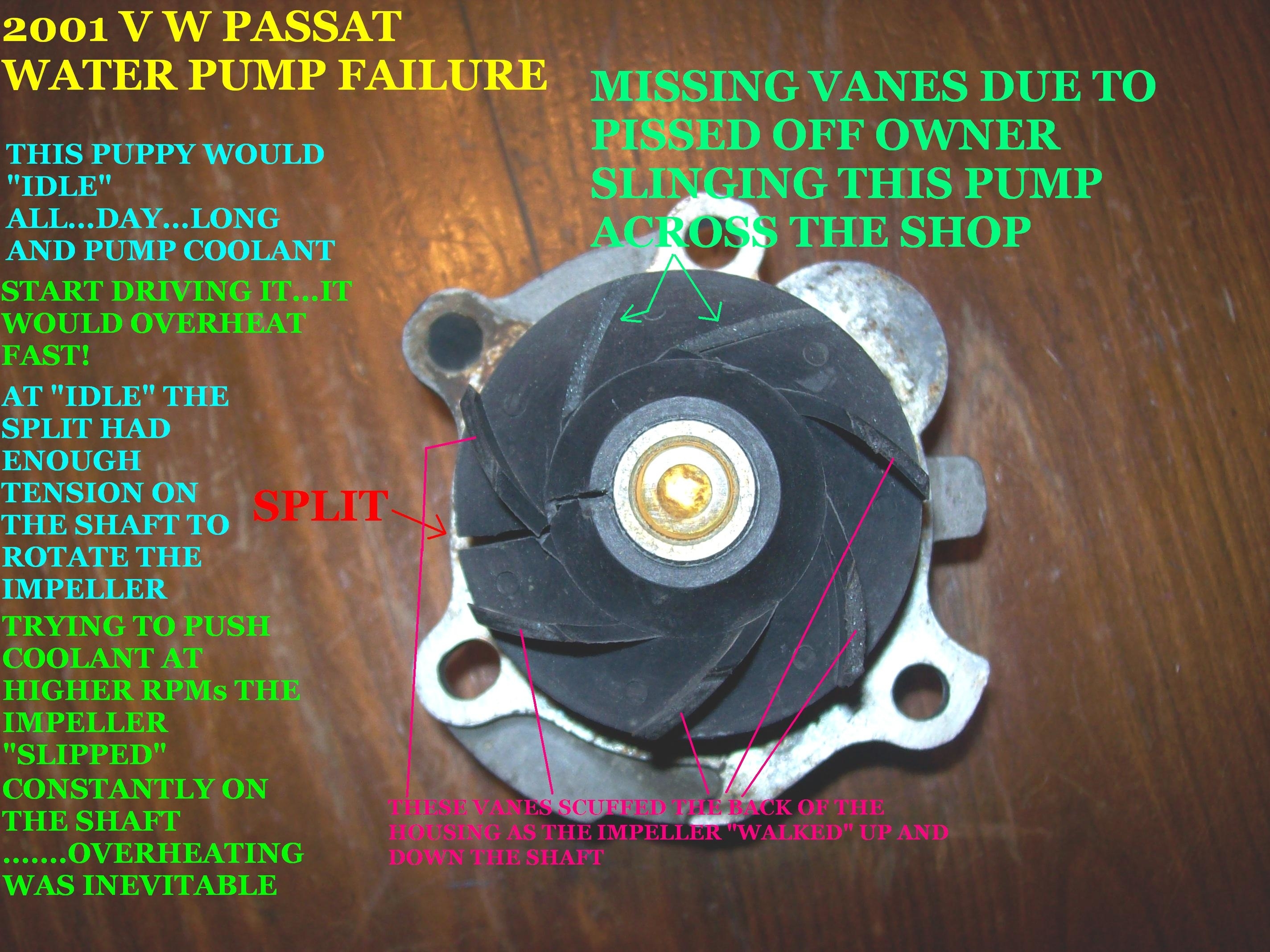

Not trying to scare you, but plastic and water pump does not seem to fit together in my book. First picture below is the one I got at the auto store site. The rest are failures from other vehicles, some are missing a fin, slipping on the shaft, others are total fails. Unfortunately, this would require removal to inspect it.

Define "hotter than normal". Most modern engines run hotter than older engines, 210°F - 215°F is normal operating temperature these days. If it is running higher than that I would start by checking the fan clutch. These can fail and cause both over cooling (if they fail and stay on) or overheating if they fail and do not engage as needed.
If the fan clutch is okay then you may have a partially plugged radiator.
However, I would use a mechanical temperature device first to verify that it is actually running hotter than it should.
Apr 29, 2018 at 1:52 PM
PATENTED_REPAIR_PRO
  • 1,853 POSTS
replace the Viscous Fan Drive.
