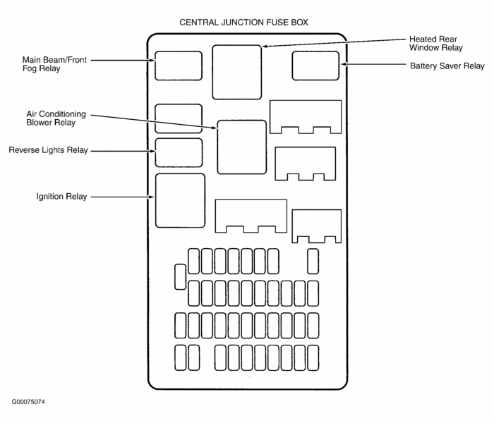

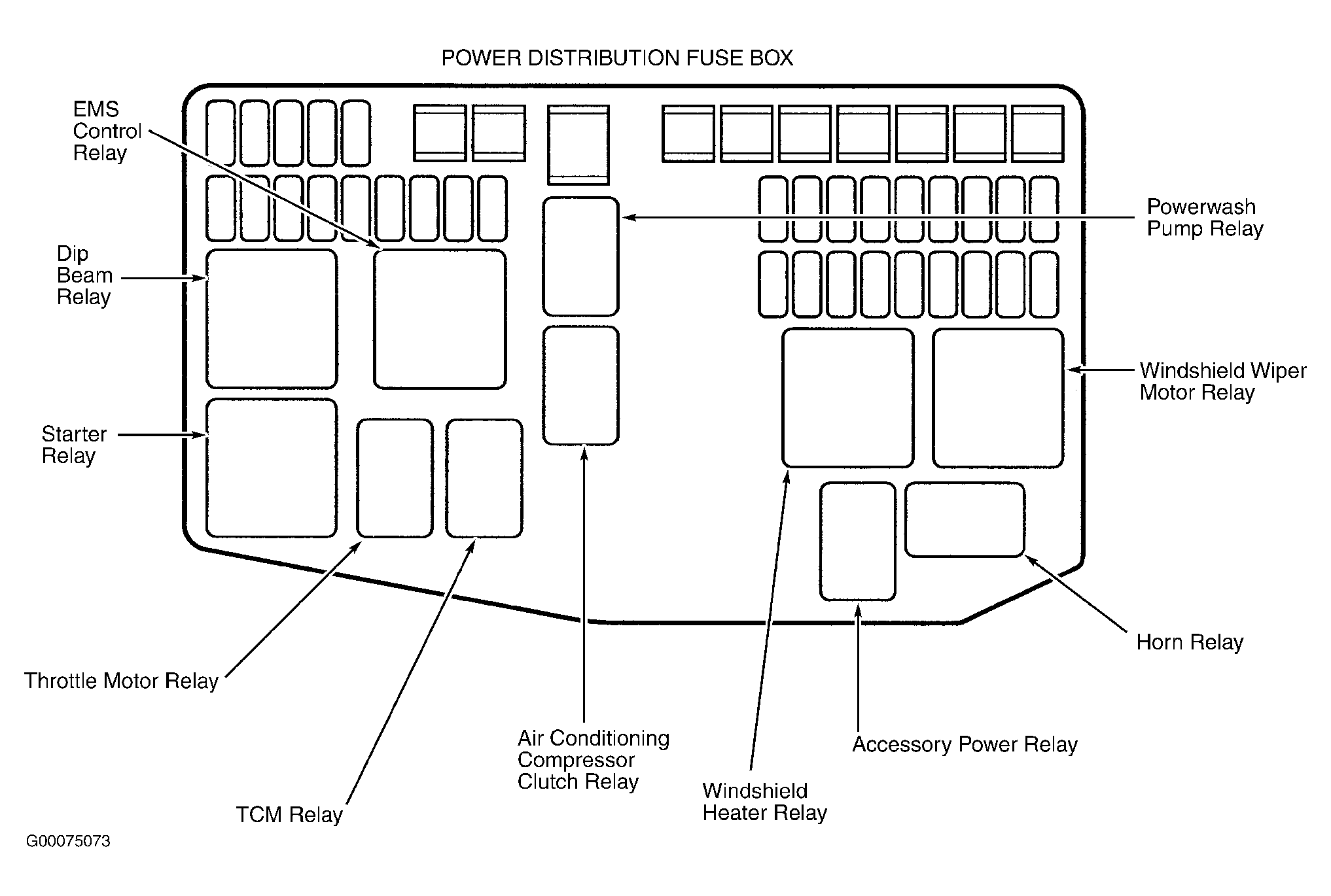

Thanks doc. The thing is that I believe my car is missing the tcm, I bought the car like this. The car wont start ( the starter wont even engage) it everything works all the electrical components are ok, I read in a post that the programming is only required when you put a transmission from a 3.0 in a x type with a 2.5 I dont know if that is true. Do you think it is the reason why the car doesn't start? And do you know how much they charge for programming? And can it be a used tcm? Thanks I appreciate your help.

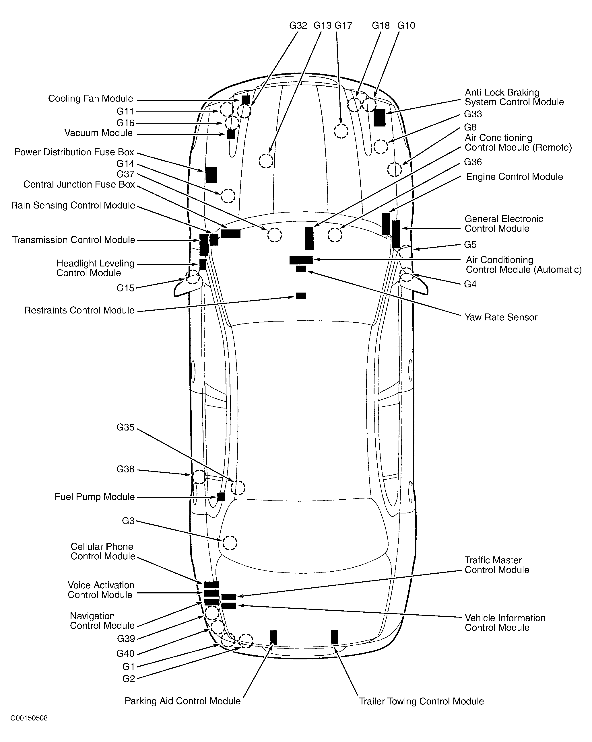

DR LOOT
  • 2,311 POSTS
I have the complete manual on this car but it is very extensive, I'm sending you the fuel section in trying to find the programming section, let me know what sections you want me to send you.
