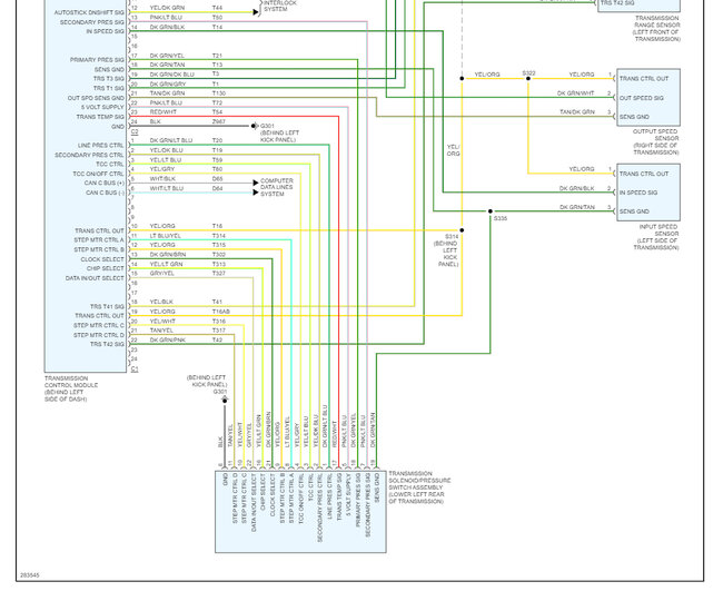

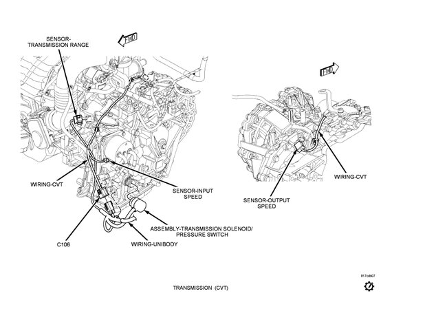

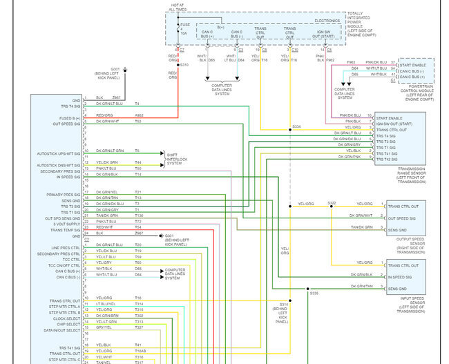

It looks like the engine input speed for the TCM is handled by the input shaft speed sensor. here are the wiring diagrams for the transmission and TCM so you can see how the system works and the location of the sensor as well. Check out the images (below). Please let us know what happens.

Replaced the input speed sensor, no change. The engine speed shows 3,488 RPMs with the engine off still. In fact, it shows that even with both sensors unplugged. I'm not sure the TCM engine speed comes from either of these sensors. The PCM engine speed reading is accurate (0RPM) with the sensors plugged in or unplugged. Could it come from a cam or crank sensor? Does this vehicle have those?

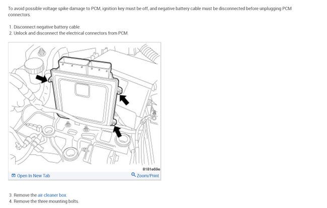

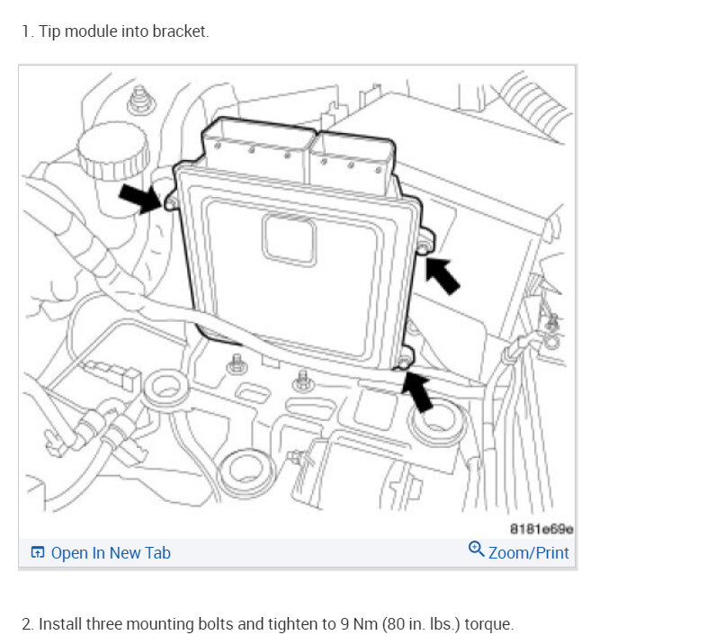

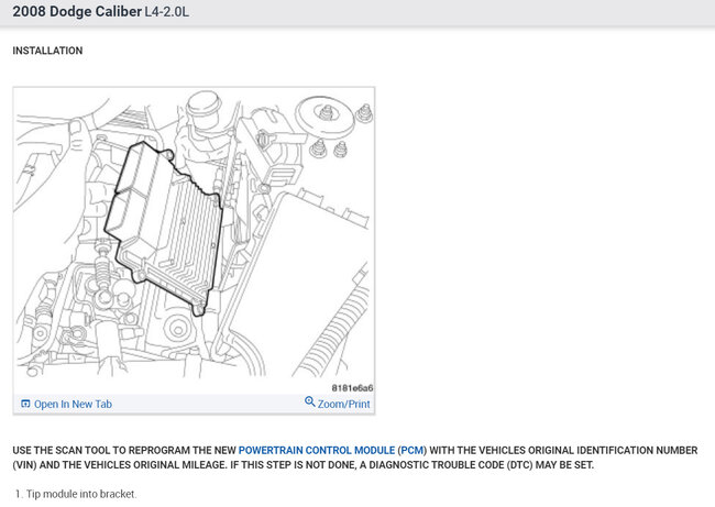

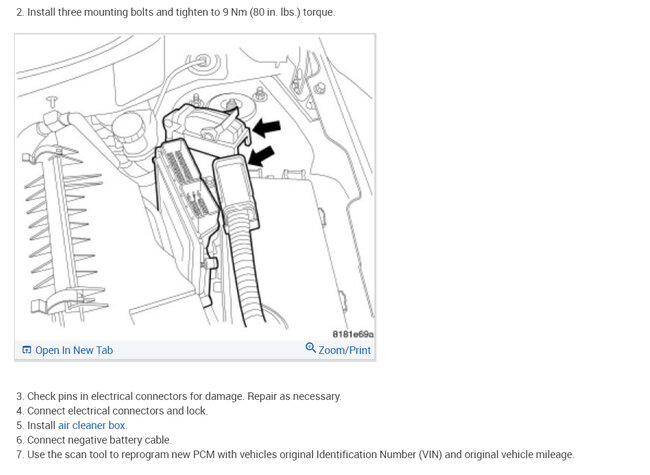

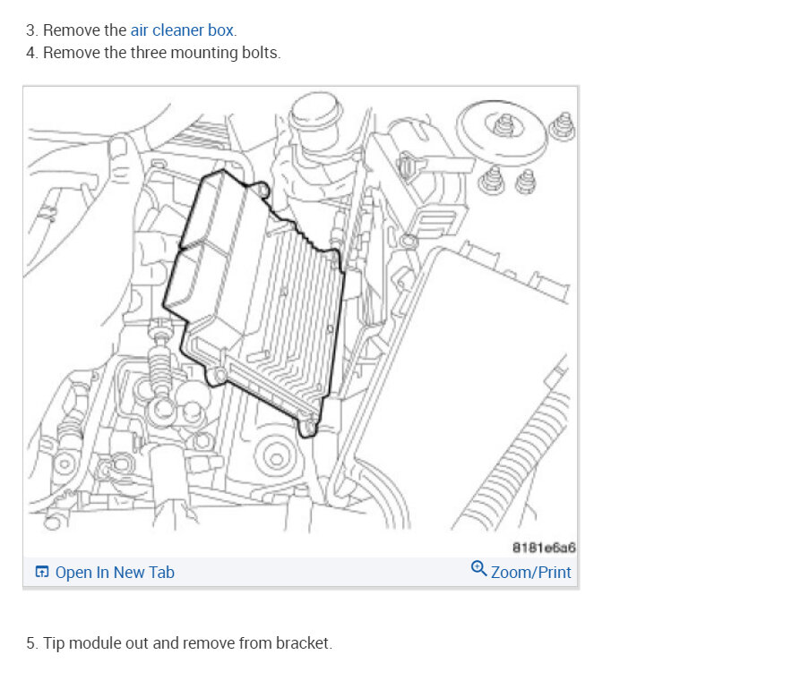

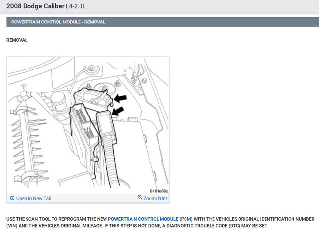

Yep, it sure sounds like the PCM is bad, I would get a rebuilt unit by searching google or eBay. Here is the location of the PCM and how to change it out, also when the electrical connectors are disconnected check the terminals for corrosion. Check out the images (below). Please let us know what happens.
